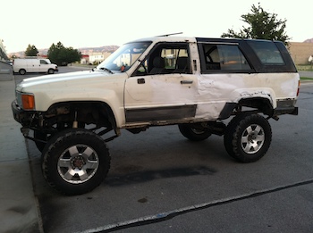

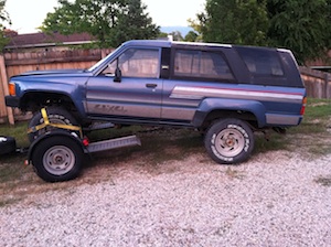

Hey guys. I'm new to posting here but I think I've read almost every post written since 2007. Anyhow. I bought an '85 SR5 with 5'' TG springs front and rear, an elocker that needs a motor, hi steer kit, and 37's for $1500. The only catch was that it had been tipped on it's drivers side and slaughtered the b-pillar.
I don't want to do a body swap, and I want to clean up some of the welds the other guy did.
I also (yesterday) just got ahold of an '88 with no motor and a good body..
So here's what I'm thinking:
22RE from 85 to 88
TG 5'' springs from 85 to 88 minus 2 springs (hopefully dropping to 3'')
elocker from 85 to 88
IFS steering box is already mounted on 88 for hi steer. (winning!)
33's
Rock sliders
on board air compressor/tanks
Aux fuel tank
Swing out tire carrier with Jerry can and hi lift holder
Here are some pics of all I get to work with!

Just somthing to think about. the 85 frame sits about 4 inches higher in the front compared to the 88 wich has a straight frame for the i.f.s. it would probably be cheeper and faster to strip the 88 to fix the 85 even if it takes a body swap to do it. but that's just my two cents. nice find by the way

Piss! I wanted to redo all the welds on the shackle mounts, I don't think the lift was done for road worthiness, the guy that did it was trailering it everywhere... Now i'm in a pickle.
