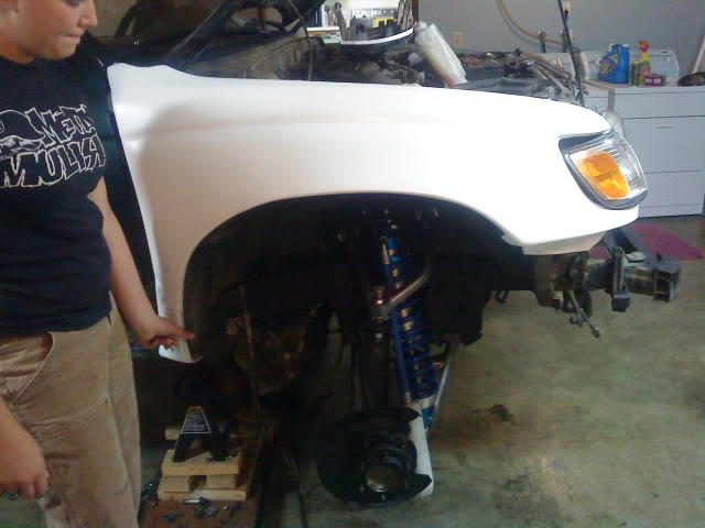

Got a lil more done today. I think there will be enough done tomoro to test drive around the block
Fenders finaly showed up from Glassworks unlimitted (about a week and a few days late) o well at least there here and my painter buddy said he would paint them this weekend.
Put in the 1" differential drop spacers.
Mocked up secondary shock hoop for placement and fit.
Removed secondary shock hoop and finish weld. (it was too hot to paint and put back on the runner so were gonna do that tomorow)

Ok since i last posted progress slowed a lil im waitin for parts. but here are some more pics.

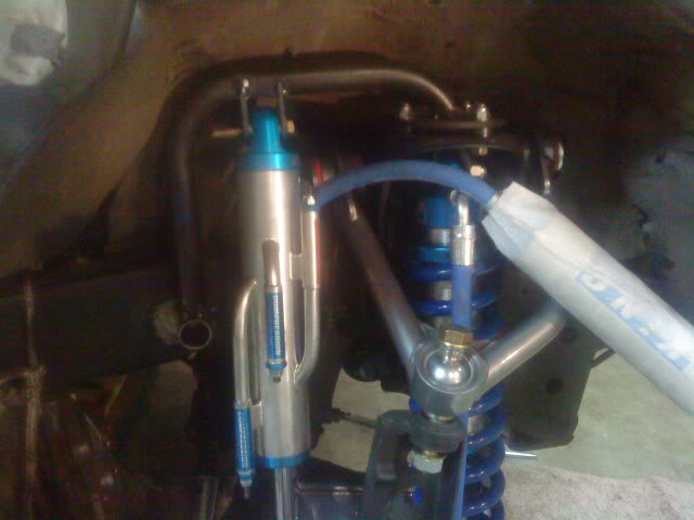

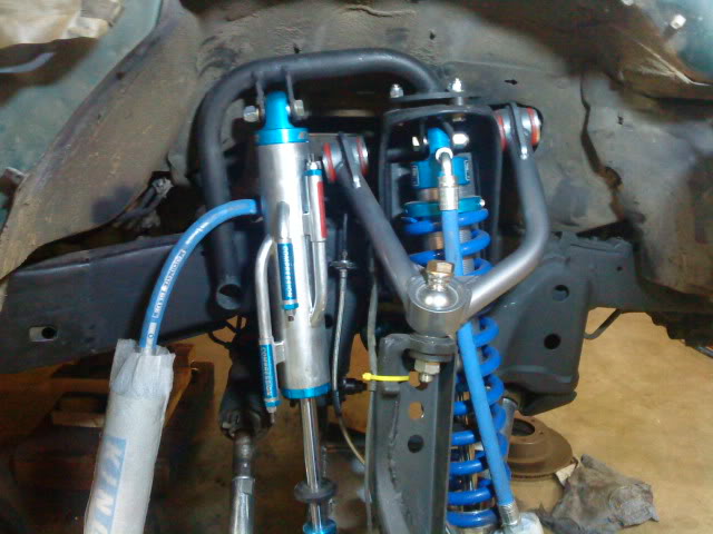

Finish welded and installed secondary shock hoops. And extended brake lines.

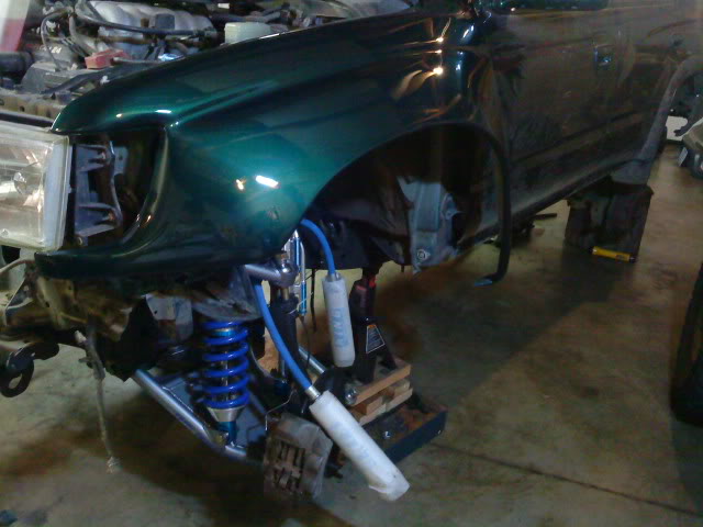

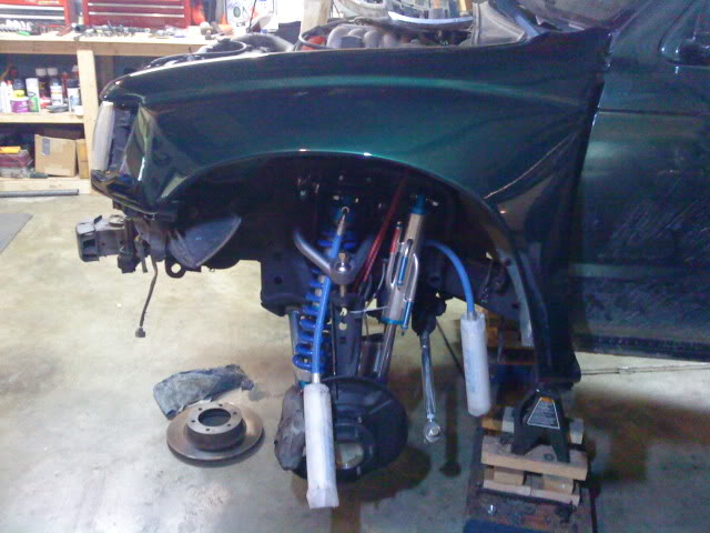

Got the fiberglass painted by my painter buddy.
Ya they look beautiful. I didnt want my GF rollin around town with white fenders thats just half ass'd.

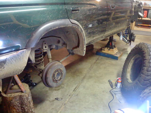

Begining teardown of rear end
Hopefully by 2mro the shock resovoir mounts will come. And Im really hopin the SONORAN STEEL 1.2 rear end kit comes. i hope i hope i hope
