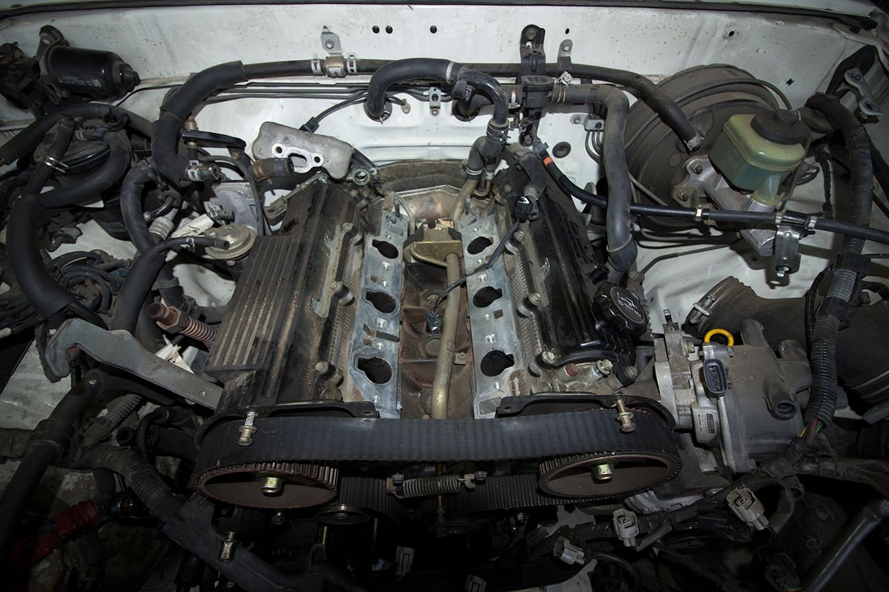

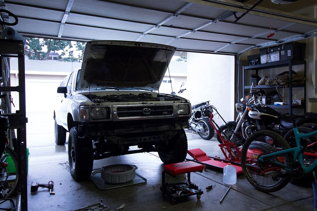

Alright, some photos as promised. Not many, and hardly interesting. Most of the photos I took were close ups of my labels so I can sort out the vacuum lines when I reconnect everything, and I won't bore you with those.

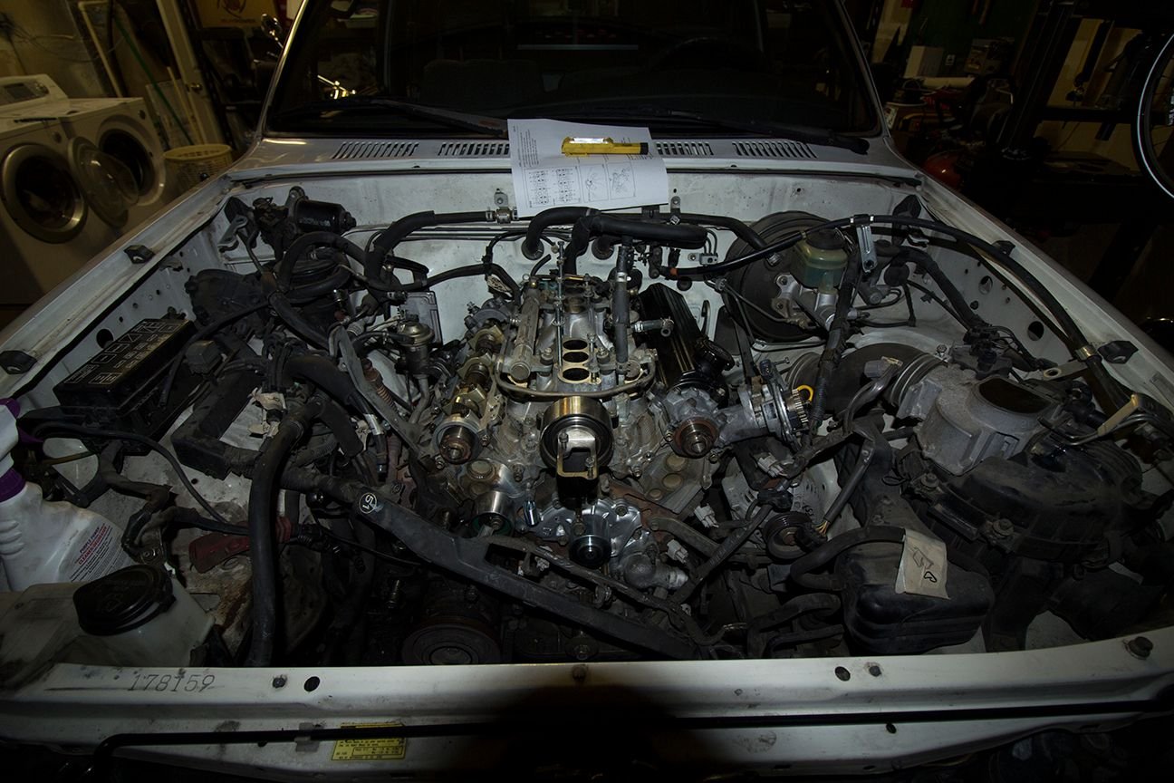

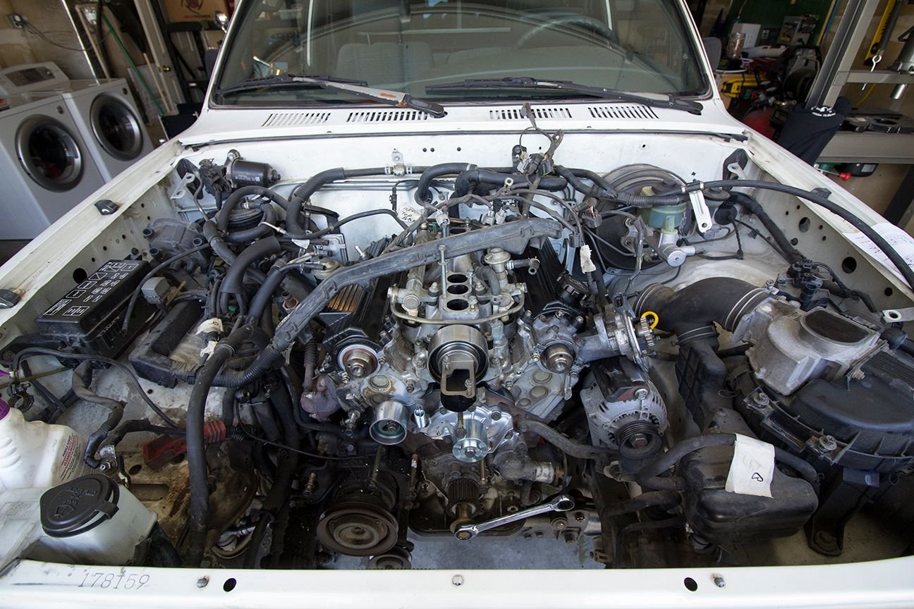

Getting started - draining the coolant, and rolling around outside in the rain to get the bumper and tow hitch off.
First signs of progress, a few things out of the way.

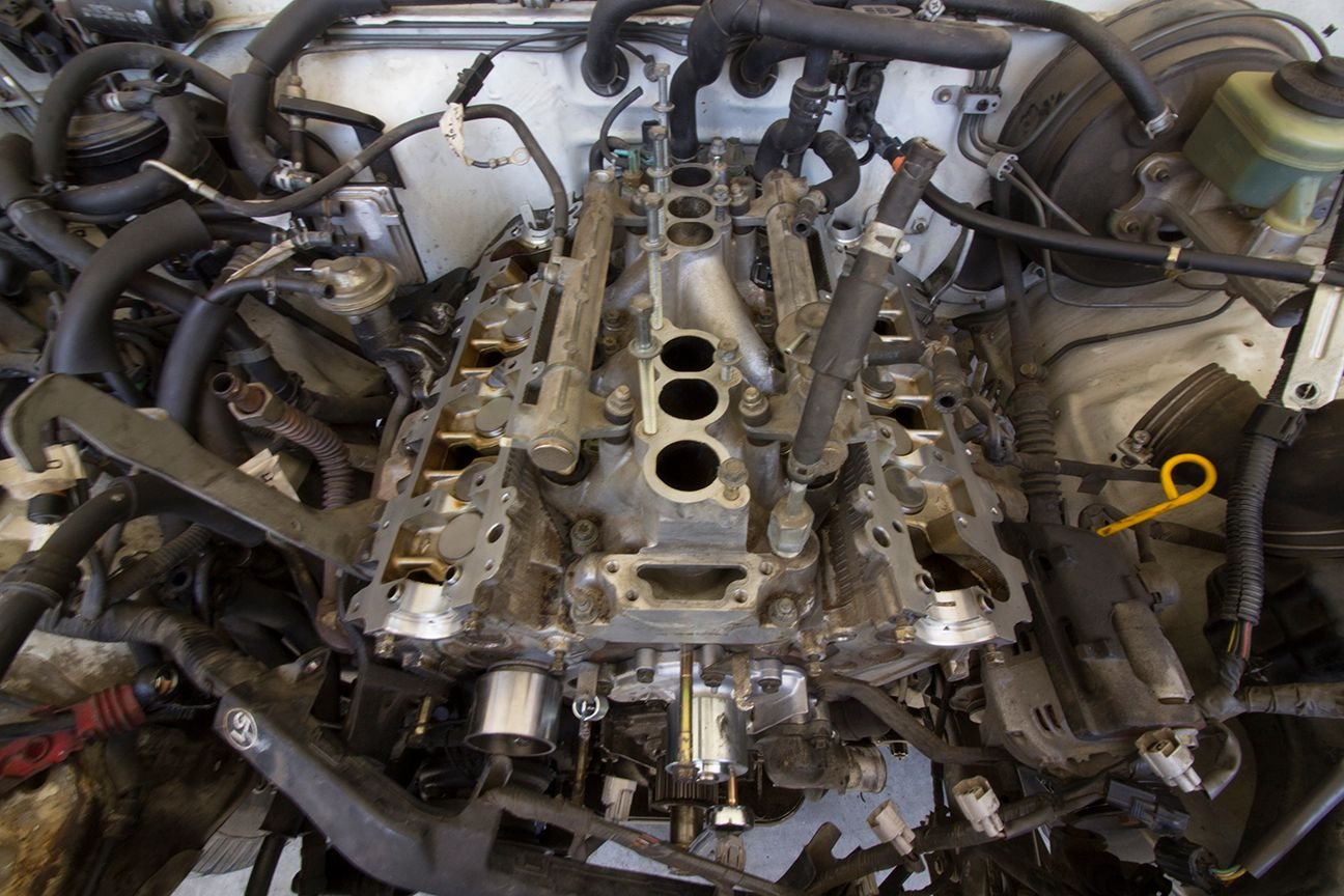

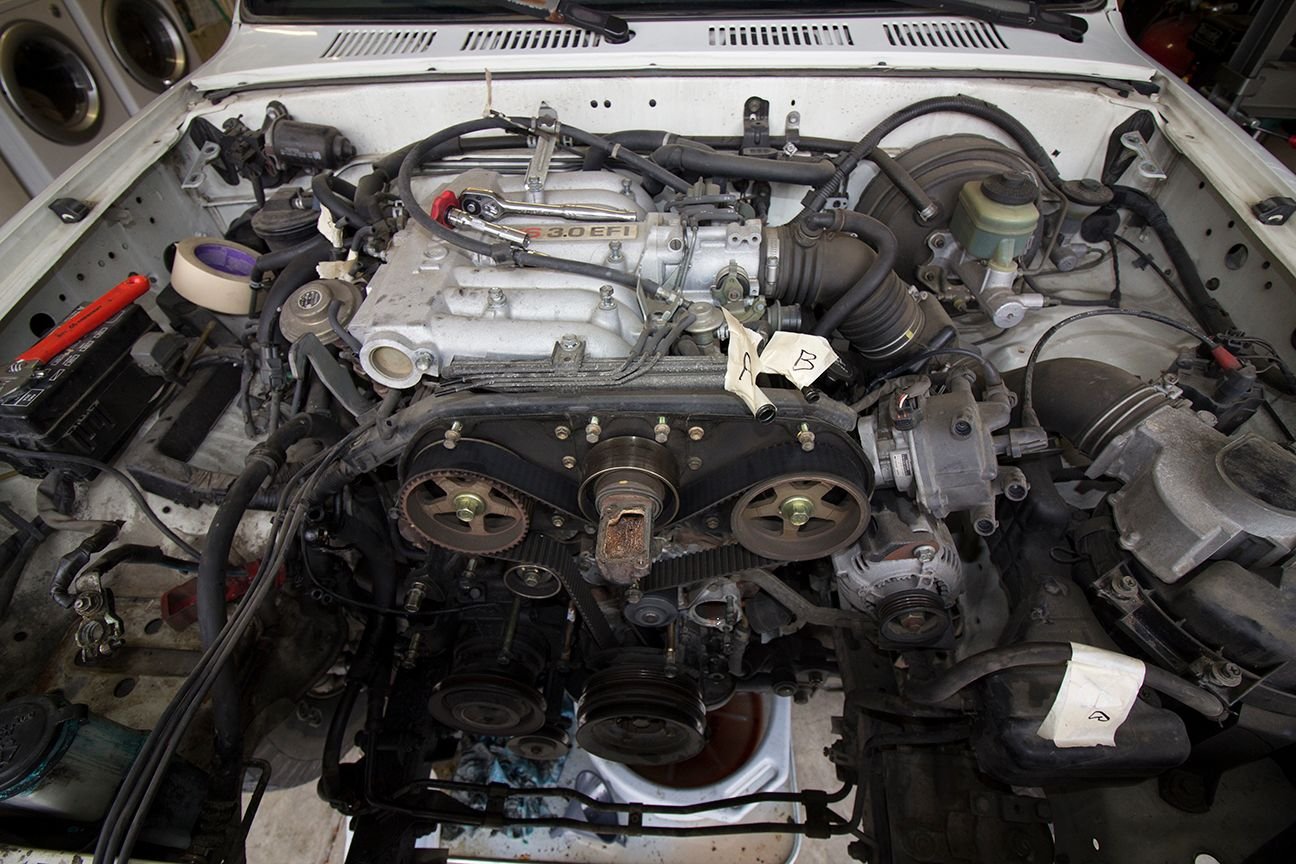

Intake plenum off, things cleaned up a bit, new knock sensor and harness installed.

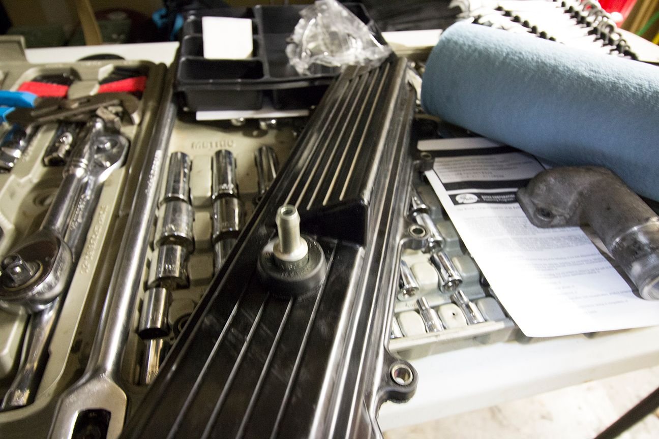

I don't know why everyone says PCV's are a pain to change, I found it quite easy

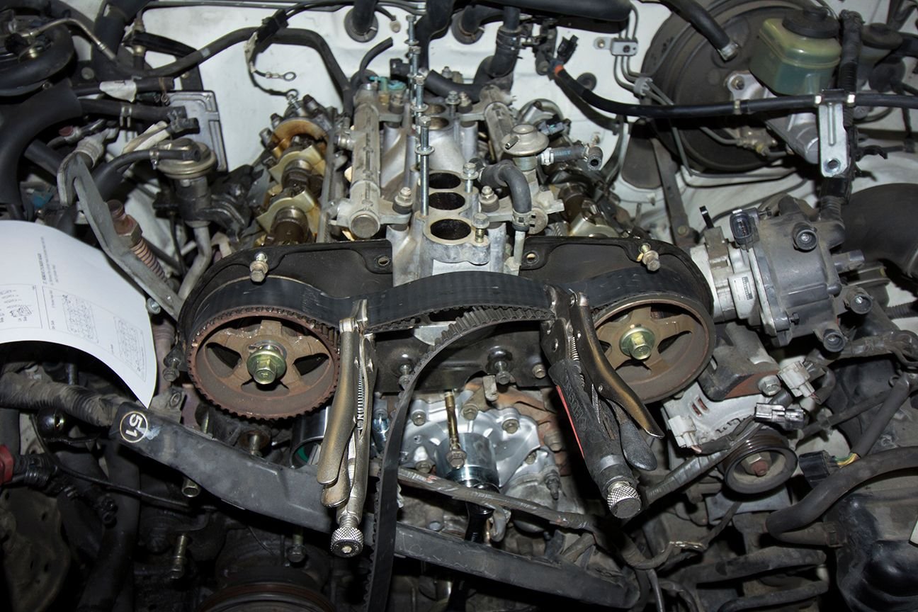

My super fancy cam sprocket holding tool. Make sure you use your new timing belt for this so you know it'll be strong enough

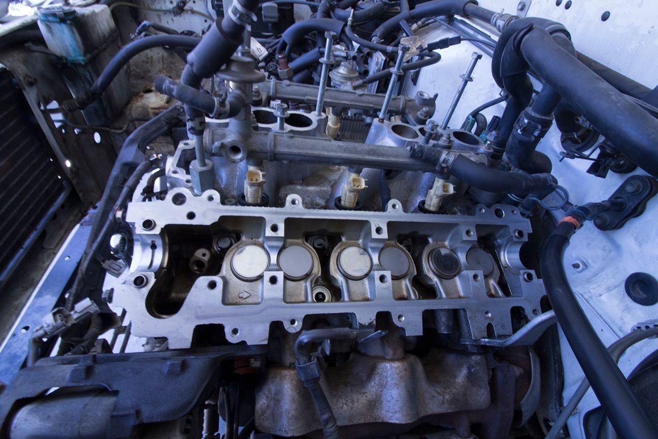

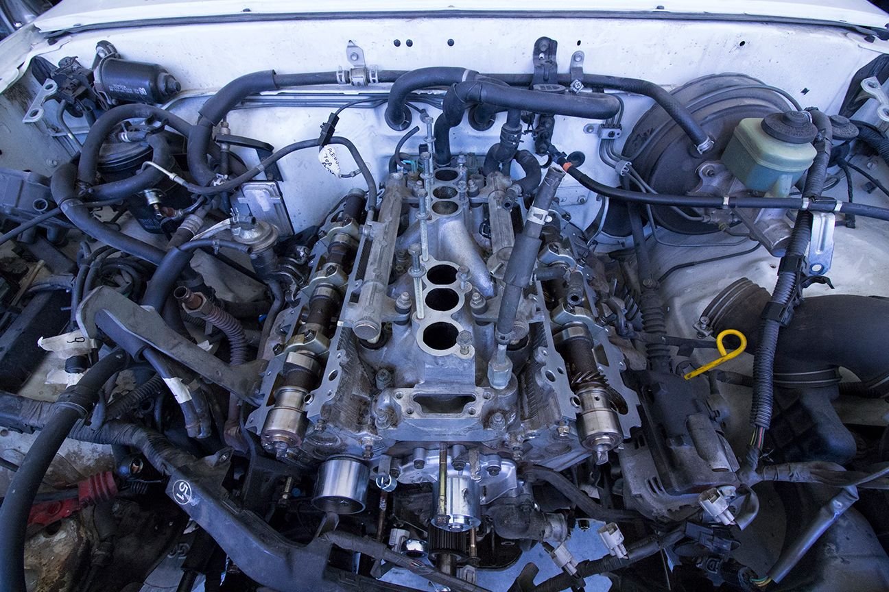

New injectors and valve shims installed, cams out, just before beginning reassembly.
If you look close, you can tell that each of the exhaust shims is dull, where the old intake shims are shiny. Fingers crossed that #6 valve isn't burned!

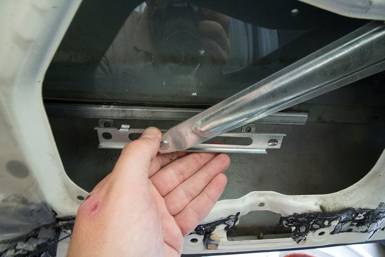

Cheap window regulator off eBay - obviously fits as described. The conversation with them is ongoing, they asked for photos and VIN and all to sort the issue out.

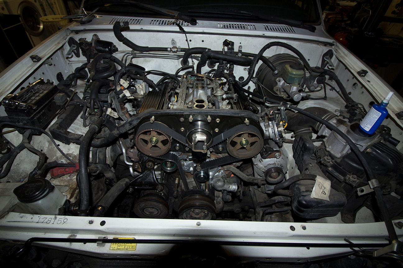

First steps to going back together!
My current resting point. I have another class in a couple hours and my final project is due, so I decided not to start playing with FIPG and torquing things just yet.

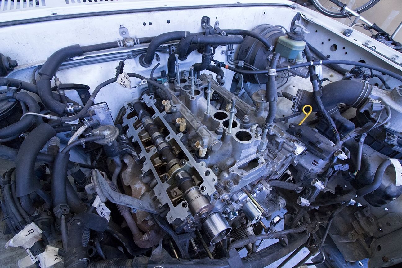

Well, I hit my first angry point working on her. Installing cams, following FSM judiciously in regard to torque spec and sequence. Install the first (driver side) cam no problem. Reset torque wrench (brand new CDI wrench that was calibrated less than 60 days ago) to 27in-lb. - approx 3Nm - for bolts that call 16Nm. Arbitrary low number to do my first 'snugging' pass. Second pass around 10Nm, then the final pass.
Bolt #2 on the passenger side cam stripped out before hitting 3Nm. Didn't even begin to feel snug, just kept turning. After the first full rotation I was a little thrown off, since I'd spun it down to contact with my fingers - shouldn't be THAT far to 3Nm. Stop. Check wrench setting. Start turning again, go another full rotation with no resistance. Take it out and it's wearing the threads out of the head.
The resting point for the foreseeable future.
I went ahead and installed the LH valve cover and reinstalled the distributor and water outlet. Figure I might as well get as much done as I can and get parts off the bench. Gonna drop by NAPA tomorrow and see if they have a torque wrench for the crank bolt, since my biggest one only goes up to 150ft-lb and it needs 181.
Guess it gives me time to crawl underneath and pull the tranny finally. Decided to finish the engine up before I did that, but plans change.
Also just realized I forgot to re-check valve lash on the driver side in my anger, so that valve cover will be coming back off tomorrow.
Now to begin research on fixing the stripped head. Helicoils the best option? Not something I've ever had to deal with. I don't think drilling and tapping for a larger bolt will really work since it's the cam journal, but there may be room there. Might just see if I can clean it up with a tap and drop longer bolts in. Oh well, tomorrow will be play time, when I'm less angry.

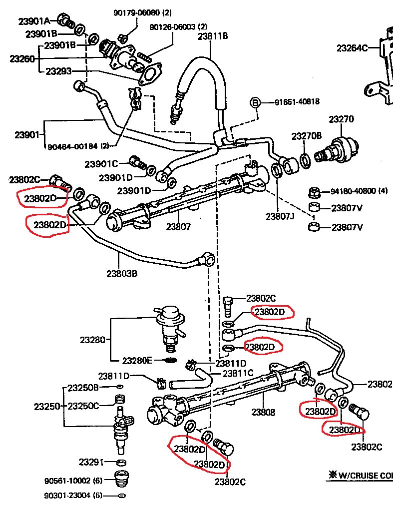

Crush washers for the banjo bolts that connect the fuel crossover pipes to the fuel rails, item 23802D (circled in red) in the image below: Toyota P/N 90430-12026
Dealership got $2.40 each for these, can be had for 1/2 that online easily. (So, kids, the moral of the story is plan ahead.) You need eight if you remove both fuel pipes. FSM calls these the "No. 2 and No. 3 Fuel Pipes." The crush washers are a non-reusable item.
Toyota P/N 90430-12026 circled in red.

Update from the past few days:
Took a long weekend to hit Overland Expo West. Even better than last year. Think I found a line on a bumper, emailed the manufacturer to continue the conversation we started at expo. Also spent entirely too much money on books and motorcycle gear.
Running either side of that weekend: Damn good thing I removed the LH valve cover, as I totally botched my math for valve shims and got all the wrong ones. Sorted that out, fortunately the dealer was happy to exchange the wrong for the right ones, so no money lost on that mistake. I'll update the valve shim excel document with a correct valve shim calculator when I get around to it. Figure it might save someone else my headache, but it will also help me out next time I have to do them.
Got the correct valve shims. Helicoiled the stripped cam journal threads. Wanked a cam seal putting it all back together. Got that replacement, spent today building everything back up.
Starting things out this afternoon. All valves are checking out in spec now, got the covers on last night.
It's starting to look like an engine again!
Next "drat" moment, realized I never ordered crush washers for the fuel dampener. Even I am now wondering "when am I gonna learn?!" so I meticulously went over the rest of the job in my head and ordered (hopefully) the rest of the gaskets and such, along with a couple more that I had earlier said "screw it, I'll just reuse it."
Once those come in, I'll be able to get the plenum back on. Going to have to figure out vacuum lines, because I was going through my photos and realized I have no idea where a few of them live. Quit for the night because the rest of the belt covers and fan/radiator components are in the bed of the truck, and I've got to push it out of the garage to get to any of them.
Honestly spent most of today's working time under the truck degreasing and scrubbing everything in sight.
How I solved a couple of issues that seem to come up a lot: Cam sprockets were both removed and torqued to spec using the old timing belt and two pair of vise grips as pictured above. You do have to reposition the belt for tightening/loosening each one, and be mindful of your routing. I was paying attention and noticed the tensioner bracket (spring tensioner) would be running close to the belt the first time I did it, and I still managed to route the belt around it and bend the hell out of it. Easy enough to fix, but be mindful and you won't have to fix it.
Removing harmonic balancer bolt: put a breaker bar under the passenger frame rail, bump the starter. I had all my ignition wires already removed at this point, but if you don't - be certain to disconnect yours.
Installing harmonic balancer bolt: rotate to piston 1 BDC (close is good enough - 180* crank rotation from TDC alignment mark on the pulley, I silver sharpied the pulley and just cranked it about 180*) then painstakingly feed string into the cylinder through the spark plug hole. I used about 12 feet of 550 cord/parachute cord. Rotate clockwise until the piston compresses string, torque to spec. I had my roommate holding some tension on the timing belt and feeding it by hand as I went through the necessary rotations, this would be a PITA alone if you care about keeping your belt installation marks correct. *VERY* important: make sure you've got the camshaft set to TDC compression for cylinder 1 - if you neglect this, you'll possibly (probably?) ruin your valves.
Hopefully I can wrap up most of the engine stuff tomorrow. Not likely though. After tomorrow, my schedule goes into straight chaos, then leaving town for a 6,000 mile motorcycle trip until early July, so I'm probably close to where it'll be sitting for a while.

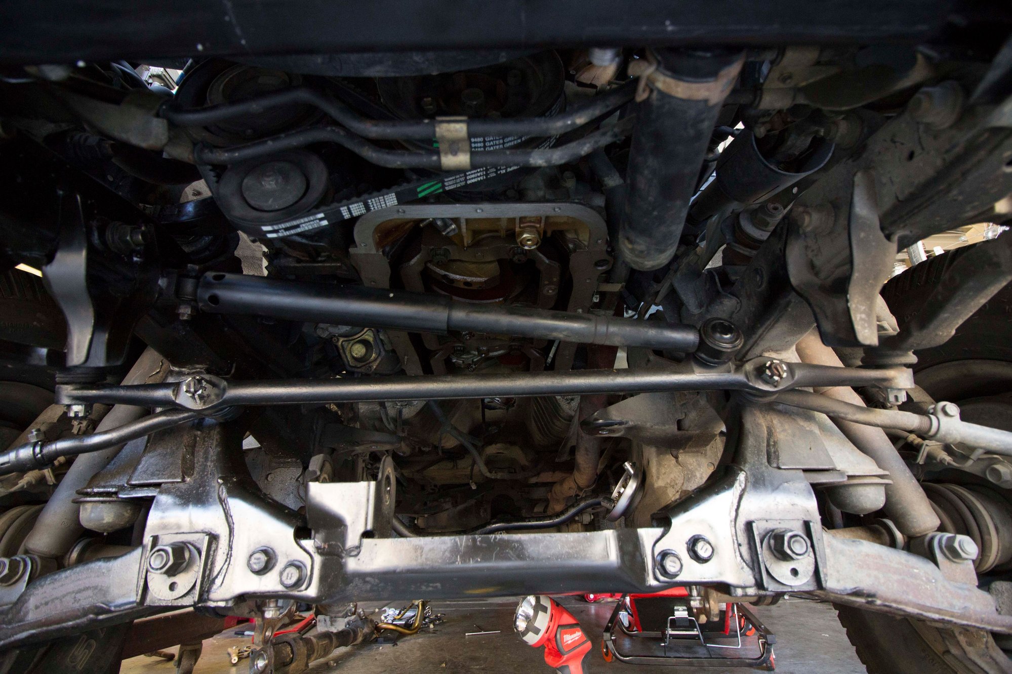

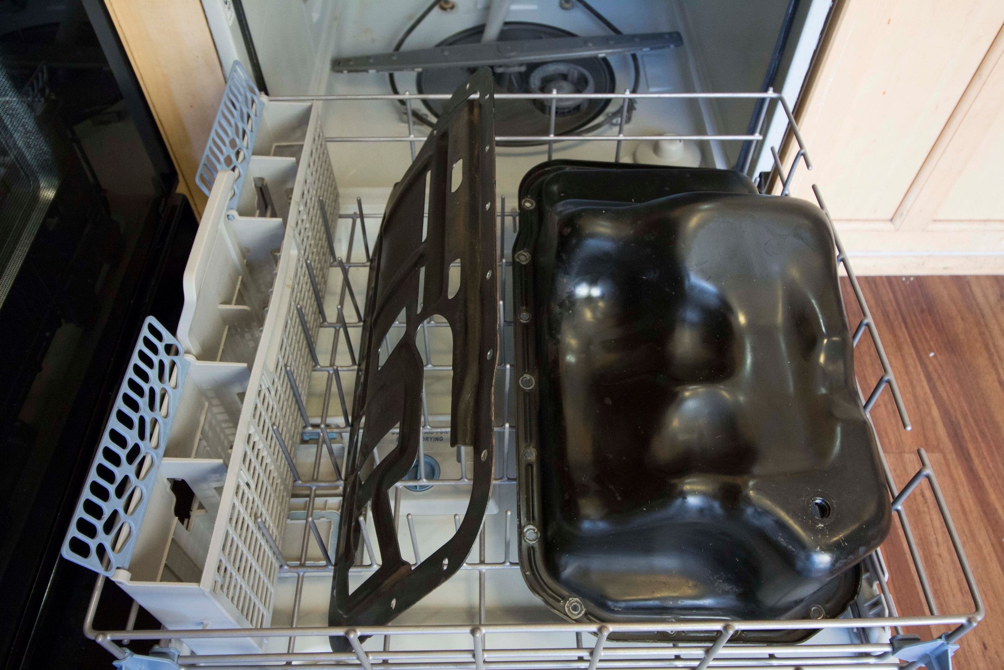

Few quick shots. Got the oil pan and baffle plate off and cleaned up. Need to roll back under her and button up the new rear main seal, then it can all start going back together. Hung up trying to find a second set of hands to simplify the job to hold things in place so I don't jack up the FIPG job. My go-to wrenching buddy's girlfriend and grandma are in town this week, so I'm out of luck for a few days.
Engine as it sits now. Had to buy the brace, or leave my garage door open (in town - no chance) for the duration of the work because there's no room for the hoist with the door closed.
The belly. Garbage shot, but looking pretty desolate down there.
Bachelor level: 1000. This was after much scrubbing with a brass brush, picks, degreaser, brake cleaner, and windex. Couldn't manage to keep the tiny flakes of RTV off. If it kills me, Darwin will be proud.

Replaced all the window weather strips and window run on the driver side today, a LOT easier to roll up and down, except one spot that seems to catch. I did not replace the lower/front run, as I mistakenly thought it was all one piece, so I assume that's my problem. I can't seem to find a part number for it online, however
