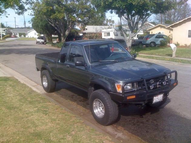

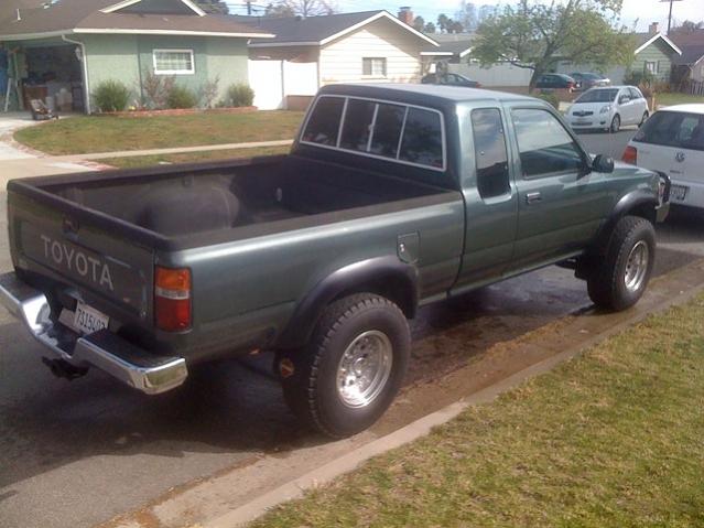

I picked up a 1992 toyota pickup DLX 4x4 xcab. It has the stock 3.0L V6 motor.
The truck is pretty much stock at the moment.
Plans for the truck:
1) Interior- Rip all the carpet out and herculine the interior.
2) New Rear Bumper (truck came with an ARB front bumper) and Rock sliders
3) Fix windshield wipers and sprayer setup (long story ill explain later)
4) New audio system for inside and out (gotta have tunes for the camp site)
5) Solid Axle Swap (trying to collect parts, as soon as I get everything together I will be swapping front ends).
6) New tires (33x10.5 MTR KM2)
7) Repaint truck
I have attached a couple pictures attached below, let me know what you guys think. I am sure I will have a ton of questions.

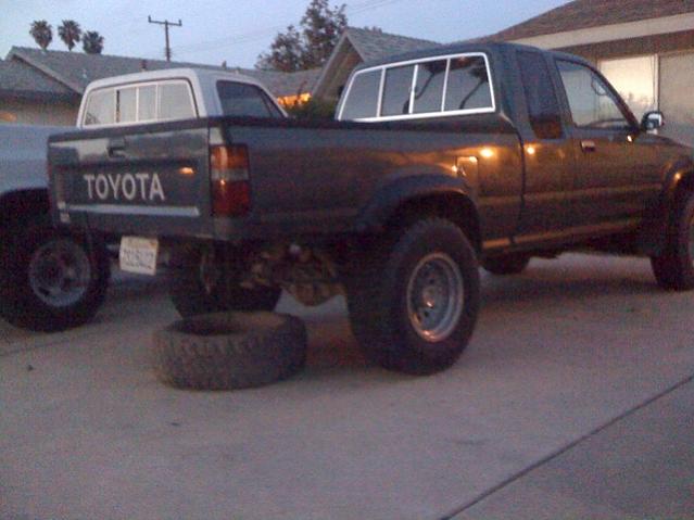

I spend a couple hours the last 2 days making working on a rear bumper. After toying around with ideas for a while, i am going for a high clearance bulletproof bumper.
Day 1: remove old bumper and tow set-up, clean up old tow setup and throw a fresh coat of primer on it, rough cut stock 2x4 steel for bumper,
Day 2: Tack bumper together to get a rough idea of dimensions, remove roughly 6" from the bottom of the bed, clean up frame, finish mocking up rear bumper, final cut and weld rear bumper up, mock up mounting plates for bumper
Day 3: To Be Determined
Here area few pics of the progress so far, i dropped the spare tire so you can see the rear clearance I will have when its done. I am also planning on mounting the rear tire somewhere on the side of the bed.
