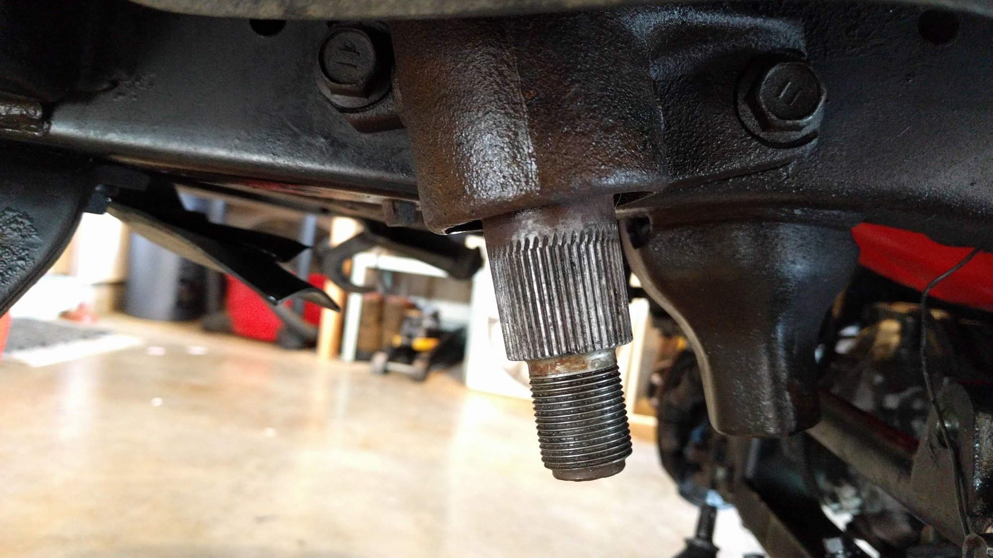

Everything was going like a boss when I found this....
Has anyone seen this before? This is a stock rig, I can't imagine how this happened. Or is it more common than I thought?
The good news is I have an entire rolling chassis from a V6 'runner sitting on my RV pad, complete with steering box. Bad news is it set me back a few hours. C'est la vie.

Am I seeing this correctly? Are the spines bent down toward the left? If so, I guess an improperly torqued nut could lead to that.

Yep the splines are twisted.

isn't that the idler and not the steering box?

Dropzone, it looks like the steering gear to me. Also, the front of the car is to the left in the picture, which makes this device on the drivers side.

Definitely steering box. Also, if you disassemble the idler arm, there are no splines. The shaft is a part of the arm. I have a mini write up of the 4crawler bronze bushing install I'll be adding shortly.

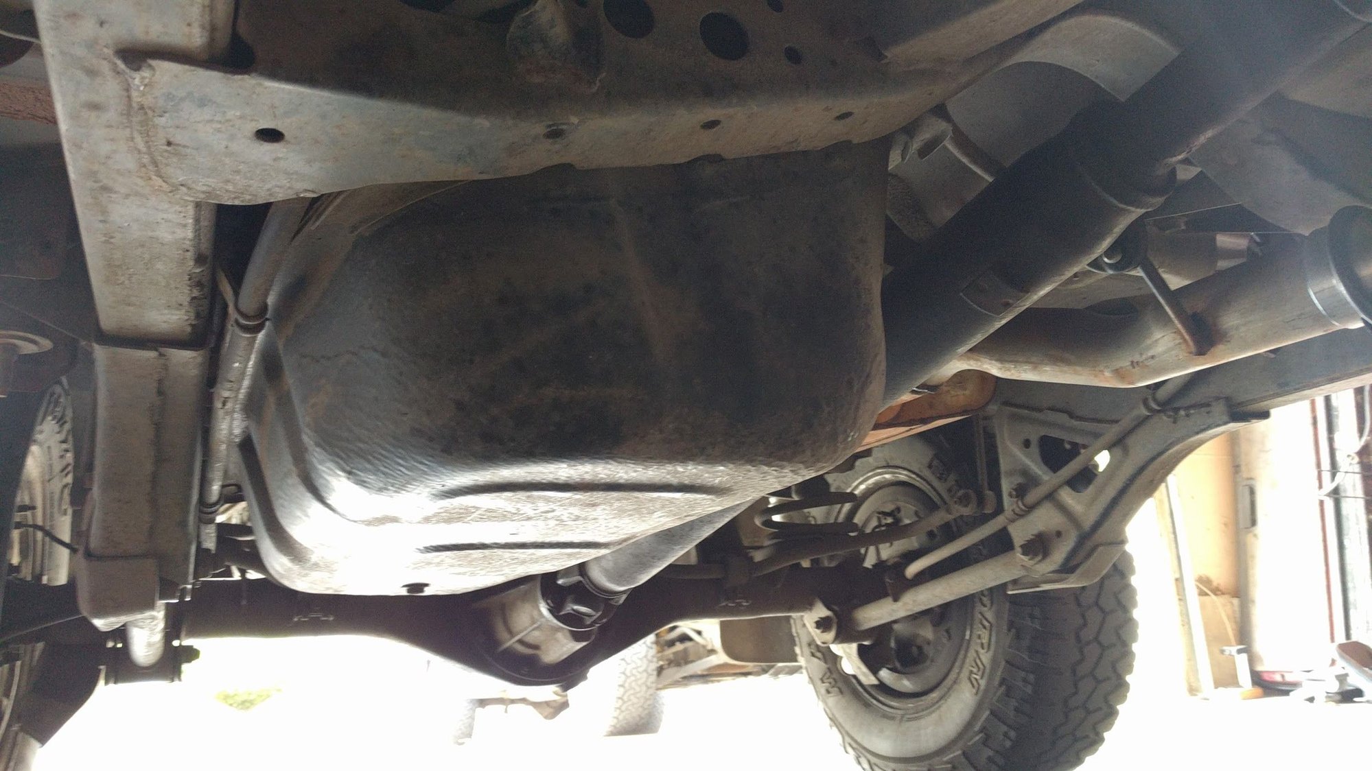

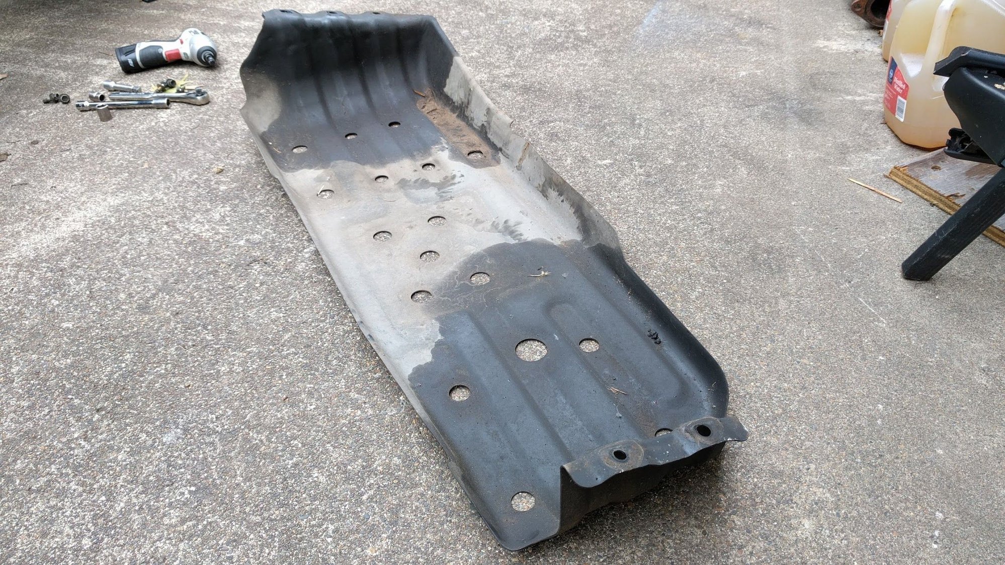

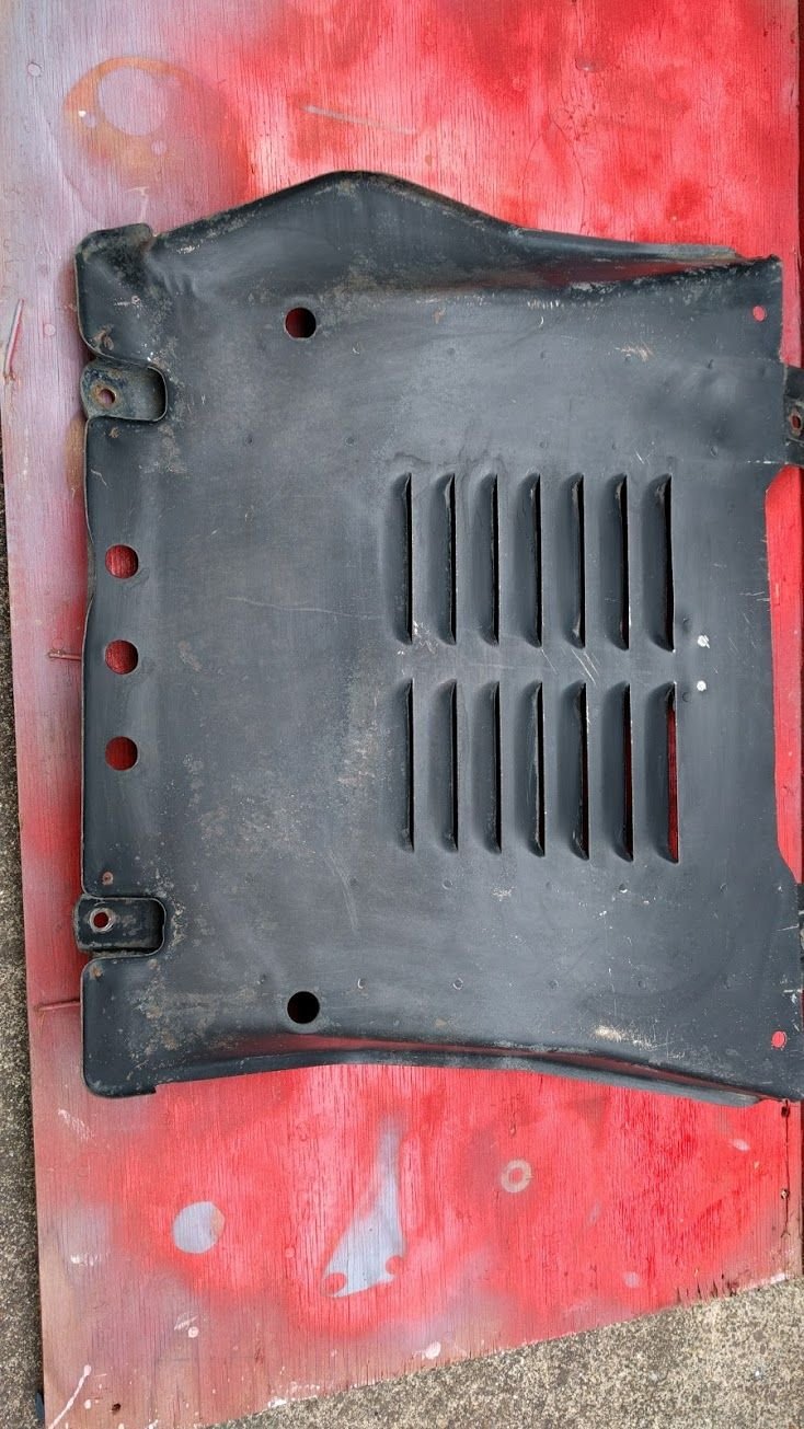

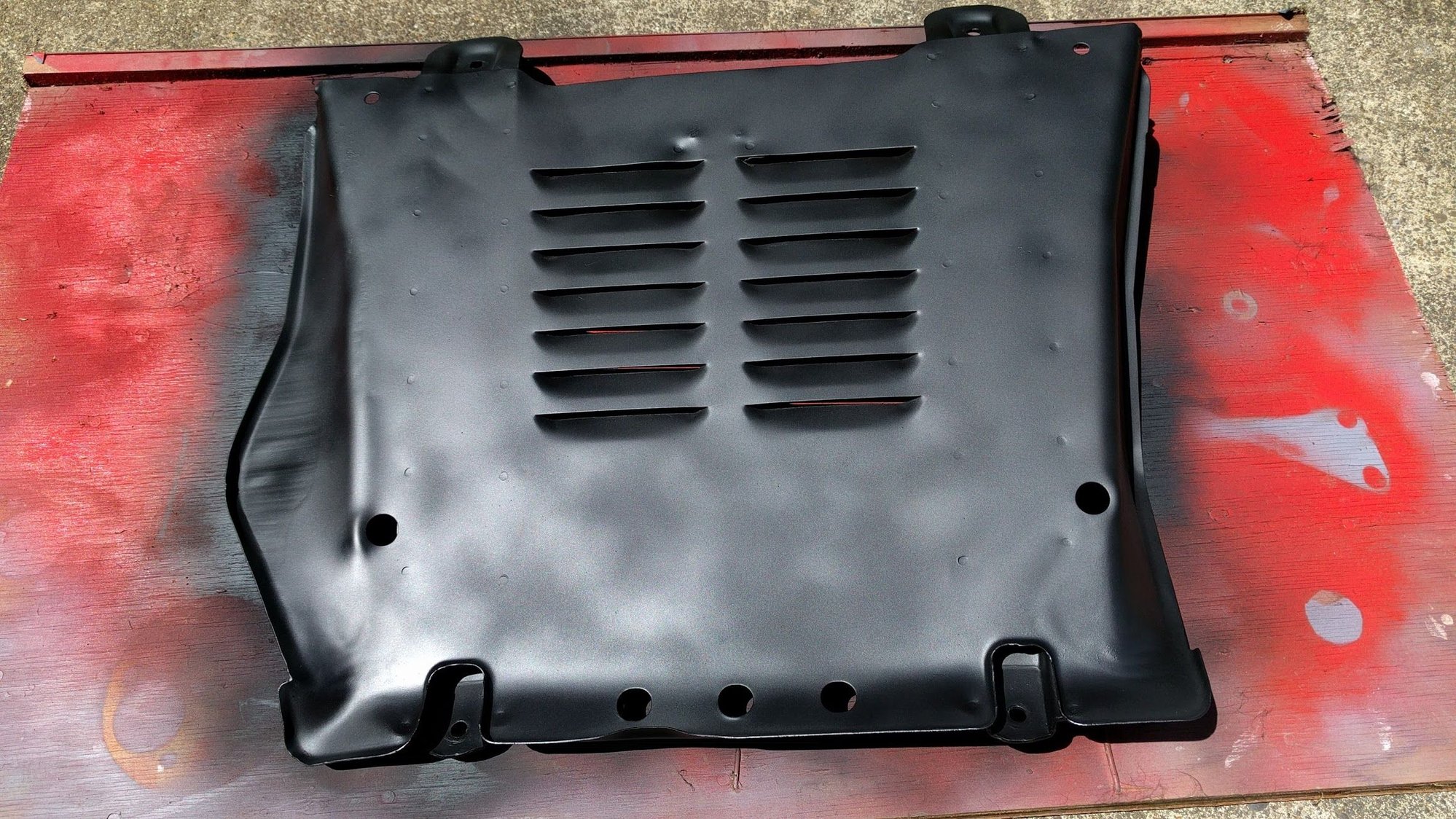

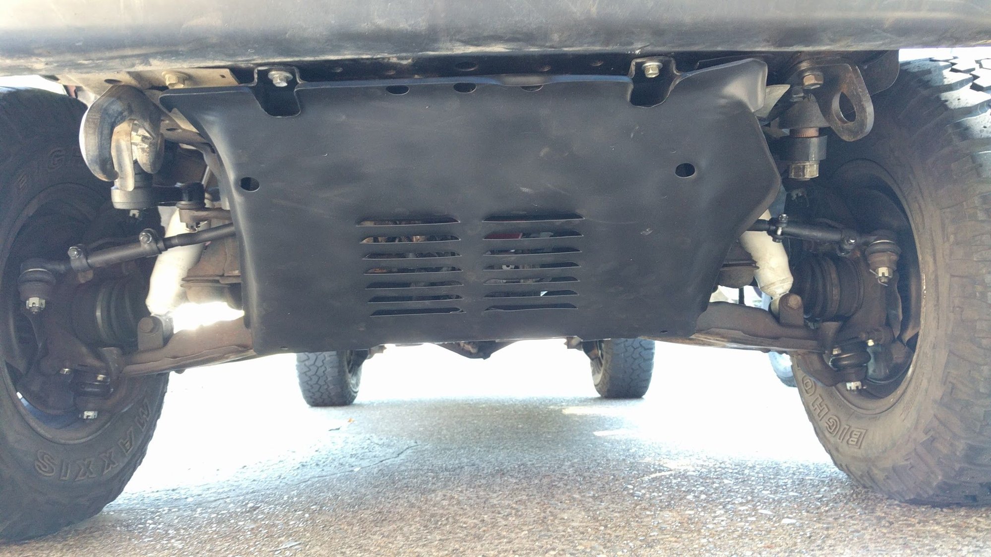

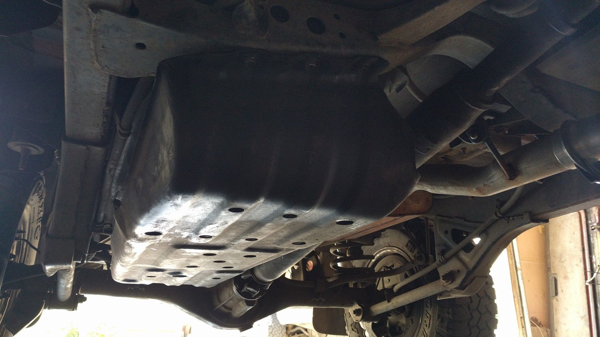

Now that the front end, engine swap, and all related hoo-ha is done, figured I'd reinstall the skid plate. One of the mounting holes had a broken bolt stuck in it so I spent the first hour of my day dealing with that. But got it sorted.
Skid plate - after pressure washing, still needs some help I think:
Washed up and wiped down with grease and wax remover- better...
Giving this a shot, can claims little to no prep required... we'll see about that!
All painted up
Installed!

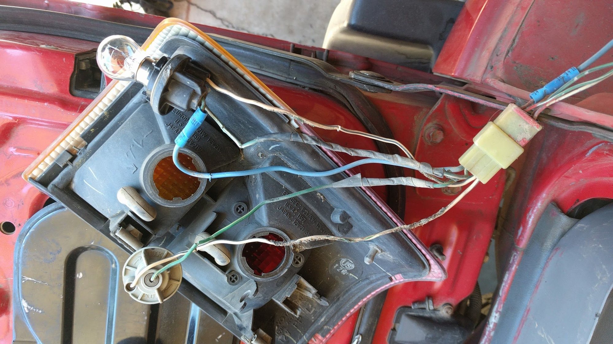

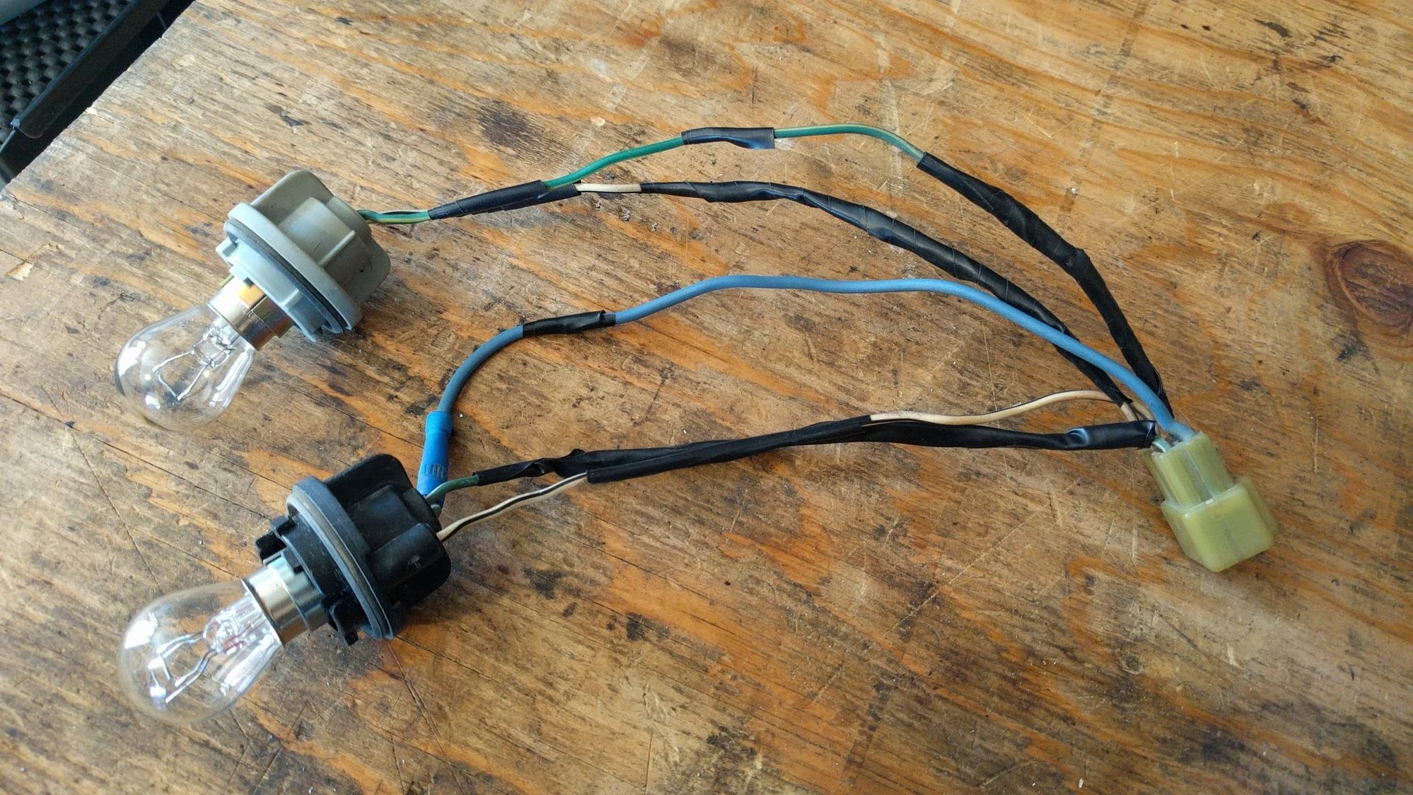

Had a brake light out... pulled the tail light out and found this... I'll be adding a tail light harness to my junk yard shopping list. Pulled the ˟˟˟˟˟ty trailer wiring out while I was at it.... not pulling any trailers with this, and if that changes, I'll build a real wiring harness for it.
Not sure how my lights are even working...
Better for now....

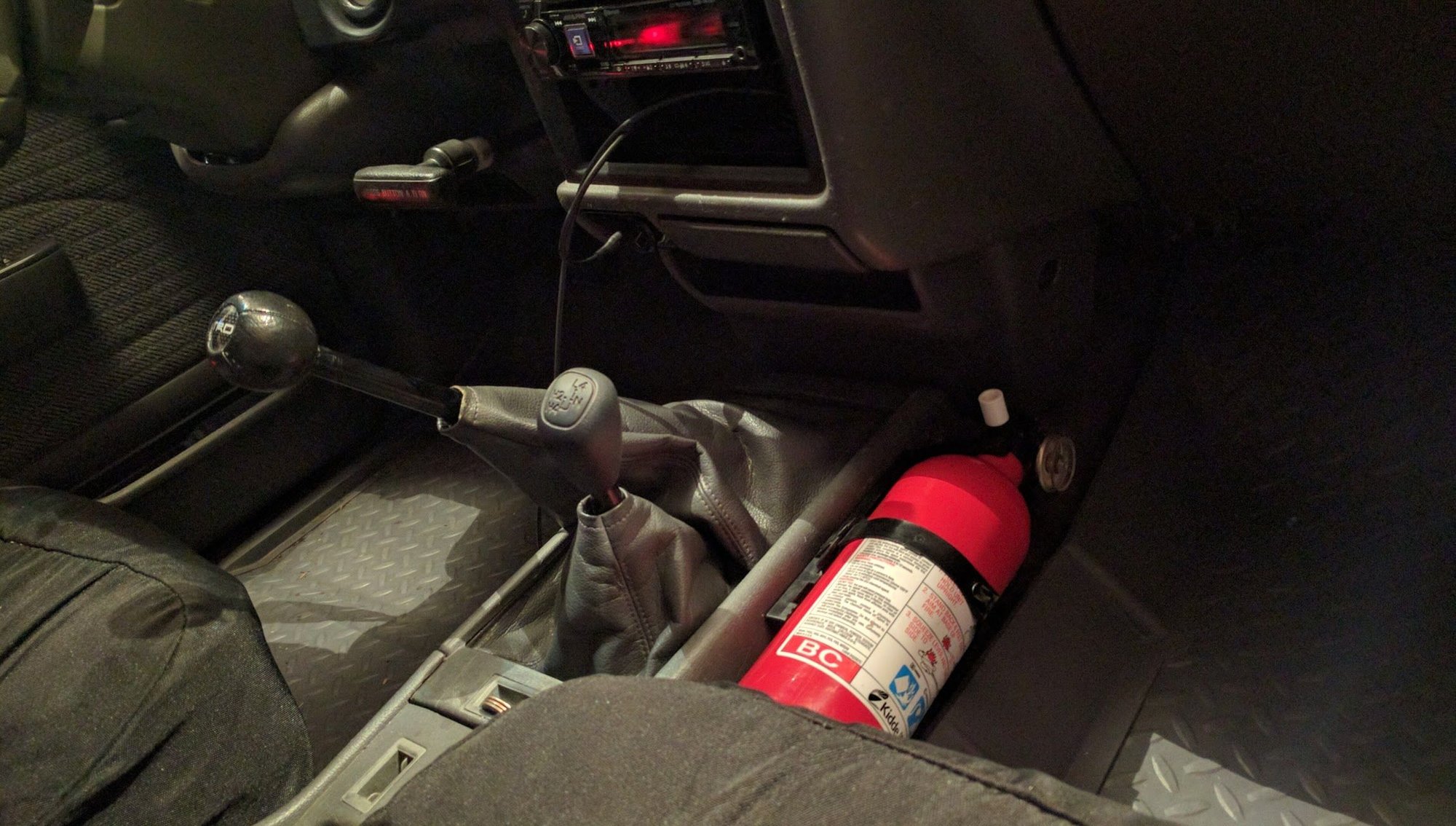

And mounted my fire extinguisher. I like them handy, this seemed like a decent spot.

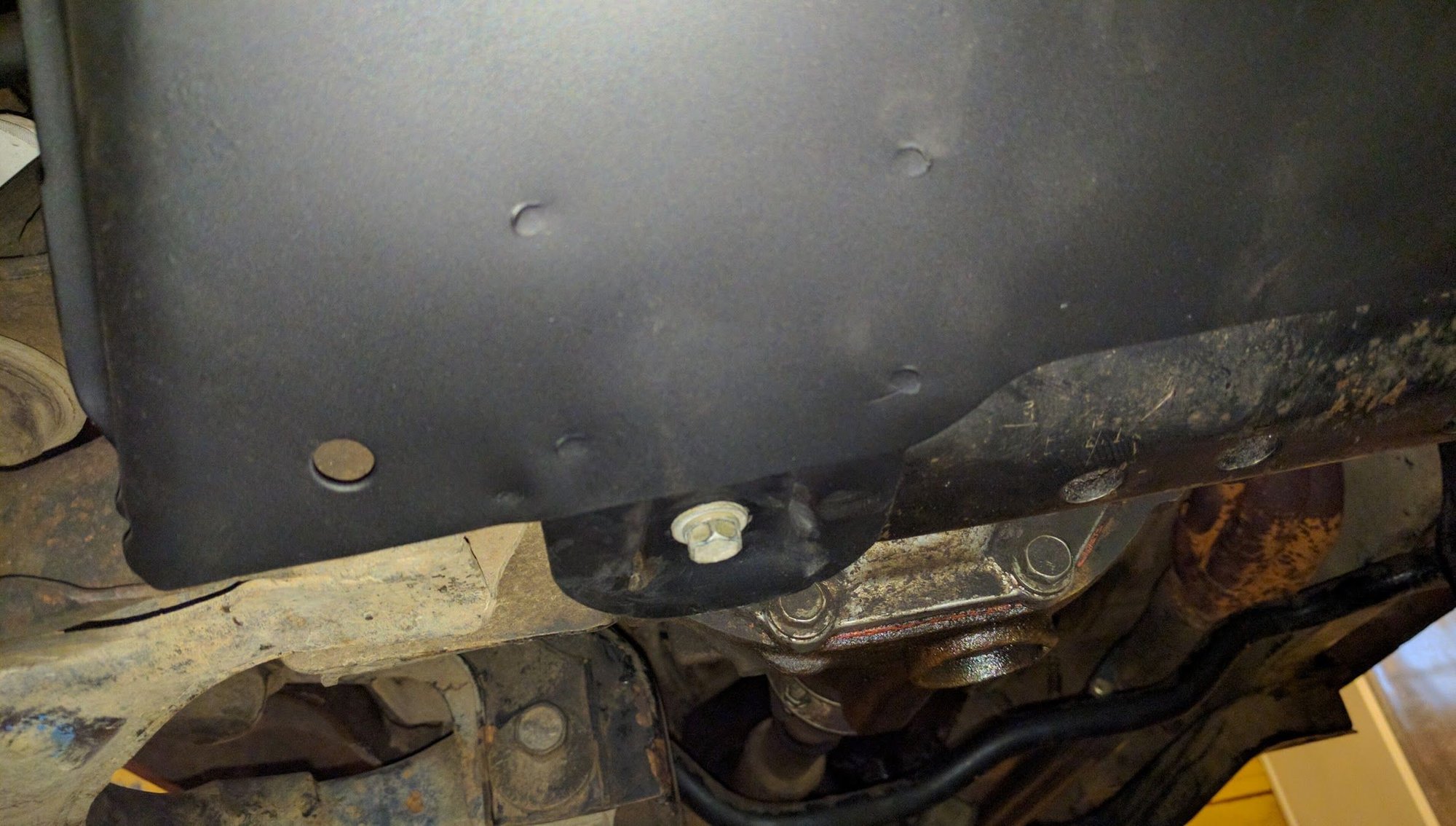

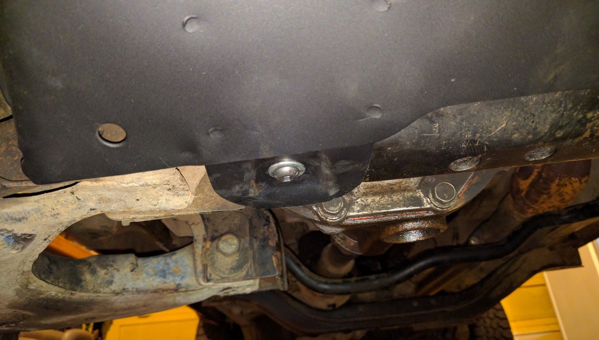

I don't like the factory bolts holding the lower part of the skidplate on. Looks like smashed bolt removal would be imminent if I kept these around. An easy fix is some button head bolts. I'm surprised I haven't seen or heard of this mod before, I'm sure I'm not the first person to think those bolts would become unusable after a few trips to the woods!
5 of these for $3 at the local Fastenal:
Old stupid bolt
New awesome bolt:
Both installed... much better!

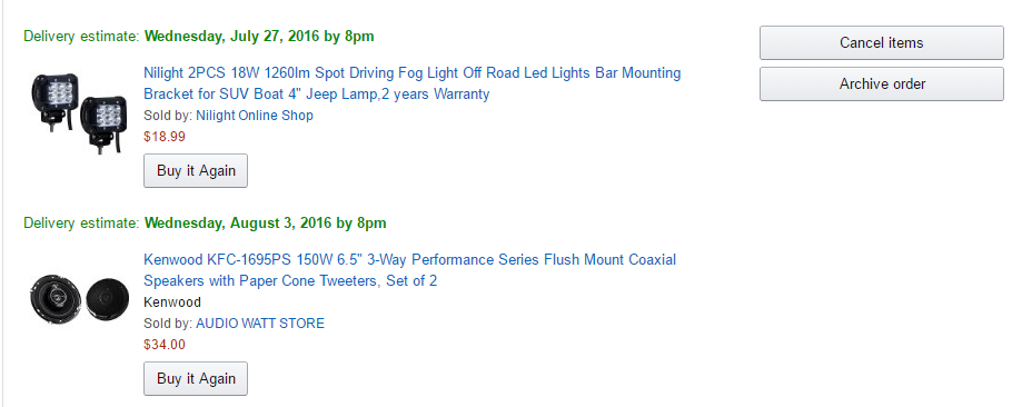

Blew one of the junk 4" front speakers the PO had installed. They were garbage anyways but it is pretty much forcing me to figure out a good door mount solution. I think I'll be borrowing from Dropzone on that one. And Amazon says those are decent lights. We'll see for $18.. they are no Rigid's, but I bet they'll work for the price.

That wiring mess you found looks like it was done by the same master that wired some of my trekker.

I'm pretty sure this villain is on the loose and responsible for wiring hack jobs all over the world... if I ever find him I'll string him up!!
