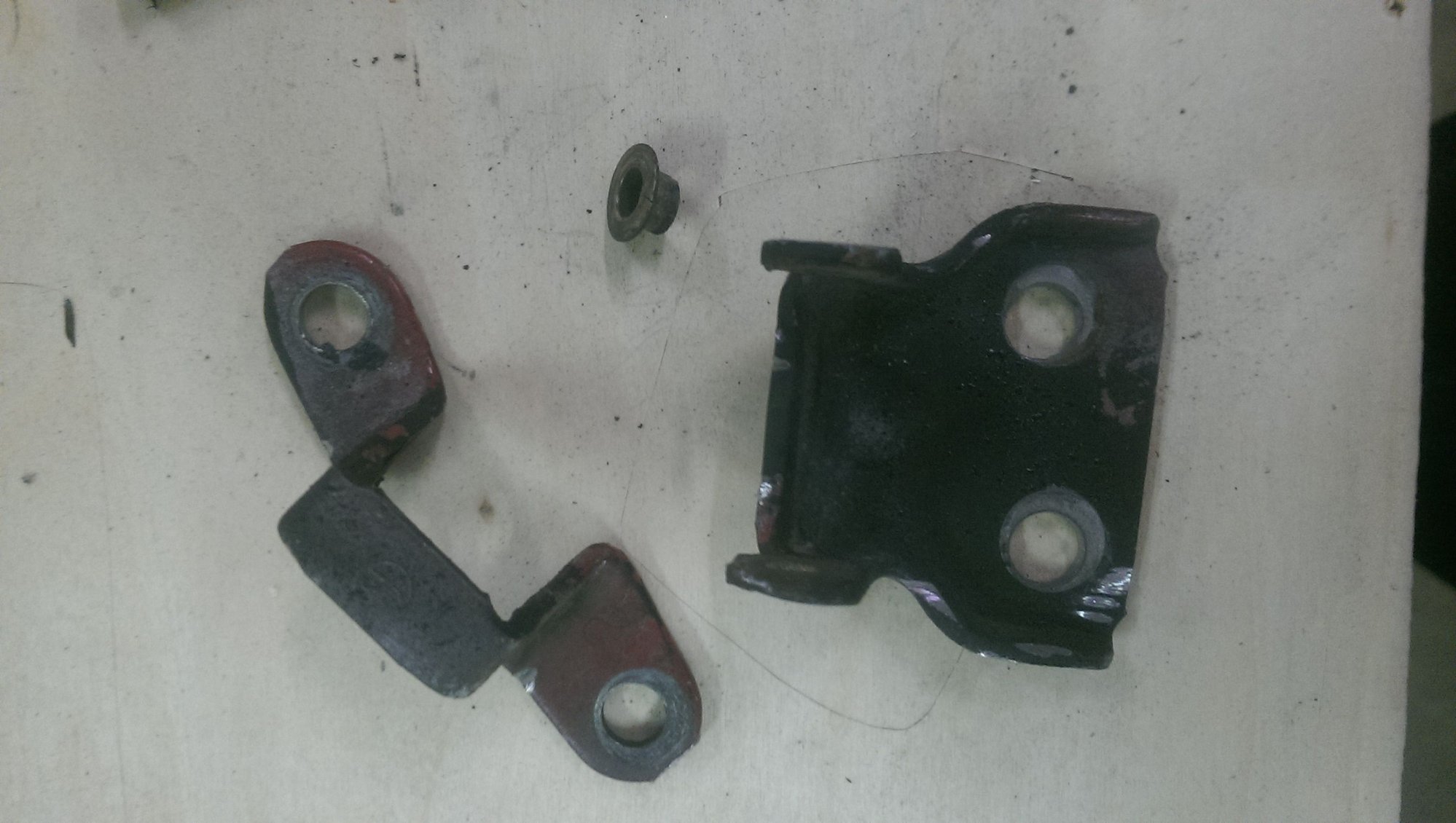

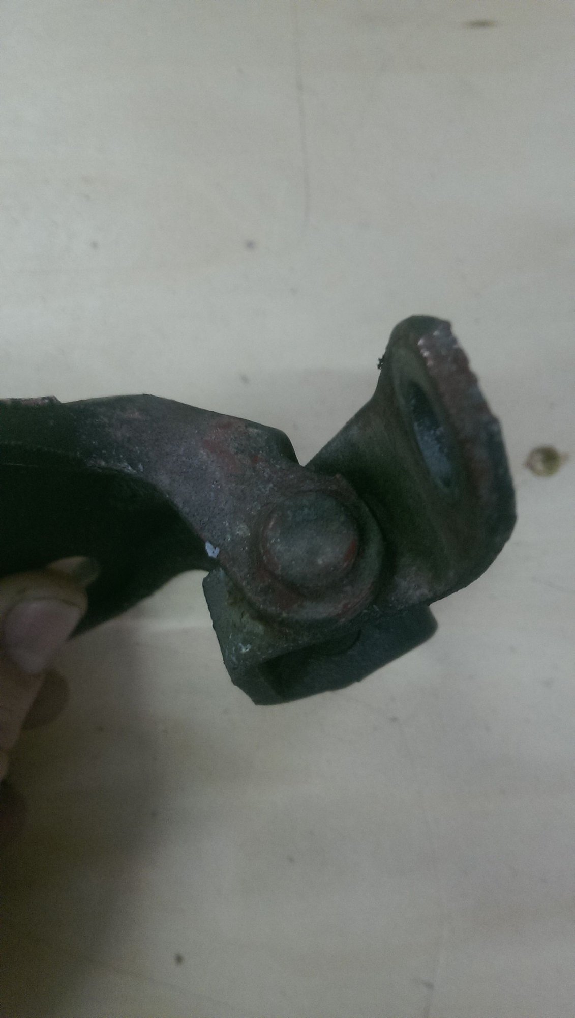

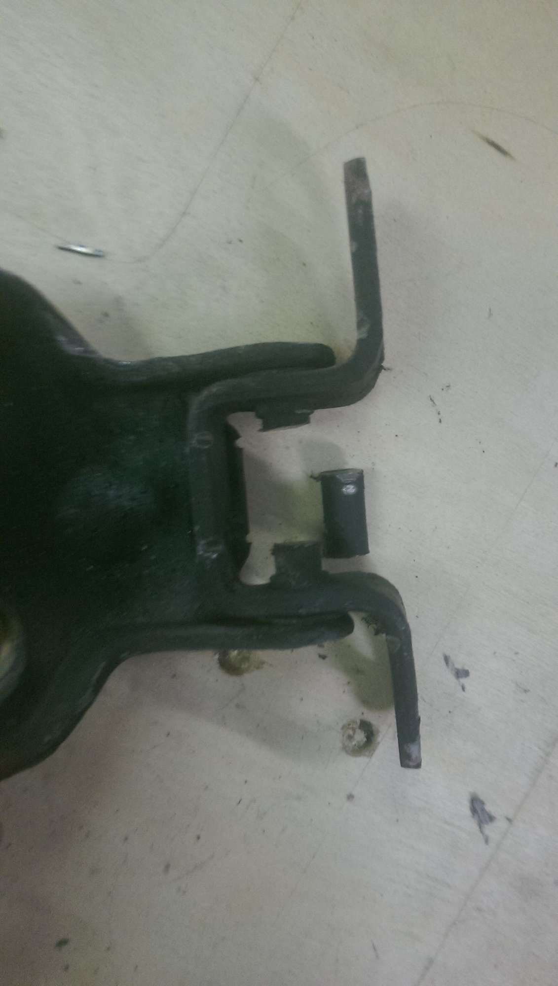

Before you even remove the hinges and get them all mixed up, it's EXTREMELY important to go ahead and label whether it's a Driver's/Passenger's side and upper/lower. I would suggest scribing or engraving a "DU" "DL" "PU" "PL" for Driver's Upper etc. into BOTH parts of the hinges as you pull them off. There are some very subtle differences in hole location and the way in which they mount to the doors, so it's a heck of a lot easier to keep everything together from the beginning. I did not and had the doors and each hinge on and off about 6-8 times trying to get them all matched back up correctly.

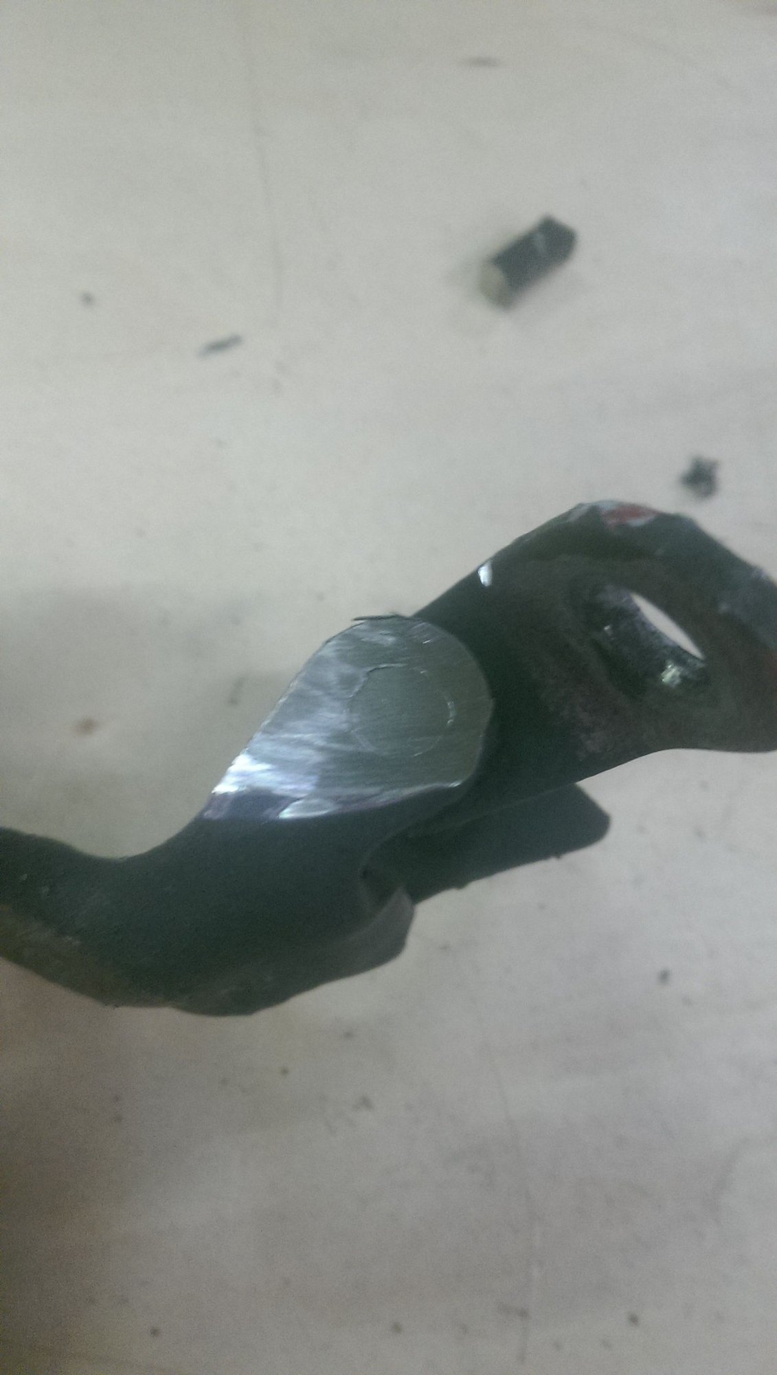

Having said that, start by grinding off the top and bottom cold riveted mushroom on the pin of the hinge.
Standard hinge
retaining mushroom that needs to be removed
ground off top starting to show the actual separation of the pin from the hinge
center section of the pin cut out to allow me to pound the heck out of it with a punch slightly easier. When using a punch and hammer to get what little short sections of the pin are left out of it, be careful not to distort / bend the bracket out of shape too badly (vise helps a lot)
two parts of the hinge separated
http://www.mcmaster.com/#2938t5/=13xrmvw

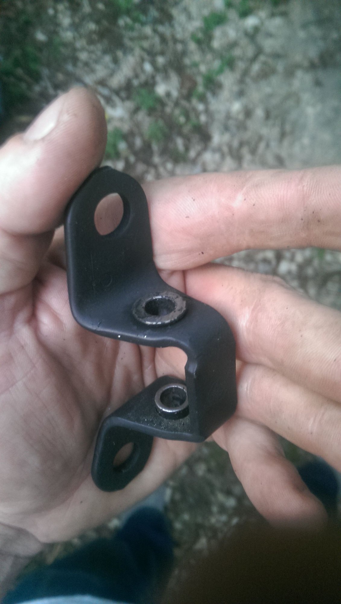

" />holes in the smaller bracket drilled out from stock to 7/16" to accommodate new stronger bushing/bearing McMaster part 2938T5 w/ 7/16" OD and 5/16" ID- ***DO NOT DRILL THE HINGE BRACKET THAT GOES TO THE BODY, JUST THE SECTION THAT GOES TO THE DOOR***
Hinges installed with 5/16" shaft Square security pin from Ace Hardware
These aren't quite as easy as some you may buy online, or anything that the Jeepsters do, but a nice cheap alternative to those things and a good little upgrade, especially if your doors are obviously starting to sag or the hinges are just completely worn out.

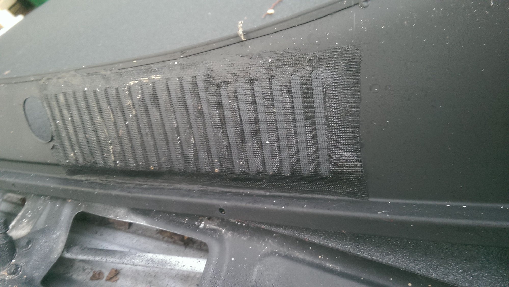

I also got really tired of pulling leaves out of the Cowl area as I was doing all of this. Obviously with the Cowl removed for the Raptor coating, I decided to get a small screen door repair kit and put some screen over the slots in the cowl where the leaves were falling through. I used a caulk gun and some standard Liquid nails and ran a small bead in between each of the openings and all the way around the outside of it (not TOO much as you don't want it squishing out into your screen, just enough to hold it). once the screen is cut and placed over the top, I just ran my fingers around each of the beads making sure the mesh was pressed down into the Liquid nails thoroughly in the center and all around the edges. I used the synthetic mesh because it was black, but I'm sure you could use the wire version if you wanted to and it might last a bit longer. (Sorry I didn't get any process shots) Then I painted the back flat black to match. Results Below.
quick look at what the bottom looked like finished up - you can see a few areas where I really pressed and squished the liquid nails into the mesh

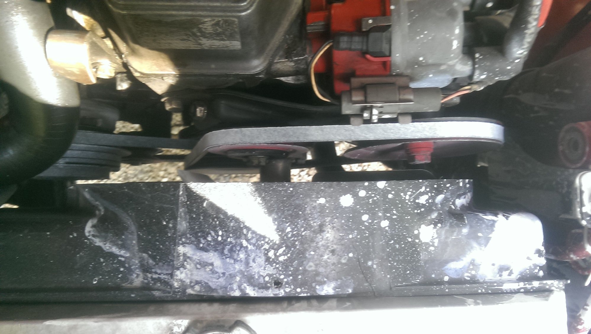

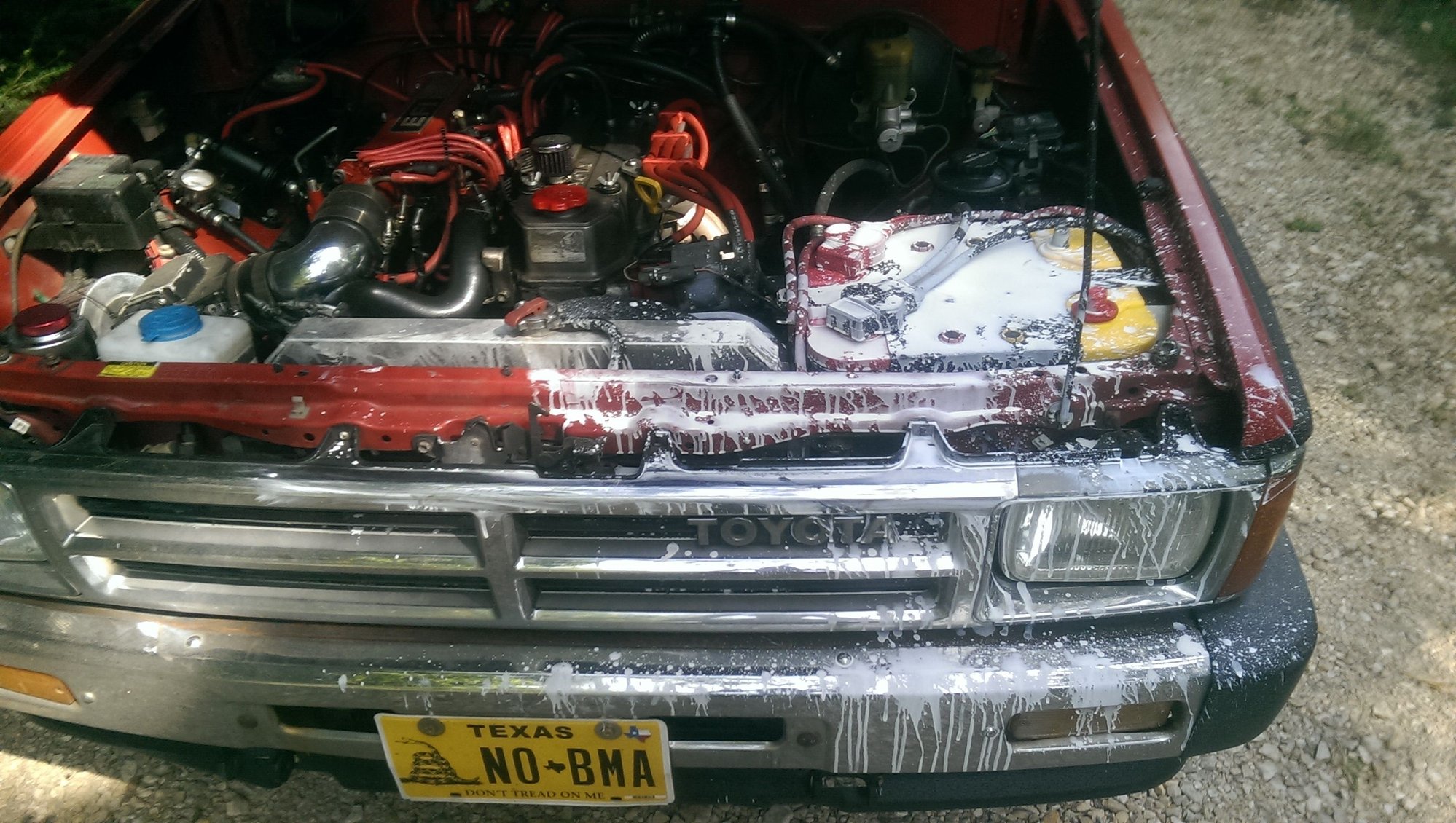

The white you're seeing is oxidized aluminum salts. The radiator flush I used to clean out the oil ate the radiator from the inside out until it finally ate through the lower portion and started spewing white powder all over the front suspension. I've heard of this happening from electrolysis when your motor isn't properly ground and the coolant becomes charged, but I've got a 2 ga ground from the battery to the block to the body, a braided ground from the radiator to the block, and another on the head. My Friday was determined by chemistry, and that stupid bottle of radiator flush slowly but surely eating away at the aluminum in my radiator. Going to order a nice brass 3row and eat ramen for three weeks.

Light alloys hate alkalis, while ferrous metals are largely unaffected.
Lucky that the head is made with thicker material cross-section than the flimsy chinese radiator.

flushed out the whole cooling system and literally pulled the thermostat and ran a water hose through the motor until it came out crystal clear. did the same to the heater lines (front and rear). Poured some OEM pink antifreeze and water mix back in and drove it to work this morning. My fear is that the corrosion might have eaten a pinhole in the bottom of the radiator. Basically I'm going to have to drive it this week like it is an just watch the temperature gauge like a hawk and keep filling it up everytime I stop. It's that, or pull the radiator out of the '86 and swap it in until I can order another one in. DEFINITELY going brass and copper on the next one.

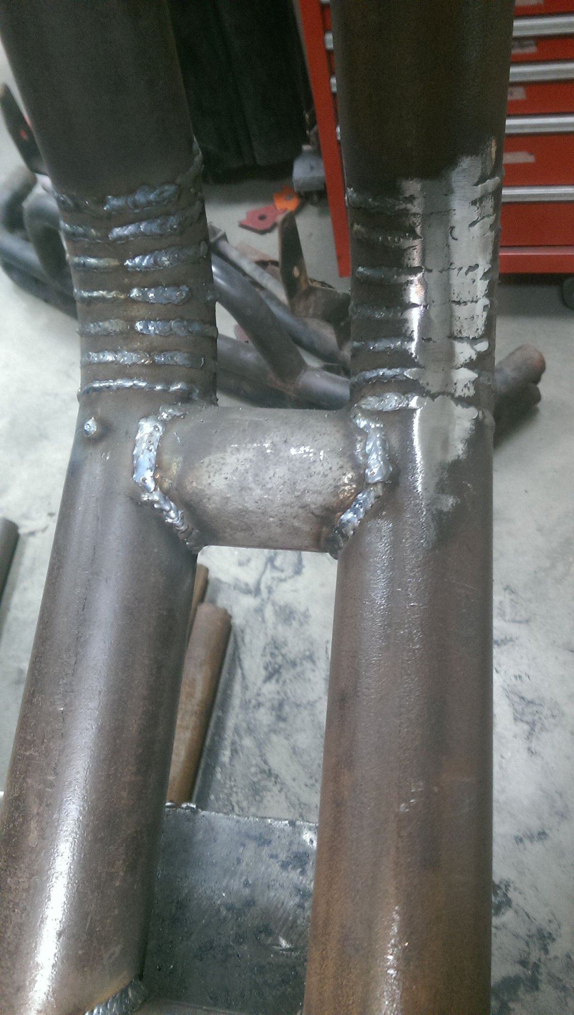

Swiss Cheese! however, the 1/2" plate brackets that slide into the frame rails and trailer hitch + Supports are solid, so I'll reuse those. The original bumpers were made for either/or the 4Runner or Pickups for the mass market and all of them had the license plate cutout. I don't need it on the 4Runner, so it'll get deleted and just be two bars going coast to coast. Haven't decided if I want to wrap the rear bumper around like the front does, but I'm sure I'll mock it up to see what that would look like.
I'm guessing Smittybilt used .075" or 14ga steel tubing for their original bumpers which isn't that thick especially when capped off with leaky plastic stoppers that end up trapping water inside the bumper and rusting it out. I'll be fully welding all of the tubing ends so it's completely closed off.
Front bumper doesn't look that bad in this pic, but it's toast. I do like how they used the front two body mounting points as extra mounting points.....going to have to steal that idea although mine will also have the winch plate that bolts to the four bolts in the front frame as well (where the hook and tow loop are currently mounted)

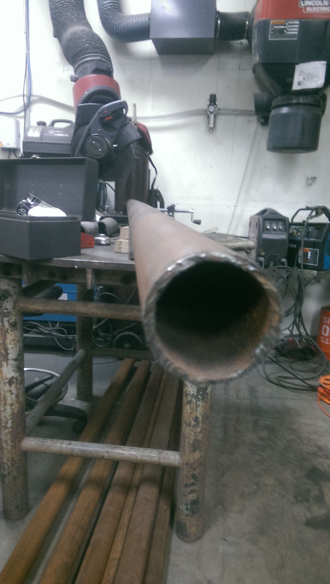

In contrast to Smittybilt's .075" tubing, I got 8 sticks of 8' oil well drill stem tubing that's roughly 5-6 gauge at almost 1/4" thick (.203-.220"). That should be enough for the front, rear, and nerf bars at only $50. Going to make some super beefy bumpers with the old school looks of the Smittybilts but with integrated LED blinkers and hawse fairlead.

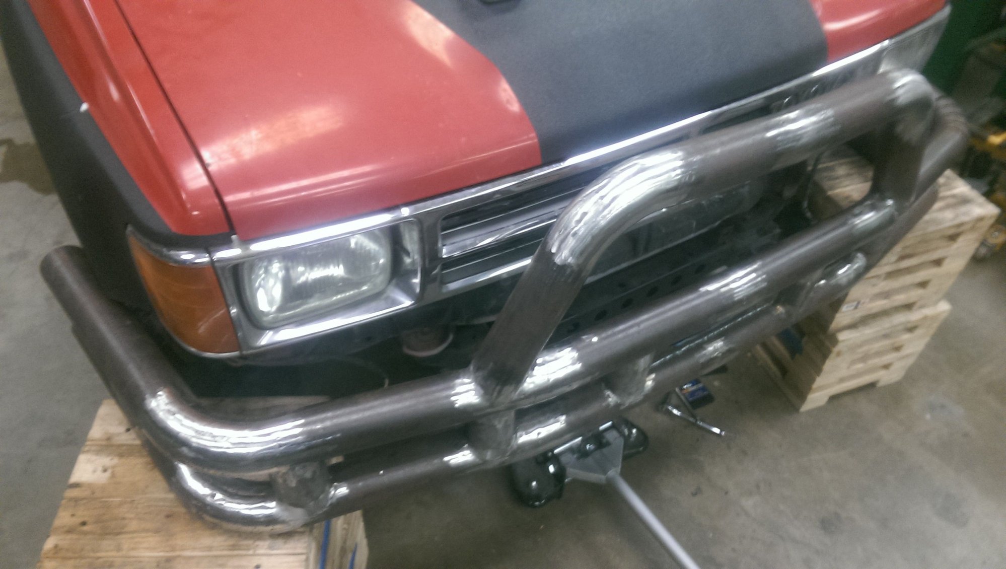

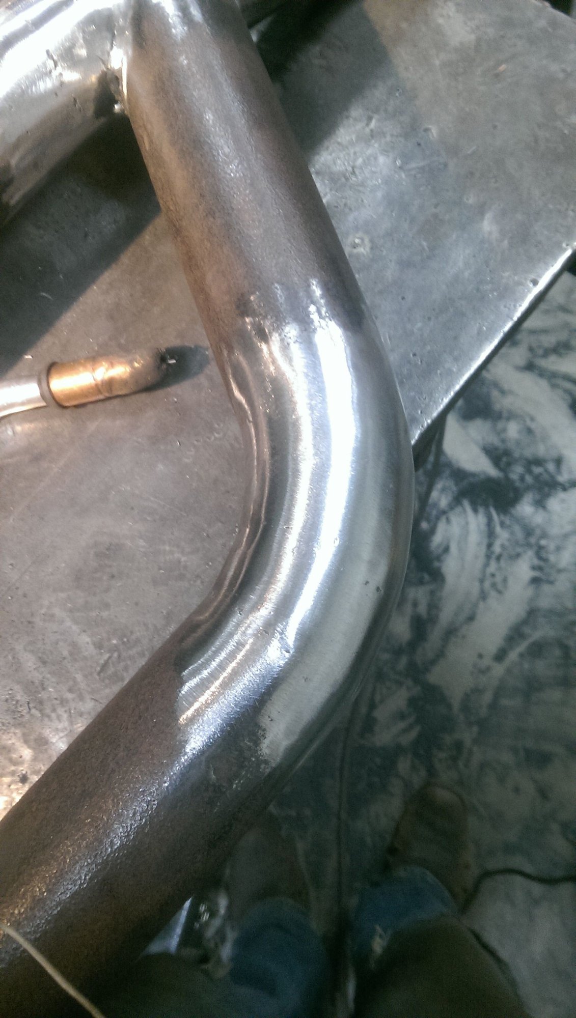

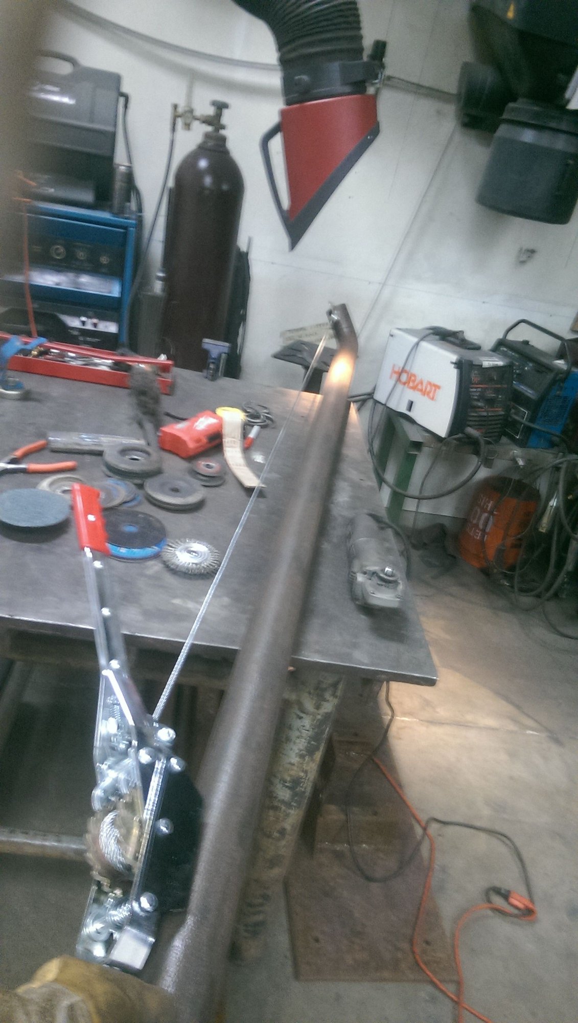

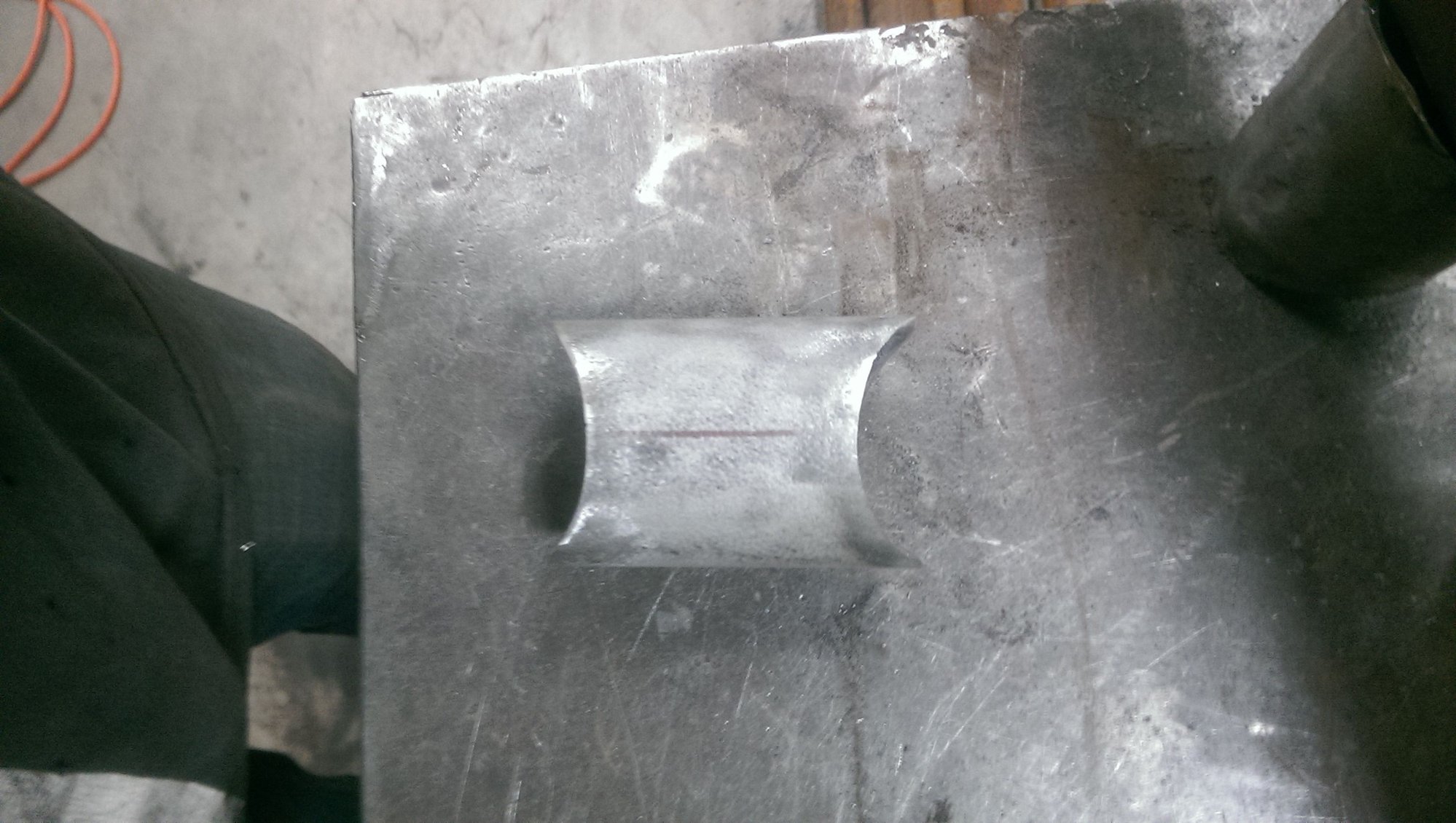

Hmmmm....how to get a nice bent radius on 1/4" wall 3" tube without the machine they use to build battle ships? Maybe cut out pie wedges and then use a come-a-long to hand winch it? Can't believe that actually worked.
My cute little double cove pieces - I made these a little longer (spreading the bars slightly more apart) than the original Smittybilt's because I needed the space for the blinkers and hawse fairlead to sit flush
Pie wedges measured out and ready to cut (just used a 5" grinder - I'm sure there are easier and more precise ways
nothing beats a sparks selfie
Cut and ready to roll.....or bend rather
Hooked up a 2 ton hand winch or come-a-long (we have a bunch laying around my office from some old project
Clickety-Clack Clickety-Clack!
Welded up.....don't be making fun of my welds.....haven't done it in a long time and it's a public owned (and very poorly taken care of) welder used by a ton of inexperienced people. A wise man once told me you either get good at welding or you get good at grinding.
Smoothed up.....looks much better. Once it's covered in bedliner, you'll never even know it was sliced

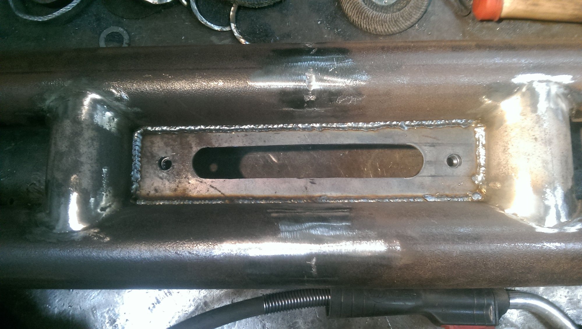

1/4" Plate with weld nuts for fairlead
not quite finished as I still have to weld on the tabs for the lights as well as the oval openings for the blinkers, then I'll have to fab up the winch plate and see how it will all fit and bolt up to the rig. Guessing since the '86 isn't insured, inspected, or running at the moment.....I'll probably have to remove the bumper from mine and mock it up that way. I'm hoping the rear bumper will be a little easier and shouldn't need a mockup.

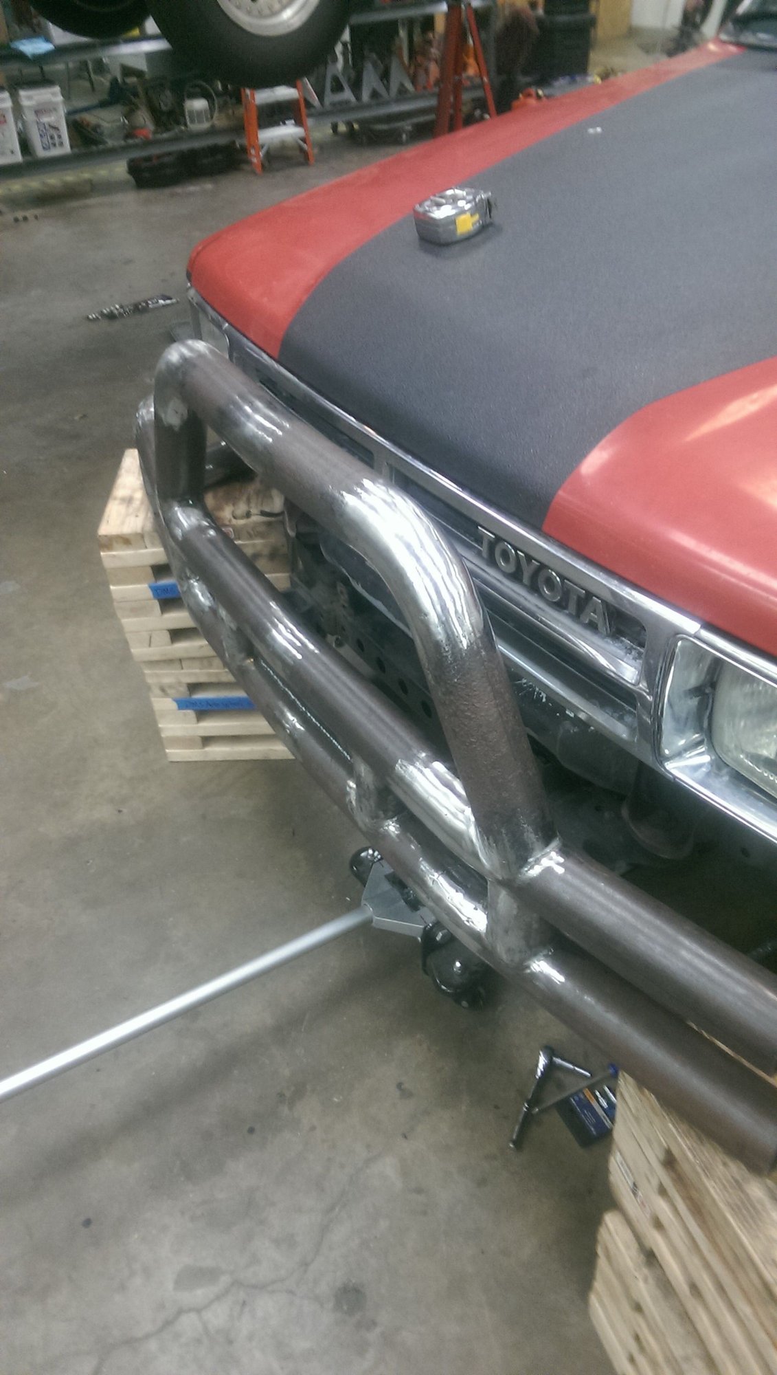

a little bit more done.....
Got to the shop last night after work and found the Mig Welder was out of wire (welcome to public shops) so couldn't do any of the welding I needed to. However, you can't let something like that stop you from being productive, so I decided to pull off the front bumper of my rig and try to mock up the new pipe bumper for the '86 to see how this bad boy was going to mount to the frame and what kind of bracket / winch plate I needed to fabricate. I got the bumper as tight as possible with a little wiggle room for the winch and made sure everything was even right to left and that the bumper was centered and started cutting out some cardboard templates.
I didn't have the right jacks to jack up the bumper in multiple spots to get everything level and even, so I had to rest it on these wooden blocks and jack up the front end until it was close (obviously this messes up the angle). When I go to do the final weld (tacking on the brackets in place), I think I'm going to hang the bumper from an overhead gantry with the now infamous red ratcheting straps so I can get everything perfectly aligned, level, centered, etc. Please ignore the cutouts on the right....that was the first (failed) attempt at bending and required way too much welding / cutting / piecing together.

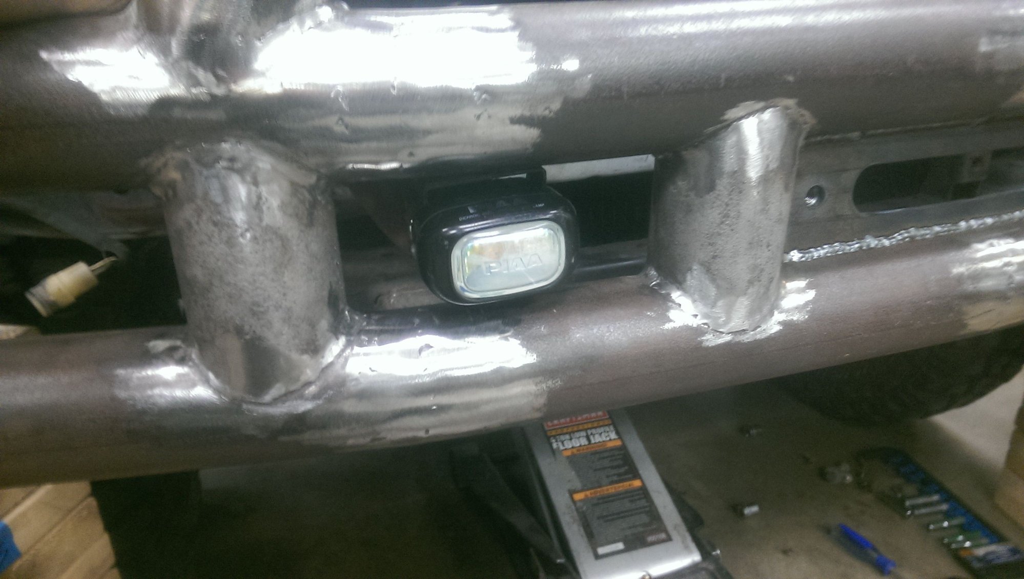

Despite my efforts to give it a few extra bends to allow a little more room for the winch, it's a little more forward than the original, but heck.....there's a winch in there!. Also, there will be a 1" tube support going from the lower winch plate bracket to the back of the vertical 3" tube over here on the side just to help support the weight and deflect impact (don't worry, it won't interfere with the tire as it will actually be in front of the inner fender or close to it)

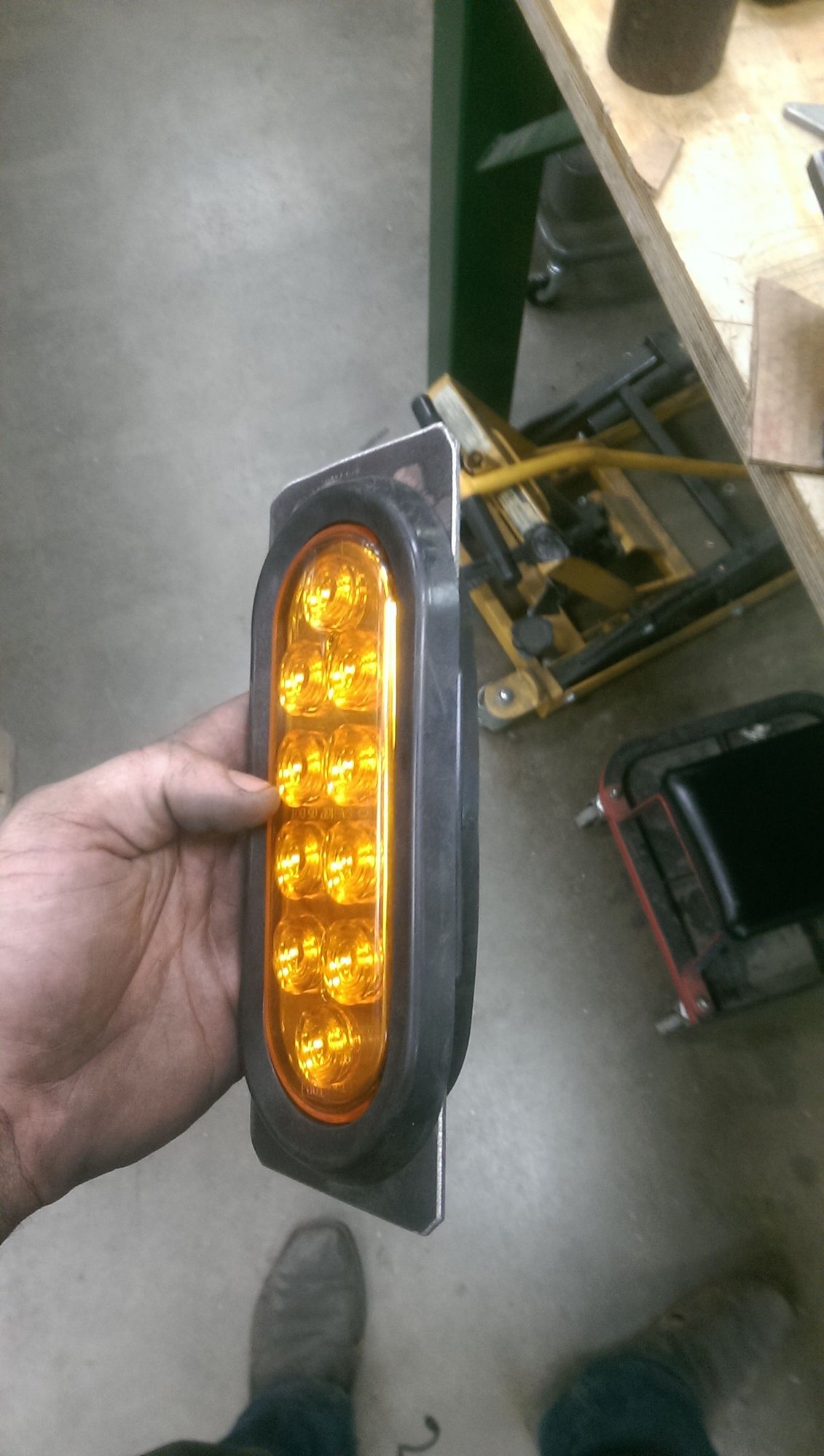

I also widened the gap between the two bars from the original (in order to fit the blinkers and lights in - went with 2 1/4" in between bars versus the 1" or so originally), and was surprised to see that it's still up above the front of the frame. Not sure if I'll try to fit the valence back on as I think it looks better with more clearance. Might need a skid plate fabbed up though.
Sorry I didn't get any pictures of the cardboard templates I cut, trimmed, drilled, finalized, and then translated over to the metal, but that's how I figured out the brackets. Here is my "impromptu" design for the front winch plate that will be welded directly to the bumper. 28" wide, 1/2" bottom "C" shaped bracket rides below the front frame and bolts to the same holes that the original hooks bolted to (could even re-use the hooks if I got longer hardware). vertical plate mimics the "front frame re-enforcement plates" (shown with all the holes already cut out) you can buy and will bolt to the one I weld to the front of the frame (one was given to me by a buddy). Curved front piece rides on top of the vertical and slides 1/2" or so over the top of the front lower frame. Winch mounts to this via the 4 holes (already drilled) and it'll get welded almost centered on the lower tube of the bumper.
Quick little cutout piece for the LED gasket mounted blinkers to fit into
These will get welded in right here on both sides. I'm planning 4 for the back.....2 red tail light / blinkers and 2 white extra bright backup lights

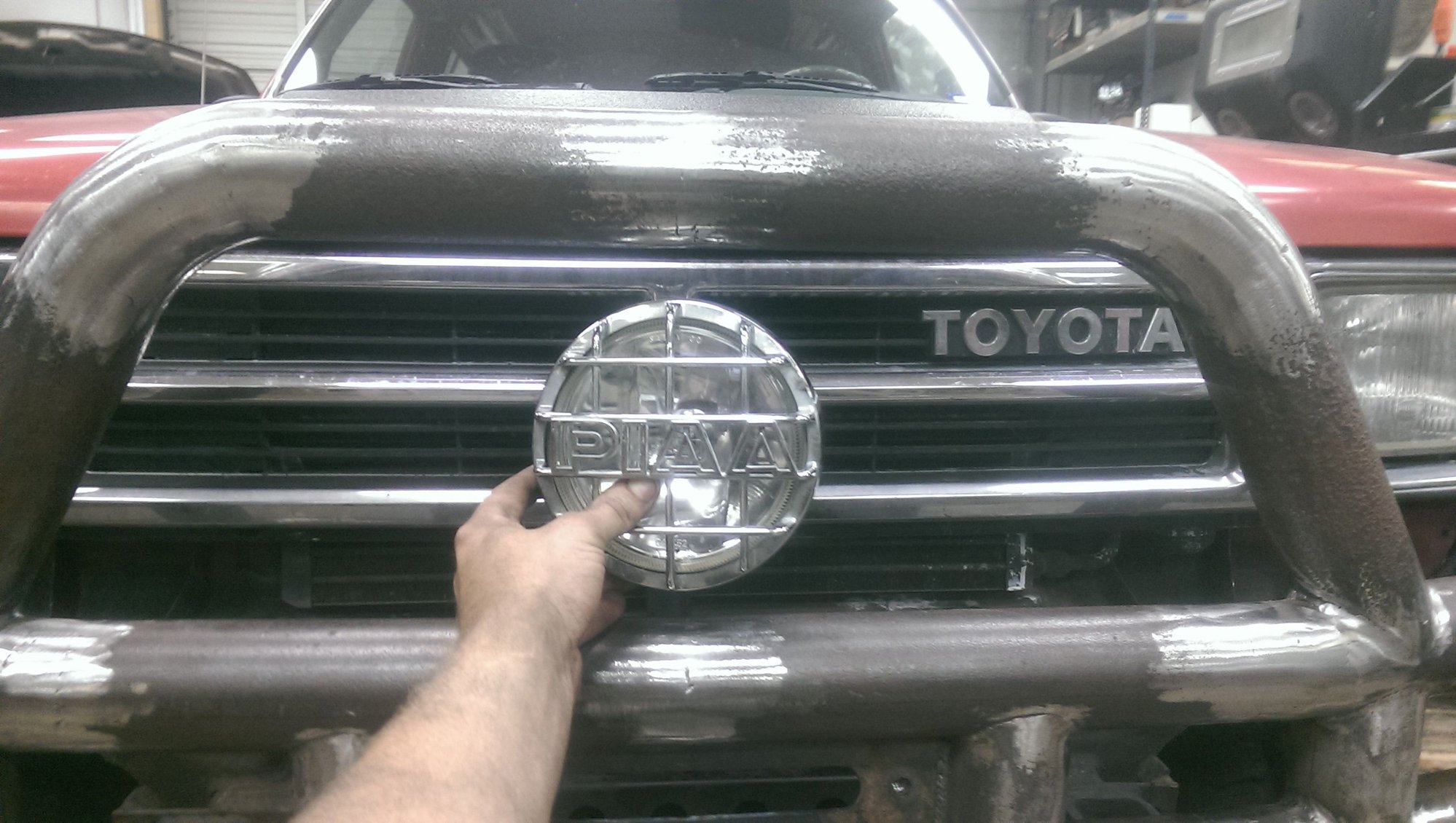

Just to show you how tight the winch is under the grille at the height it'll be mounted to the plate (and to show it fits)
I'll do 3 of these 6" lights across the front (bought 4 for cheap off ebay - will leave one with the rig for an extra bulb / lens). Before anyone tells me to go with an LED bar, suck it....it's a 30 year old vehicle....I'm going old school kool.
And here's where I'll let you guys vote on which lights should go here......I like the oval ones and may put the fog lights below the winch plate underneath. The oval ones show above are projection driving lights (invented by PIAA) and now incorporated into most modern headlights and really throw light far out there . I'll probably wire these up with a switch that they can be "on", "off", or "on with high beams"
These are the projection ionic fog lights and they could go in this opening as well. I'll let you guys decide.

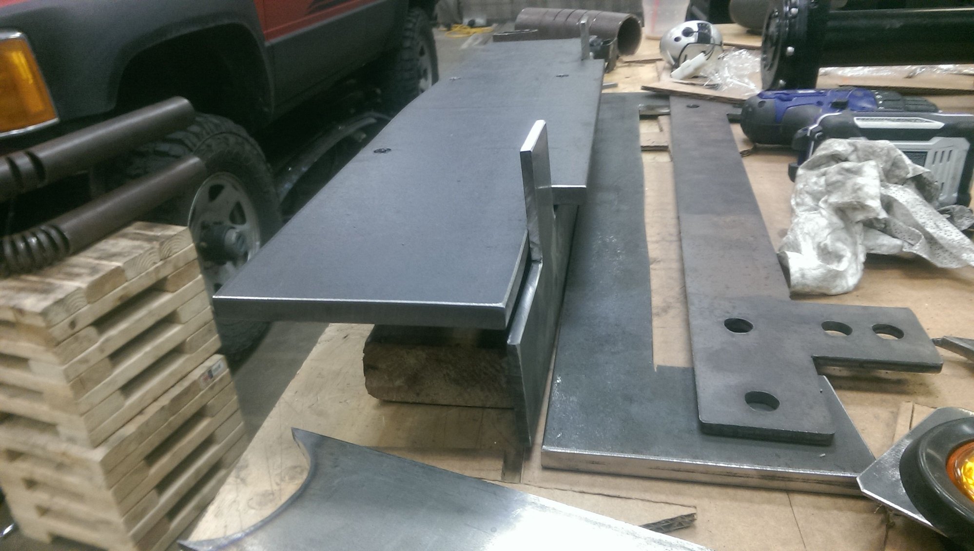

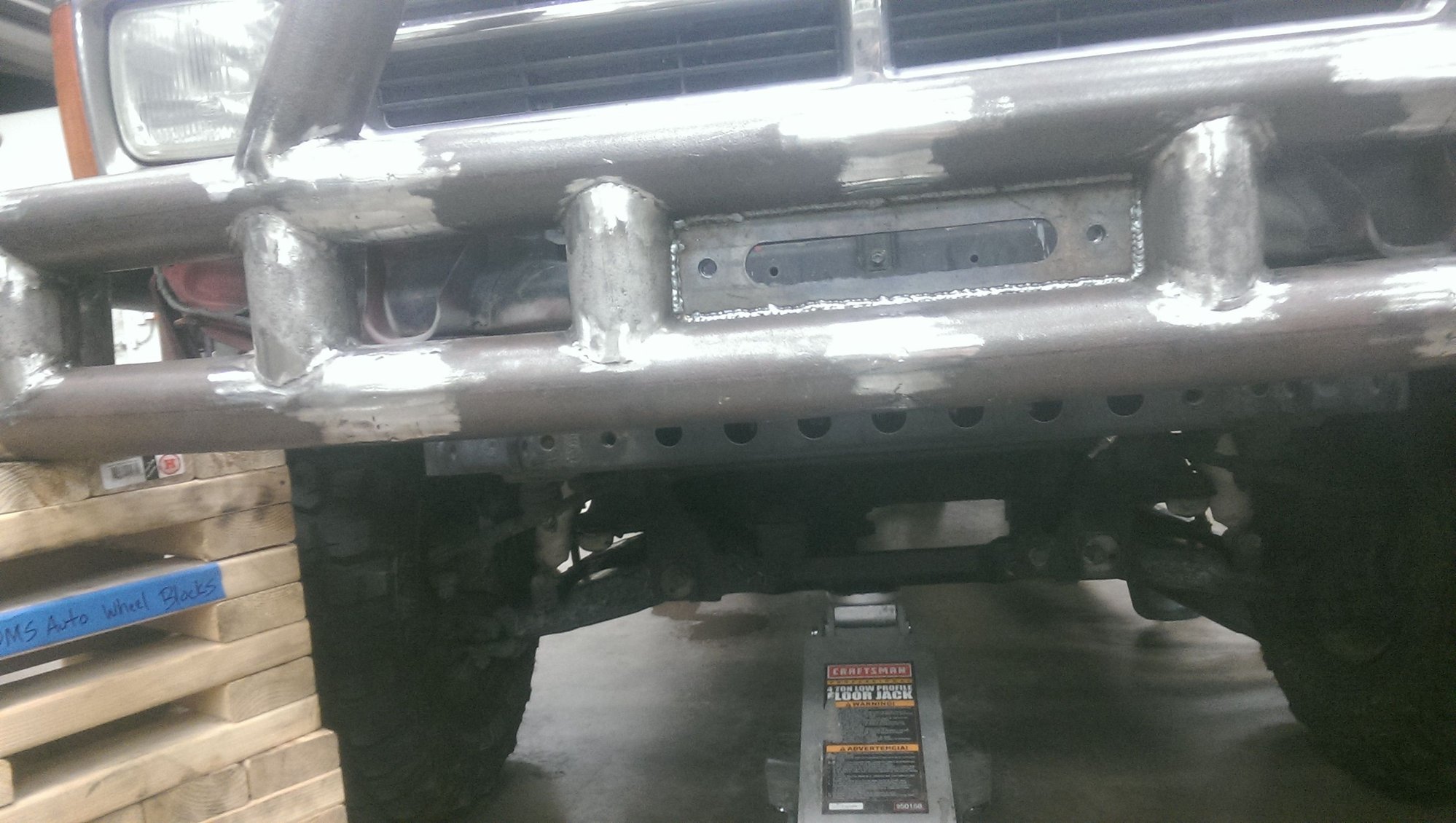

Got the Winch Plate / bumper mount welded up last night and man it's beefy. Like Arby's 5 for $5 on 1/2" plate steel beefy. Also got the other side of the bumper bends cleaned up and finished and ready for end caps (a friend of mine convinced me that if I wanted it to look "Finished" that I had to buy the 2 7/8" fence post weld on rounded caps, and so I ordered some at $1 a piece to be in by the weekend). Blinker plates are welded in as well and the only other thing I'll need to do is weld some simple light mounting tabs on soooooo.....minus a few holes to drill in some mounting supports, everything should be ready to mock up and weld in place.
Oftentimes, I like to start with the hardest things first , so the rest is downhill. The front bumper was definitely the hardest, and the Rear bumper should go fairly quickly as I'll be re-using the original frame rails and trailer hitch an simply welding on new tubes, probably only with a slight bend at the ends like the original Smittybilt. I had thought about trying to bend them 90 degrees and continue down the sides stopping at the fender well like the front does, but I'm not sure if that would just look stupid, or actually look decent. I may mock it up just to see.
Nerf bars should also go much quicker as they will just end in a 1/4" plate with 4 holes that will bolt through the frame rails.....nothing fancy at all.
