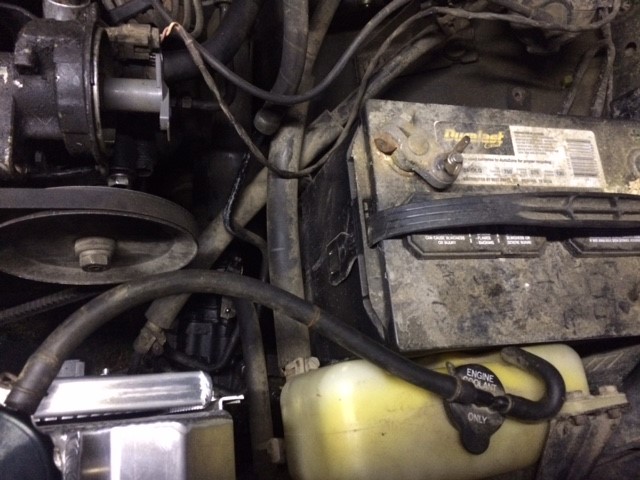

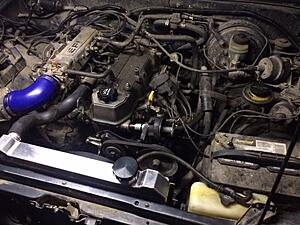

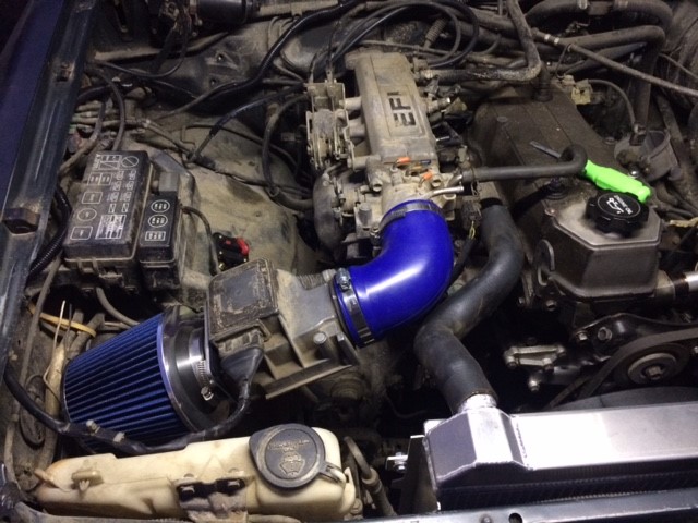

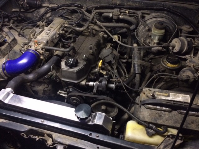

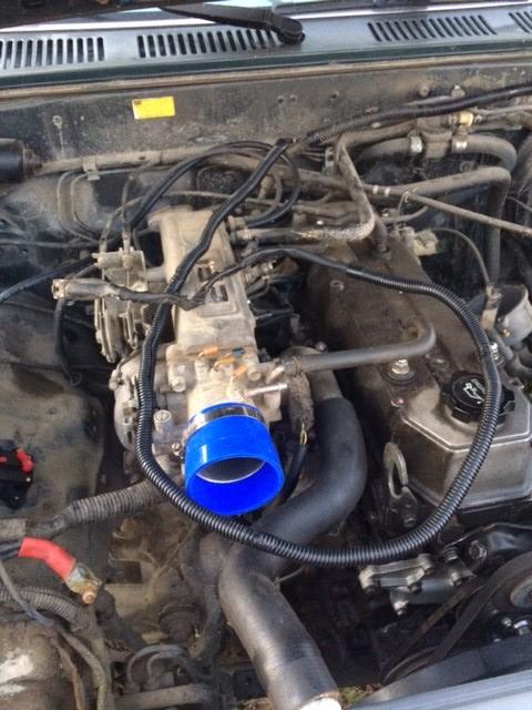

like I posted, I didn't have to cut and extend the wiring to move the AFM to the passenger side, I was able to separate the harness from the loom and reroute it. picked up some 3/8" split loom and spiral taped the wires up, came out pretty good and there is definitely enough harness to reroute.
just a simple elbow and a cone filter with an adapter is needed

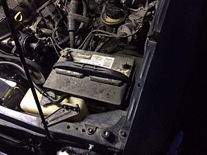

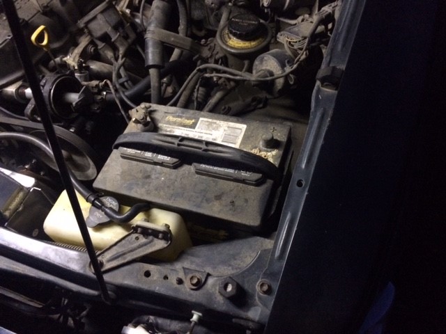

I need to build a battery tray but test fitting the battery in the driver side

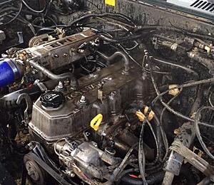

ya I know my distributor is hangin out lol

Very cool! Thanks for the great pics. I will definitely be doing this once I get a few other half finished projects done, and track down an appropriate elbow for this.

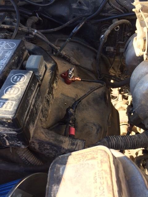

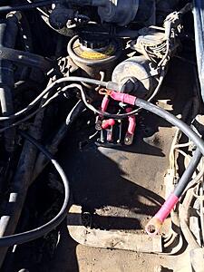

finished building the battery cables, mounted the circuit breaker, mounted a power junction on the passenger side. It is tempting to yank the engine just to be able to clean the engine bay lol.

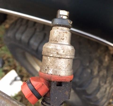

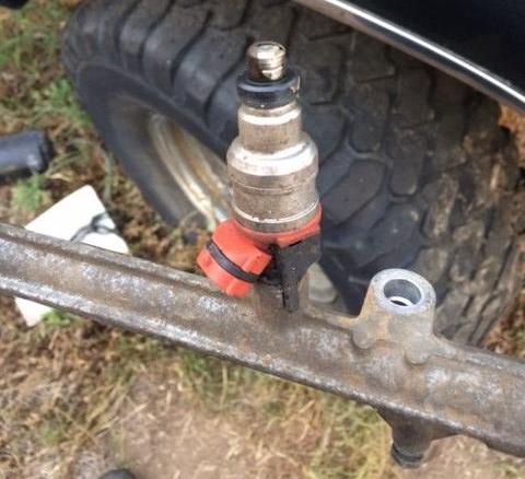

My new(ish) lower intake will be here this week so Saturday I went out and started tearing that side apart, when I was removing the injectors I made sure to twist them so they were free moving and there was no resistance in them. I pulled the rail and they all came out of the intake easily, but number 2 came out like this. surprisingly it wasn't leaking.

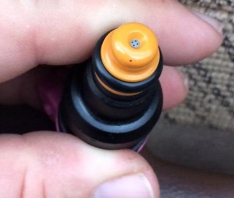

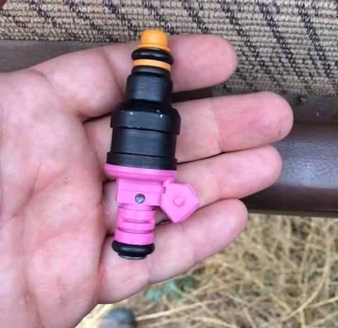

My new 4 hole injectors showed up yesterday, glad I had already planned on replacing them. My pink injectors lol

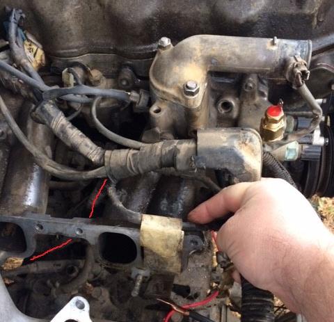

I would like to kick a Toyota engineer in the nuts that thought this up. lets run a 13 wire harness through the middle of the intake manifold so it cant be removed with stripping 8 feet of harness out. well i am gonna cut the manifold between these 2 bolt holes.

Yesterday I was able to get the new-new injectors put it, the pink ones I ordered would not fit even though the ad said they would. So I ordered a different set, 4 hole, and these ones went right in. got the rest of the intake put back together, block heater installed, filled with coolant, pitman arm installed, oil changed. It fires right up, drove it around the driveway, BUT the idle is drastically jumping from 1500-2000 RPM, while sitting I give it throttle and it just bogs down and will not build rpm's, unplug the TPS and the rpm's shoot up to redline. the other week when I had it running (and leaking coolant) the rpm's were fine and had throttle response but I realized I had not hooked the coolant lines up to the IACV, I am going to bypass the IAC again and see if it fixes the problem.
