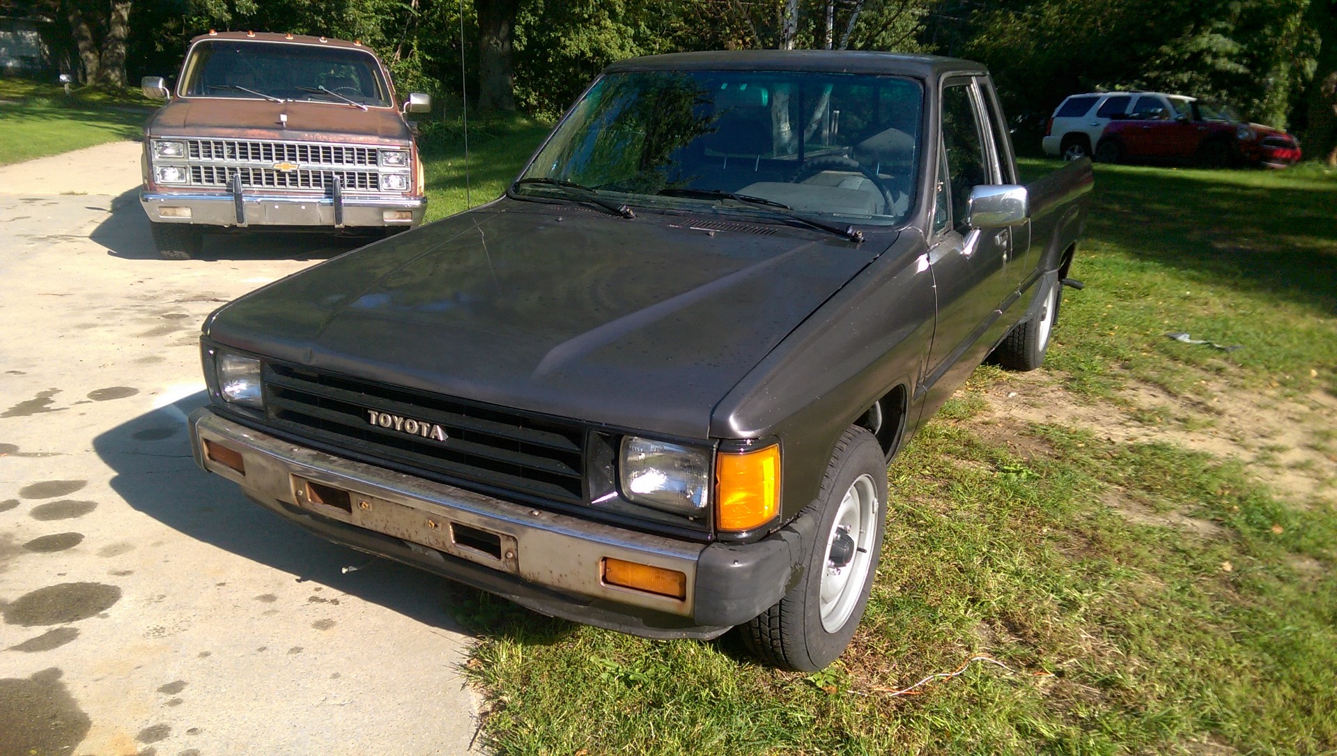

Thankfully this is not my first time working on a Toyota pickup, I have an 87 pickup that I was driving but it was very rusty and was in an accident. I do have a Weber carb, I installed it on my other truck. But I think I will keep the stock carb on this truck because the PO installed a rebuilt carb and it seems to run fine. As far as the transmission I have another W55 to put it this truck that came from my parts truck, so I already have that taken care of. But thank you for the advice. Here is a picture of the 2 trucks side by side.
