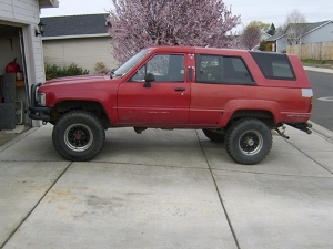

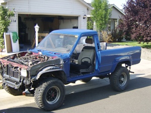

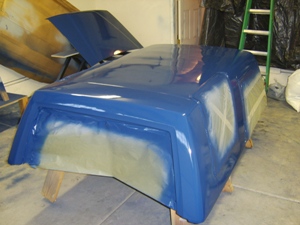

Hey y/t,
i had posted about a month or so ago, saying i was going to paint my runner, well the time has come...here are the pics (so it did happen) she treated me good as a redhead, lets hope the new face lift will pay off in the end...with out further ado, i present, My blue baby!!!! (original 85 pickup color!) let me know what you guys and gals think!

I think the tops were never smooth nor painted blue....
But at least you opted to do it right the first time! Most people paint the outside sheet metal and it looks terrible! Good job

nice. blue beats red anyday

This is correct, i could not let myself paint the rough top, thought it would look better smooth, thanks

this is a single stage with "ultimate wet look" hardner and reducer mixed in. The base clear was twice the cost and i still want to be able to take it out and scratch it with out having a heart attack. I had 2 issues, first i had some seperation of the paint on a couple of small spot, i think due to oil from the hands or something, still have not quite figured it out, and second, i started to paint when it was about 79 degrees around 10 am, so i got a couple of runs since my reducer was for 85+, im okay with it, i might fix it but it is a trail truck (or in the process anyway) this was my first paint job, and with the help of a buddy of mine, i have learned alot about painting a truck. (we did his 88) i posted these from work so i will try to figure out the best way to post bigger ones for you guys tonight,

if you have some separation issues it could be from oil or some type of chemical residue left behind from a dirty rag (sometimes you can't see it's dirty with your eyes). Make sure you sand after primer with 320'ish sand paper, then take tack cloth and clean the surface right before you shoot it to remove any oil, finger prints or chemicals that could be there that you can't see. then shoot. It's always important you use brand new rags and cloth when you paint, not something laying around the garage that could have armoral or something on it. Even thought it's a trail truck that will get scratched it's always nice to know how to do it right and get good results. Congrats!

Thanks for the info, we did wet sand with a 400 after we stripped the rig and after primer, also used those blue shop paper towls and some of this degreser the paint shop reccomeded, but it does in fact sound like some sort of oil that made its way back on, i will be painting another toyota some day and all of this has been a great experience, again thanks for the info...

The red..it filters thru..
