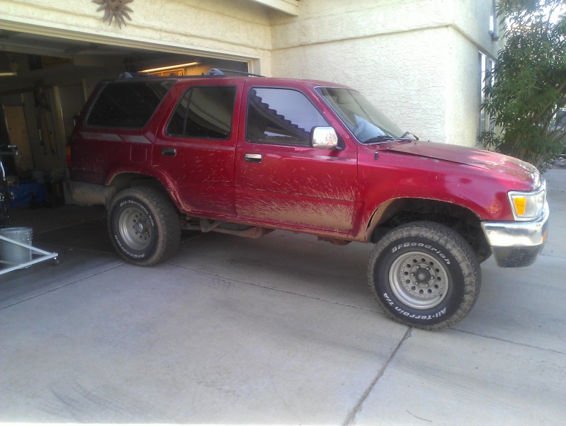

​The rig:1994 4runner 5speed with the 3.0 vze.
all factory with no mods or major upgrades found. Windows are sluggish if working radio installed incorrectly. I belive its had the replacement recalled engine work. Heads? I can't remeber, but entered my vin, it showed that I didn't me needing it but I'm. Not really sure.

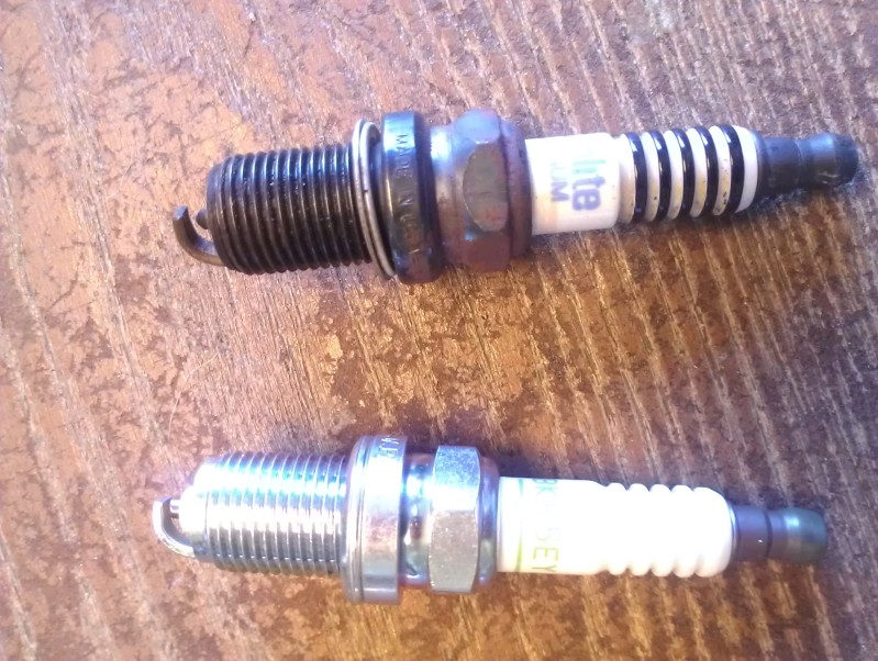

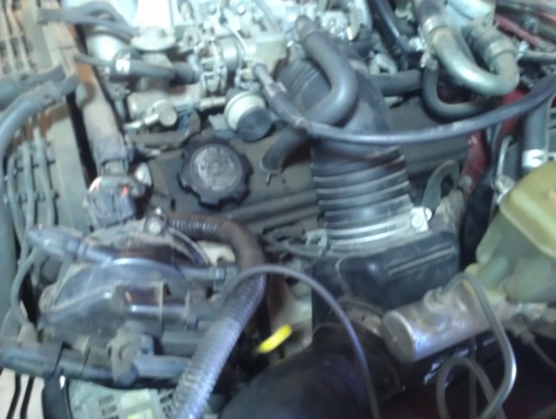

first thing I did was a tune up. New plugs, filters and basic fluids. Found out the window washer res had missing parts when a half gallon of fluid poured onto garage floor.... :-)
pulling plugs
not to bad.

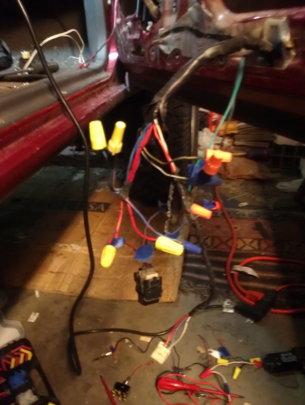

strange mess of wires found in passenger door window switch not working. Speaker falling off door and panel has lots of damage. Ac is ok so no worries.

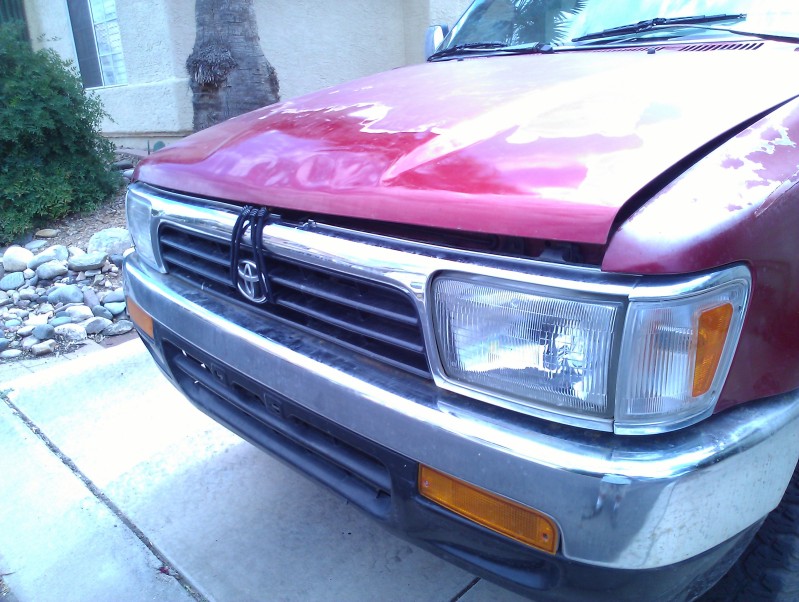

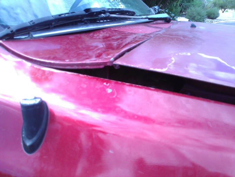

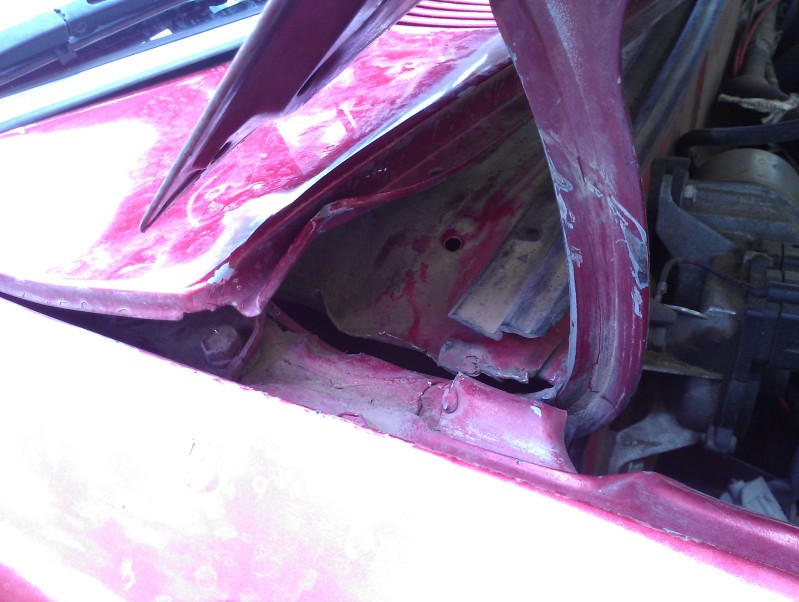

I was driving home after my inspection and my hood latch disengaged and the back up failed. It didn't break window thank god, I had just put it into 3 rd gear. More work to do.
the cowel looks ok but under it looks like part of the horizontal metal for panel that the hood bracket bolts into is cut too hell., I lost some bolts too. Going to u pull it this weekend.
solved for now

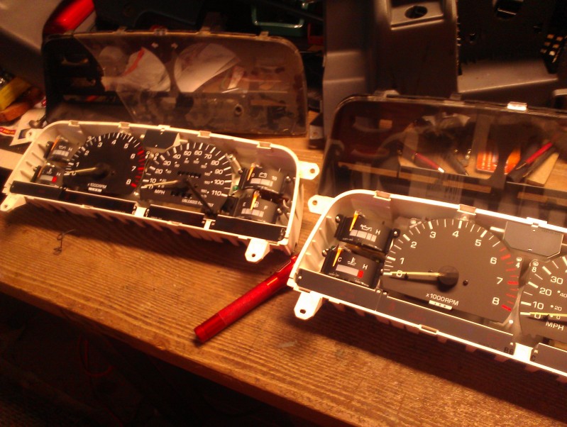

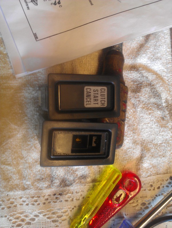

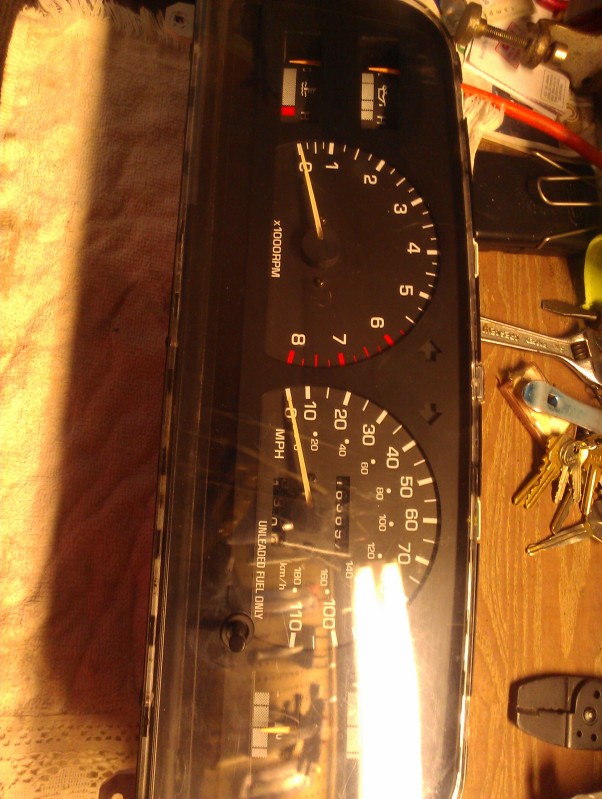

So none of the interior lights or dashlights were working. The gauges did work for the most part, but the plastic covering the instrument cluster is broken and the cluster itsself is full of dust and dirt. Also the switch on left side of steering column is broken and function is unknown.
I went out to the you pull it and scored a new instrument cluster and a found a clutch start cancel switch that I belive is the unknown broken switch. I didn't even know what that switch did at that time.
I grabbed other switches. I got 2 window switches because the windows are a big issue. My wife won't drive with me untill I can get her window to roll up and down. I rigged up a toggle and it worked but not well and that's for another post
Here is the new cluster. Removing this was very intimidating. I followed this post https://www.yotatech.com/forums/f126...4runner-75768/ and got lots of tips from reading and searching through YT. I reused a bunch of the green covers for the mini lights and was able to get all bulbs working. I also used my new electrical diagnostic tools, still learning btw, and I checked all the resistance and stuff like the FSM says by measuring and using the check points on the back. It was great to learn and understand. One of the things that is not working is the temp gauge. Doing this test confirmed to me that the cluster gauge works so the problem must be downstream for this.
I'll continue. I got clear covers off and I swapped the broken one out. Top left of photo u can see the cracked one. While in there I cleaned all the collected dust. I really feel like I got lucky finding this and swapping over.
that looks so much better. It wasn't new, but this is an improvement to the missing chunk of plastic one.

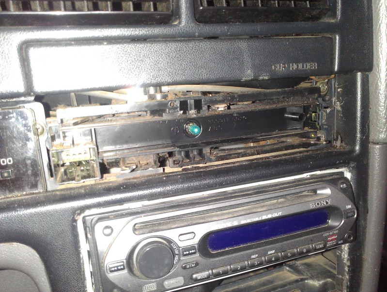

here is the back light bulb for environmental controls. Name:  IMAG1279.jpg

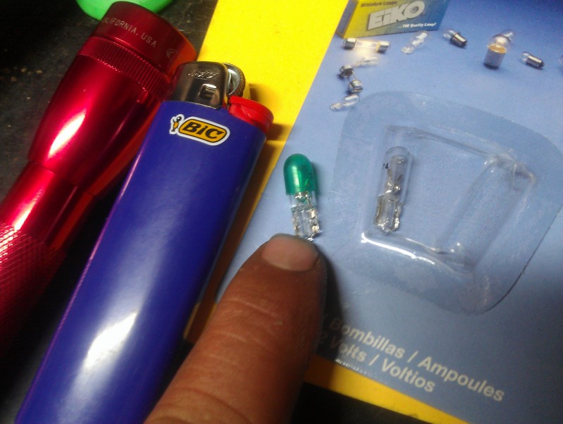

tHis bulb is crazy small. I was super carful with the bulb condom.Name:  IMAG1278.jpg

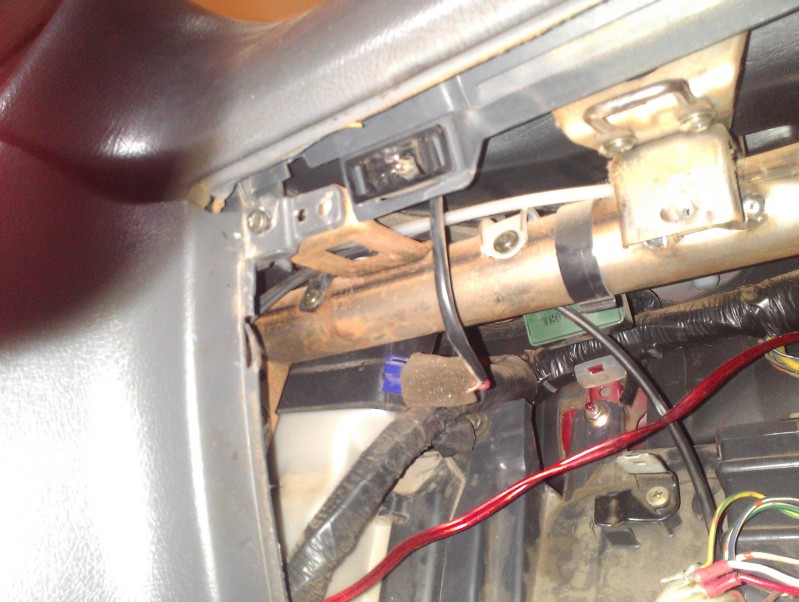

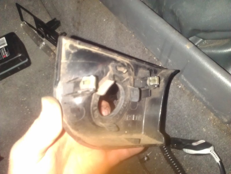

I guess I didn't get a light in my ignition. Name:  IMAG1315.jpg
