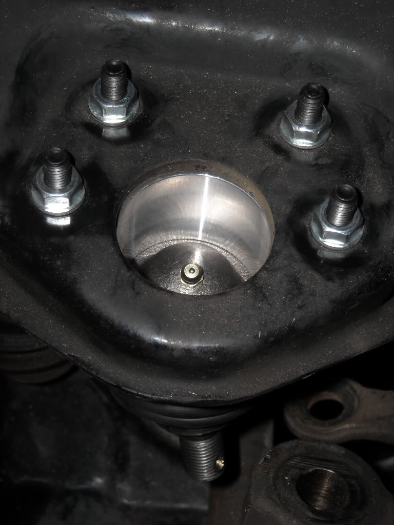

I had 4 crawler 1.5 inch ball joint spacers and I could easily grease the upper ball joint through the bj spacer.... Where did they put the grease fitting on there? It should be dead center right on the top.
The fitting comes off the top at an angle, and points right in to the inner wall of the spacer.
Maybe there's a way to get a fitting on there. I haven't actually tried, but it looks pretty impossible.

Interesting..... These are made by Sankei 555/ Machined by Downey for more travel, but as far as I remember the 555 series are pretty close to identical. That's really tripping me out... I had to look for a little bit but here's a picture of how mine looked.......
