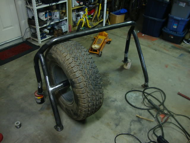

This is the approach I plan on taking... I just need to find some scrap steel tube.
https://www.yotatech.com/forums/f88/...nd-gen-202242/
