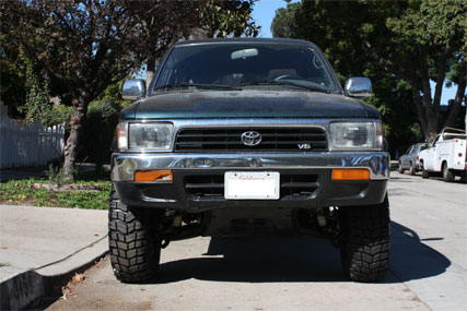

pics with new tires
got my xterrains and intake installed. woo hoo.
Attached Thumbnails NYChopshop's 1994 4Runner Build-Up Thread-ximg_4159.jpg   NYChopshop's 1994 4Runner Build-Up Thread-ximg_4171.jpg   NYChopshop's 1994 4Runner Build-Up Thread-ximg_4178.jpg

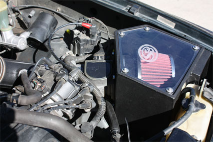

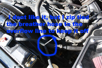

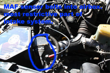

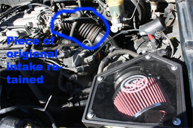

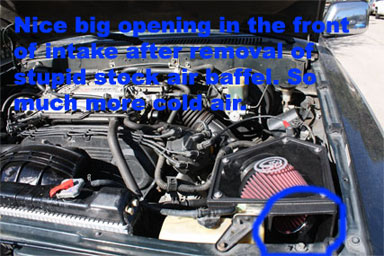

Intake install 1/2
The install for this was a little bit of a pain because of the air flow sensor. I had to tear out the intake (previous owner had put a cheapo pvc pipe between the MAF sensor and the intake manifold doing all of nothing for the truck) and remove the sensor. I then installed the sensor in the S&B intake box, bolted that in, and replaced all the hoses. Everything I need was installed - okay thats a lie, my box shipped a few parts short, but it SHOULD have. The problem was quickly rectified by the intake company, so no harm no foul. All of the hose extensions and even a zip tie. The best part of this intake is that it removes the stupid restrictive airbox and the matching cold air baffle that directs what little cold air the 3.slow already gets. This intake sounds great. Adds a whole new level of ballsy grunt on the throttle, and I get 3mpg improvement over the stock filthy filter. I got 16, I now get 19. LA traffic ridden highway miles. I can feel some real world horsepower, but I really feel that my truck can actually breathe at highway speed and at RPMs over 3k which felt restricted before. I highly recommend this specific intake to anyone with this engine due to our stupidly designed air flow sensor which must be retained in order to use an intake like this.
Attached Thumbnails NYChopshop's 1994 4Runner Build-Up Thread-wimg_4163.jpg   NYChopshop's 1994 4Runner Build-Up Thread-wimg_4165.jpg   NYChopshop's 1994 4Runner Build-Up Thread-wimg_4166.jpg

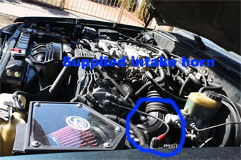

S&B intake install 2/2
More pics of the installed intake
Attached Thumbnails NYChopshop's 1994 4Runner Build-Up Thread-wimg_4168.jpg   NYChopshop's 1994 4Runner Build-Up Thread-wimg_4169.jpg   NYChopshop's 1994 4Runner Build-Up Thread-wimg_4170.jpg

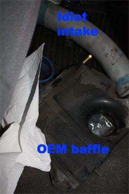

parts ripped out during install
This is the idiot tube made of pvc the previous owner seemed to think would improve performance by a billion times im sure. Also removed was the stupid OEM baffle that restricts the air going in to the nice fat new intake hole in the S&B airbox. The S&B filter is an oiled element but unlike K&N's elemets, its has a very fine particulate filtering capability. The problem with K&Ns are that the filters allow big chunks of dust etc into the combustion chamber, damaging everything moving, especially things like piston rings. S&B explains all about the particle filtering as well as providing downloadable pdf files with the installation instructions. Good thing too, as they dont include instructions with their kits!
http://www.sbfilters.com/
EDIT: Over the last better part of a year I have learned that my so-called 'idiot intake' was the ISR mod. It seemed pretty crappy to me at the time, but seeing the resonator box that was there from the factory, I assume it did a world of good. I can now say, however, that the S&B intake rocks the ISR mod in just about every way but price!

That S&B Kit is $200 though...is it worth it when I could spend a little more and buy headers or something really worthy of HP upgrades?
It literally just looks like it plugs into the stock intake you are only replacing the box/elbow piece and the actual filter box.

In regards to the air filter, I'd say that because of the considerations of the cold air routing, the hose rerouting, and the way the 3.0l air flow sensor is designed, its totally worth the money in my opinion. I have a magnaflow-based exhaust (sure aint mandrel bent, but it works and sounds alright) that came with my truck, but nothing has given me more real-world-skinny-pedal feel than the intake. It really gives more power - in my particular instance - in the mid-range of RPM, from 2-5k ish, I don't quite remember without seeing the tach in front of me. It also sounds great, not too loud but it deepens the whole shebang! From a 'hmmmmmmmmm' to a 'whooaaaaaaaaaa'. Also, with your catback exhaust this really should help your truck in particular feel and sound better. I dont have a ton of disposable income (why else would a $2000 vehicle be my daily driver?) but I would buy this intake again at $185 shipped any day of the week and twice on sunday. I also have to pass california emissions. My buddy who lives in philly has a 5.0 mustang and tells me about how lax it can be on smog out there, but putting headers on my engine would cost a bunch, take more time, probably effect more greatly my smog emissions than the intake, and so far as I understand, not necessarily correct one of the more severe weakpoints of the vehicle. The 3.0 can be harmed more than helped by dropping the backpressure in the exhaust too low, and my cat-back (maybe even a hi-flow cat, its new... I cant tell) exhaust does a good enough job at helping the engine breathe on the back end.
I should also add that the best parts of the intake are what they remove or eliminate vs what they add. They do give you a larger surface area of air filter because of the shape, but they also eliminate the front air baffle (the stupid 3" hole all the air has to come through to get into the airbox!?) and the matching hole on the airbox, and the stupid secondary filter for the breather hose is also gone. The air horn is upgraded because it needed to be, but the stock accordion piece that goes from the throttle body to the air horn is as good as it needs to be and isnt a weakpoint of the system. The real part that they can't fix is the fact that the air flow sensor is a stupidly small and restrictive size. The air intake has been designed around making the system work as well as possible with that piece.
All I can really tell you about the intake that can really speak for the effects is my opinion on the real world feel, and my gas mileage improvement. The 2-3 mpg on the highway will buy back the intake in shorter and shorter order every day. When I got my RPMs over 2k before I did the intake, my truck felt held back, really like it was restricted somewhere. It had me worried that there was a problem. I'm sure my dirty paper filter didnt help the situation, but when I went from fairly dirty paper to the new intake, that problem and sensation totally went away.
Also, I just got spanking new 31s for the meantime, I cant bare upping the tire size without regearing. When that time finally comes, I'll probably go 33x10.5. I recently checked my doorjamb and the sticker didnt have 31x10.5r15 as my tire size, so I feel like mine came with the 4-spares option, but my spare is a 31 and looks stock. What do I know. I'll check with my toyota dealer when I make sure my truck isnt still effected by the steering shaft recall and see what my gear ratio was from the factory.

Makes sense thanks for the clarification. I checked the instructions .pdf here:
http://www.sbfilters.com/pdf/install...06%20REV-B.pdf
This explains a lot of my questions about the install. The only thing that would be different in my case are the two OE vac lines, the one to the pair reed valve. Since my EGR is blocked off I just capped it. My guess is I would just not put the 90 degree barb in (shown in step 16)?

I'd either block off the elbow (under the air flow sensor behind the filter, right?) or use it to run a breather hose to like the axle or somesuch. Put the barb in for sure, from there you can just cap it or run something else to it. Since the airbox is plastic, I wouldnt want to damage it putting in something like a metal bolt to block the hole in case its not the same thread pattern. Plus, you never know when you're going to add another widget or gizmo under your hood that needs a breather!
