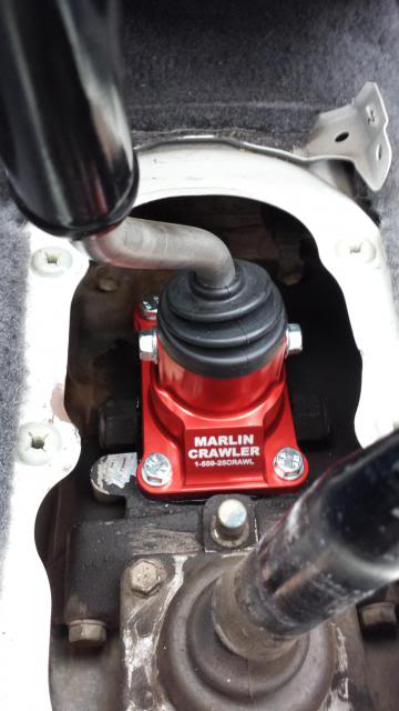

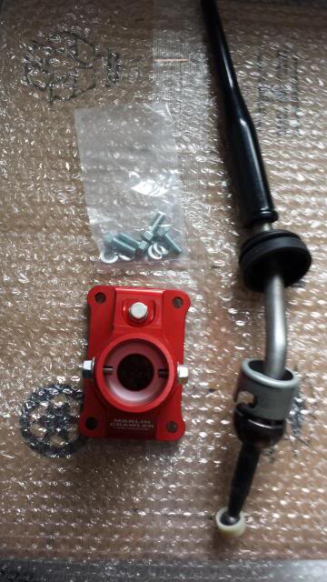

I got some gift certificates from Marlin crawler for Xmas last year so I got a short throw shifter.
I am very happy with the shifter. Throws are short and engagement is very positive.
