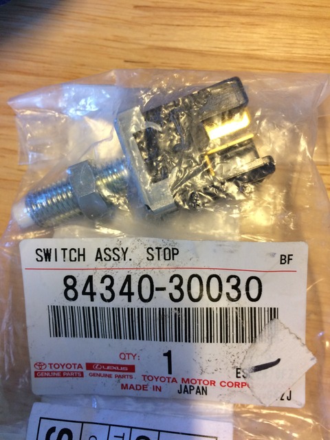

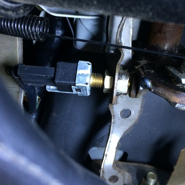

It's been a couple of months since I've posted progress. I got the new rear bumper on and it looks great but I don't seem to have pictures. We had a minor maintenance crisis and there wasn't much info on the 'net. "Brake lights don't light." After checking the fuse and bulbs and cleaning the fuse box they still didn't light. I used Rad4Runner's tutorial here in post #167: http://www.toyota-4runner.org/classi...ml#post2585137
No dice. I ordered a new brake light switch from eBay. The Toyota list is $78 but a seller had a new OEM switch for $22
Here's where it goes: Name:  6F7BB1CF-5DF4-4F12-B482-5B5C5720BF3F_zpsx2oe6kjd.jpg
It goes under the dash. There's an air vent pipe in the way so it's best to remove that. I ended up taking out the driver seat for more room. The actual change out takes a couple of minutes with a 14mm wrench. This is where the switch is located from an eBay listing. It's the black thing at the top to the left of the brake pedal. I hope this helps because I found little on the internet or FSM. If you have "Brake Lights Won't Go Off" there's a rubber pad that hits the white plunger on the switch. You can see the round rubber piece below. They wear out or get a hole. Some people glue a penny there. I hope this helps someone:

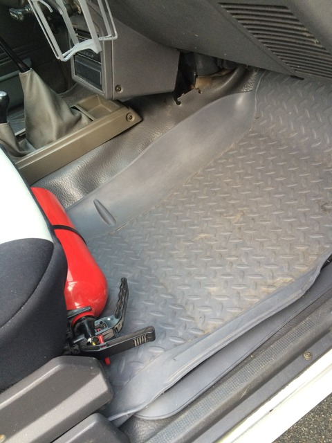

1st gen Tacoma floor liners fit 1st gen 4Runners
I think WeatherTech floor liners are the best but when I tried to find floor liners for my 2000 Tacoma X Cab I could only find Husky liners in gray. We sold the Tacoma and I got a new 2016 Tacoma. Come to find out 1st gen Tacoma floor liners fir the 1st gen 4Runner pretty well,
Front passenger:

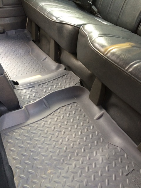

The rears fit great:

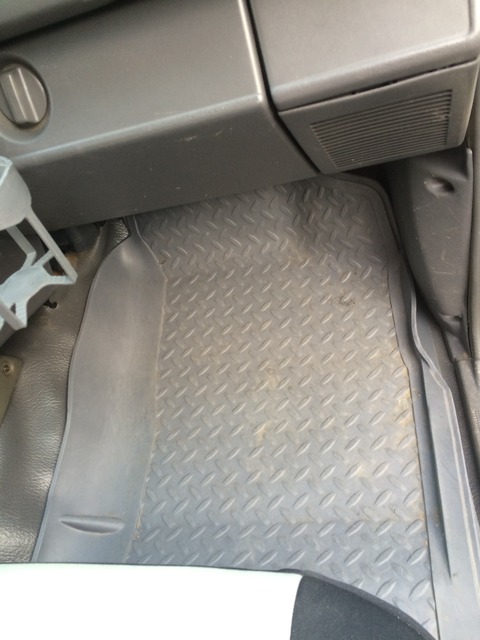

I didn't take a picture of the driver's side, I guess because it's so muddy. Anyway it fits. I need to get some industrial Velcro to stick them down better because I have vinyl floors instead of carpet.
