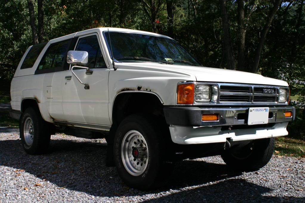

And I do mean slow. I came on here about four years ago to figure out how to install a tow hitch on my 2000 4Runner. I used to have an 88 4Runner I bought new. It was a DLX with vinyl floor, stripped down except for A/C. I put a Kayline top on it and kept that on for five or six years. I bought it for $12,500 and sold it after eight years at 100,000 miles for $8,900. It was replaced by a new white 1997 4Runner. That got wrecked so I got the black 2000 SR5. I soon realized I NEEDED a 1st gen again.
I found this about three hours from me, 89 DLX, vinyl floors, nearly identical to my first 4Runner:

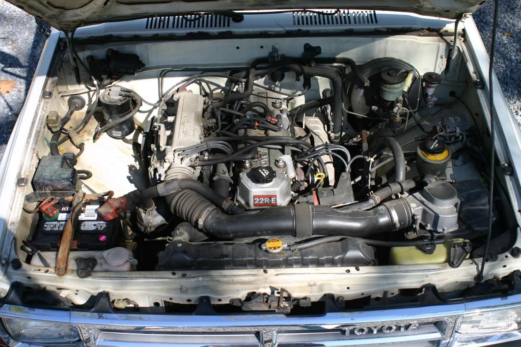

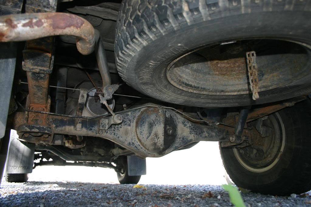

Underside was not too terrible. I think it was undercoated at one time.

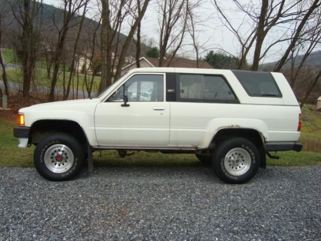

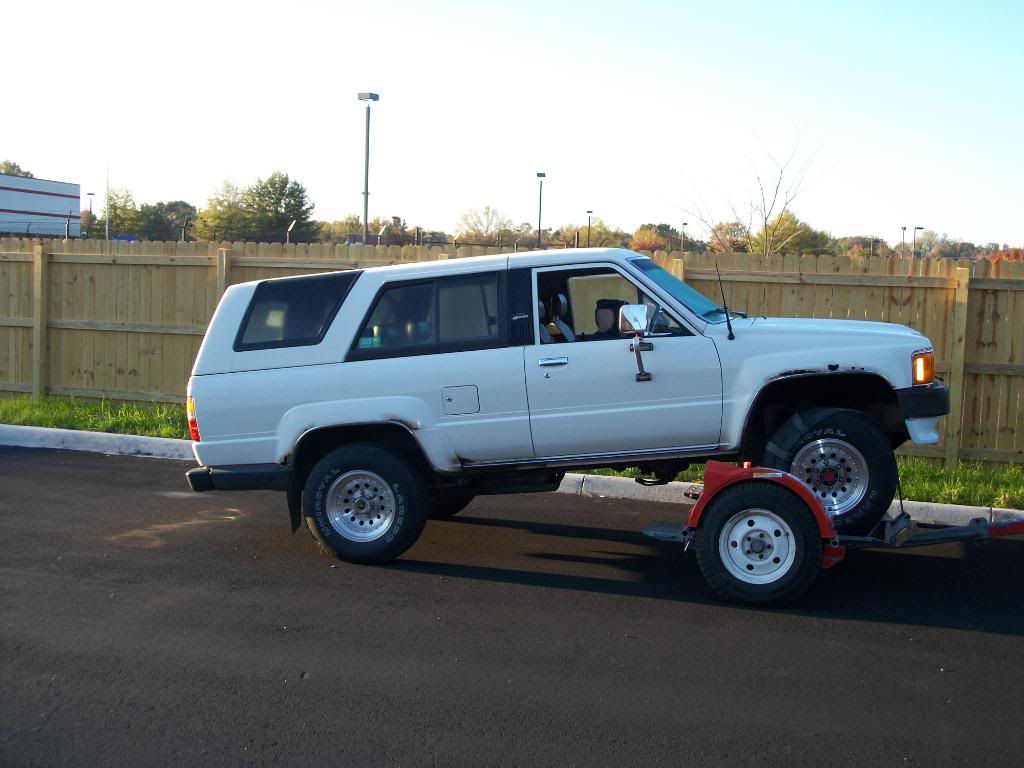

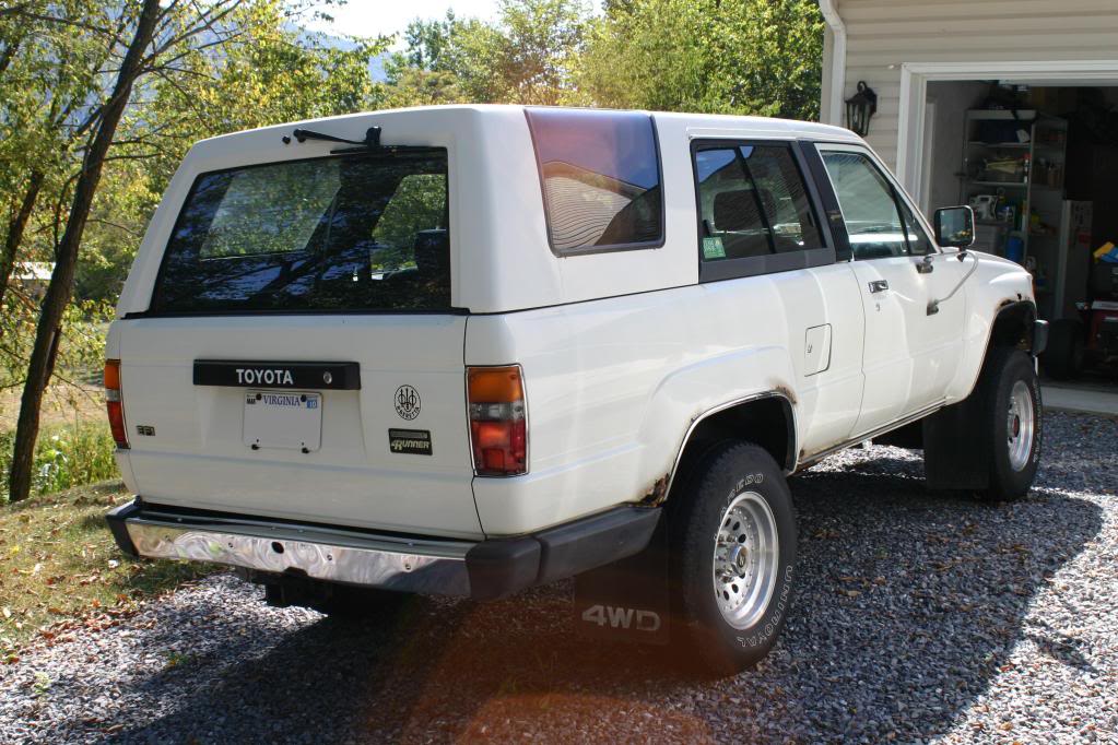

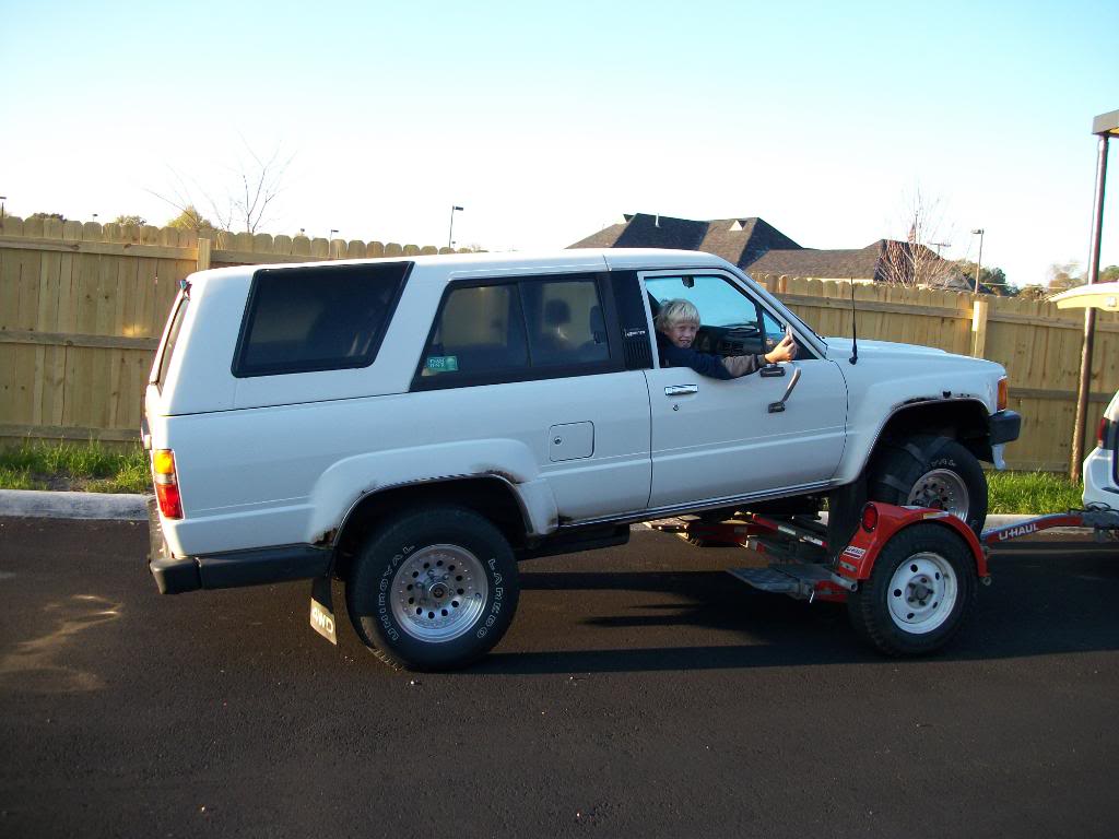

So I towed it home three hours from the mountains of VA. I live in the Richmond area. PO disconnected the drive shaft for me:
He did not ride like this:

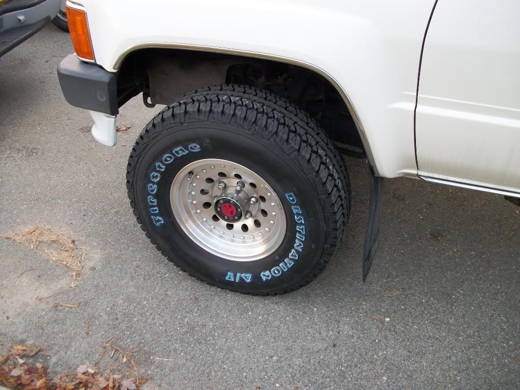

I love Outlaw II rims. They were on my '88 too. So 80's. These are actually Sears knock offs called "Z Racing."
This is my first body work on anything ever. It had the dent everyone has. I drilled a small hole and pulled the dent and finished it with "Rage" body filler. It sands much better than traditional Bondo. Sprayed white primer. I replaced the faded tail light lenses.

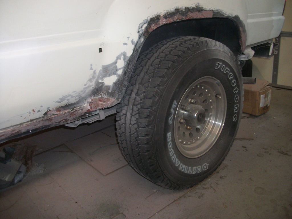

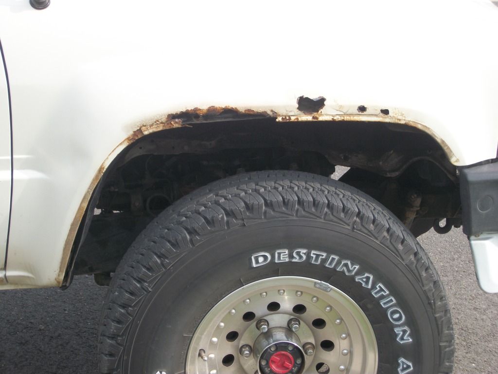

PO's father in law was a park ranger and I guess he drove it a lot on dirt roads. You see all the rust on the fender bottoms. The chrome wheel trim was literally holding the edges together in some places. When I took the gravel guard off the passenger side the metal was gone and there was a red dirt clod the size of my fist where metal used to be.

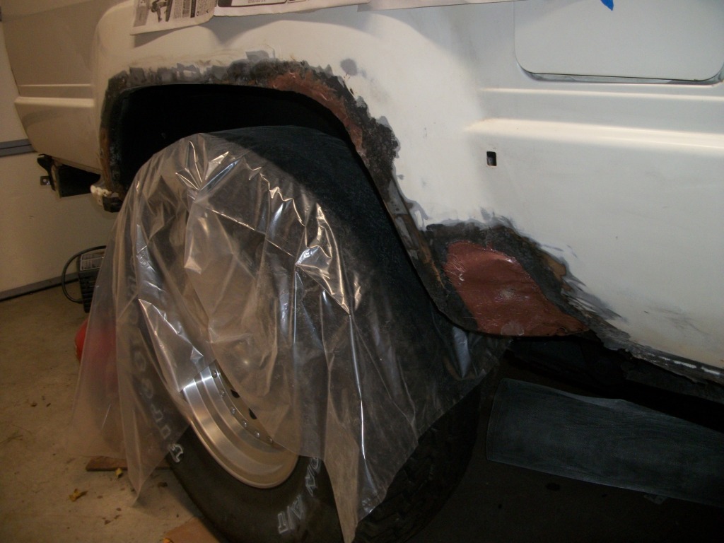

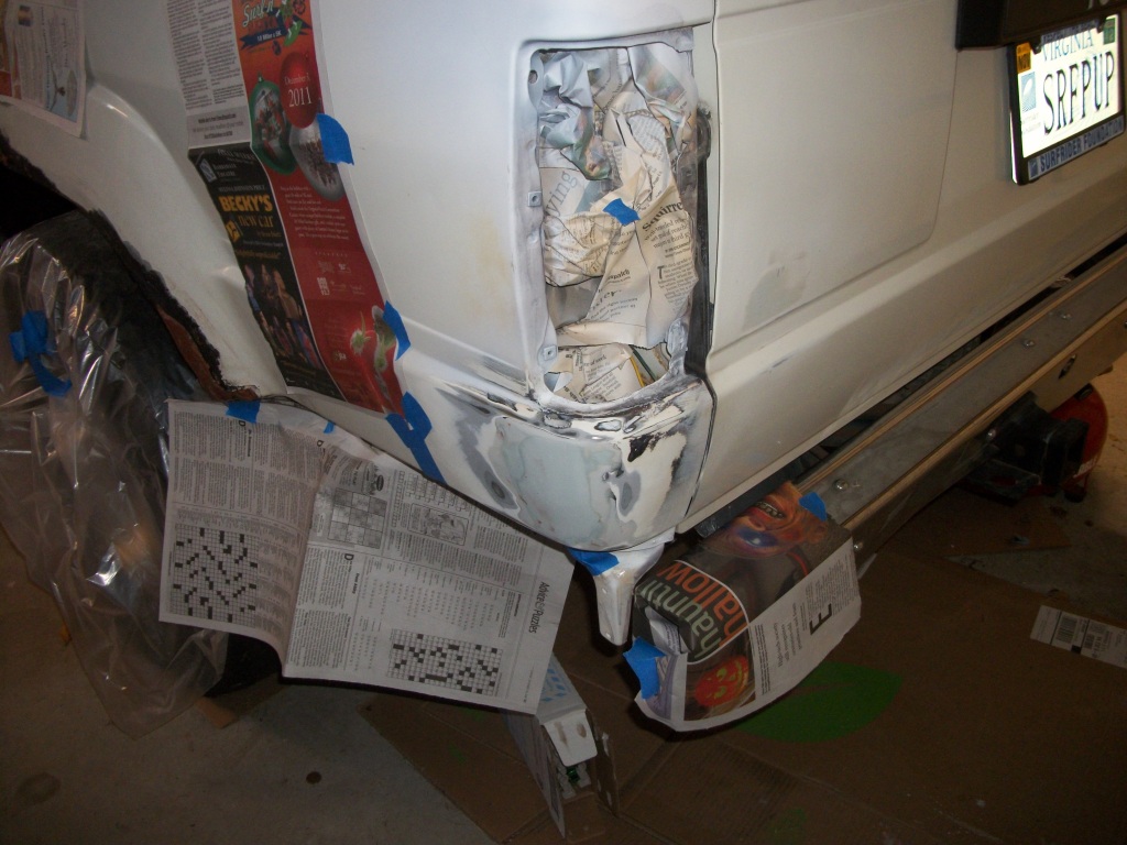

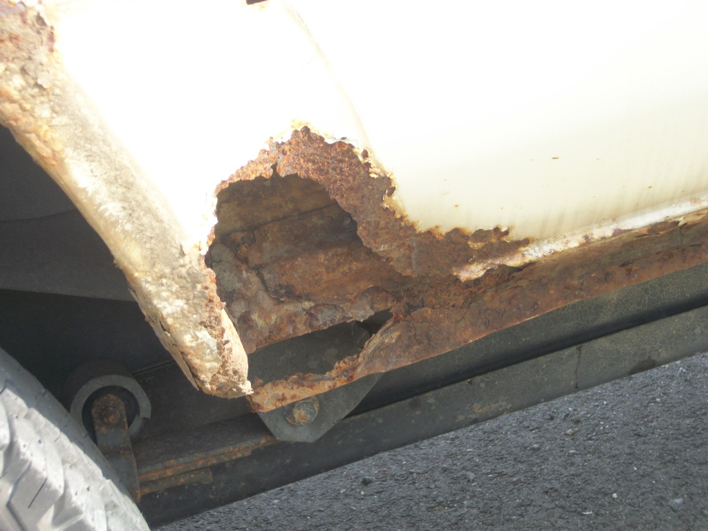

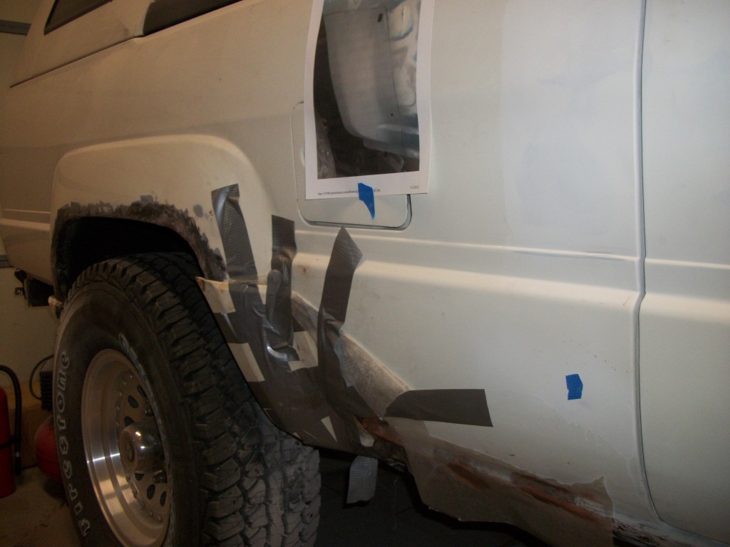

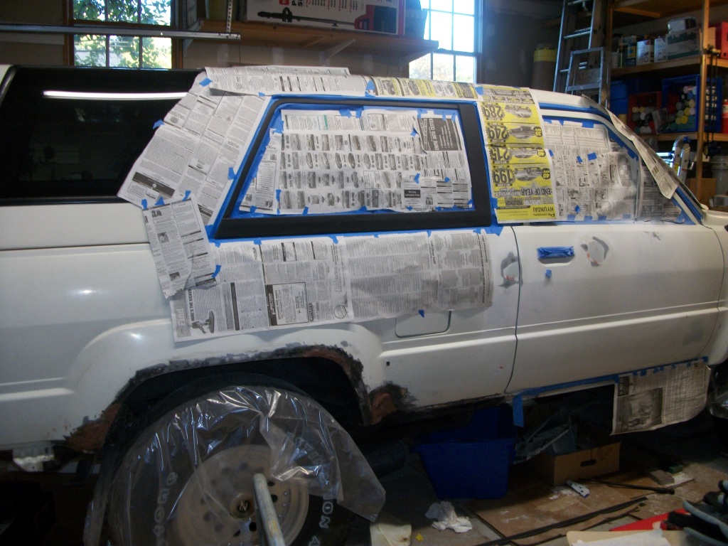

I got a bunch of Eastwood products. I brushed Naval Jelly on the rust and drove to the car wash. I sprayed rust converter on the cleaned metal and the rust encapsulator (or the reverse order- whatever the directions said.)
I pulled off the rear panels and applied fiberglass mat from the back side. I wet the mat with West System epoxy and filler. Make it up to sort of peanut butter consistency. Wear latex gloves. Smoosh and sculpt it with wax paper from the kitchen.

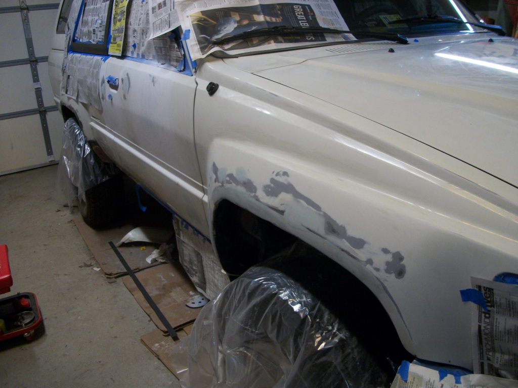

I did the same with this front fender and topped it with a thin layer of Rage. I forgot to mention to take the fender liners off first.

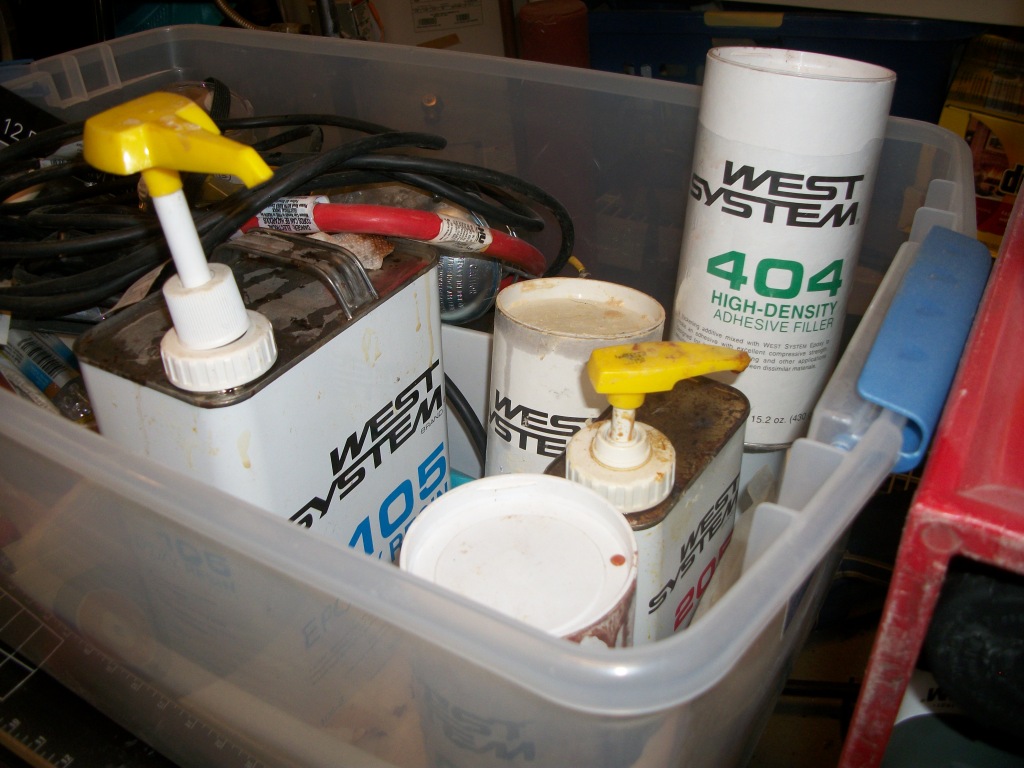

This is the stuff I use. You get it at boat stores. I like Jamestowndistributors.com. They frequently have free shipping and they're cheaper than West Marine. The tops look rusty because they floated around in Hurricane Irene. I lost a ton of tools and momentum. Grr.

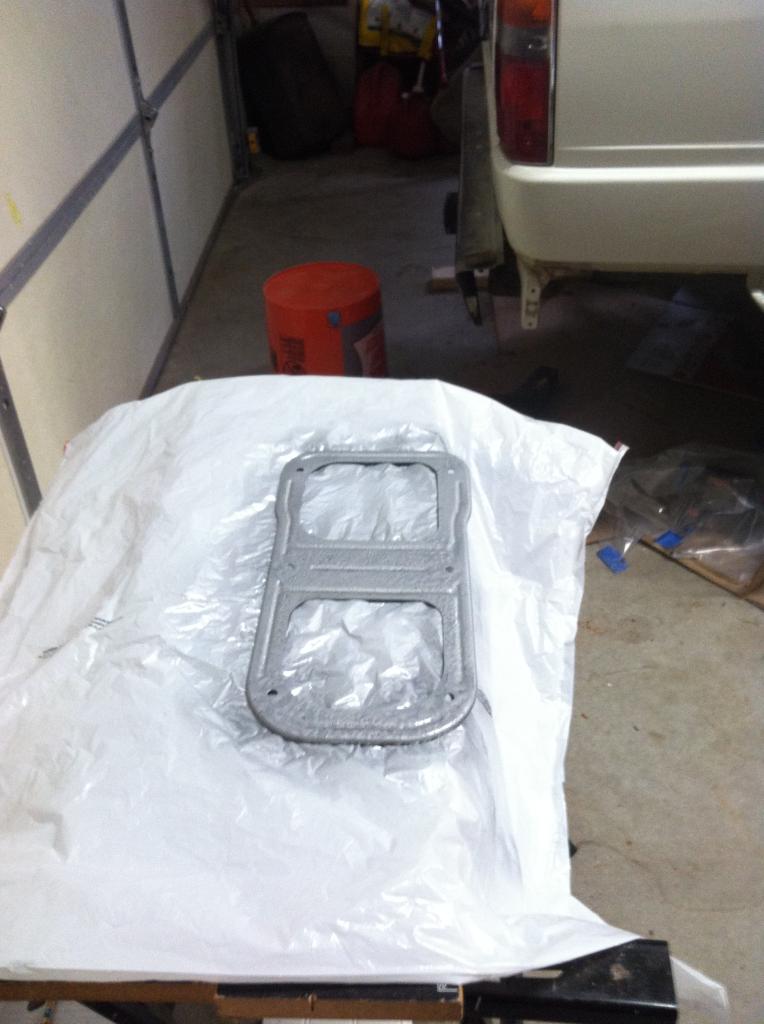

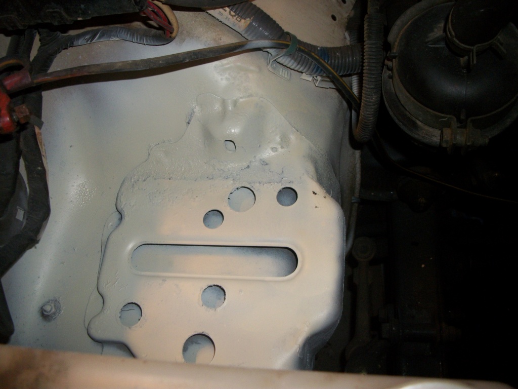

Derusted the battery tray. This is factory matching from paintscratch.com. It's more tan than it should be.

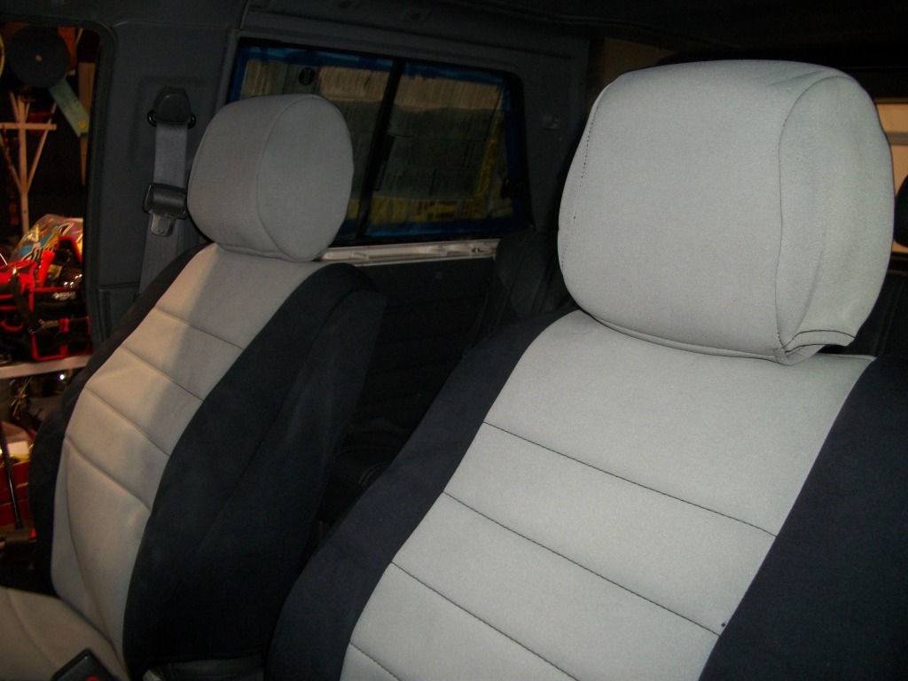

My stripped DLX came with vinyl seats. They are cold in winter. In the 80's I kept gray sheepskin's on them. They were custom and costly. PO of this had some eBay covers to hide a tear on the drivers seat. The rest of the seats are excellent. I learned on here that Toyota TRD seat covers from 2005 or so fit our seats. Hmmm. So when a front pair of Wet Okoles from a 2004 Tacoma came on Craigslist I took a chance. They fit. I took the seats out to put them on and also installed 4Crawler seat lifts.

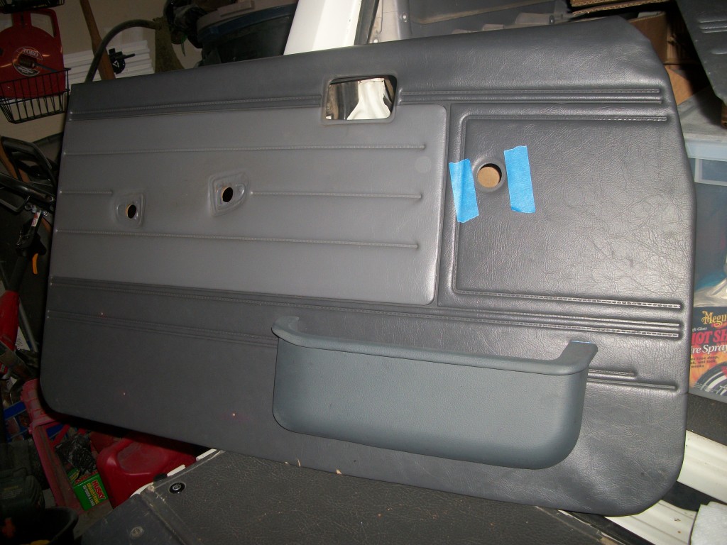

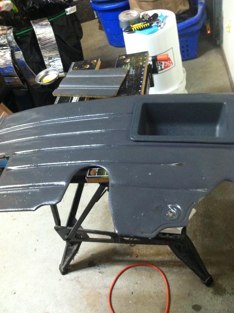

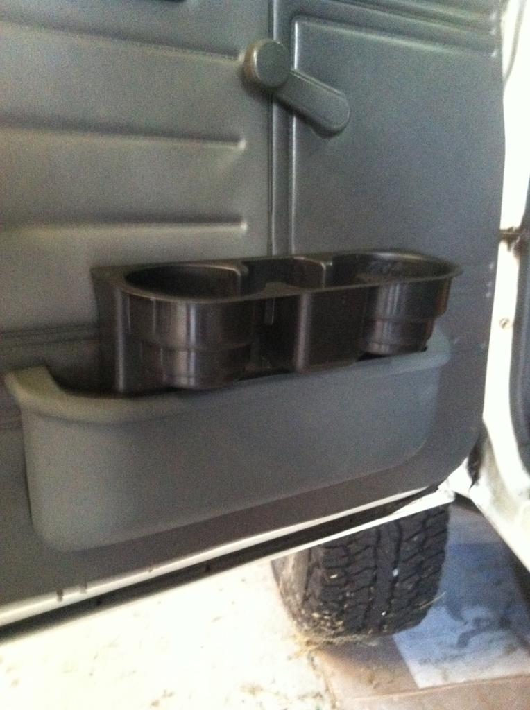

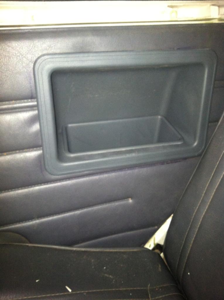

I got red door pockets off eBay and painted them with Duplicolor vinyl paint in graphite gray.

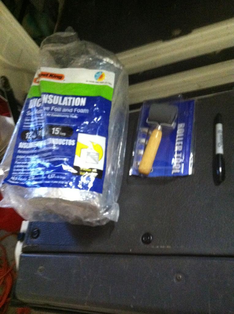

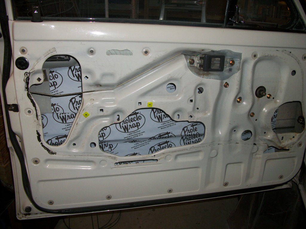

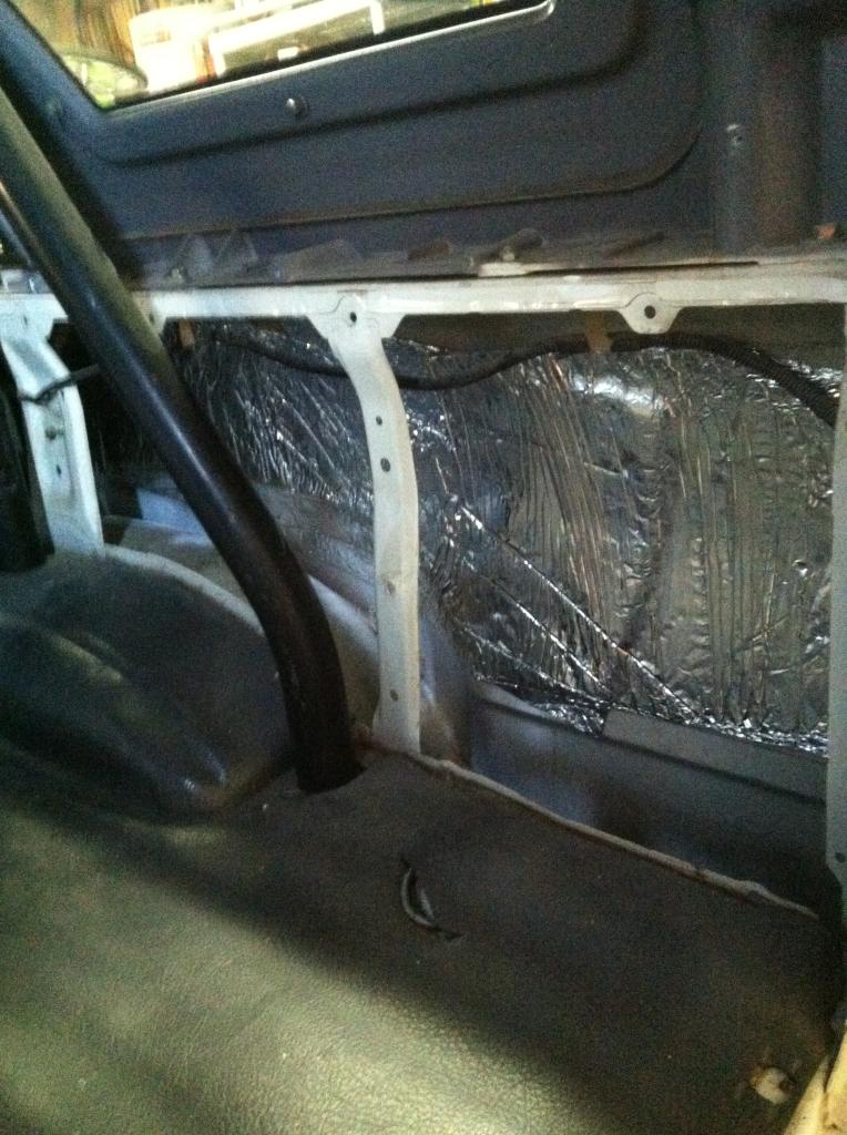

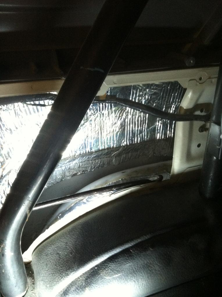

Sound proofed the doors with Protecto Wrap from Home Depot, roofing section.

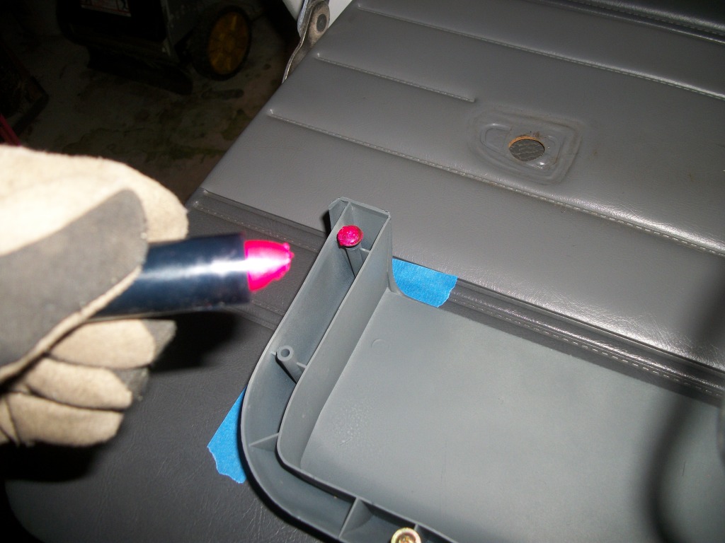

This how I marked the door panel for the door pockets. Borrow ugly lipstick from daughters room. Rub on screw holes, transfer red to panel

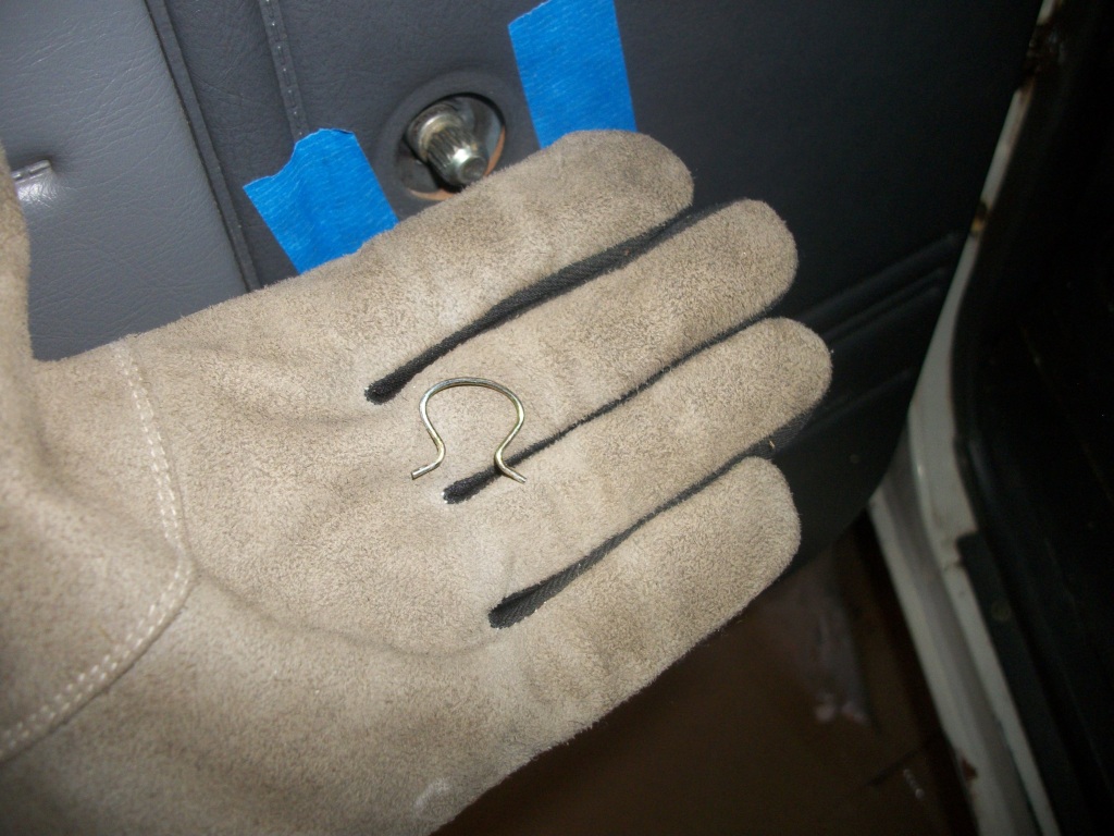

These are the "omega" clips that hold the window roller handle on. To get the handle off you slip a rag between the handle and door and see saw back and forth 'til the clip lets go. They always fly away. I got a pack of 50 from eBay for my next entry into the door. To get handles back on you position the clip on the handle and push it on and it clicks. I could not figure out how to get it back on and did a web search. I felt stupid when I found the answer. Thought I'd mention it.

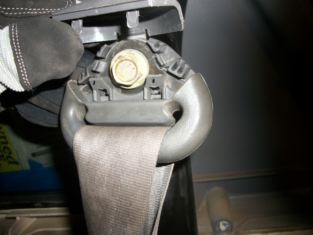

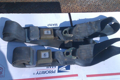

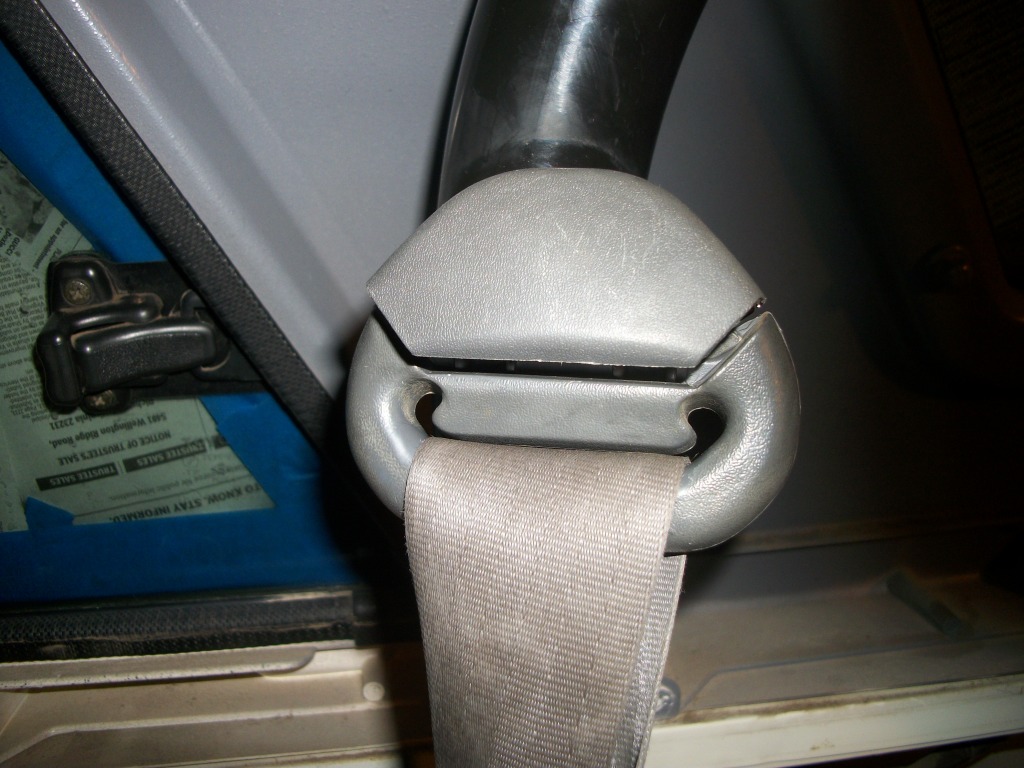

I got front seat belts from a 1993 truck to put in the rears. I got both male and female ends. They have covers over the rolling part. My old rear laps looked like this, the female part is smaller that the Toyta female end. I think these were put in at the Baltimore port:

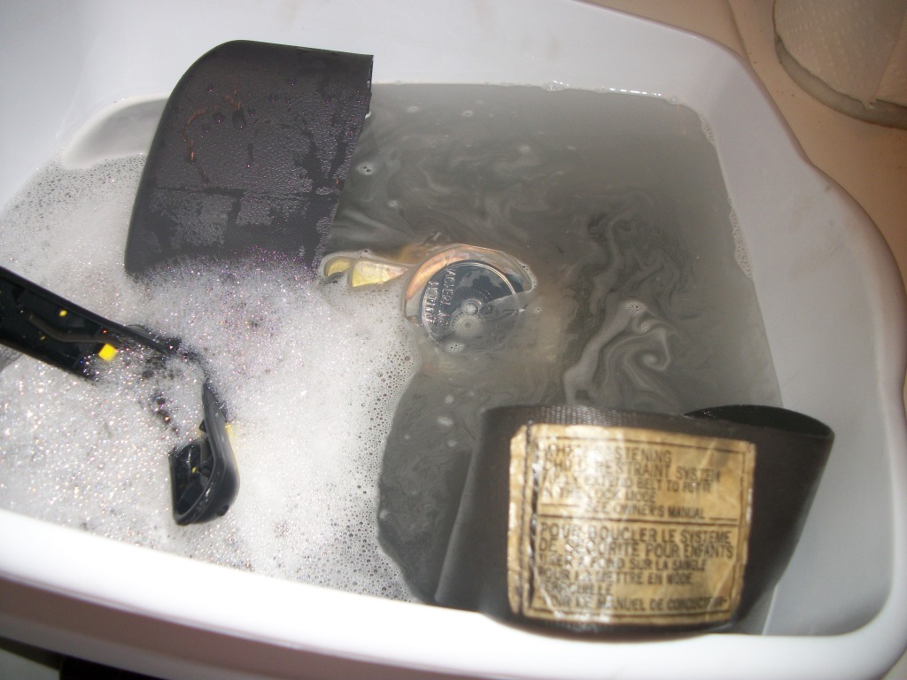

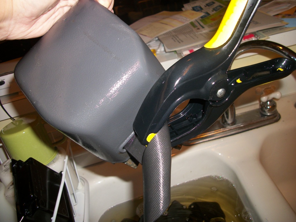

To clean new/old belts I extended it from its housing and put on a clamp to hold the belt free. I washed them in Simple Green.

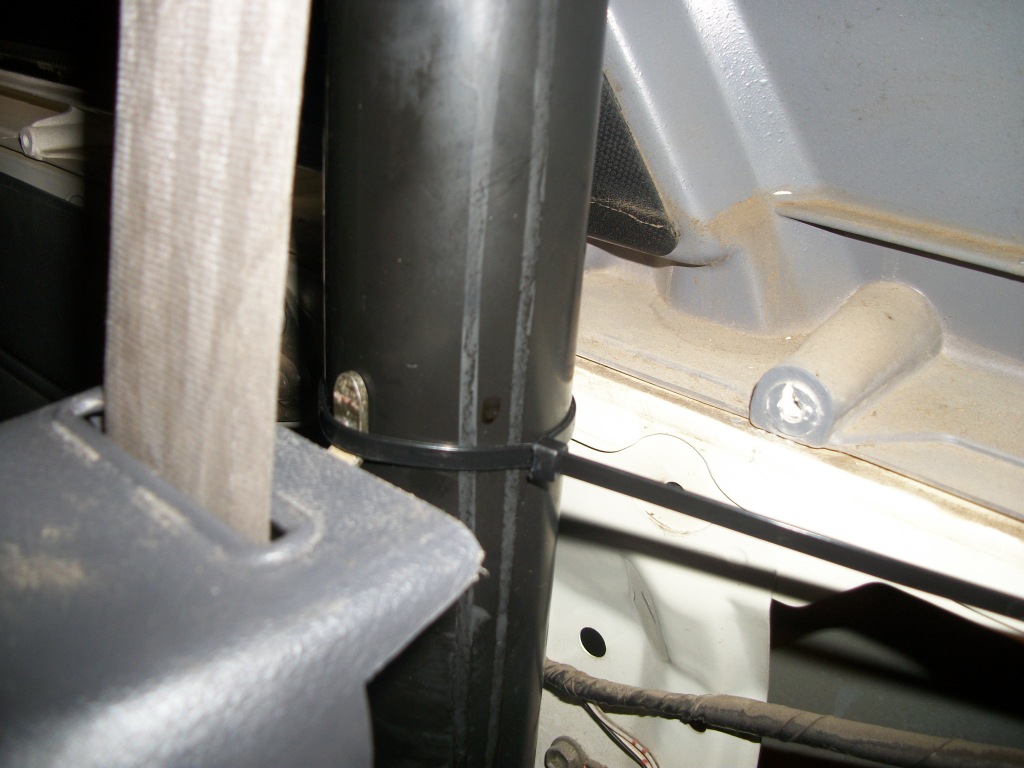

There's a little tab at the top of the '93 seatbelt housing. I used a wire tie to attach it and clipped the excess. The rest of it is bolted.

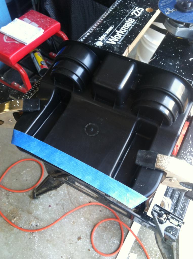

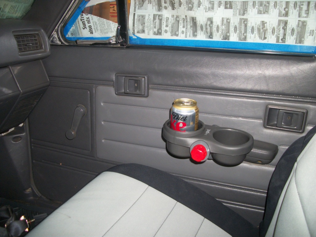

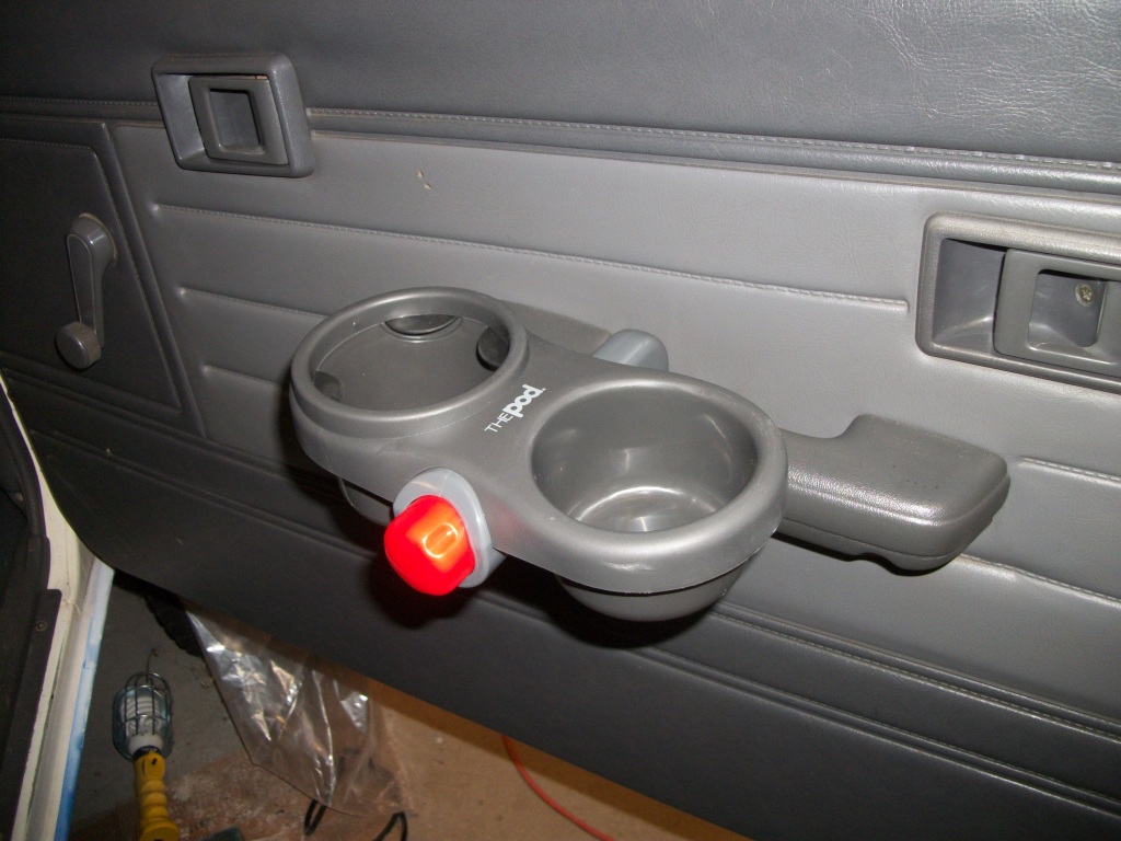

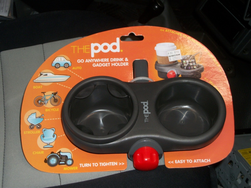

Cupholders. I had the $1.00 holder mounted on the glove compartment but it broke. I got the Wedge but it was too tall for the door pockets. I cut an inch of the bottom and wedged it with pipe insulation. Works fine.
Bed Bath and Beyond had these for back to school. I think they are meant for dorm bunk beds. They are a gray that matches. They were $12.99 but with a 20% coupon it was only about $10.

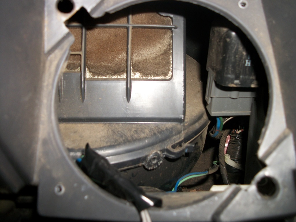

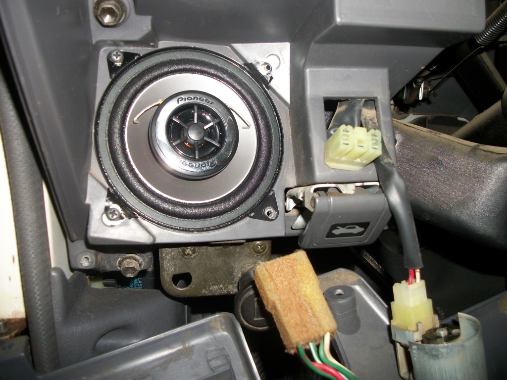

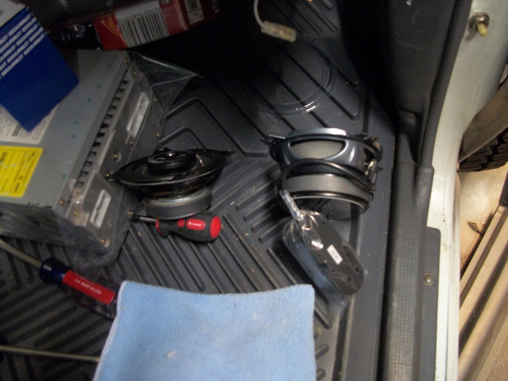

PO had installed a new stereo and 4" Pioneer speakers. It plays iPhone okay. I got caught up in the Infinity hoopla from the other 4Runner forum and got some for front and back.
Old Pioneer on left, new Infinity Kappa on right
Crutchfield says they don't fit. They do. Very easy installation and I
recommend them.

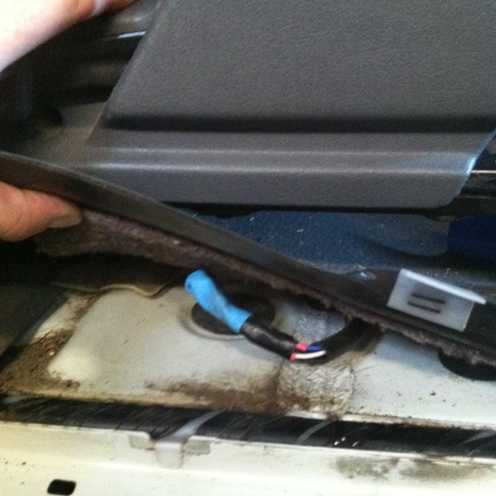

I pulled up the threshold plastic to run speaker wires. The blue plug here is where the O2 sensor exits the vehicle in 1988-1989 4Runners. It goes to the catalytic converter.

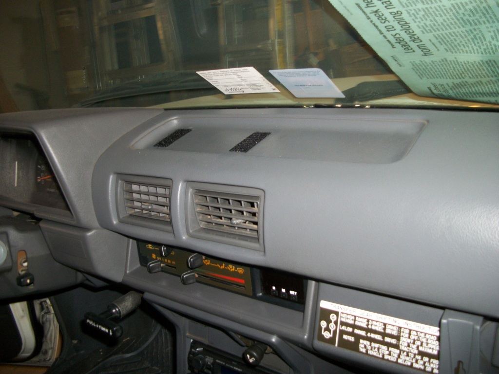

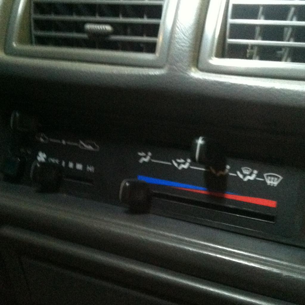

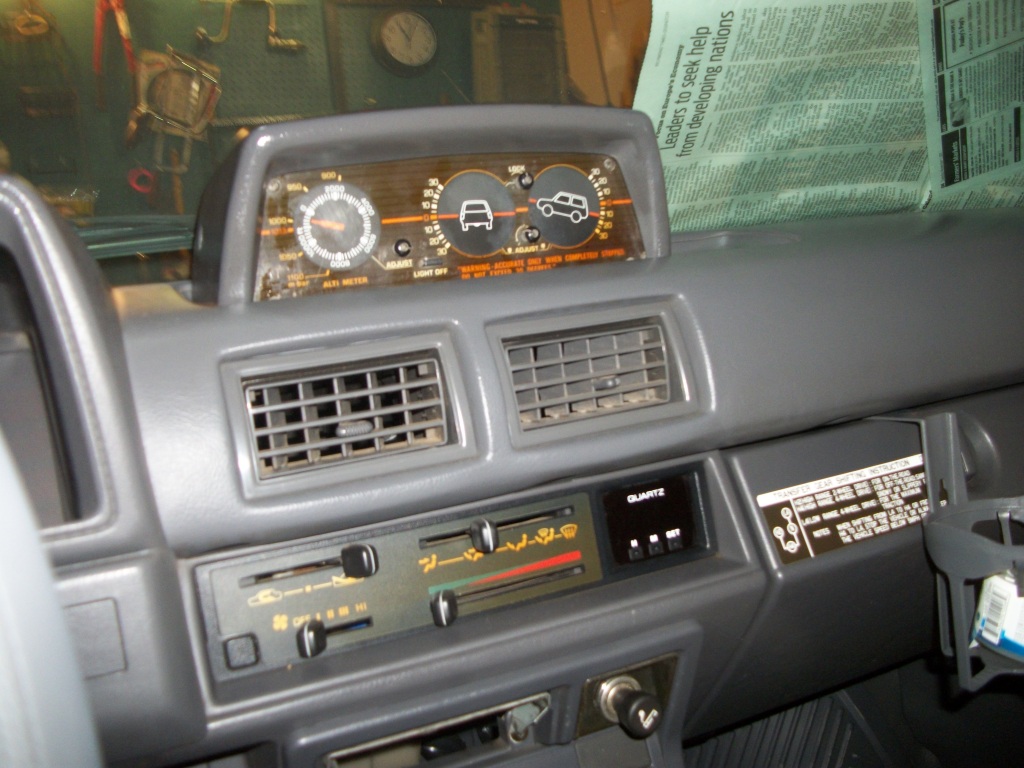

Old heater bezel was cracked. I got a new one a while back. They are only about $25 new from a Toyota parts place on line. Someone on eBay is selling them for $56. Don't pay that!
With a tiny screwdriver to pry out the old bezel it only takes about two minutes to change

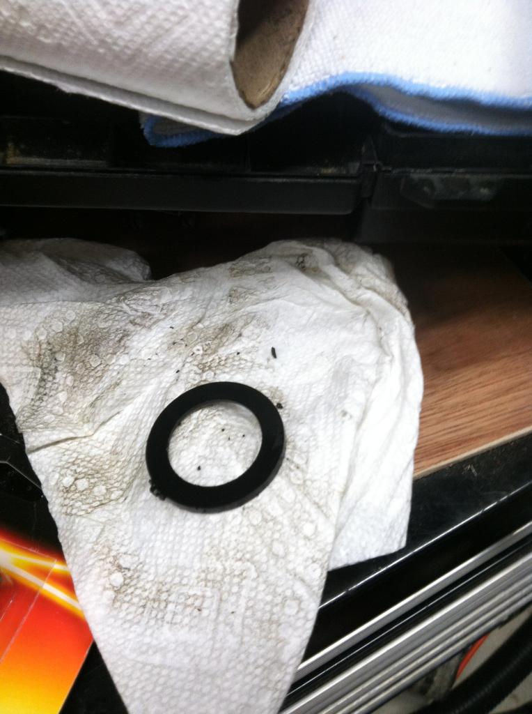

I had some shifting problems and decided to change out the shifter seat. I got the pieces from Marlin Crawler. I have a W56 transmission and I should have used the white seat but I ordered the red one. The red one shifts fine. It looks like 89 was a transition year and I just got lucky. I didn't have any snap ring pliers so I didn't change the 4WD one. This is the old seat. It doesn't look bad. Truck has about 148k on it. It was not shifting well.

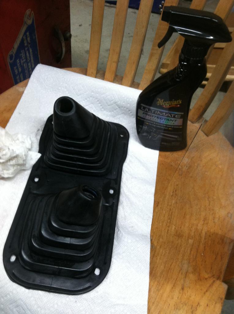

I cleaned the rubber boot and wiped on some Meguiars Tire Shine. It looks new.
The metal trim ring wasn't bad but I sprayed it with some silver hammer finish paint.

My younger son is taking small engine repair and welding. Where was he when I was using fiberglass? Oh yeah, Middle school. He got the shifter back in.
I'm painting some interior parts. I'm rebuilding a double decker console I got. It was painted black but I'm getting it back to gray. Progress is stalled because I got some peelage. I'm going to have to sand some and recoat. This is pretty much where I am now.

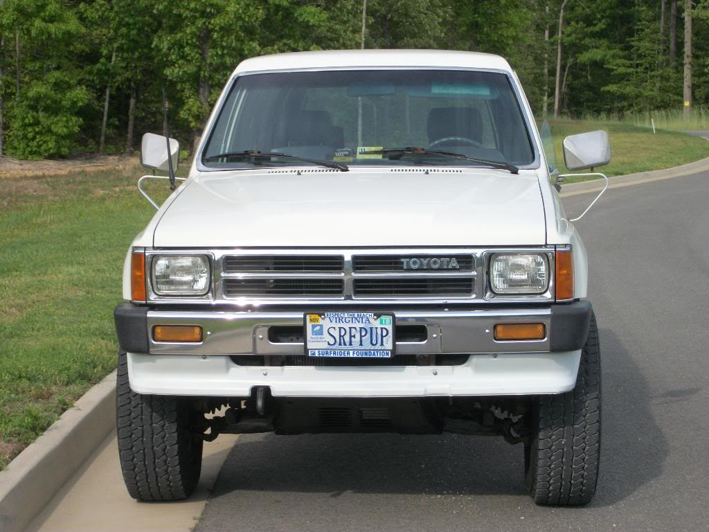

That isn't the license number any more. I hope to get some smaller mirrors on soon. They are stainless.

Hmm.. wanna insulate my 4runner, how long does it take and what all is involved?
I never heard of doing Peel n' Seal until KiyoBrown's build:
https://www.yotatech.com/forums/f199...thread-219271/
If you do a search for Peel n' Seal on Google there are a ton of good threads about it. The stuff I use is really to go around house doors and windows but for some reason Home Depot has it in the roofing section. I was just watching "This Old House" today and they were using my brand, Protecto Wrap in Boston. I used one roll in the two front doors and one roll of the Frost King in the rear sides, speaker boards and back seat sides. The doors have a nice substantial thunk when you closed them rather than the tin sound they used to have. You can do one area at a time. I recommend some interior panel tools so you don't break a lot of clips. I got these "trim tools" from Harbor Freight. They are $7.99 now. Autozone also sells something similar:

Excellent work!!and I love the cupholder!!
