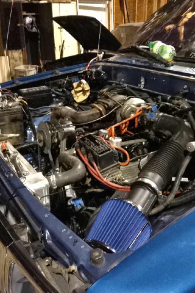

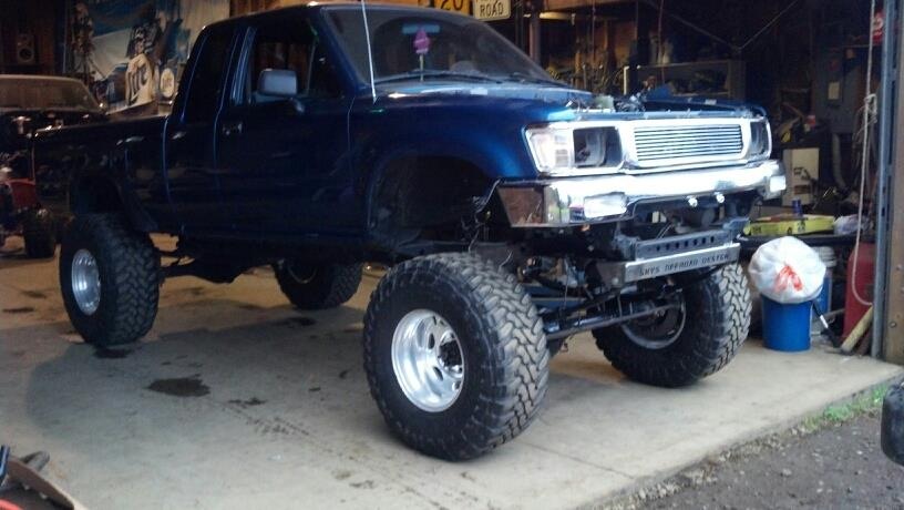

New to the site! Figured I would post a little info about my current build. Its a work in progress and currently hasn't hit the road since going under the knife.
To start with the whole reason behind the motor swap was partly to do with having a father that is a diehard buick freak and a son (that's me) a die hard Toyota freak. I found a good deal on a freshly rebuilt 1984 sequential fuel injected 3.8 turbo v6 out of a buick regal. The motor was rebuilt with a mild cam, aftermarket turbo wheel. Mild head work so on and so forth. I couldn't think of a better heart transplant for the 224,xxx mile 3.0 v6. So the project began.

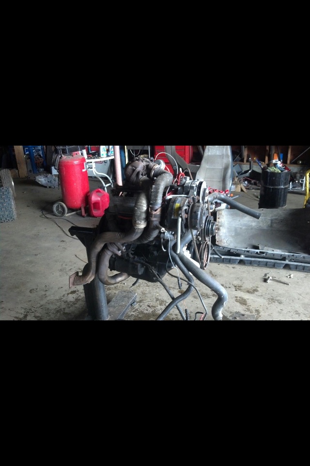

The buick motor fresh outbid storage

The heart being yanked out

Is that the Gran National motor? If so your truck is going to scoot down the road quick. Welcome to Yotatech and looking forward to seeing your build.

Welcome to YotaTech! I am happy to see another buick engine in a Toyota. They are some of the best engines around. Looks like a clean swap! What adapters/bellhousing did you use? Did you keep the R150f? Have anymore pics?

I'll keep digging I have a few that I will post right now. Currently I have a 4l60e in it right now because I wanted overdrive. However after mocking everything up I'm not going to use it because of all the hoops I would need to jump through to make my electronically shifted transmission... Not electronic. Reason being, $$$ the control modules and all the gizzmos to make it work wouldn't make it worth it. The idea now is to spend the money and buy an adapter to run my toyota 5speed... Risky I know but with a good clutch I'm going to try it. I'm very easy on my rigs and it will be a street princess. To answer your question this motor is out of a regal. It is the pre grandnational version from 84-85 that was fuel injected however it is a "hot air" motor I.e. Non inter cooled like the later 86-87 version from a GN.

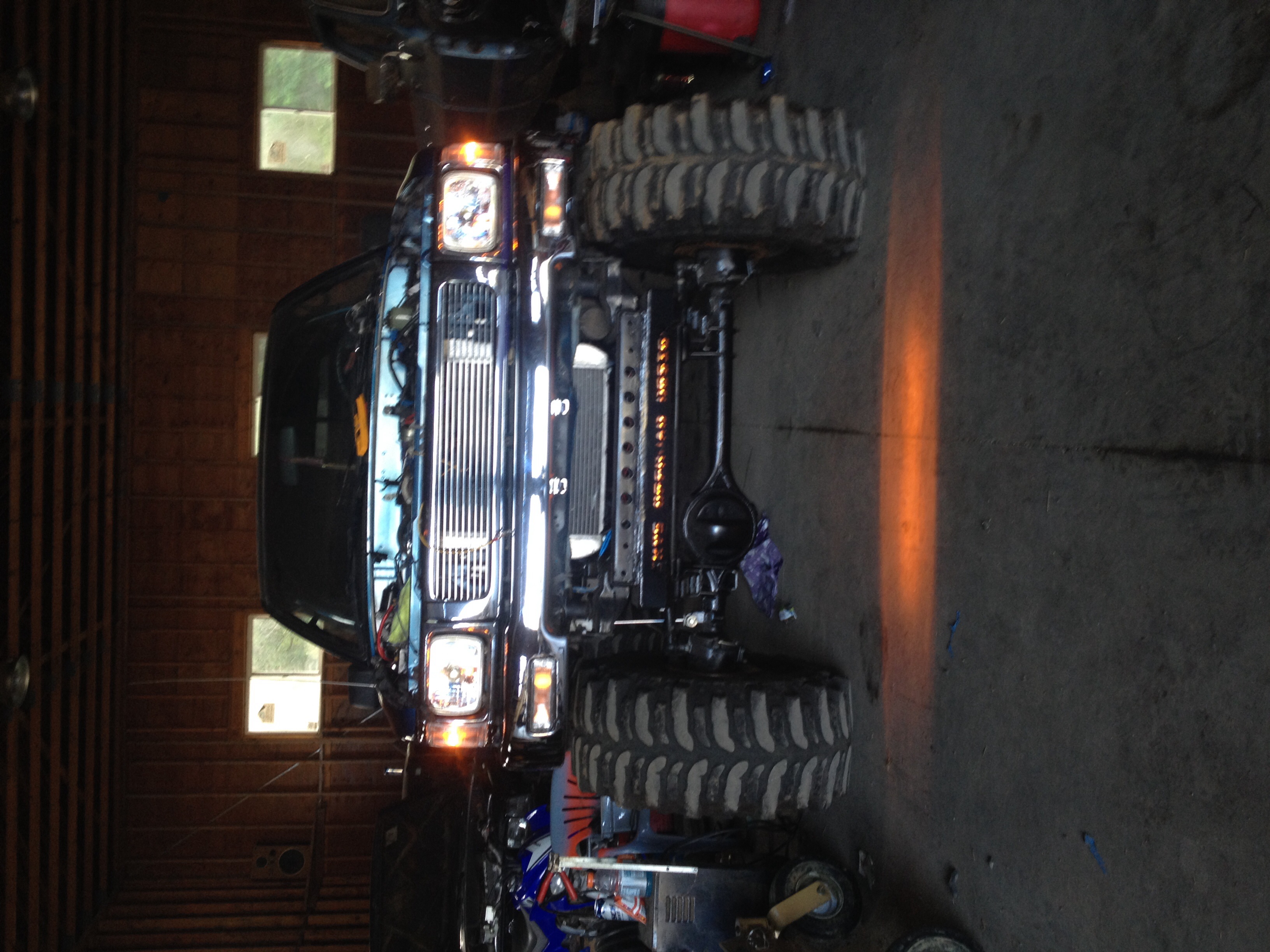

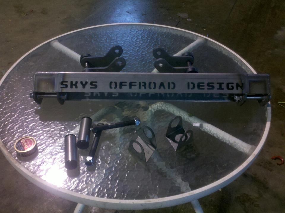

This is how the truck sits currently after sas. 5"trail gear springs sky's off-road crossmember 2"body, on 36x16x15 boggers on 15x12 weld sidewinders

She has a pretty good stance

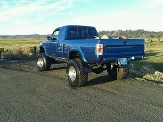

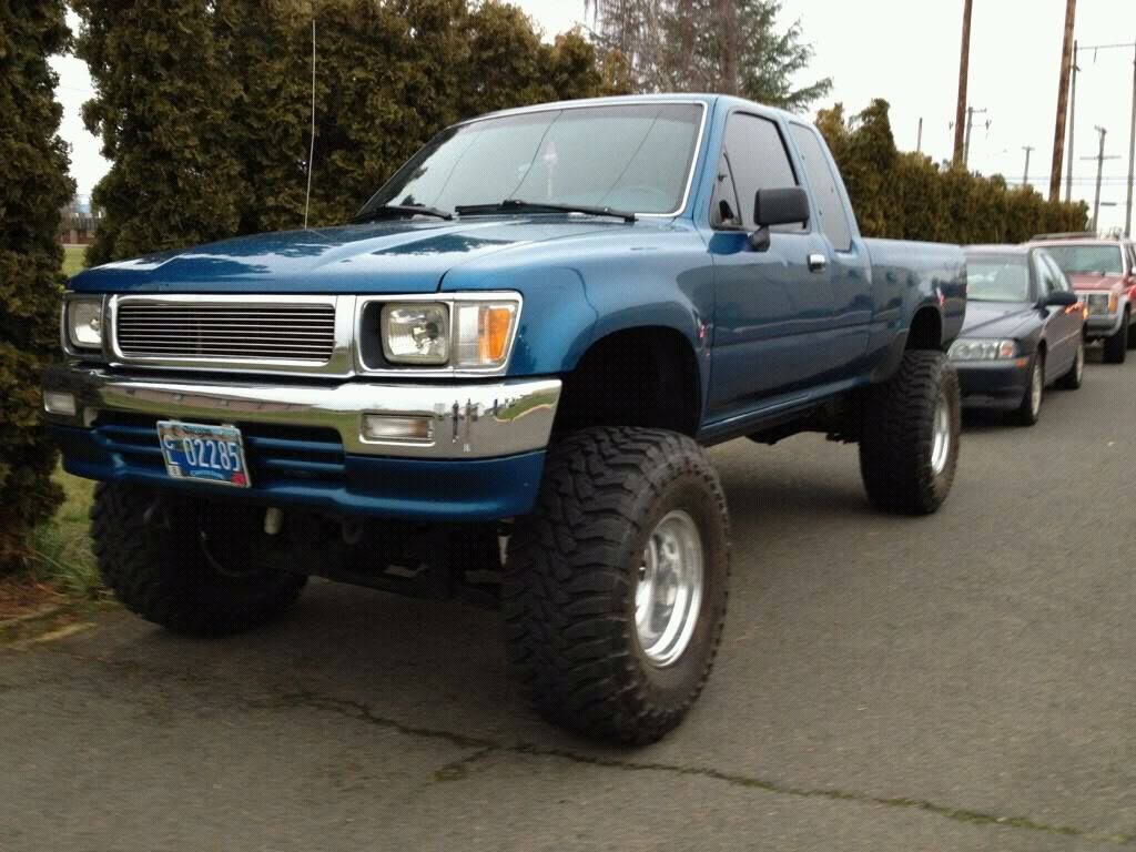

Before she had surgery. Helps when ou start with an almost flawless base.

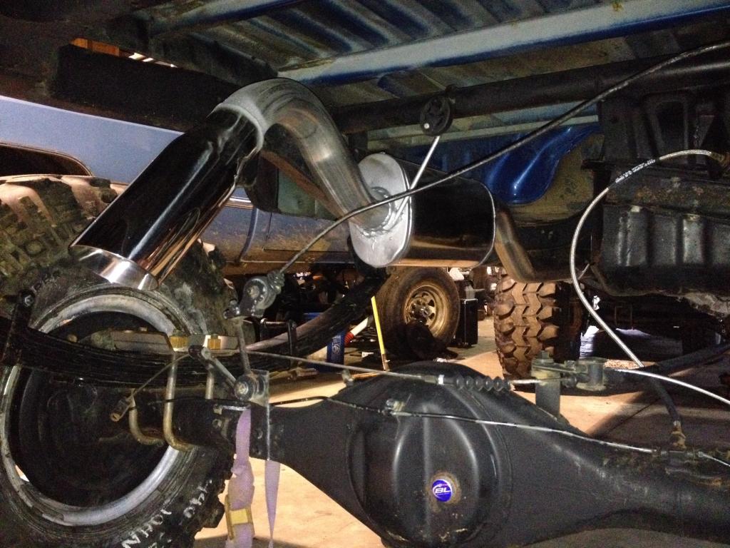

Don't bash on the angle of the tip I know it's big I know it's low. Let me explain lol. I brought my truck to my buddies exhaust shop where he built a custom crossover pipe up pipe out of 2.5 stainless. In 3" all the way to a 40 series polished stainless flow master. It was meant to be a mix between a SoCal turn down style and old school turn down. However I need to raise it up a lot higher so it's not so out in the open

Looks great! That R150 will handle that engine no problem. I threw around the idea of putting the buick 3800 series 2 supercharged engine in my truck for a long time, and I almost pulled the trigger, but things came up and I am sticking with the 3.0 for now. Clean truck!
