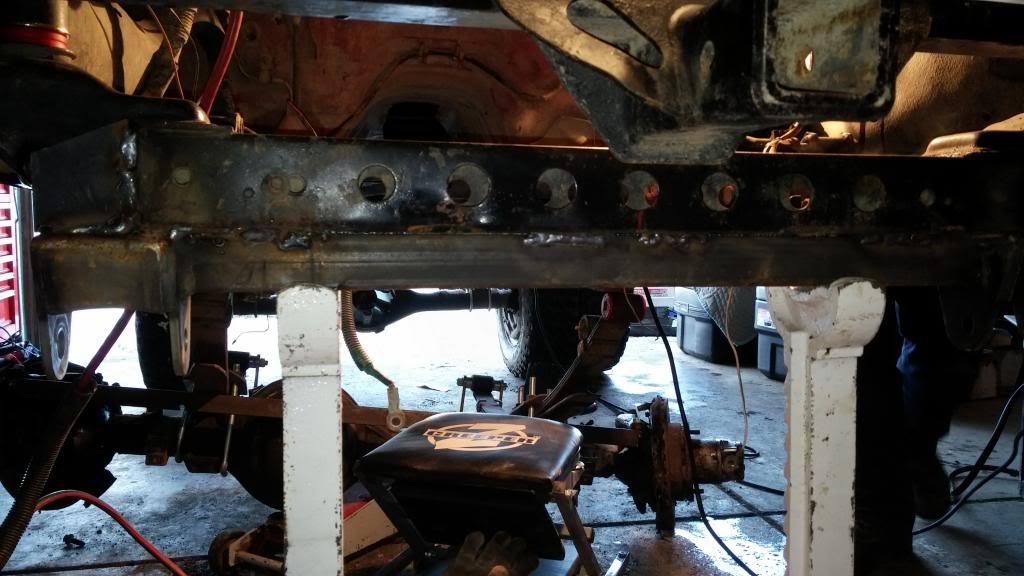

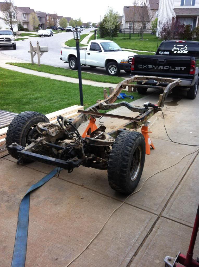

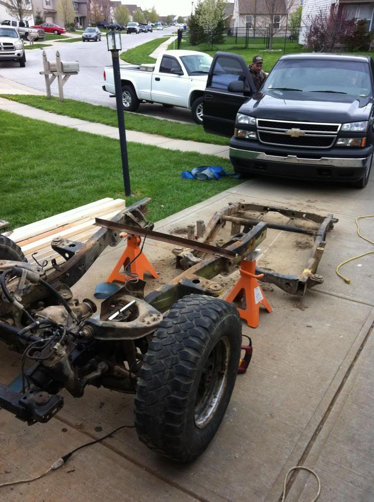

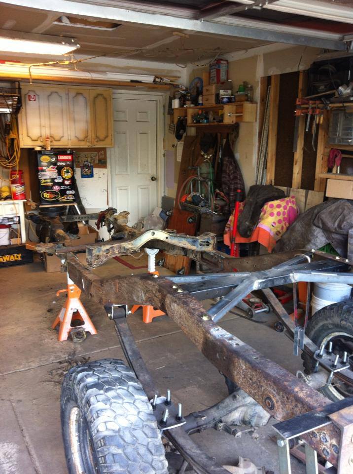

There was a lot of frame rust so i decided that I was going to redo part of the frame. I found out that square body s10 frames are the closest to stock yota frames. The C fits almost perfectly over the frame rail.

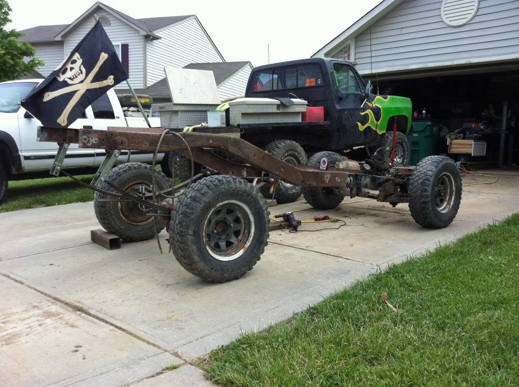

Pic of the donor s10.

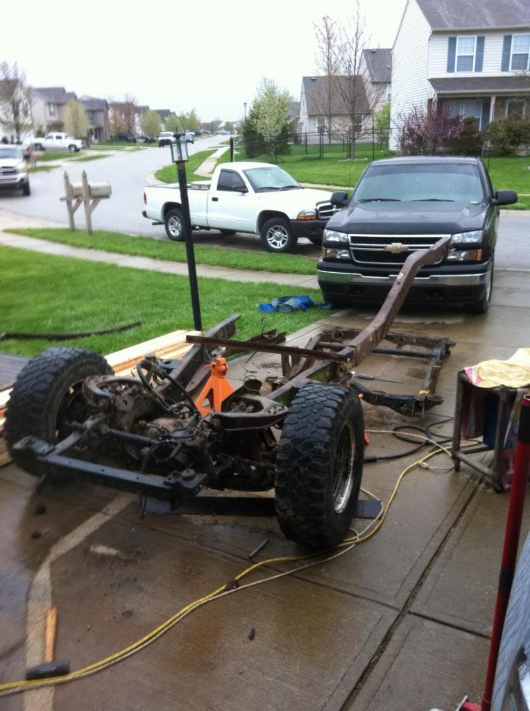

Pics of the yota frame getting the new frame welded on.
Size:  129.4 KBName:  IMG_0527.jpg

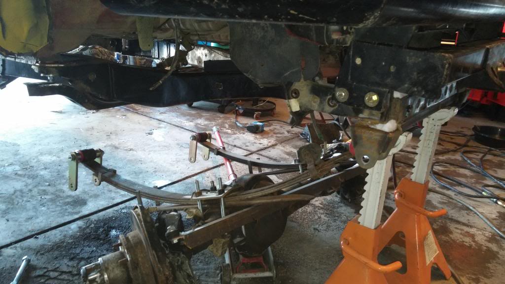

Size:  103.2 KBPut the rear suspension in.

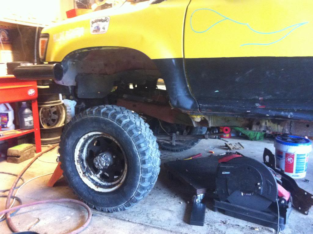

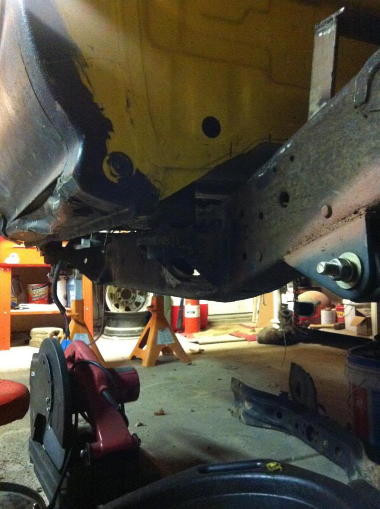

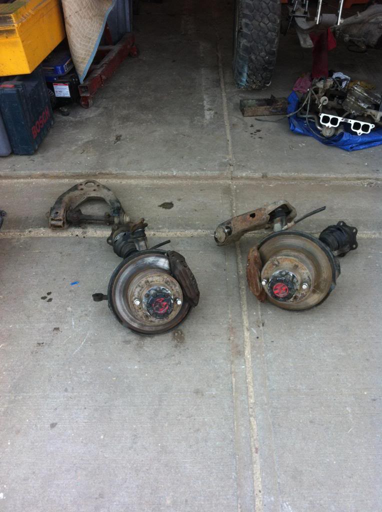

Then i cut out all the IFS.
Size:  110.3 KBName:  IMG_0886.jpg

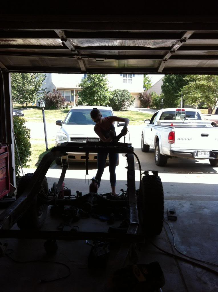

Then i enlisted the help of my girlfriend to help me with some of the fabrication.

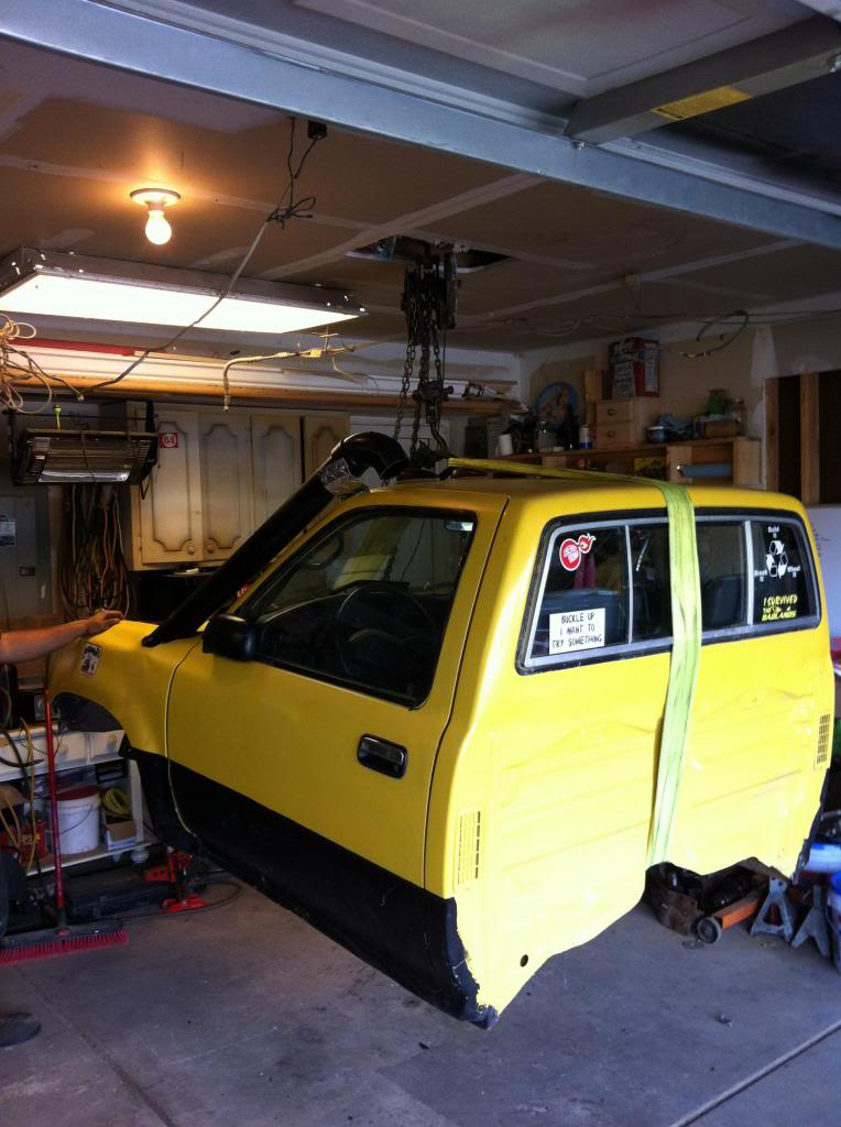

Size:  98.8 KBI mounted the cab.

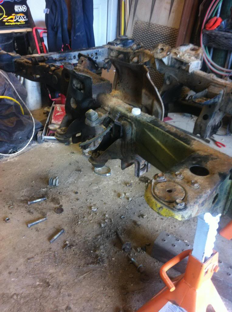

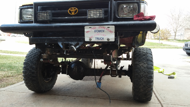

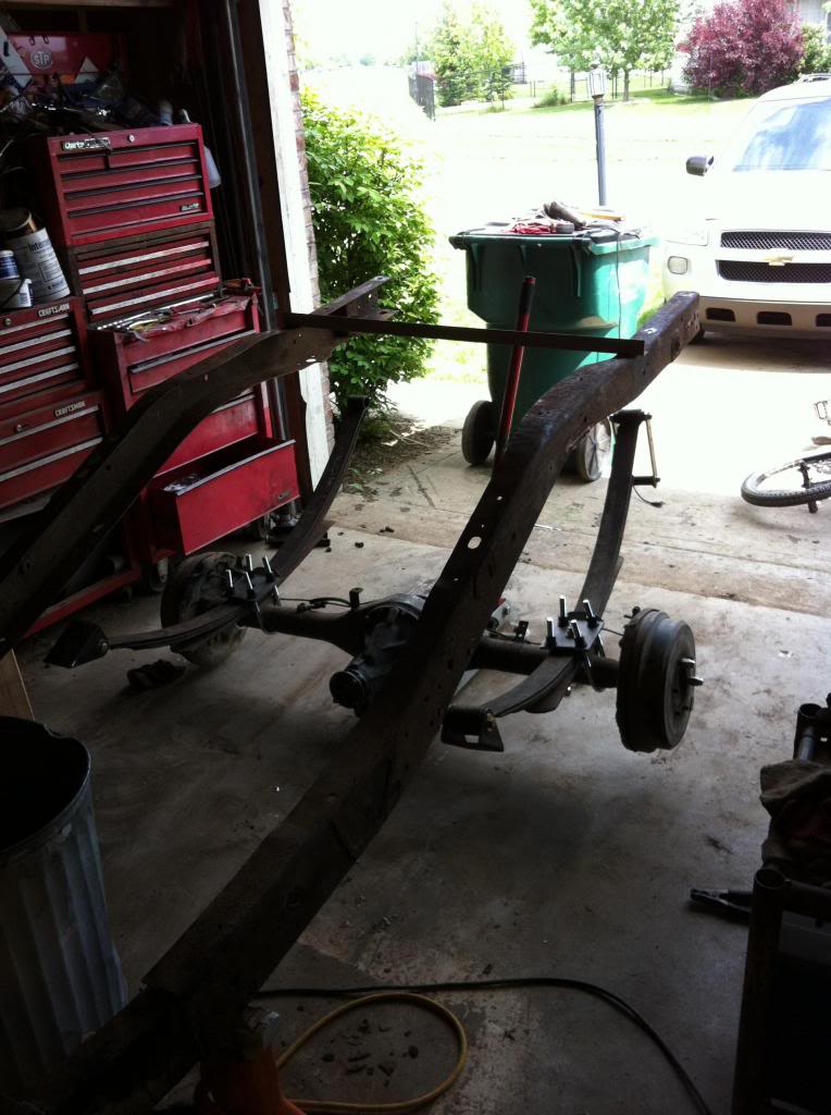

Then i tacked in place the front hanger. and mocked up the front axle set up. i still have to tear into this axle and redo it. But i wanted to get the truck on all fours again so i can move it around for now. I am about to start restoring a 79 f-250 for a guy so i will need to be able to move it around.
Size:  104.1 KBName:  IMG_1098.jpg
Size:  105.7 KBName:  IMG_1101.jpg

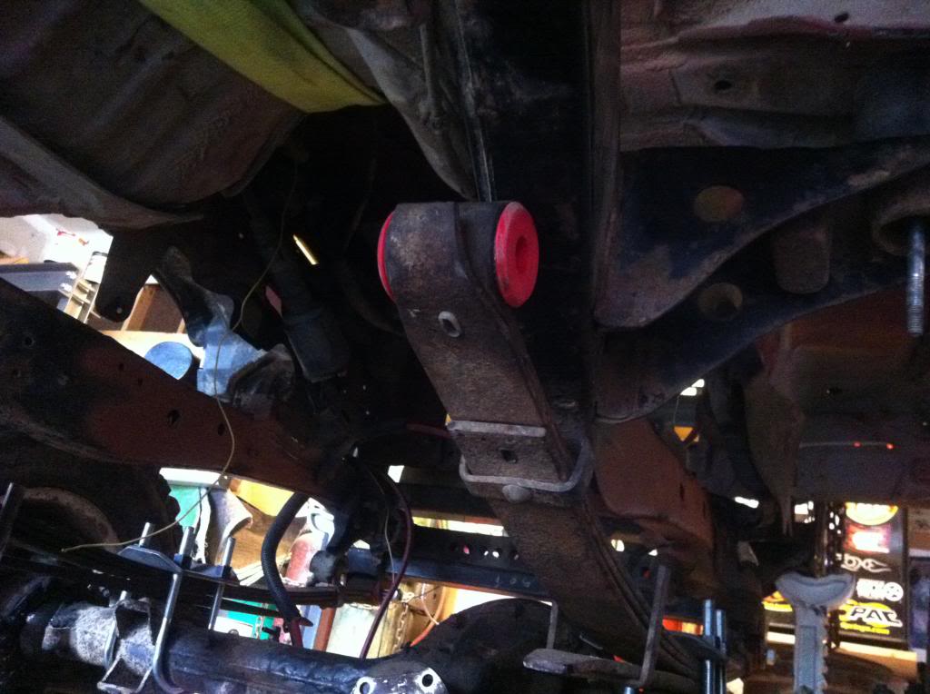

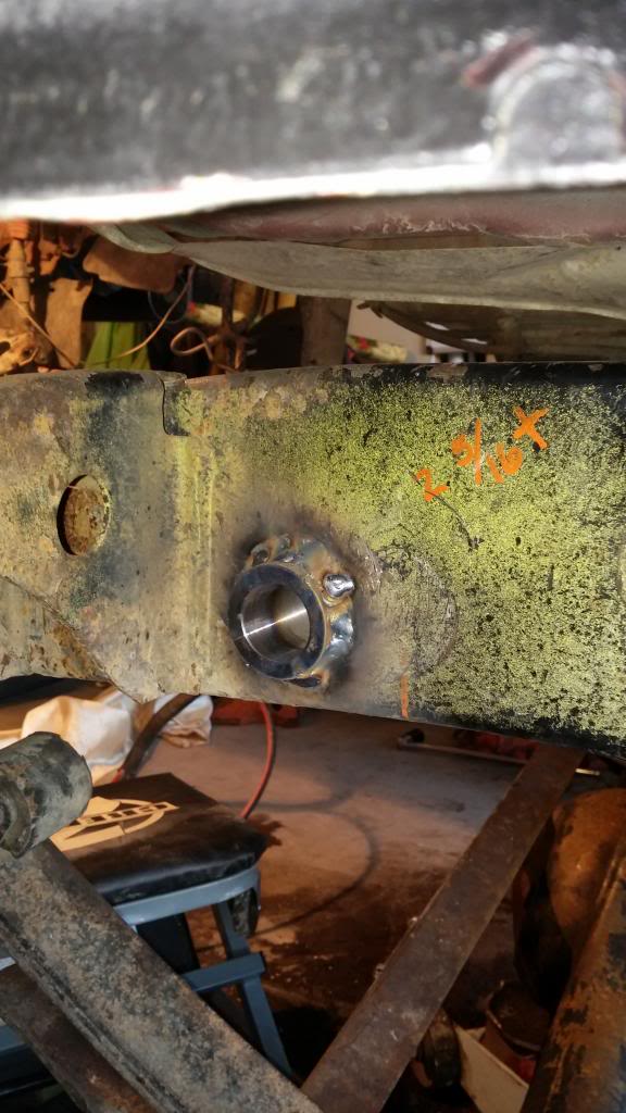

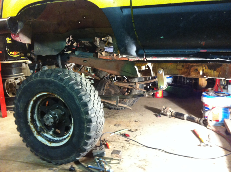

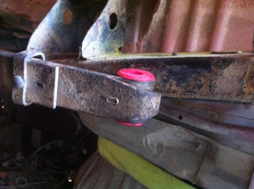

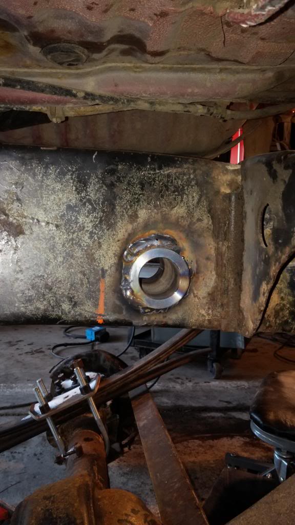

Yesterday I got the drivers side shackle mounted.
I found out my touch has no acetylene so i had to find other methods of cutting the holes for the frame tubes...
Thursday I will hopefully get my motor all put together and ready to put in.
Then this weekend I am going to take the truck over to my girlfriends house so I can use her dads torch to cut the holes for the pass. Shackle.
I'm also going to tr and get done modifying the spring perches.
Since my axle is out of a land cruiser it was a spring under so I have to modify the too part to work for a spring over set up.

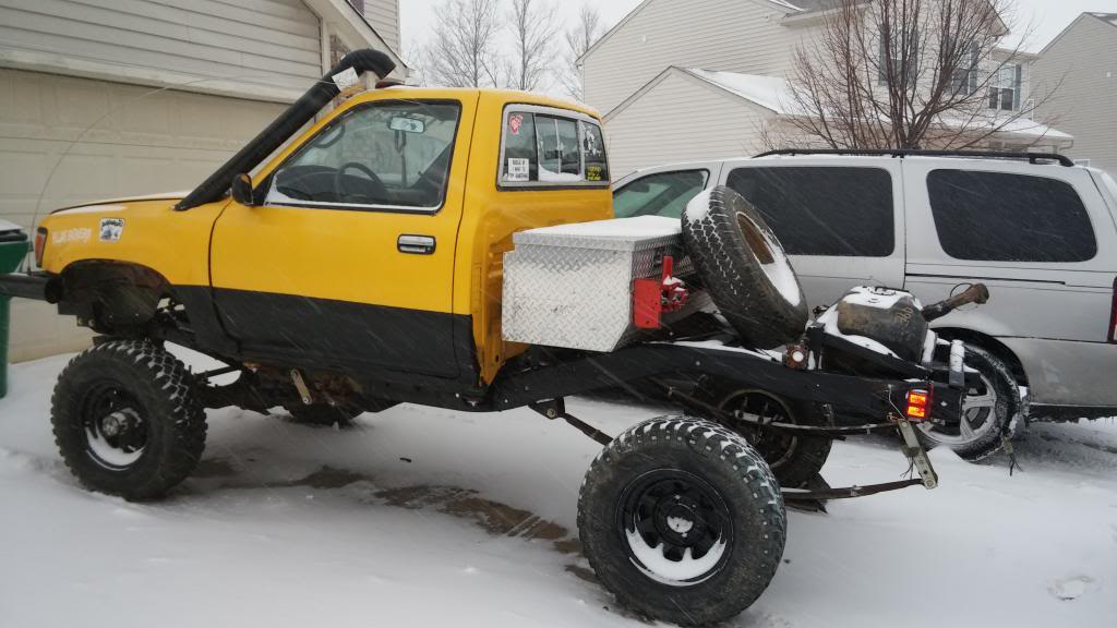

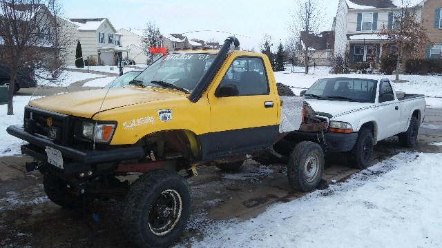

Here is a small update from the past couple of weeks.
Got the front axle mocked up

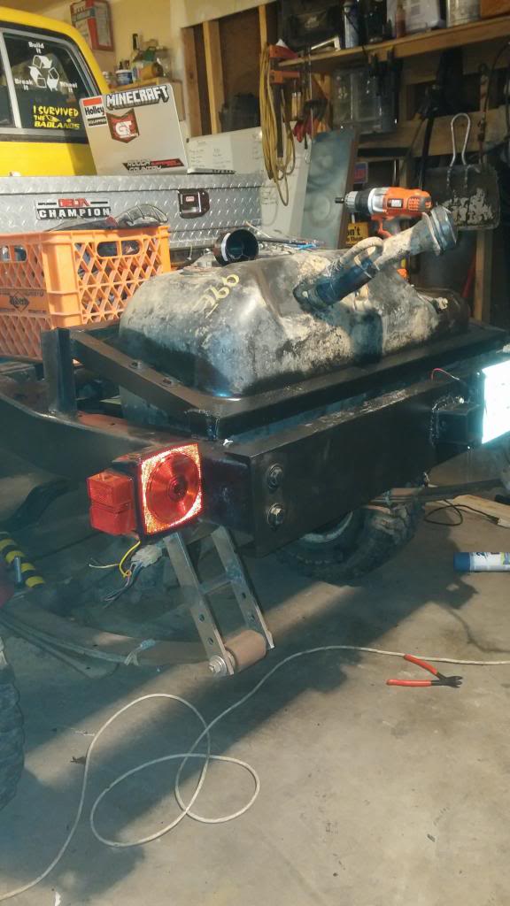

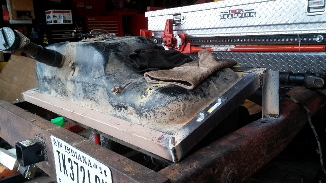

Made a gas tank mount.

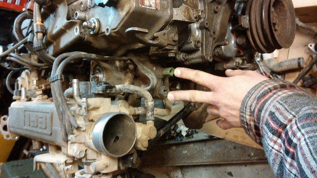

Anybody know what these sensors are called?
I need one of them.
Drilled for the tube on the passenger side

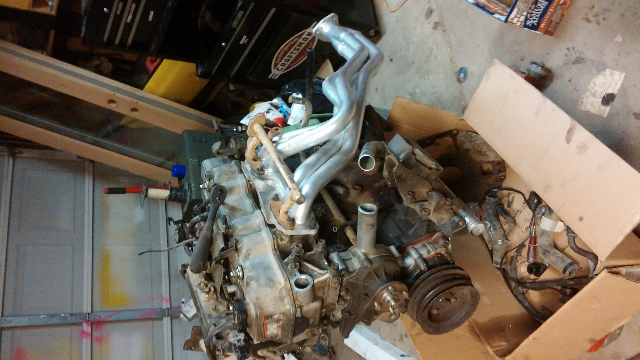

Made a lot of progress on.getting the motor ready
Here is a picture of how it is sitting today.

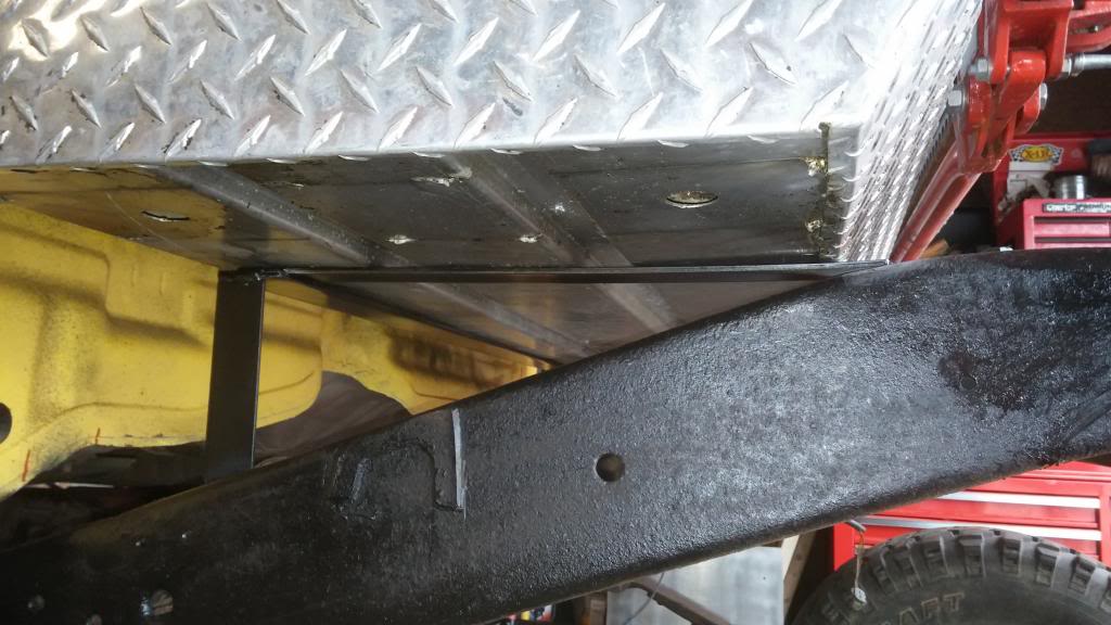

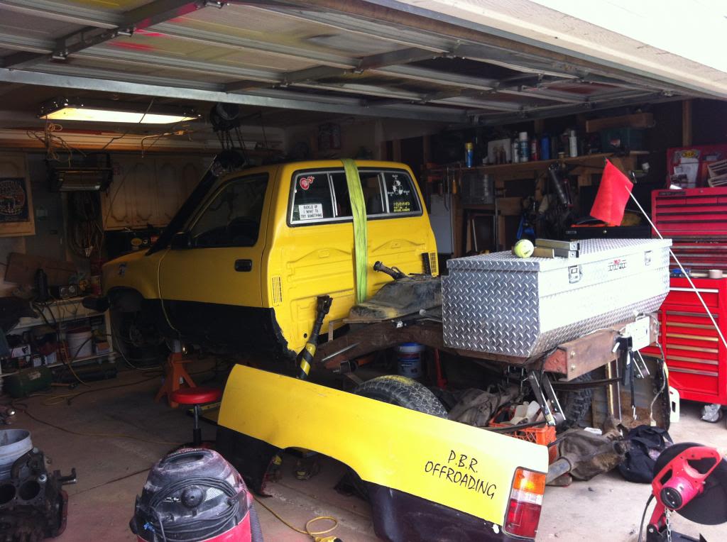

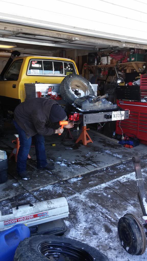

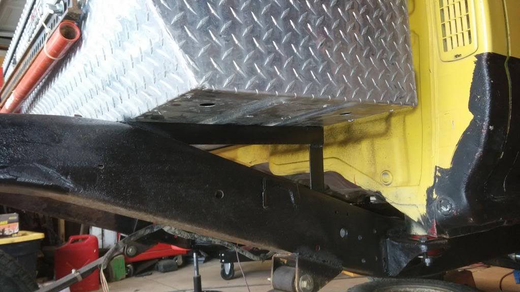

I made a toolbox mount.
mounted some trailer lights to use as temporary tail lights.

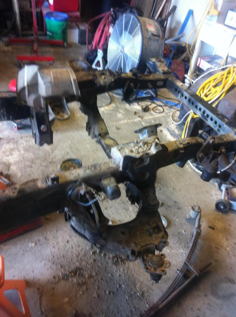

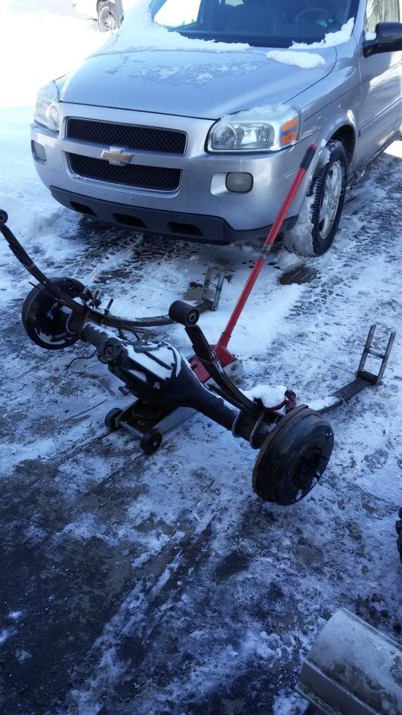

then pulled the front axle.
