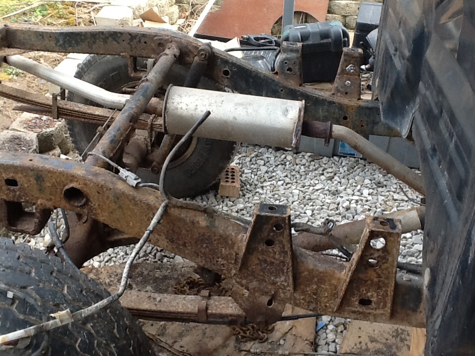

Out of order I know, but I was digging through some pictures on my old phone and found some "before" pics of the frame... "after pics" are at the bottom of page 1 of my build thread:
And most commonly the worst part on these trucks from what I've seen is on the passenger side near the front spring hanger. This was all cut out and patched with new metal.

I live in WV too. I am nea r the elkview area. My frame was rusting in the same area as yours just not as bad. Take a look.[URL="Name:  imagejpg3_zps637d5f5e.jpg

Speaking of your frame take a look back through my build thread, I recommend the POR-15 products. It's been driven through one winter since then and held up nicely. Of course you can't completely stop the frame rust/rot because it comes from the inside out but hopefully I extended the life of it. I'm looking into purchasing a half frame from BudBuilt one of these days for a permanent solution.
