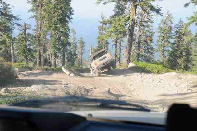

Ummmmmmmmmm ok what would you like to see in the way of pictures?
Mountain Cop's 1986 4Runner Build-Up Thread - "FireRunner"-profile-pic_016.jpgMountain Cop's 1986 4Runner Build-Up Thread - "FireRunner"-profile-pic_017.jpgMountain Cop's 1986 4Runner Build-Up Thread - "FireRunner"-profile-pic_018.jpg
