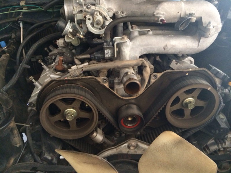

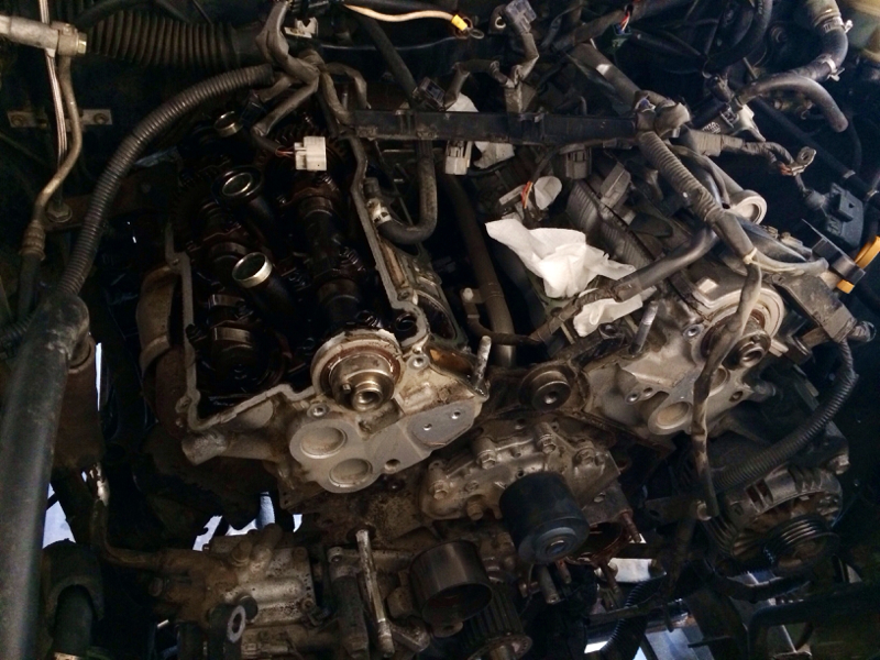

Looks like I am getting some coolant into cylinder #5. Hopefully it is just a head gasket and nothing more. I started pulling the motor apart when I got home from work today. Hopefully I will get the head off in the next day or two. I am just working on it here and there when I have time.

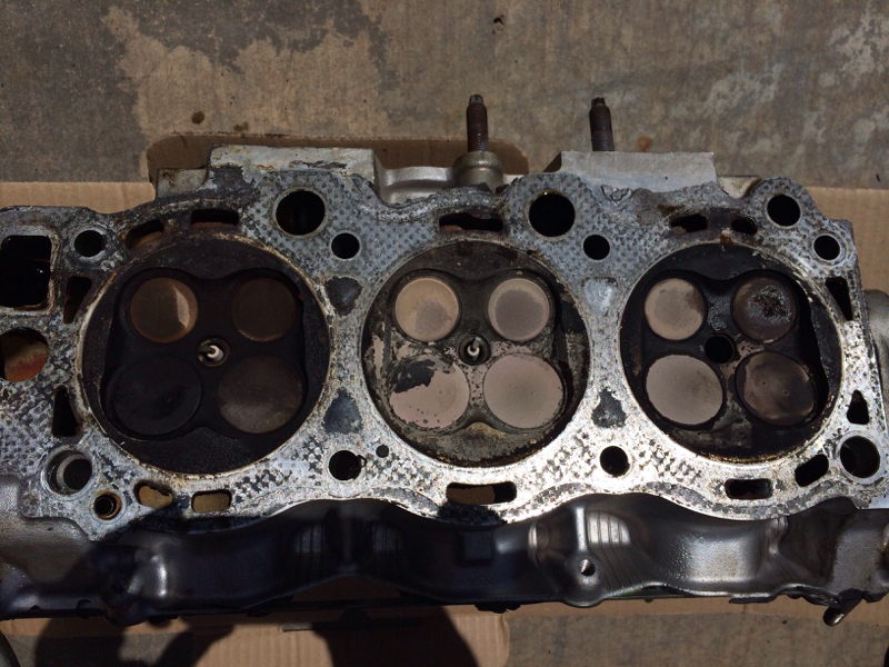

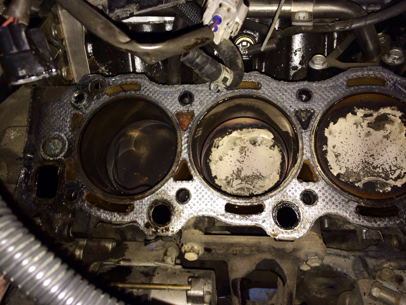

Got the cylinder head off today. Cylinder #5 definitely was wet. I am going to send the head to the machine shop on Monday to have it pressure tested. Hopefully that goes well and I will get it resurfaced and back together.

Are you doing both sides? Given all the work to do one side, pull the second head and send them both out is the smart thing, IMHO.

Yea I figured I have gone this far. Might as well pull the other one off and do both. I would like the peace of mind so if I go on long trips I want have to worry about it.

I just pulled of the 2nd head and sent everything off to the machine shop to be inspected. We will see what happens.

Well all that was wrong was a bad head gasket. I sent both heads to the machine shop and they pressure tested fine. I went ahead and spent the money and got a complete valve job. I just got everything back together and it runs great. Can't wait to take it out wheeling soon!!
