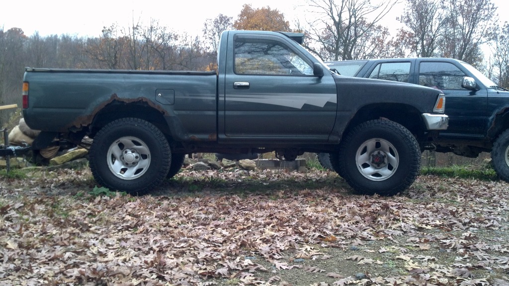

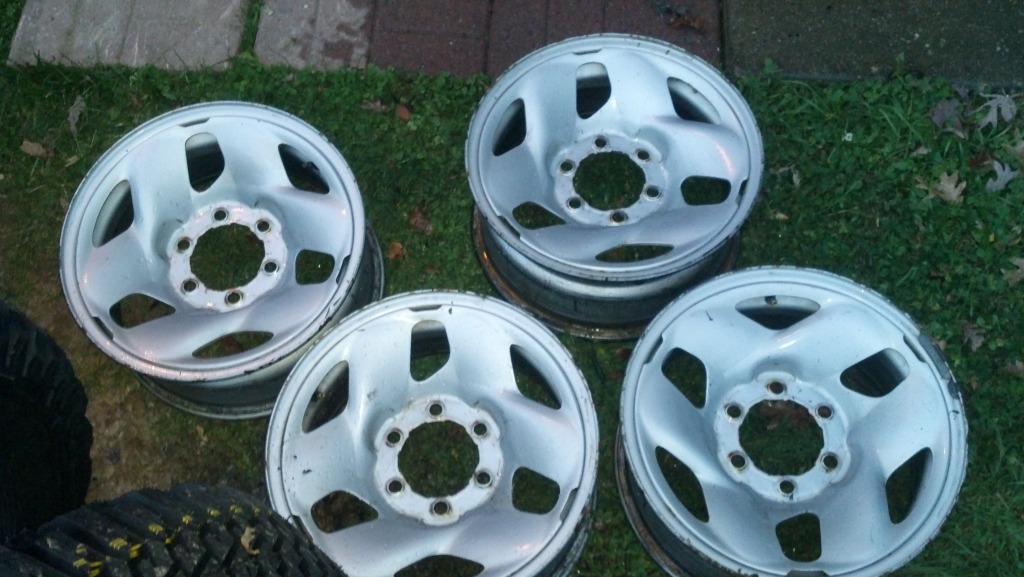

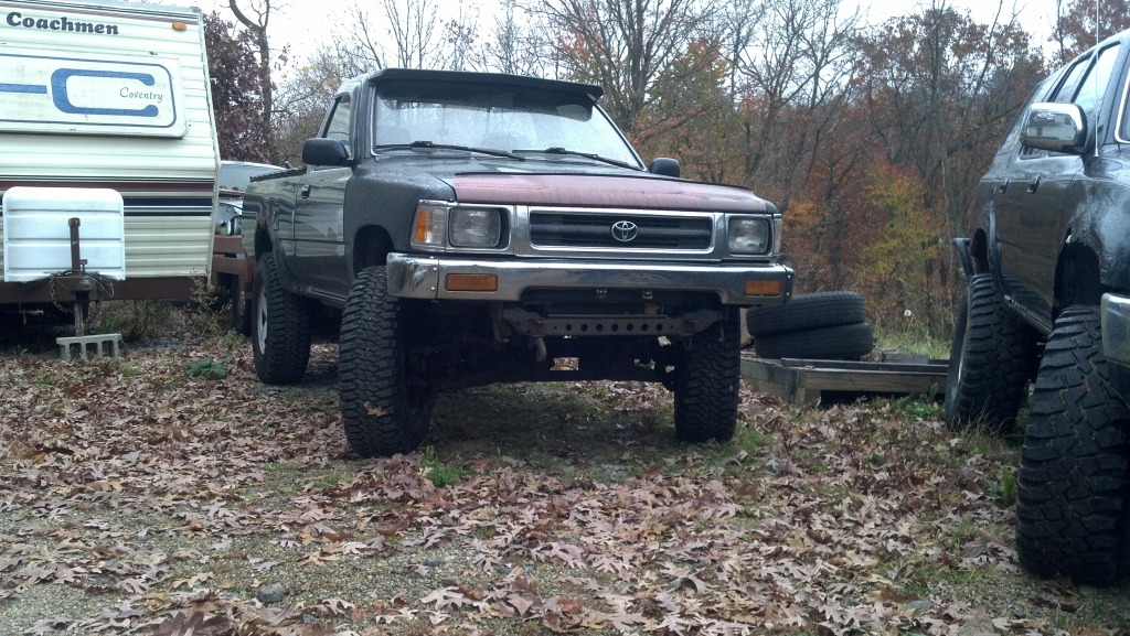

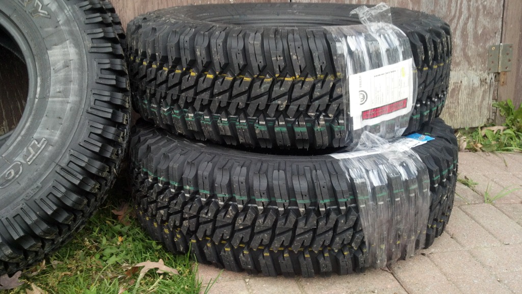

Well not to much going on lately. About the only thing so far are new shoes...
I pickup some steel Taco rims for about 100.00 and then a set of 265/75R/16 Treadwright Guard Dogs M/T (E) with the Kedge grip. After the retread they work out to be about 33x10.5 which is nice. The weight of the 10 ply is a bit much though. I'm thinking each wheel is about 80lbs mounted.
For balancing I used 2000 airsoft pellets in each tire. Works great! have not had any issues with them at all. Every once in a while I get a wiggle and with a tap of the brake it's gone!
I put these on in Oct and ran great this winter!!!

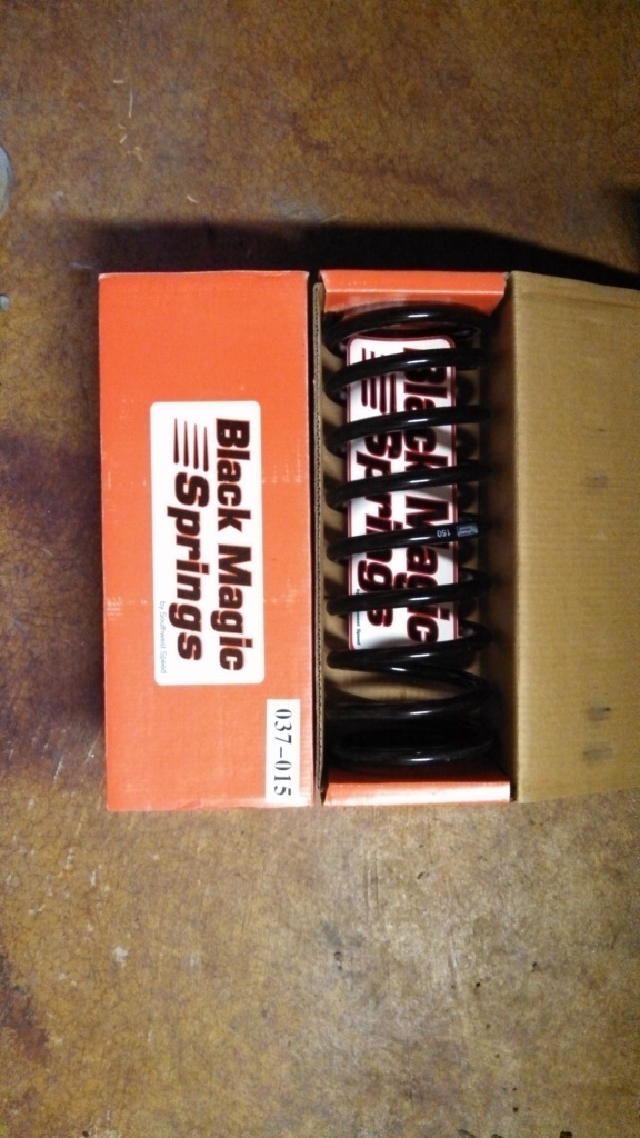

Also just ordered a set of coil springs for the rear. 5"x13"x150lbs Hope to have them for next weekend. Start of another thread!

New Thread!
https://www.yotatech.com/forums/f199.../#post52061906
Soon to be installed...
