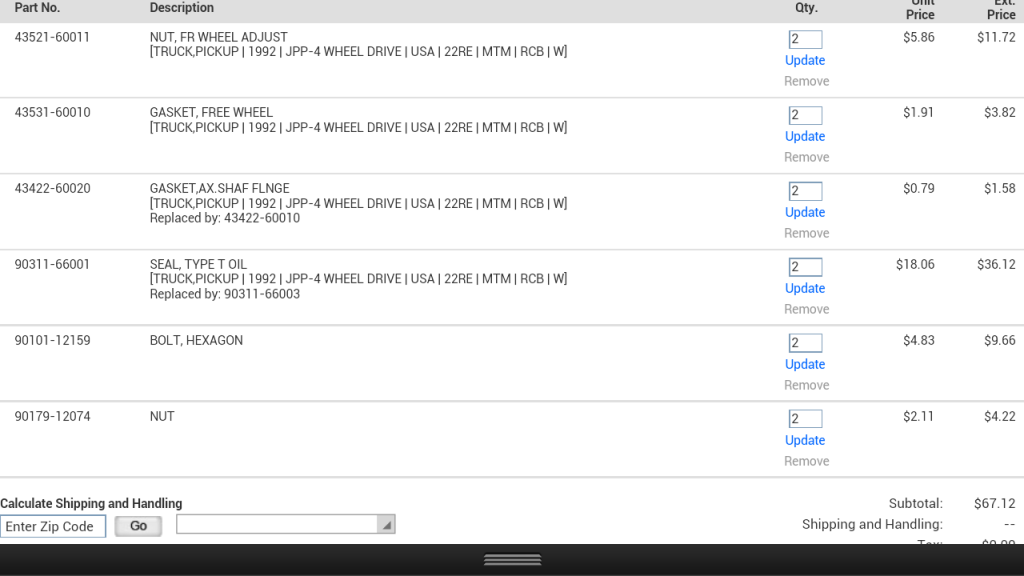

Haven't started working on my bumper yet but did end up having to take my stock bumper off recently cause the corner of it cought my tire and the tire pulled it down, also found out that my torsion bar bolts are messed up so I gotta replace them so I can adjust the height so I can get my camber back straight.
So I priced parts to rebuild my hubs and change out those torsion bar bolts and nuts, let me know if you see something for the hubs missing.

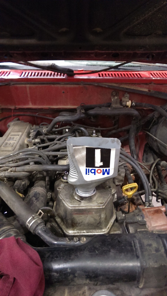

Well worked on the yota today. Changed the oil, rotated tires, and change the torsion bar bolts. Which I will say if your bolts won't turn seperate from the nut no matter how much you soak it and everything. Save your self some trouble and just get a torch out or something to cut the bolts.
Here's some pics.
Wish my truck sat like it is on the jack stands all the time.
Bolts after I got them out. One broke the other of course is cut.
Cut bolt measures 1" sticking out the nut, the broke one was 1 1/4". I set both if the new ones to 1 9/16".
My new funnel specifically for the yota. Fits the fill cap hole perfect. I actually threaded it in some.

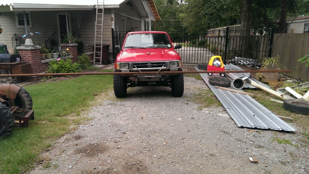

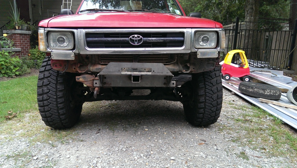

Mounted my winch plate yesterday and stuck one of the 20ft sticks of funding up on it and started taking measurements.
heres some pics.
Mounted winch plate
put 2 c clamps in the plate and slid the tube through it so I could get my measurements.

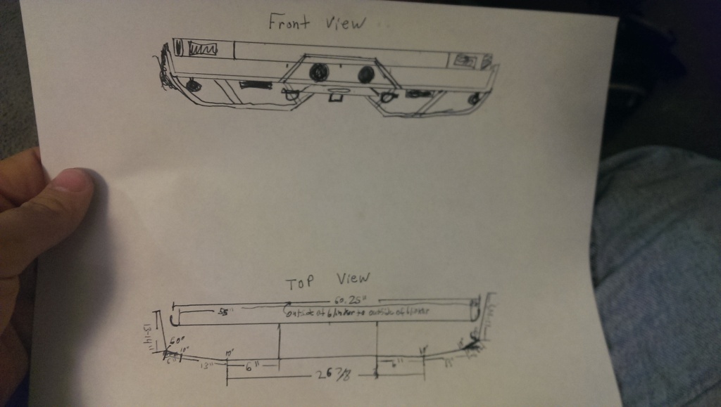

Here's my measurements and a ruff drawing of how it will look.
