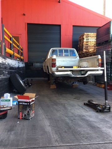

Truck goes up
Off with the wheels
Umm...nope not happening

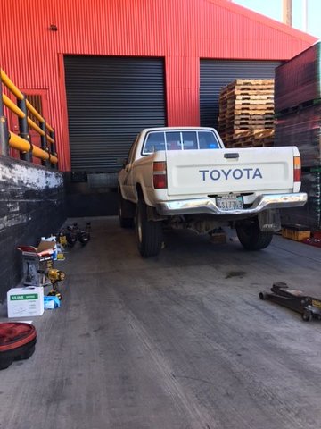

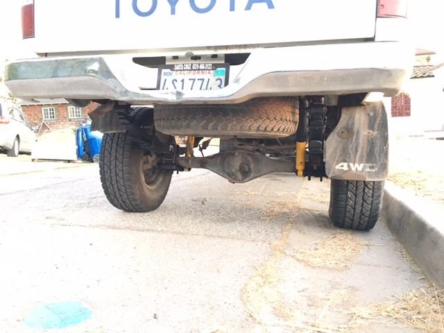

No more saggy rear.
So much more daylight under there.

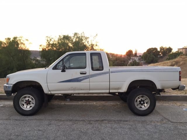

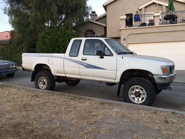

Front is actually 1" lower than rear measured from rim to wheel well.
Oh yea, my rear end went up 6!! inches with the 2.5" OME lift. I cranked the torsion bars in the front a bit and it gained an inch, but is lower than the rear by an inch, we'll see how it settles out.

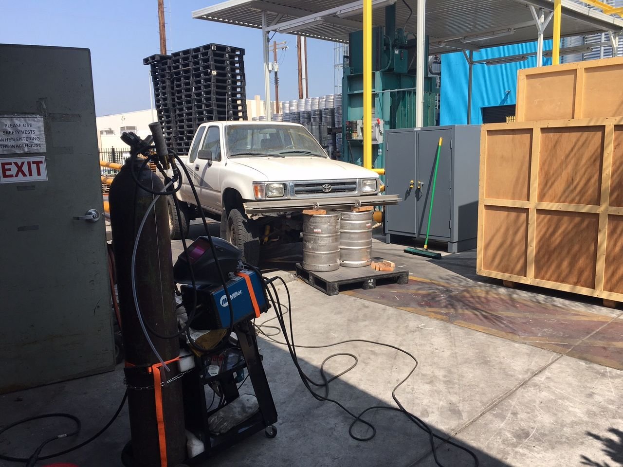

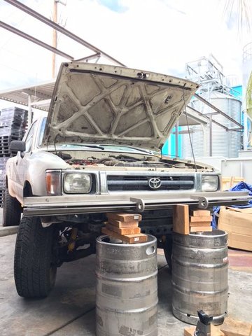

kegs make great support blocks

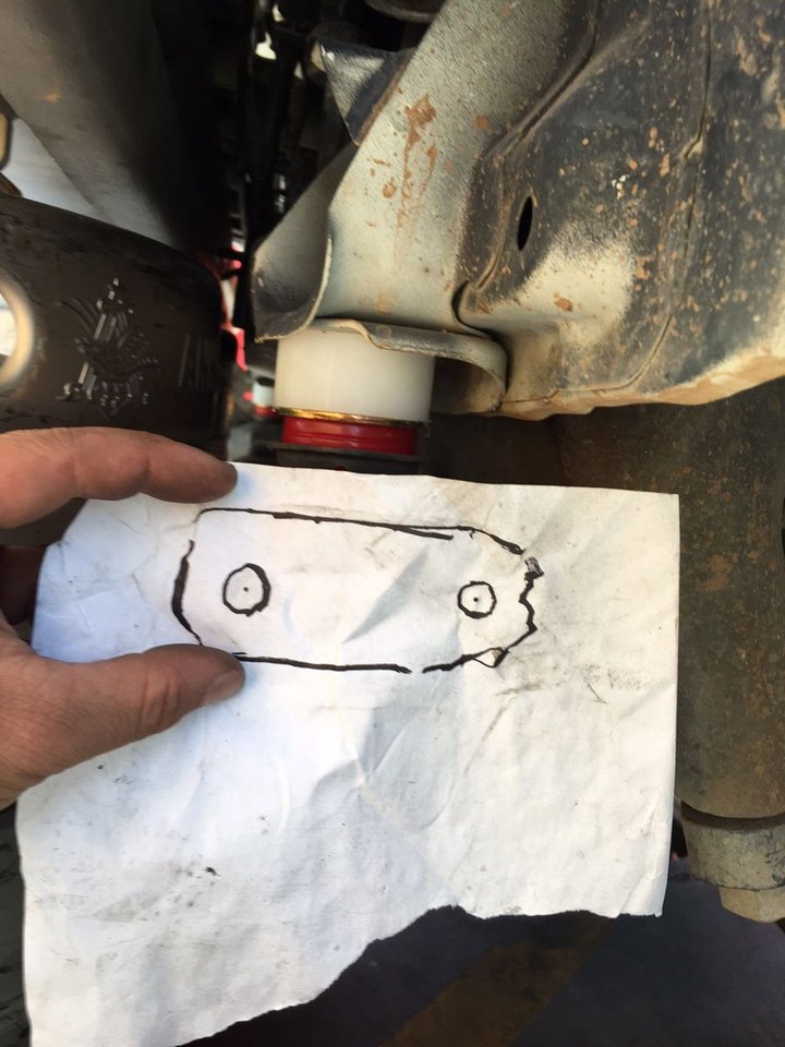

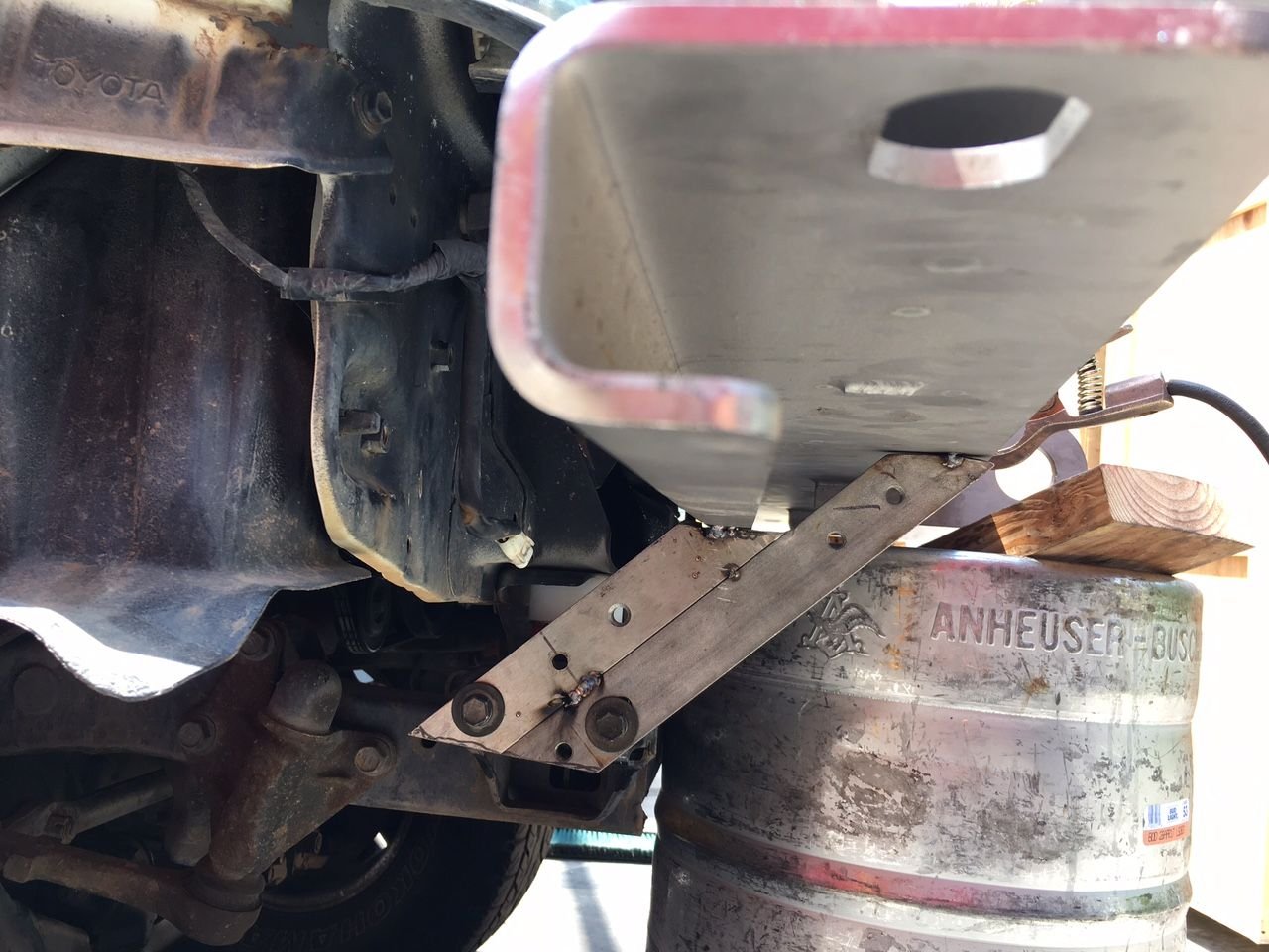

Once I got it pretty much where I wanted it, I made some attachment hardware and began the tricky part. Quick trace of the stock mounting holes
This will translate the hole locations to the stainless bar
Stainless bars tacked to the bumper to check fit

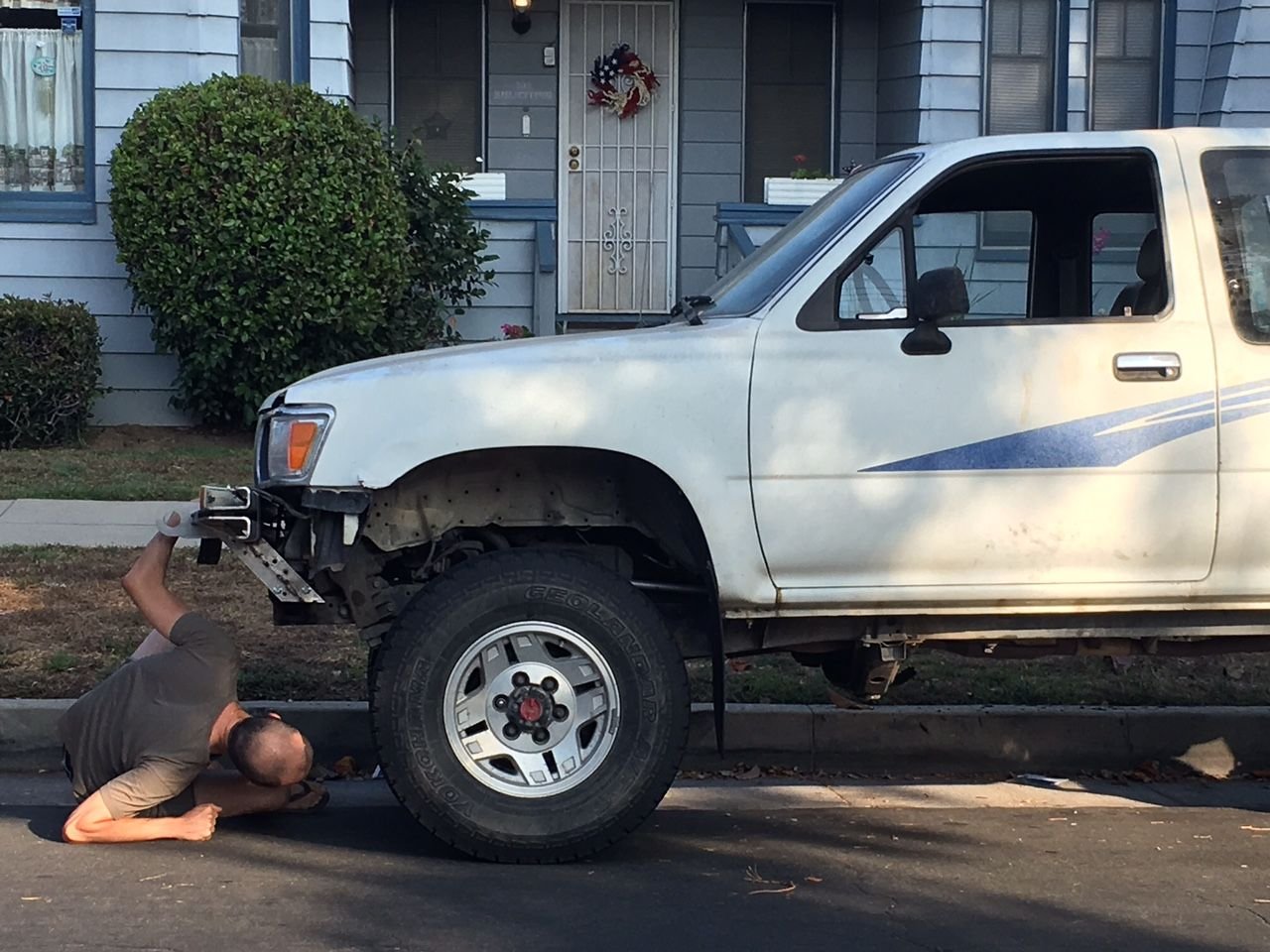

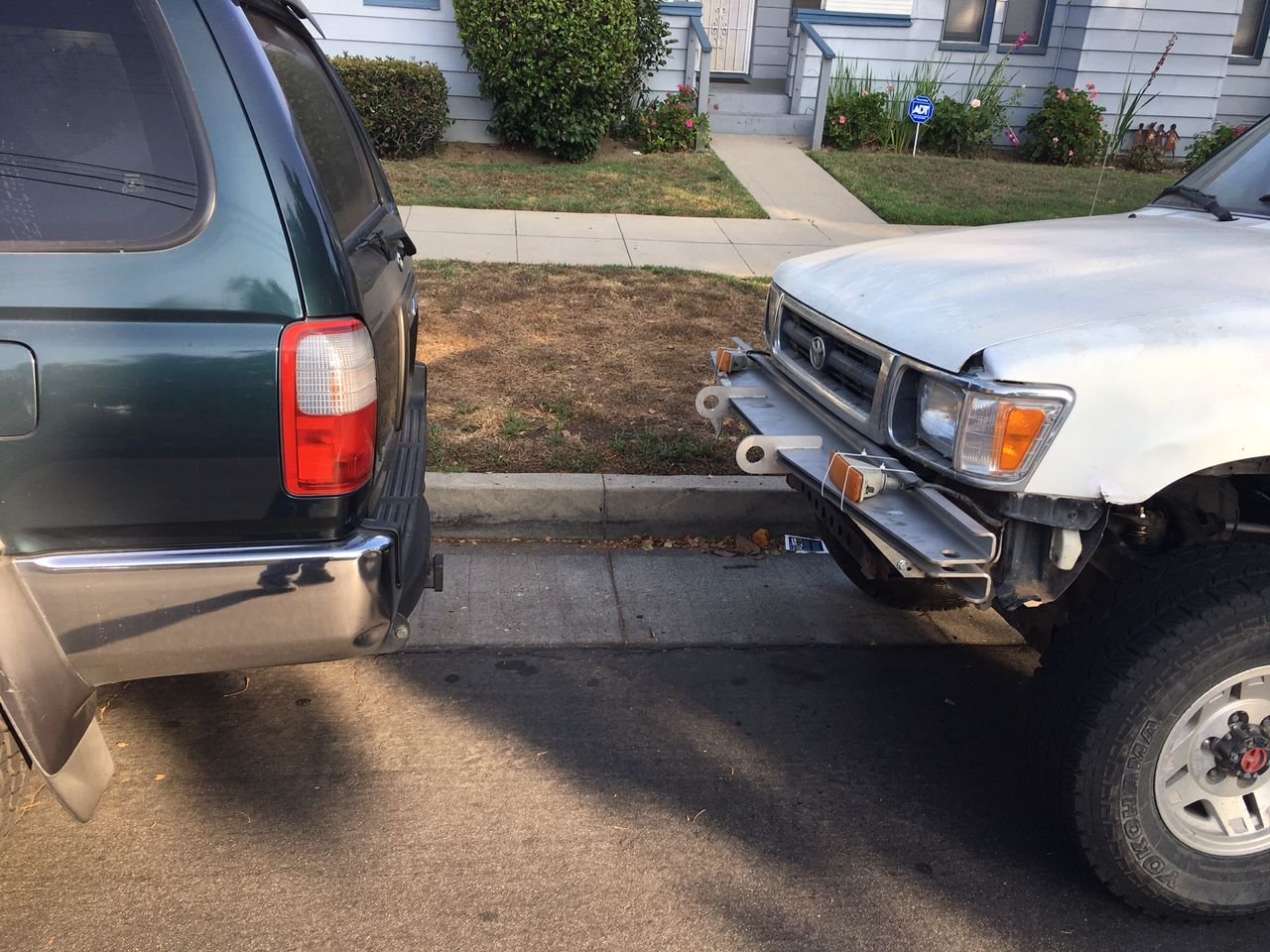

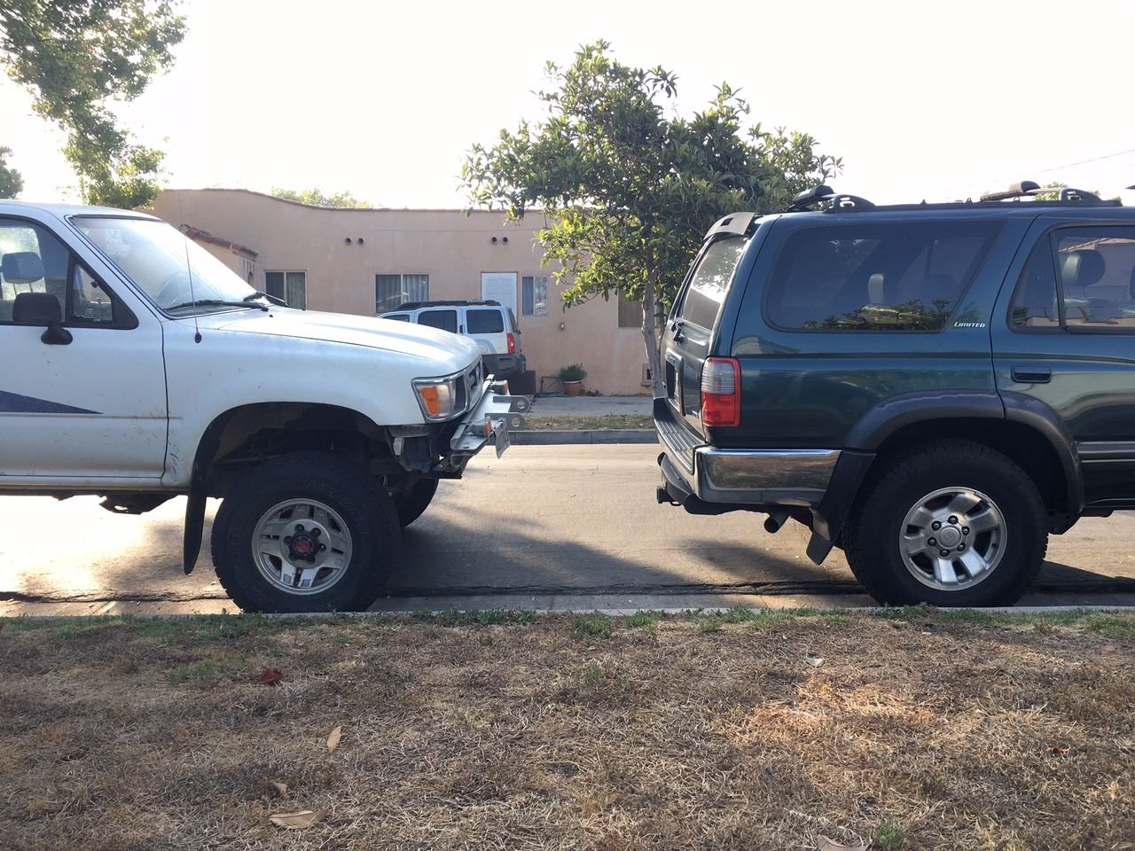

Woops posted a little fast. I still have not made a decision on the blinkers. Comparing it to my friends 4runner
Less of a functional bumper, more of a battering ram.
My buddy checking out the hardware.My favorite thing about this last image is the approach angle. I think by having the bumper this high and tight I did not compromise approach. Hopefully I will find a winch to slap on there by the end of summer, I'd love to put lockers in but decent used winch can be had for a few hundred. I fear lockers are going to be a big spend, I'll want to re-gear at that time which means doing the front and the back. I am leaning to lockers before adding a transfer case, thoughts?
