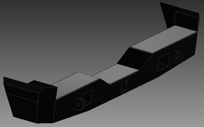

So I could make this

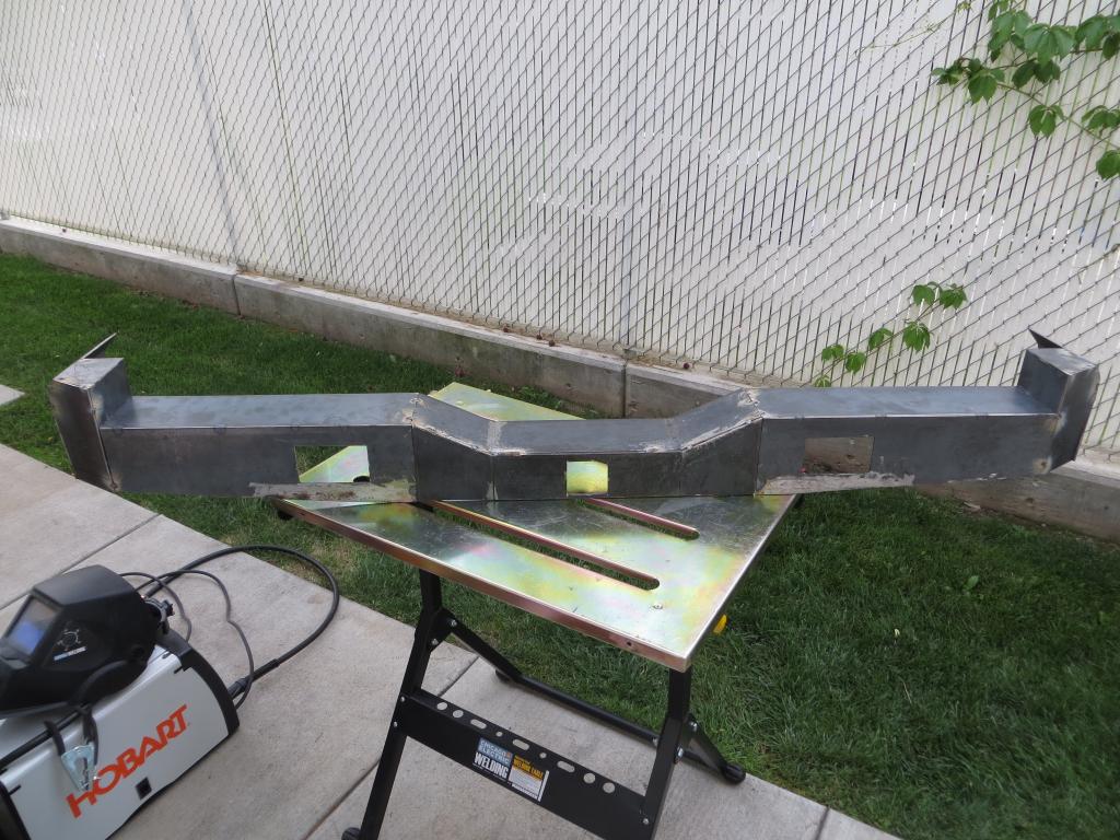

Here's how it sits now, all tacked up and ready finish welding
Still need to machine out the D-ring brackets, cannibalize the old hitch, and get some tubing to beef up the mounting to the frame, but I'm loving it already.
