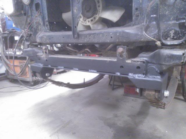

i was looking for a brake to bend my front hanger i built to convert my IFS to a solid axle. instead, i was given the OK to use the one at work. it is a very dangerous tool but it did the job.
i am doing a similar setup as this low clearance design.
the usual setup is this
which is square tubing to drop the leafs about 2in. the only other debacle i have now is to either put the front rear leaf spring bushings through the frame like stock, or weld on a hanger below the frame.

Hey Buddy!
I really like the Idea of the Low Profile hanger. Looks like it would be easy to make especially if you have access to a Brake.
As far at as the rear goes. I would go through the frame with the Tube kit. I am going to order the Jig to use on Richies frame, so we all can use the JIG.
Scrollin through your thread, I thougt hey, this guys front end looks like mine! Wait a minuet...
Thats a Sky Hanger, if that helps for you to recreat one. The thing about the low clearance hanger is it it lacks the support the bar gives in the normal hanger. The front of the frame is pretty weak, and you can see mine has been plated. You might want to do the same, especially if you plan on putting a v8 in there.
http://www.sky-manufacturing.com/cgi...y=TOY-UCFH-001
Go through the frame with shackle bolt. If not it will sit pretty tall and you may have pinion angle problems.

that would be awesome. at my "work place" i have access to all kinds of tubing and pipe. if i can get an OD and ID of the tube going through the frame, i can make that myself. then its just a matter of buying the correct bushings.
is that your truck?? i was scrolling through pirate and saw the thread. i was looking for ideas on how to recreate the usual setup, and noticed this new design which appears to be very simple. all mine is, is a 1/4 plate 3in wide that i broke according to the measurements on the thread i was looking at (bolt holes 3 1/8th center to top). ill have kornhusker take a picture and post it next to his.
also, that plate piece is just the front right? that was something i wanted to do to install my bumper but i needed 2in so i used some square tubing instead.
