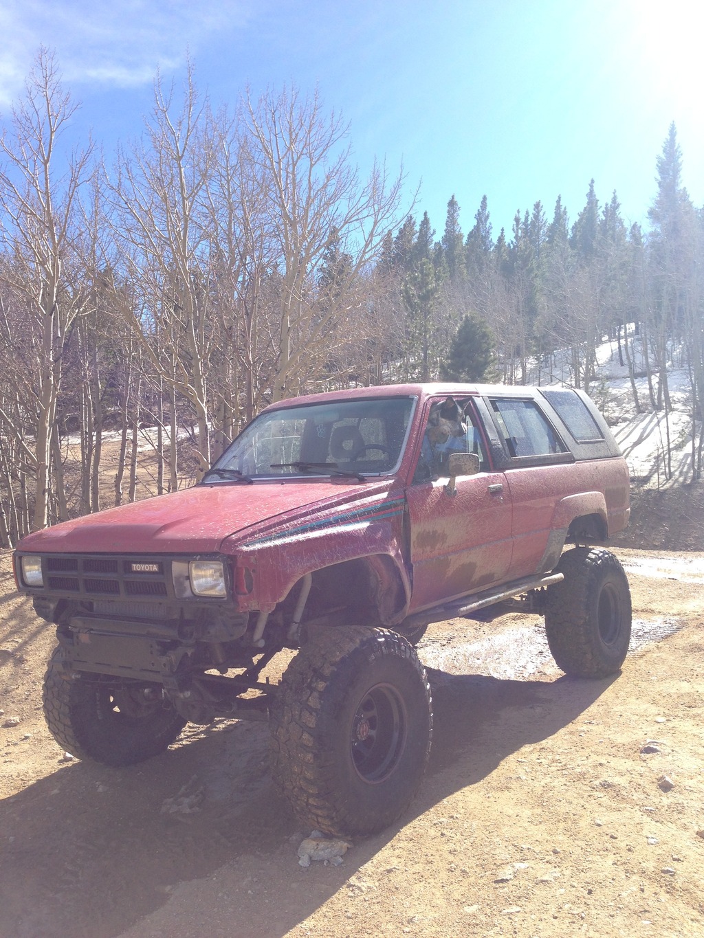

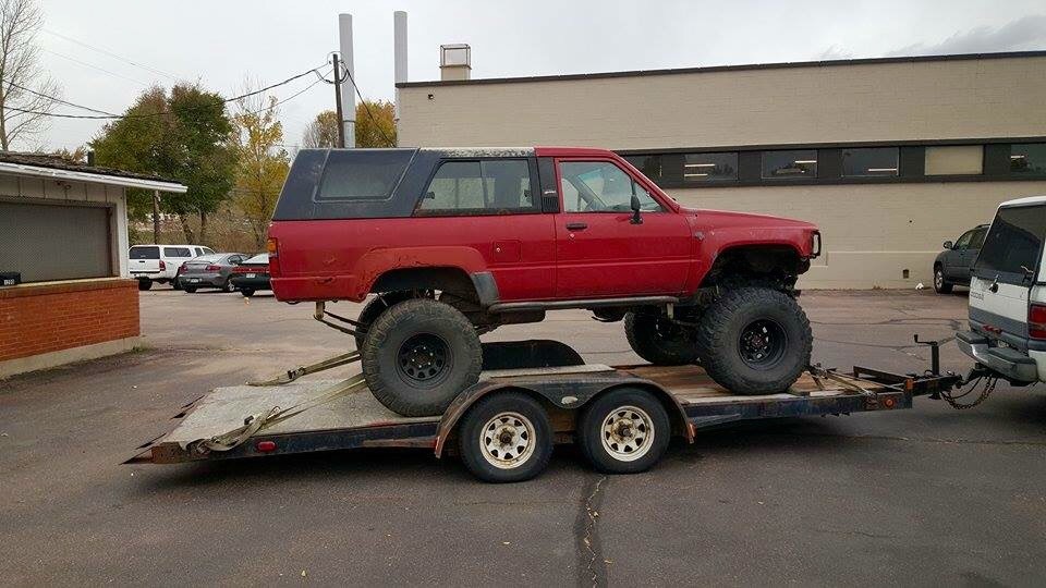

Hey everyone, so after building drift cars for 6 plus years and not really paying attention to 4wheelers and crawlers I finally got hit with the bug. Never thought it would come but it did. Iv been a huge Toyota guy for the past few years. My main current project is a 1jz Cressida. Along side that is my is300. Up until a week ago I was also daily driving and building a jzs167 gs300, I actually traded this for the runner. Okay on to the good stuff. It's a 86 with full leaf spring conversion and single axle conversion. High steer kit (no damper I need one) Has a 5/6 inch lift on 35s. Also has a 3rz out of a 96 Tacoma. The rig needs work but is all really there. Rear pinion angle needs to be set has a nasty vibration right now. Front driveshaft has a spacer in it which I hear is a cheap fix so I want to extend that correctly. Front shock hoops were jank welded on in completely the wrong spot. Rear shocks are blown. Rear shackle mounts need to be moved back. Worst of all right now it has a cracked bell housing so I'm addressing that first so I can drive it. Previous owner also welded rear diff which sucks. Here's some pics of the rig. Name:  69035A4E-7E3A-4074-AA3B-0A6BEBBDD165_zpskduxstr4.jpg

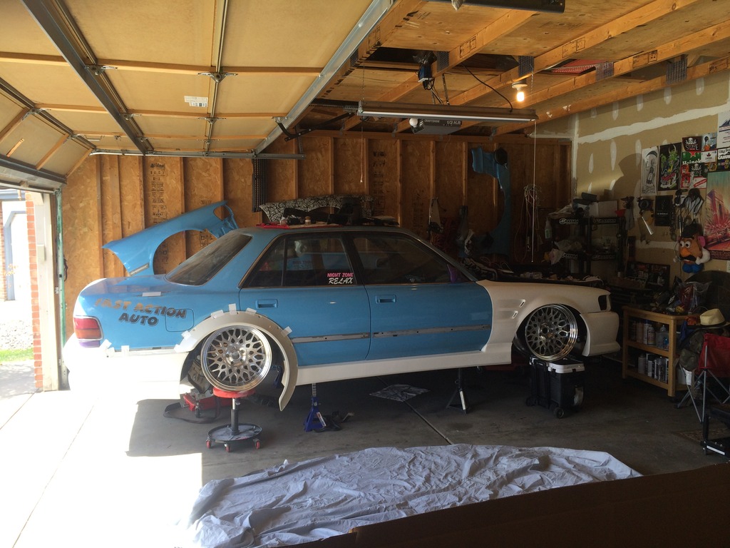

some pics of the Cressida gs300 I traded and my is300 Name:  DE93DEB1-F8E1-4510-BE33-642C119FEB9C_zpsn8gjwbbn.jpg

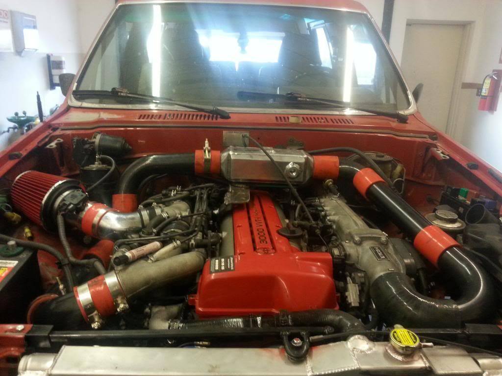

just go ahead and shove that 1j under the hood you will be glad you did. sweet cars by the way
i put a 2j in mine and hate driving stock 22re's now, so dang slow ha ha.

thanks man, it was a fun build. im not sure on the trails yet, the last two years i was rocking the 2wd auto that came with the engine. i just finished a r154/r150 hybrid swap to get 4wd back and it hasnt snowed since.

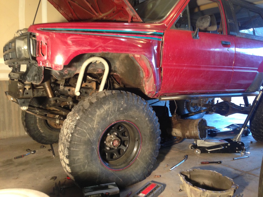

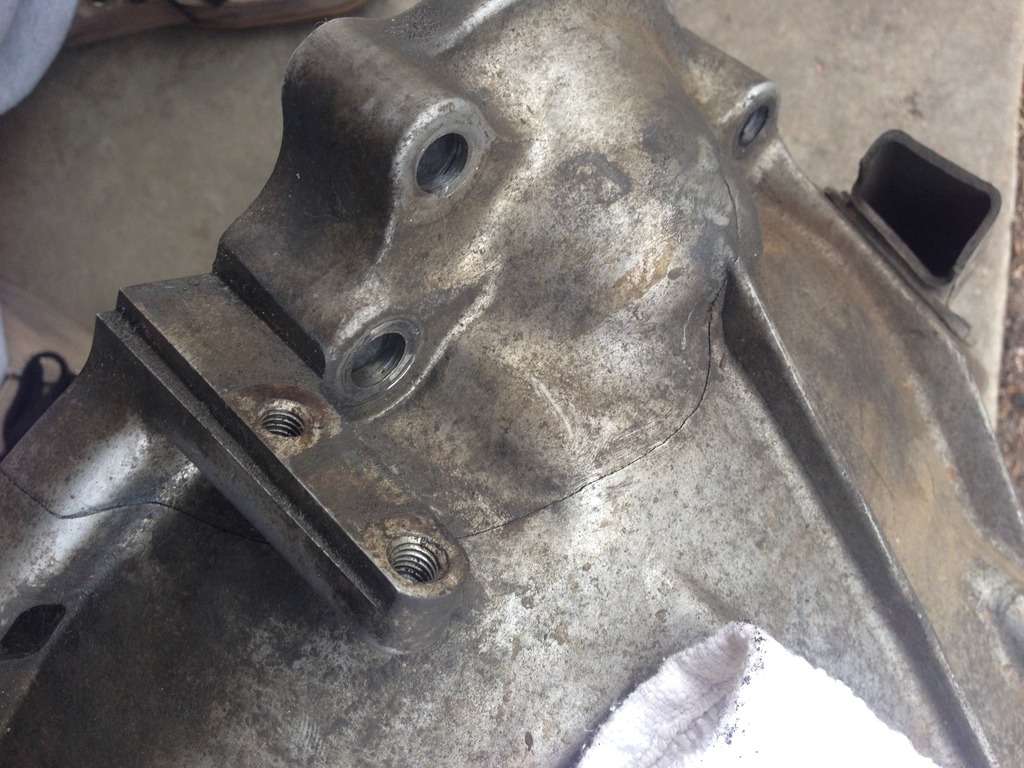

^haha rifht!? The dude was like yea it was dark and I barely had light and I wanted to get it done and leave so the welds aren't good... Like wtf why even do it? More work for me. Anways I finally dug into this thing, it's gonna be in revival mode for a few months just fixing and cleaning up previous owners work. Last 2 owners ran it hard and put it away dirty on top of no maintainence... Lol. So first on the list was the cracked bellhousing got that out and swapped yesterday. ˟˟˟˟ what a heavy bitch that tranny is. Name:  2E326263-5D43-4E8D-9252-0ACCA54B4C0C_zpsefnk1ewh.jpg
Here's the crack it was so bad because it was between the slave cylinder so the clutch would spread the clutch. Name:  A487E18A-BB55-46C2-8E2E-ED57E0783E01_zpsoj1ay5w4.jpg
Next up is correcting the rear pinion angle and then this thin will be pretty road worthy, except for the welded diff.... Previous owner of course. Gotta ditch that soon for the sake of these 12.5s lol. Celebratory "got to drive it to work photo with my coworker" Name:  8D344964-6303-4CFA-945D-9339B3929E6F_zpscg6o7ooy.jpg

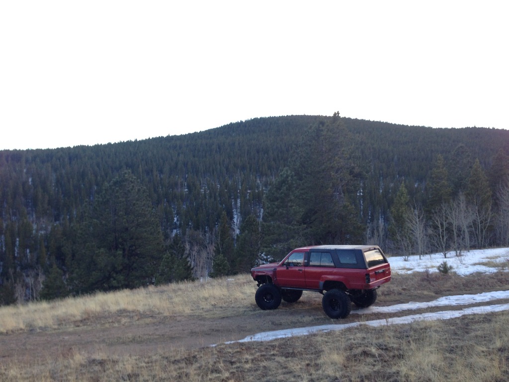

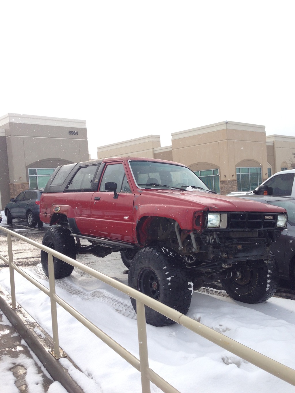

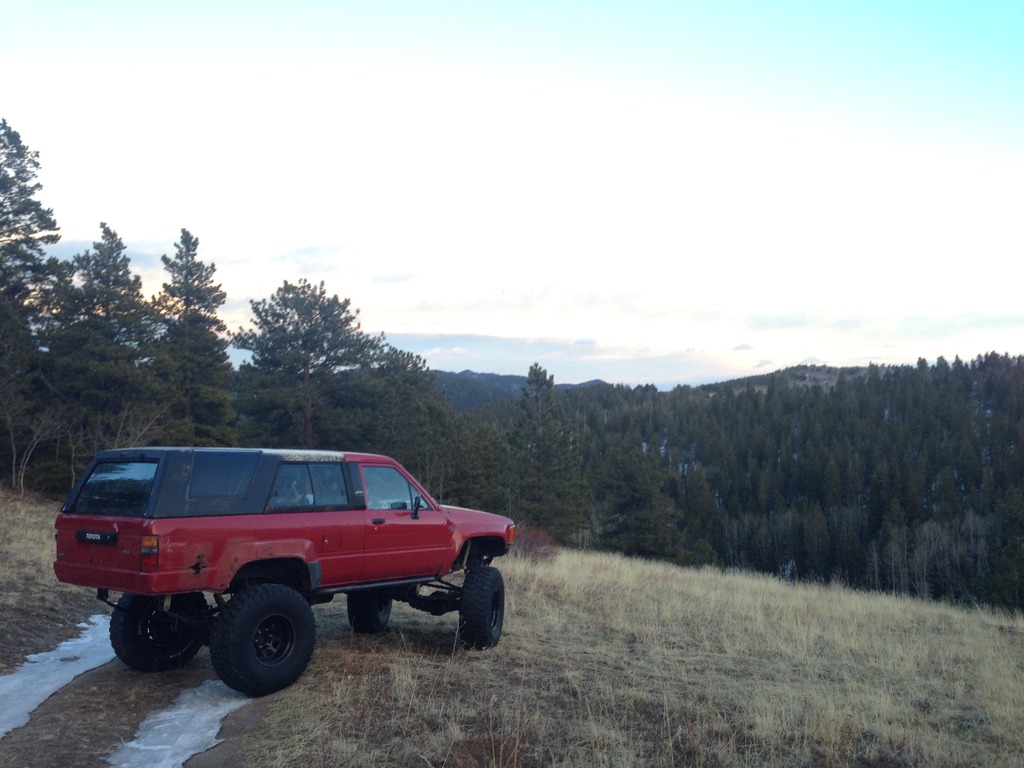

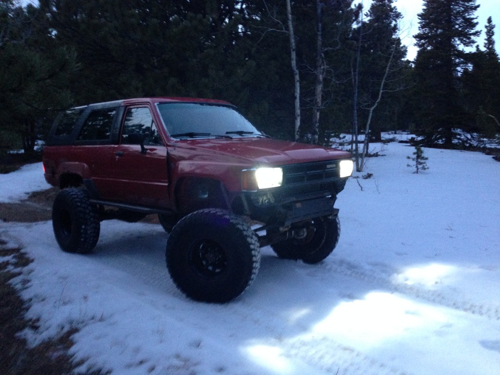

So iv taken the rig on two trips so far, central city area for those who are familiar with Co. I'm proud of it but it does need work. First off I realized previous owner installed the front springs backwards. I read the double wrap is supposed to be up front and also where it mounts to the Axel is off center, I was thinking how close my tires were to my firewall/inner fender. The shorter side is out back sitting the whole Axel a little farther back. Anwyhow here's some pics from the 2 trips. ˟˟˟˟ty tires held me back big time... Thinking about tthe course's for my next. Name:  EEEB01DB-8AA7-41BD-8F3F-2E6B4D0061C3_zpsl5w8l3n2.jpg

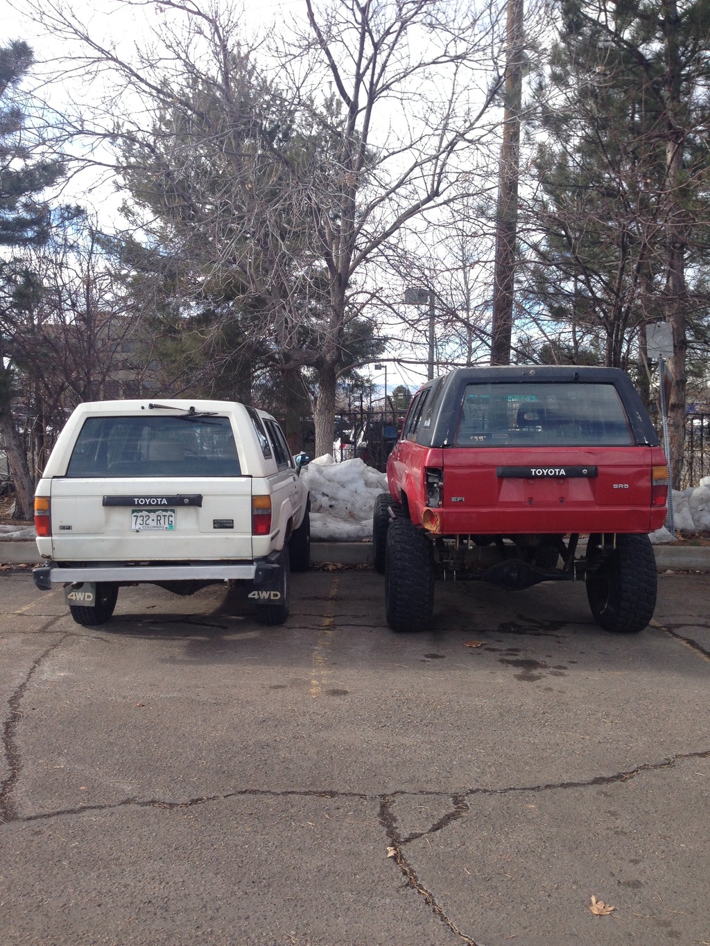

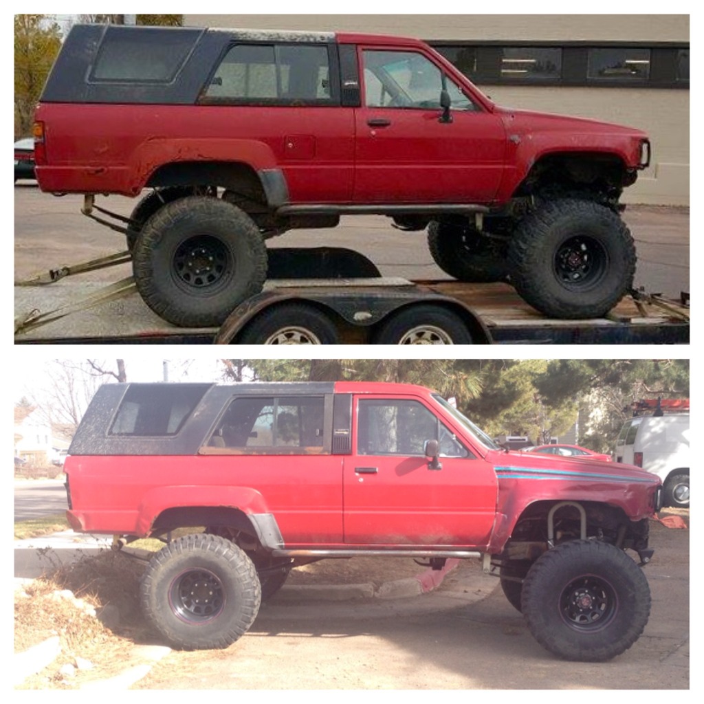

Got a bunch done yesterday. First off realized my springs were trail gear and not all pro ( probably why there bone rattling stiff) I got some random 3 inch lift Toyota leafs from the yard and pulled one stiff leaf from each pack and replaced it with the new soft I got. Front lowered about an inch. While up front I also flipped the springs around this set my Axel like 4 inches forward haha. Need new front driveline now. While doin the rear we saw someone previously had driled new center pin holes on the perches not only were they back farther they were off center... With new leafs and centered correctly the rear Axel moved back about 2 inche maybe. Ride is 10x better now the need for shocks is actually prevalent now when before on the stiff springs it handled fine without them haha. Rear is down maybe 2 inches too. Still need to move front hanger inward to correct front shackle angle and also delete the double shackle that's going on in the rear and see that shackle angle
Here's a before and after you can see the difference in wheel base. Now il be able to approach obstacles without my front hitting before my tires. Name:  B441FA48-99F0-478E-B4DB-055C449F8690_zpsqbp99kh5.jpg
