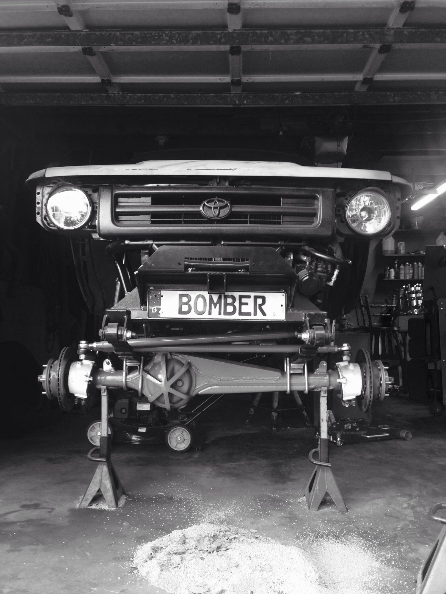

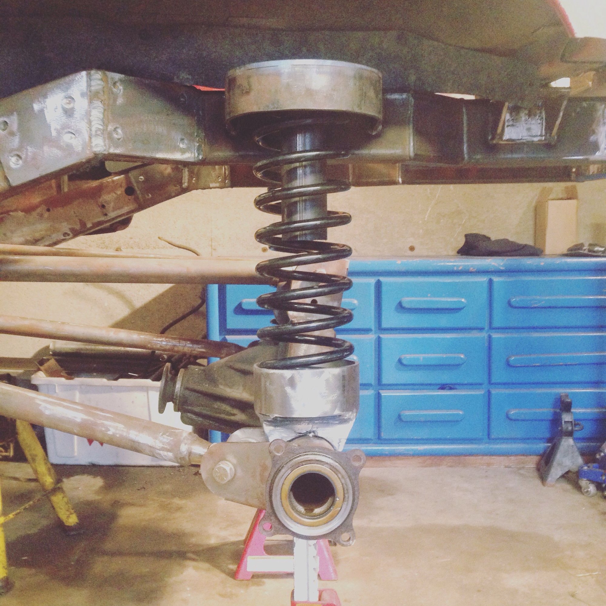

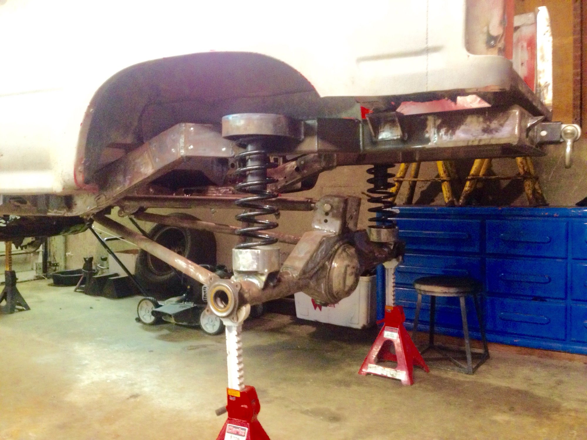

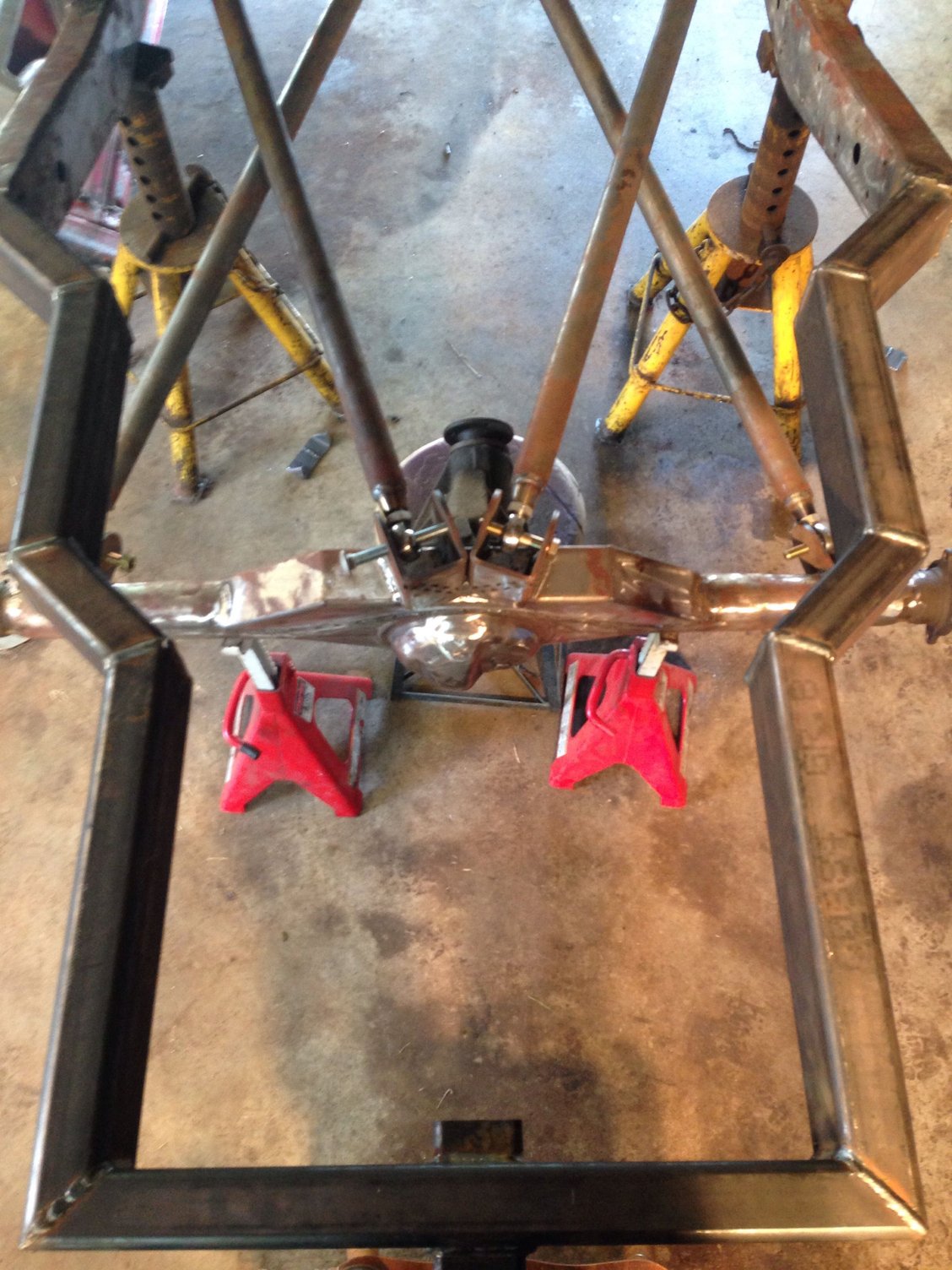

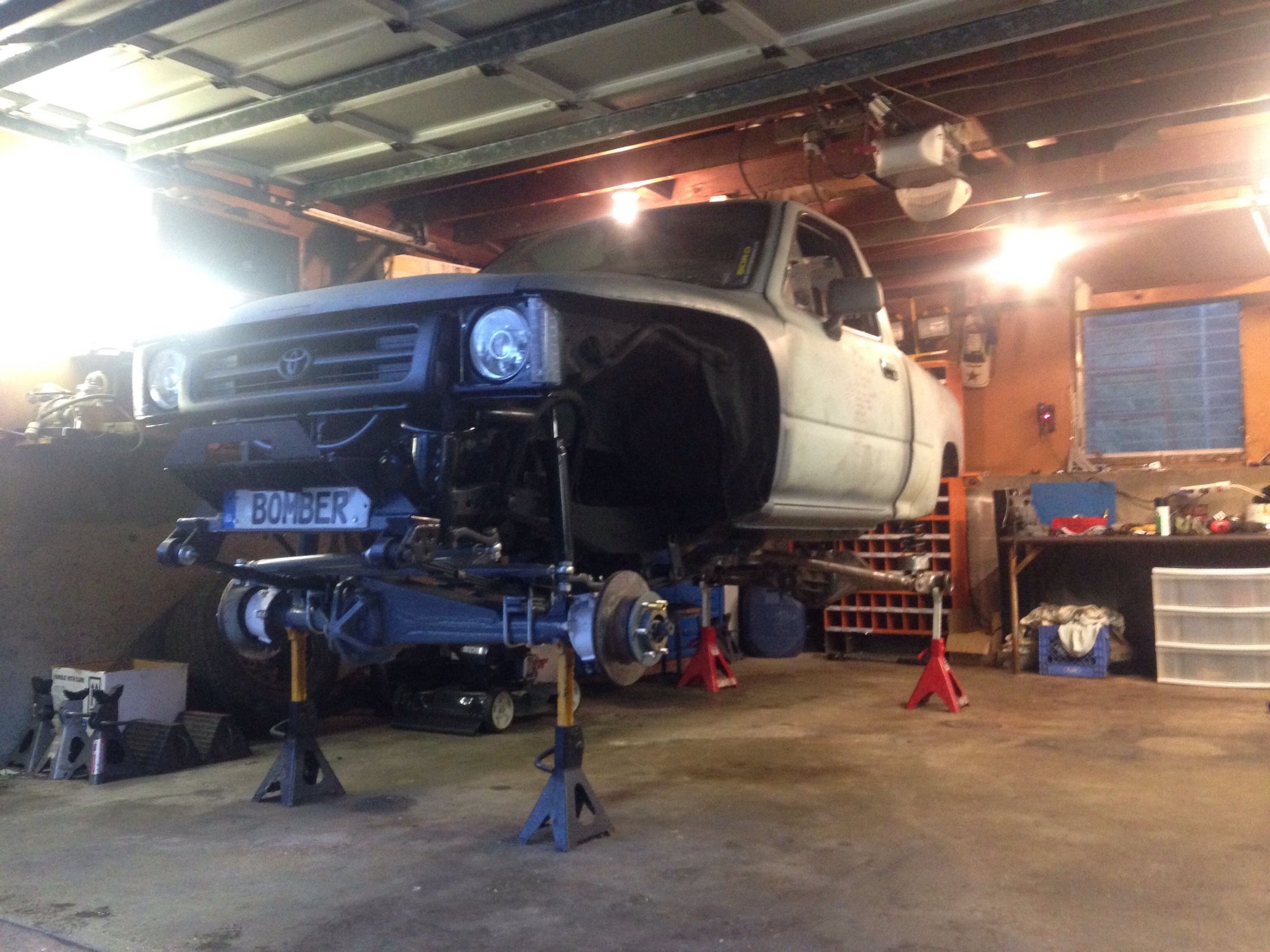

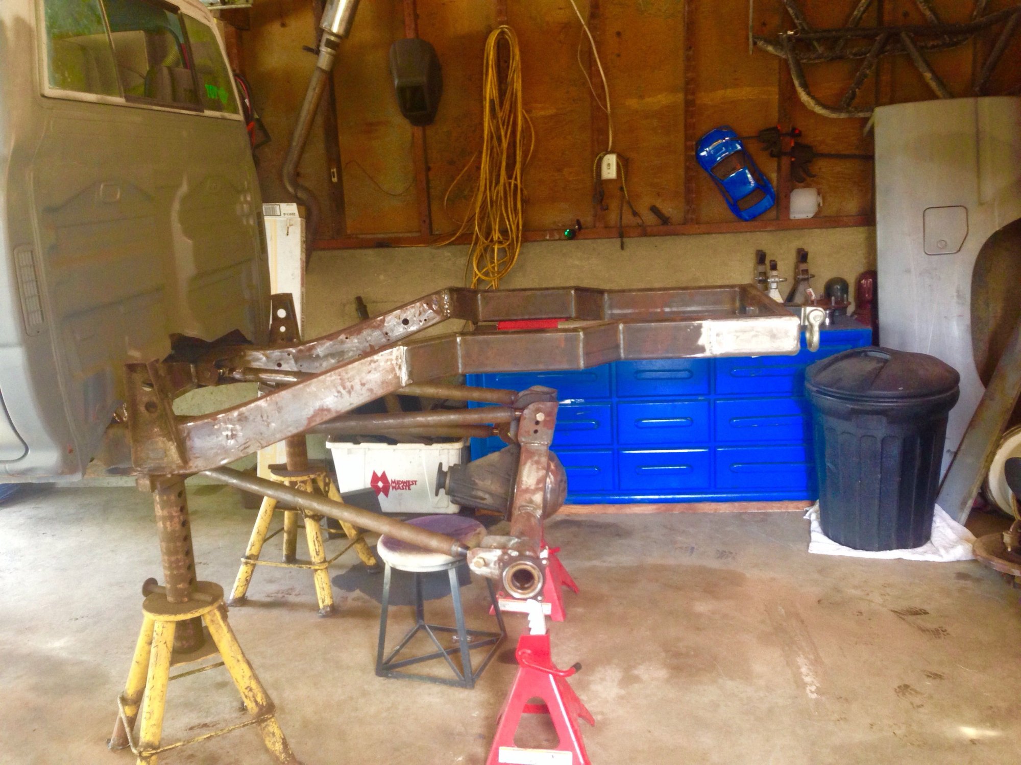

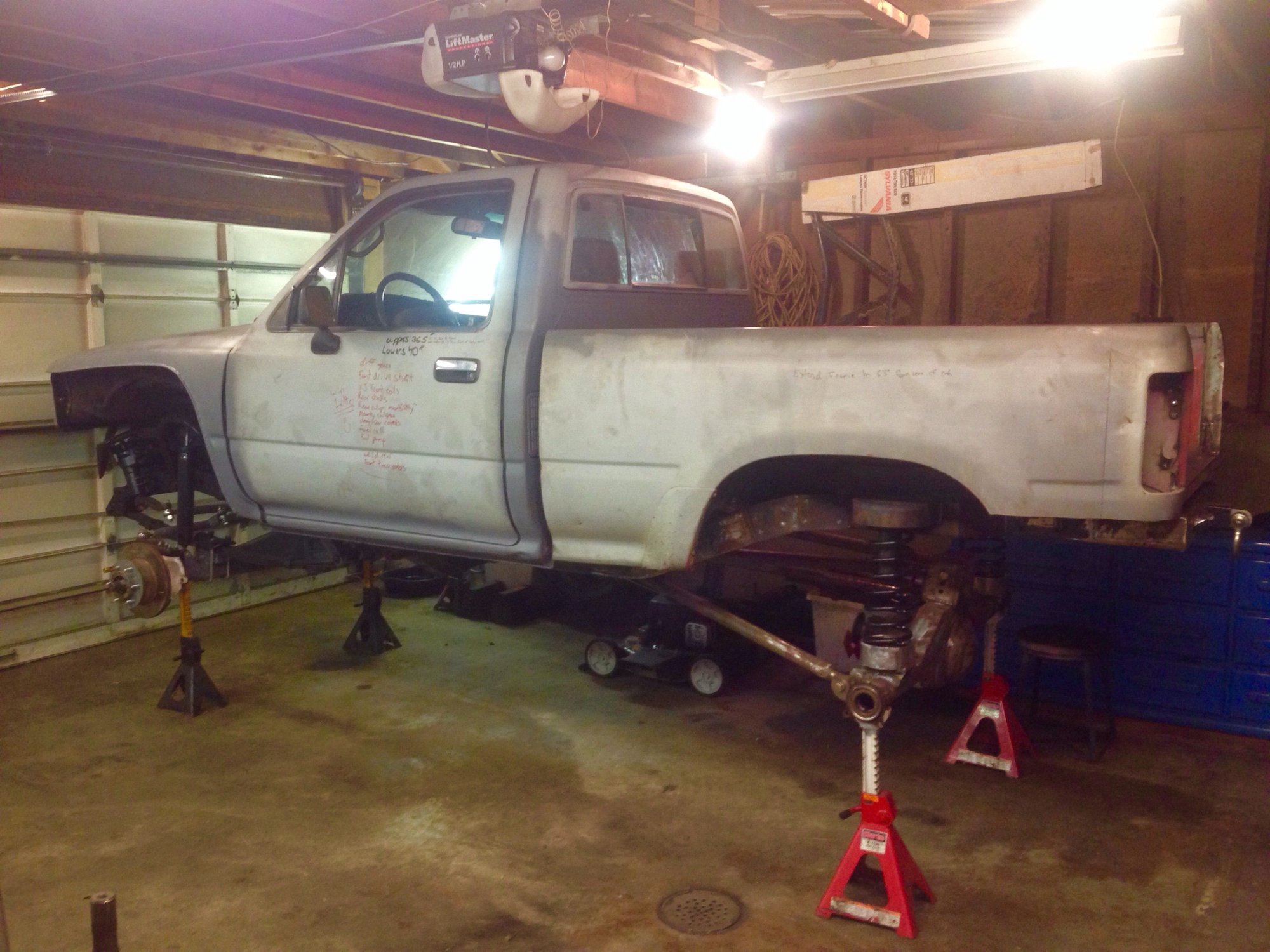

Hey guys this is my 93 short bed, iv been building it for almost 2 years off and on. Last winter I cut all the ifs shaved the frame and did a sas swap, I extended the front 7 inches and threw on hydro assist. For the rear I built a custom frame after the cab to let me run a 20 inch dove tail and a 12.5 inch bob and not have frame stick out. I also ran a dual tri four link. I also built he frame the way I did so you I could runs the coils out board and run a taller coil spring.
Hacked the whole front core support out and tubed it.

whoa can i get an shot looking up underneath your rear to see what you did to the frame from from the gas tank back?

looks good, are you going to brace the upper coil buckets some more?
