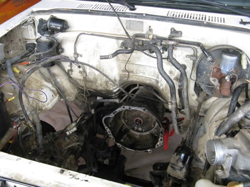

Since im in the middle of the frame swap while i had my engine out i was gona rebuild the motor cuz Its been smoking white and blue. Smokes white untill it gets warm then burns blue everytime I give it gas, specially when i sit at a light or something idoling then accelerate. I thought my compression would be low due to valve seals,head gasket, head, rings which would explain the smoke but I just did a compression test and it turned out ok. #1=165,#2=160,#3=160,#4=155. I thought it was supposed to be around 170-180 so it seams ok. The main reason for this post is to ask what you guys think I should check for. I want to get this figured out before I pull the motor so while its out I can fix whatever needs fixing and then it can go straight onto the new frame and not have to be pulled twice. the only step I didnt follow for compression testing was doing it at running temp so I might go warm it up and try.
Old Apr 27, 2009 | 05:33 PM
Justinvd's Avatar
Joined: Oct 2007
Posts: 832
From: B.C
Retried it after I warmed it up #1=170,#2=168,#3=182,#4=150
So all went up about 5 pounds except #4 cylinder went down. I only drove it around untill the thermostat opened and warmed up to running temp. I got some weird looks cuz I was ripping around the neiborhood with no hood on.
So any tips would be awsome.

hmm#4 looks a lil shady.. have you tried a leak down test?
put a lil oil in the cylinders then check again.
also you are holding the throttle wide open correct?
Old Apr 27, 2009 | 06:15 PM
Justinvd's Avatar
Joined: Oct 2007
Posts: 832
From: B.C
Yeah I tried it with a bit of oil in the cylinders and the compression stayed the same. And yeah Ive been doing it with the throttle open. Im thinking its a valve issue. No i havnt tried a leak down test yet but I think ill be doing that now.

Took the head off and braught it to the machine shop. Apparently my head was in sad shape so its being rebuild and machined and i'll have it tommorow. Ill also ordered a seal kit for my 22R-E so while its out I will being doing that cuz there are some pretty bad leaks. MY engine is totaly unhooked and ready to pull though. Ill have some more updates soon but ive just been dead tired after work and not have the energy to drag my butt out to the garage. I did get another coat of paint on the frame though.
