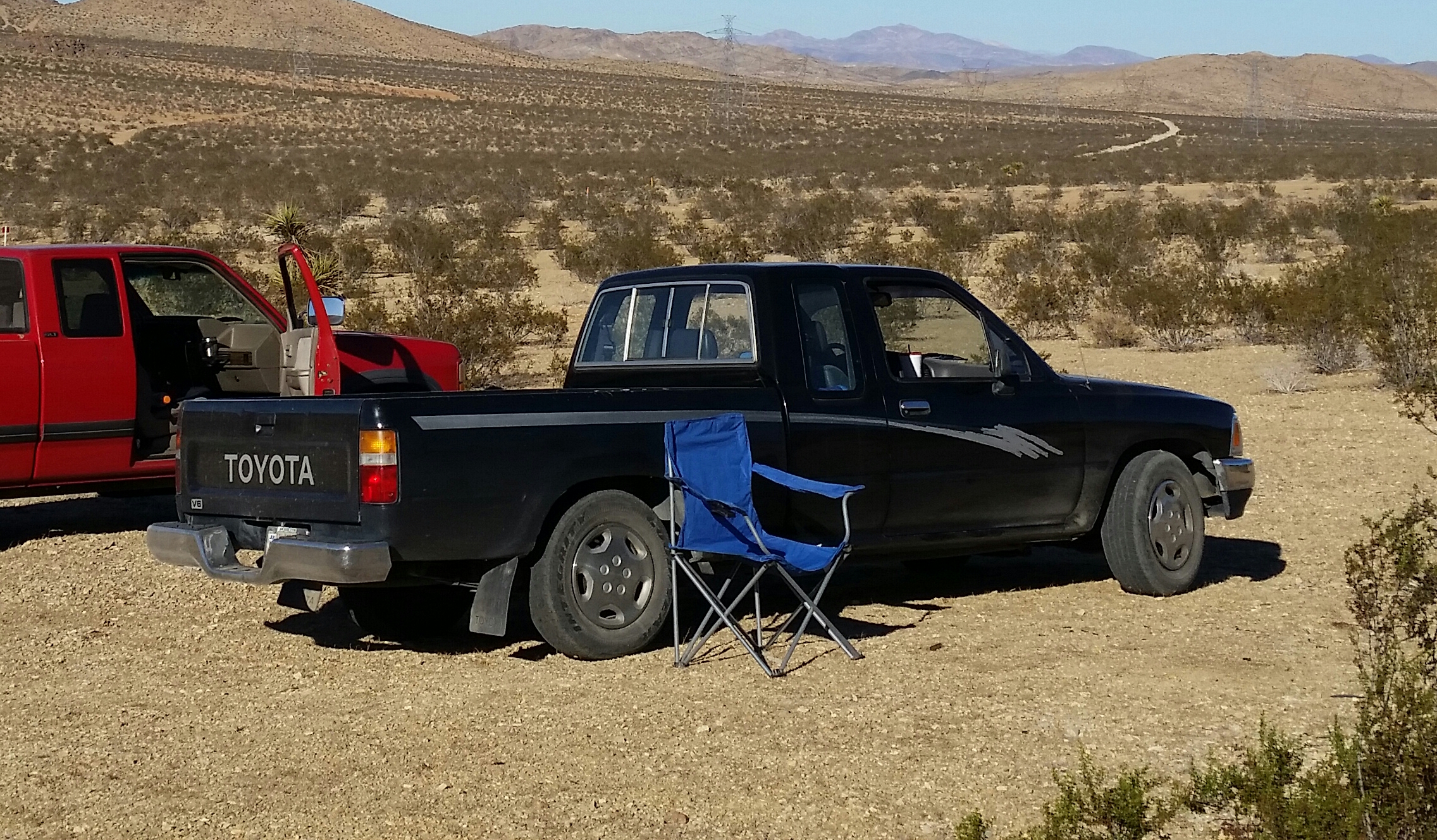

Everythings stock but want to get some good all terrain tires and maybe some shocks. I need more clearance and control on dirt roads. Main question is can I put 31s on it without lifting? Any other advice is appreciated.
Here she is~
Thanks for the replies in advance!

I think you'll have a real hard time getting 31's under your truck. I think 30 x 10.5 is tough but it can be done. You'll need someone to fabricate lift spindles for you. It takes 2 sets of stock spindles to make 1 set of lift spindles. You'll also need ball joint spacers and possibly a 1" body lift. That takes care of the front... Then there is the rear suspension. Plenty of options there. New leafs, add a leaf, Chevy 63's etc. There is a lot of information on here regarding lifting 2wd trucks. Check out my build up thread and also the user "Redneck4life". He just recently did similar upgrades to his truck.
Lots of good info here too: http://www.blowsand.com/truck/

We have a 4runner that we're gona take all the suspension off and put on my truck so its suspension not leaf springs. And 6 lug is better but the tires I have are going a little faster than expected so I was hoping I could make some 31s fit in the mean time cuz the wheel wells are so big
