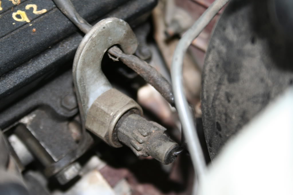

What the heck.. So reading up on YT I found the little Knock Sensor Trick you know the one with the hole on the engine hook and an extra knock sensor. I think the knock was sensing my header leak, I guess.(yes i know its a temporary fix till I get to freshen up my valve cover and intake gaskets)

Here is the temporary Knock Sensor

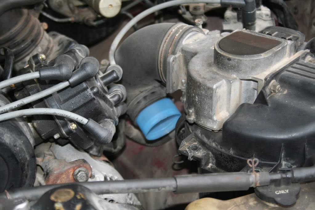

Here is a "mod" if you want to call it a mod. I took off that extra box thingy under the air box. I think it has to do with smog or something. Living down here in south texas you can get a inspection sticker for only 20 bucks with out them even taking a peek at the vehicle. So to plug up the hole under the intake hose, just go in your house, grab the top off your wife's secret aerosol under arm deodorant and stick it in the hole.

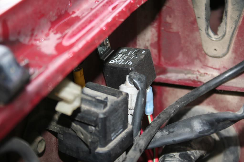

So the truck would crank sometimes, not all the time. So thinking that my ignition switch is bad and the inability to locate the starter relay. I installed a $3.99 relay. Now my truck starts every time!
