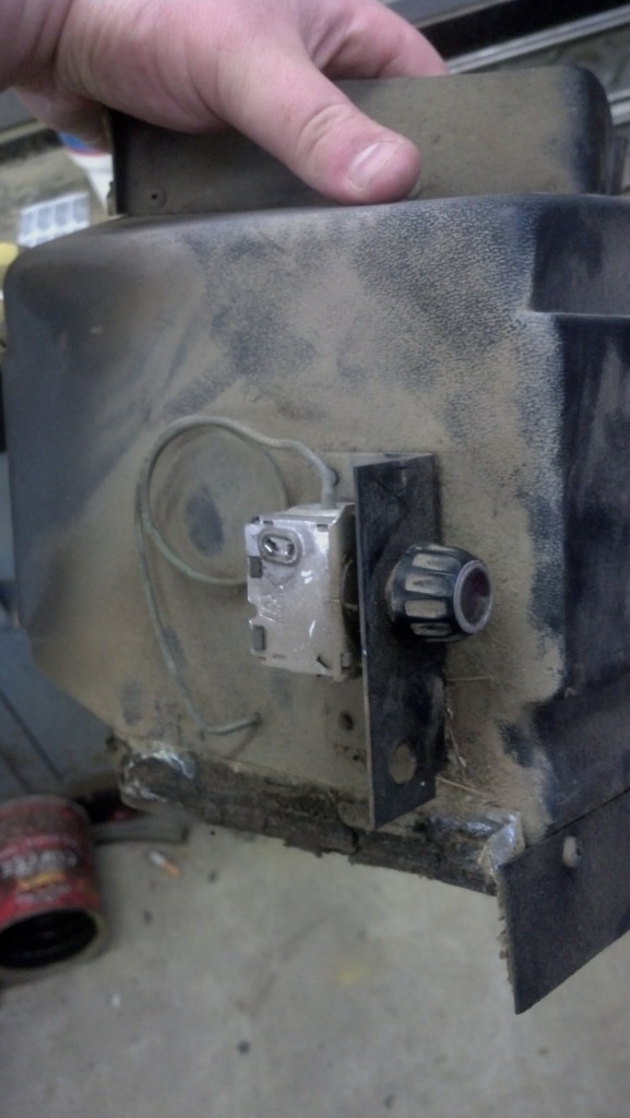

got out and tinkered with a few thing today. I have had a problem with the heater blowing hot air so I dicided to see if I could find the issue. I pulled the blower motor which was lose and letting air escape around it I think thats also where some of my fan noise was comeing from but that wasnt the problem so I pulled the a/c unit and blew it out it was full of crap. I have a question about that but I will get to that in a min. while I had it apart I was looking for other issues and discovered my problem, the fresh air/ reserculated door has broke off the rod and fell down flat against the air intake for the fan blocking off all air to it. I hate to admit it but I had to jerry rig it in the fresh air position untill I have time to pull the whole unit out and fix it rite but atleast at the moment the heat works again.
the thing I have a ? about is this
this is mounted to the a/c portion of the box, it also has a probe stuck in the coils of the a/c unit as well as some wires tied into the factory wireing who ever did it did a nice job all conections were heat shrinked nice conectors etc but I have no idea what it is.
I also dug into my small oil leak on the front of the motor, I found 2 bolts in the timeing cover that where a little lose also snugged all the pan bolts up just for good mesure.

that looks like an aftermarket pressure valve jason might be the factory switch in the compressor went bad? scritches head

Interesting looking lil valve.... The RPM Cycling thingy... maybe they moved it? I don't remember it looking like that........ BUT, if it's aftermarket, as suggested, maybe that's a bypass they did?
You'll get it..... like me, 'EVENTUALLY', haha.

Hey guys I've been out of the loop for a few days, the little thermo switch or what ever its called seems to have been installed very cleanly so I'm assuming it was replacing a factory part, I will dig into it more when I start on the a/c later this year hopefully it won't be to big of a headache. In other news I took the runner on about a 200 mile round trip ride, I have to say it was great being able to drive it, no major issues to speak of had an air bubble work out of the radiator and a bit of drive line vibration but since I haven't checked U joints and the like yet I'm assuming that's that's the issue. Have some drafts I need to run down just little things like that. The engine is running great pulls good at all RPMs. My biggest complaint was NO FRIGGIN RADIO lol, I know I needed to listen to engine and drive train and that was nice for the first 30 mls or so but it sure made for a long trip, so a stereo of some sort is in the near future. Anyway thanks for checking in guys.
