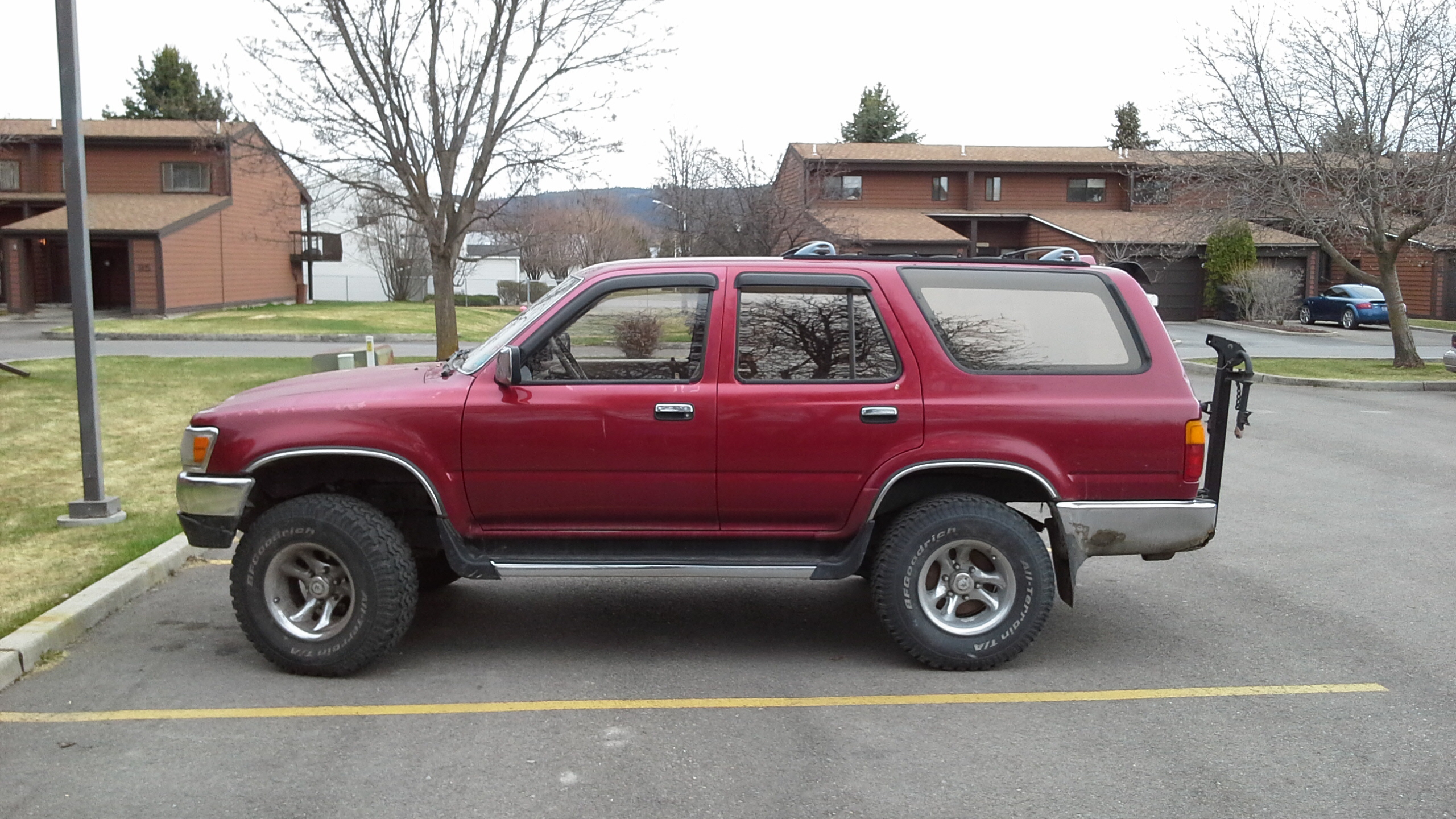

This is my 94 4runner I just bought for $700.00 off CL

Good lookin runner! You gonna put 22s on it? What are your plans?

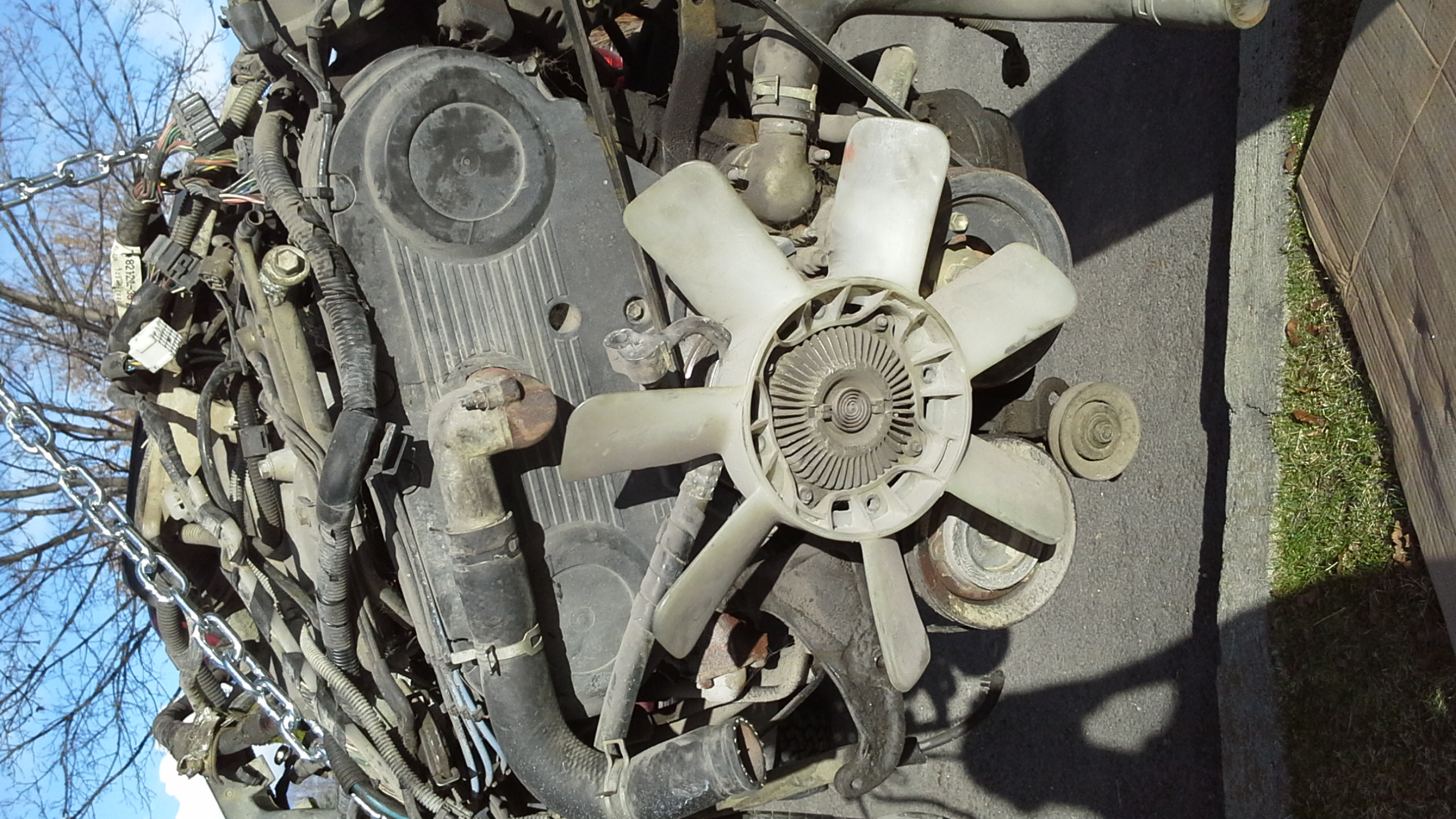

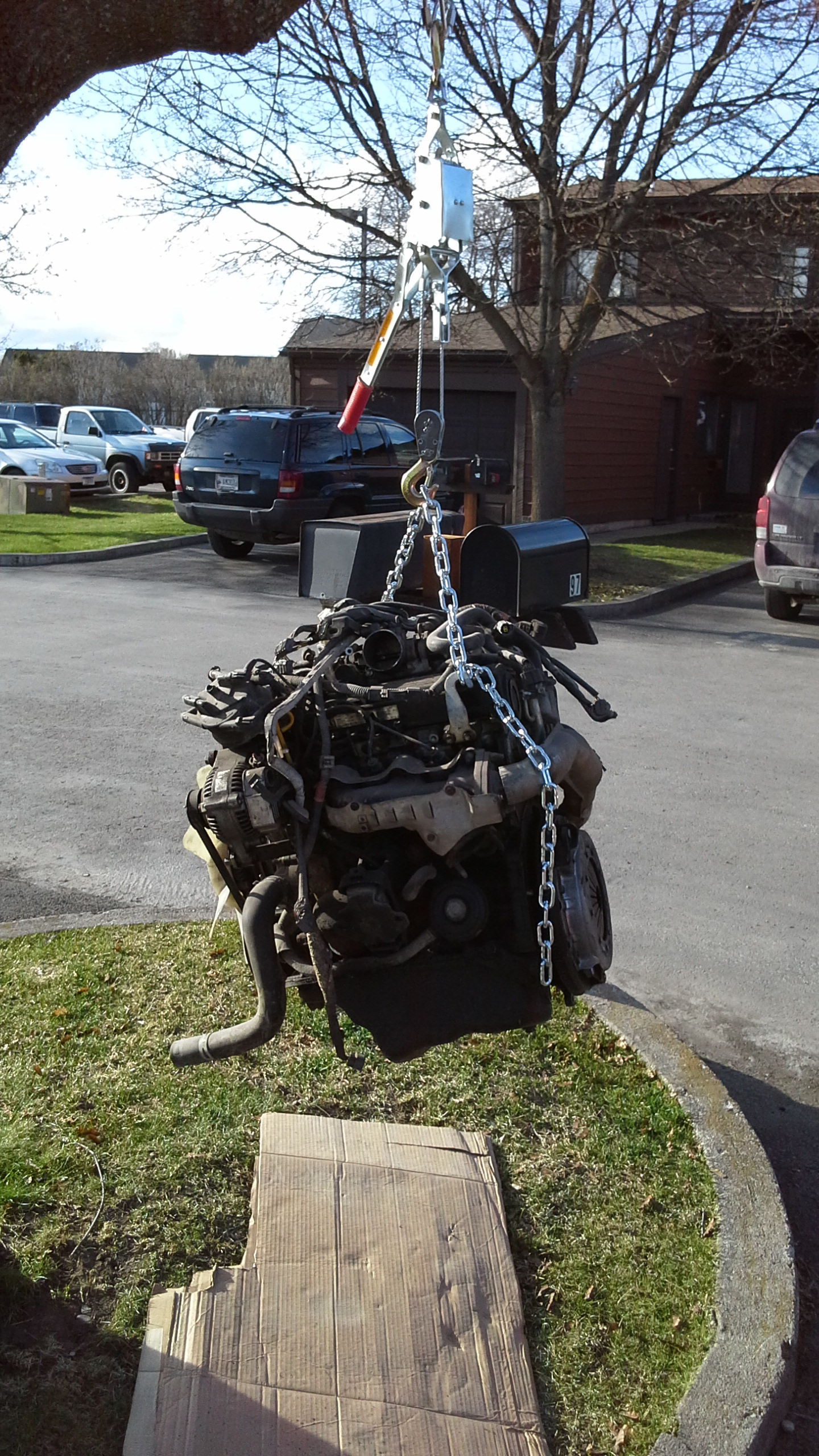

lol well right now it has BF Goodrich KO 31x10.5 on it, in the future i might go bigger but for now im going to stick with what i got, also i plan on puting a new rebuilt engine in sometime in the next few months when i have time. i just bought a 3.0 with every thing on it including the engine bay wiring harness that plugs into the computer, for $80.00 off CL that has around 96,000 on it and its not seized or with blown head gasket. [ATTACH][ATTACH]IROLLON22s 94 4Runner Build-Up Thread-20140423_182423.jpg[/ATTACH][/ATTACH]

what i want to do is rebuild this engine as a project and what im going to do is bore .30 over, take the block and heads down to the machine shop and deck the block and the heads, put a three angle valve job, higher compression springs, all new valves, port and polish, new pistons and rods& balanced , all new bearing, take my crank in and have it reground polished and balanced, new cams and lots more... but i can guarantee that it wont be a 3.slow no mo lol , iv thought about the 3.4 swap but i want something that's more a plug in play with less down time since shes my dd.
