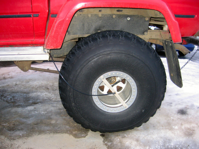

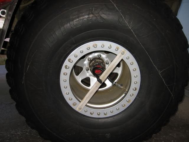

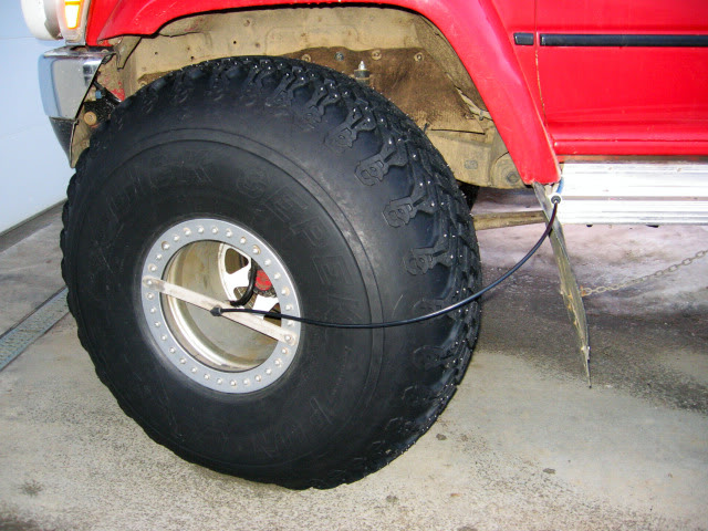

I dont have no write up or a link on the build but its fairly simple setup.
Rotating knee attached to the beadlock

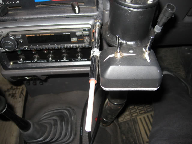

The air valves inside the truck

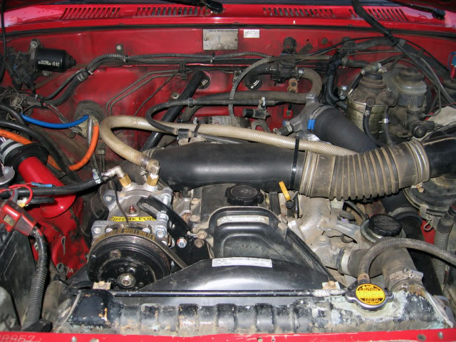

one belt driven air pump under the hood

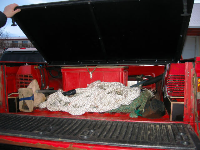

Two Fini air pumps in the back

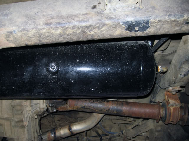

15 litre Tank for all the air
