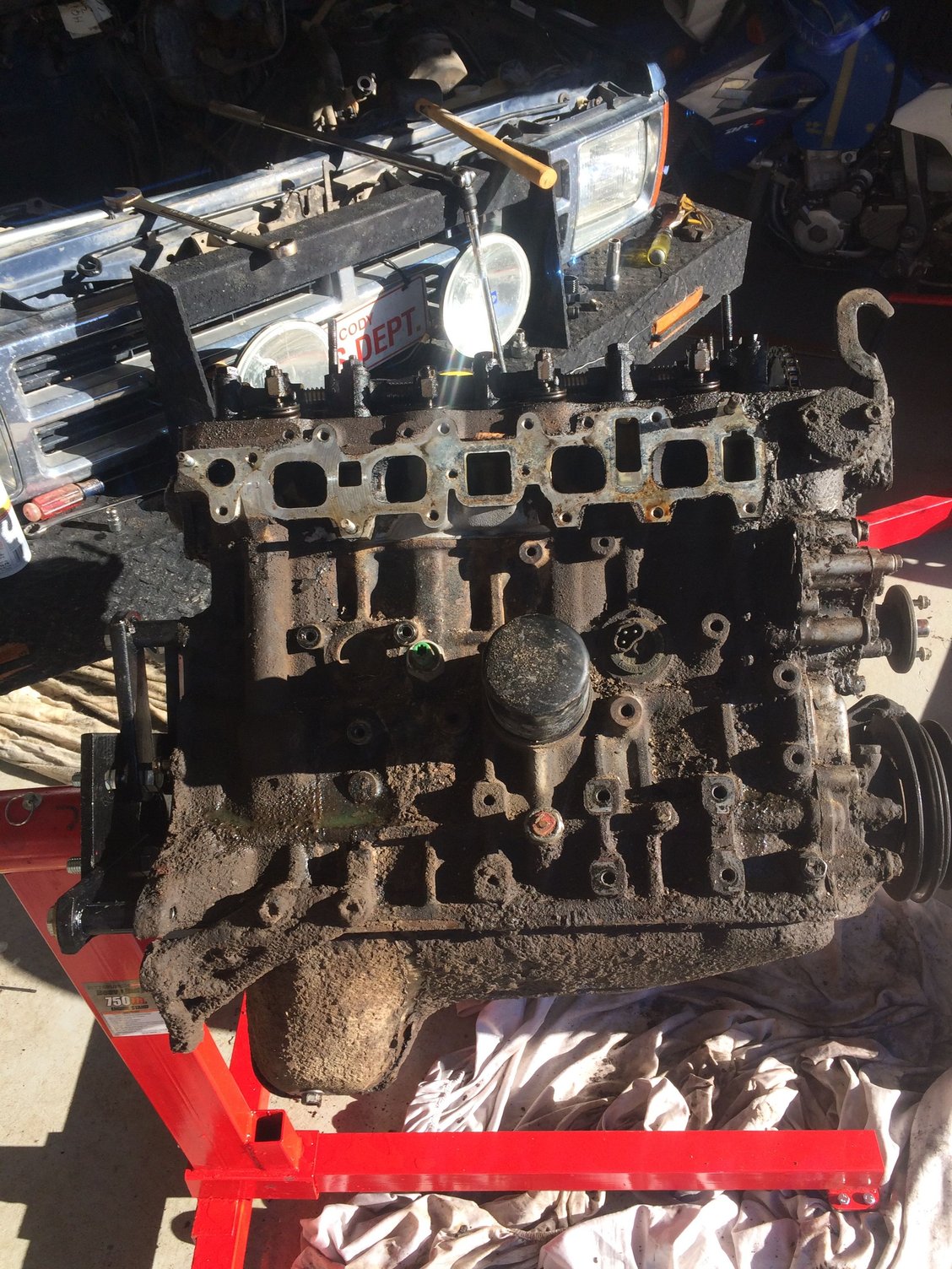

First off, Hello! I've been a long time lurker of this site for years and have used the info on here for many fixes to my 88' 4runner. This website seems to be most informative and least predatory of noobs like me haha. A little background on the truck; I bought the truck from my parents when I was in high school(late nineties) and it's been my daily driver since. I've never really touched the engine other than routine maintenance, I welded bumpers for it, and I added extended shackles and a add-a-leaf for fixing the rear end sag. It has never broke down to the point I couldn't drive home in all of its 270K miles.
But the time has come that it's lacking power (more so than usual haha), and is starting to leak coolant near the water pump and just run rough all around. So, I've decided to take the plunge and do a full rebuild of the engine and a few other upgrades to the interior and the suspension. My over all goal is to have a truck that will continue to take me where ever I want to go for many more miles. Therefore I'm going to try to keep it stock as possible and not try to break the bank. I'm waiting for my engine stand to show up and out will come the engine. I have everything disconnected from the engine except the motor mounts and a couple easy to get to motor/tranny bolts.
The rough plan is to the get the short block rebuilt at the local shop, stock engnbldr head and cam, and engnblder water pump, oil pump, timing kit and cover, and OEM head gasket. I'll try to document this best I can and I'll probably have plenty of questions when the engine tear down occurs, just thought I'd say Hi before said questions start popping up. Thanks!

It's out! I ended up working a flat pry bar gently around the perimeter of the bell housing to work it loose, I think all the baked on oil had something to do with it too. Pulling was pretty straight forward. I was able to slip a box end wrench on the infamous 17mm bolts behind the head and then I put my cheapest socket on a breaker bar and slipped the socket over one of the "prongs" or forks? Maybe of the open end of the wrench. Then I was able to gently break the bolts loose. Tool abuse for sure but it worked a lot better than trying to snake a wobble joint and extensions way in there. Hopefully the rest of this build is as straight forward.

Any tips for cleaning up parts coated in years of oil, mud, and general nastiness? I hit the whole thing with degreaser and water before i started the disassembly, but it didn't touch the crust on this thing. More degreaser and a brass brush maybe? Gasoline? How about the more delicate items like the alternator and power steering pump? thanks again

When I cleaned mine up, I found that simple green and a variety of plastic scrapers, brass & stainless brushes, 3m stripping pads and a set of metal picks did the job.
Like you, I found that engine degreaser wasn't cutting it. It would foam up and make a smelly mess of black goo. Spraying with a hose did nothing so it would dry back to where it started. Going a step further, I'd spray it on again but crawl underneath and scrub it with a stiff brush with caustic goo burning my face and through my shirt. Sound familiar?
There are better ways. This is how I got it done.
Simple green isn't less work, but it doesn't burn or stink. You'll use a lot more than one spray bottle if you want everything really clean. I used almost a gallon. Just dilute for more sensitive parts.

Thanks for the simple green tip, I'd rather use that in my garage than degreaser anyways. I used old gas from winterizing my lawn mower and motorcycle to soak things like the alternator and p/s brackets and it worked really well. Everything came off with nylon brush and looks almost new (sorta haha).

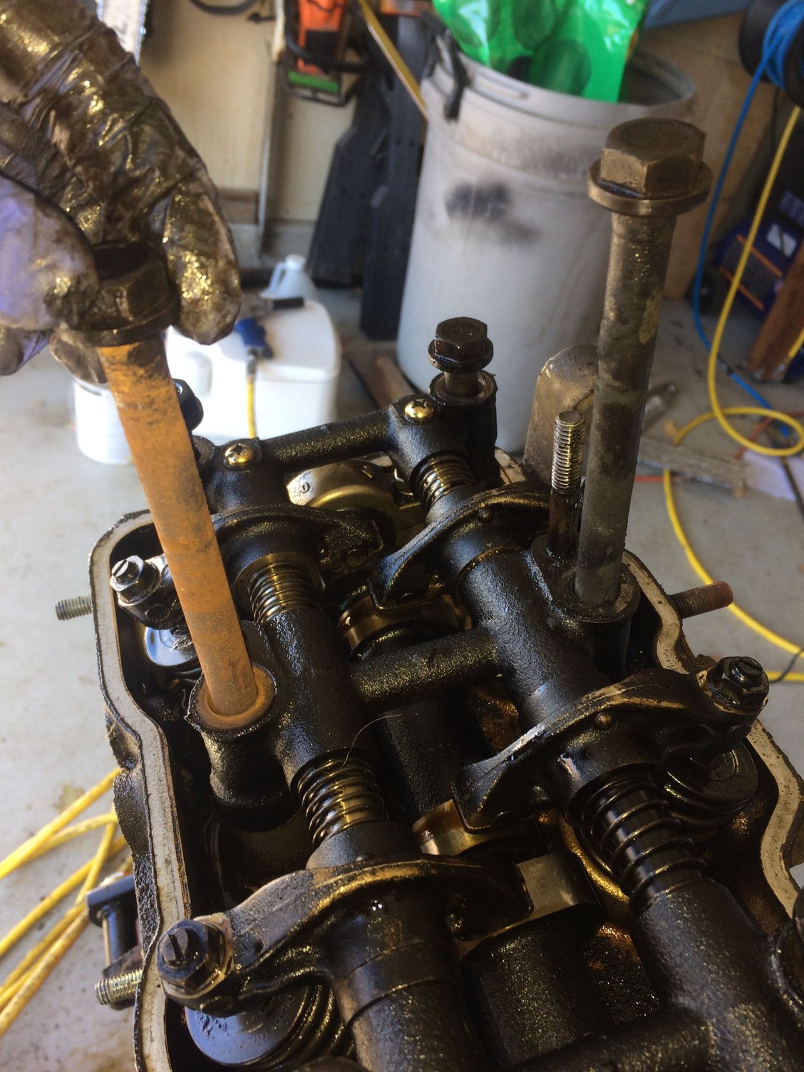

Pulled the timing cover and head today. Everything was pretty Straight forward. I was almost a little disappointed by the lack of carnage though. There were definitely some chunks of plastic floating around from the chain guides and the head bolts went from breaking loose easily to feeling like I was going to break my wrench easily. Some of the bolts were really rusty and some were coated in gloppy oil and some were coated in carbon like chunks, no two the same. Head gasket? The gasket looked ok though from my noobish perspective? Anyways it's off and short block is going to the machine shop. More cleaning in the meantime. This build has been 1 part wrenching to 2 parts cleaning so far haha. Not the same
Nothing too ugly
Money shot
Good to go for another 300k! Haha
