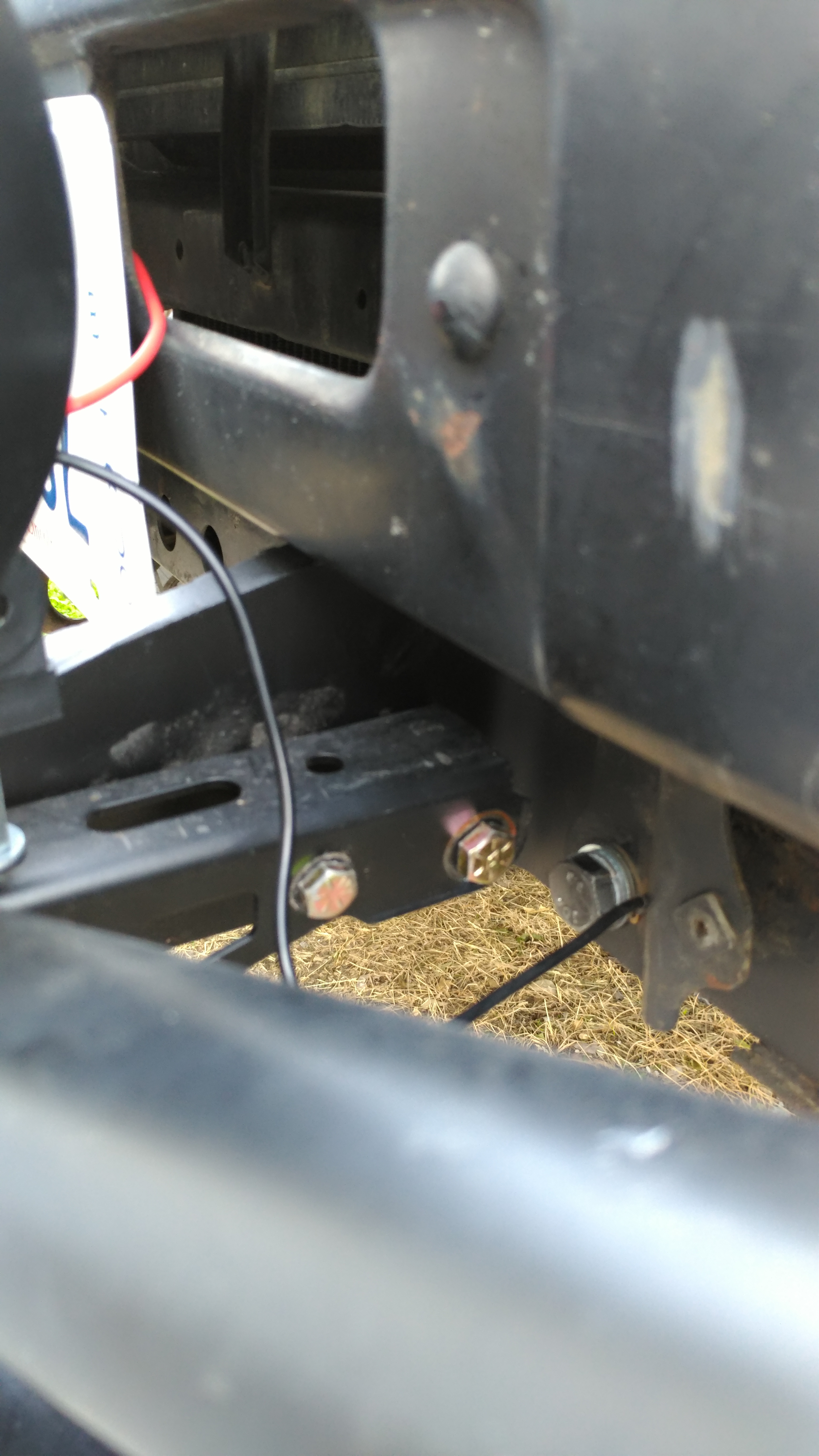

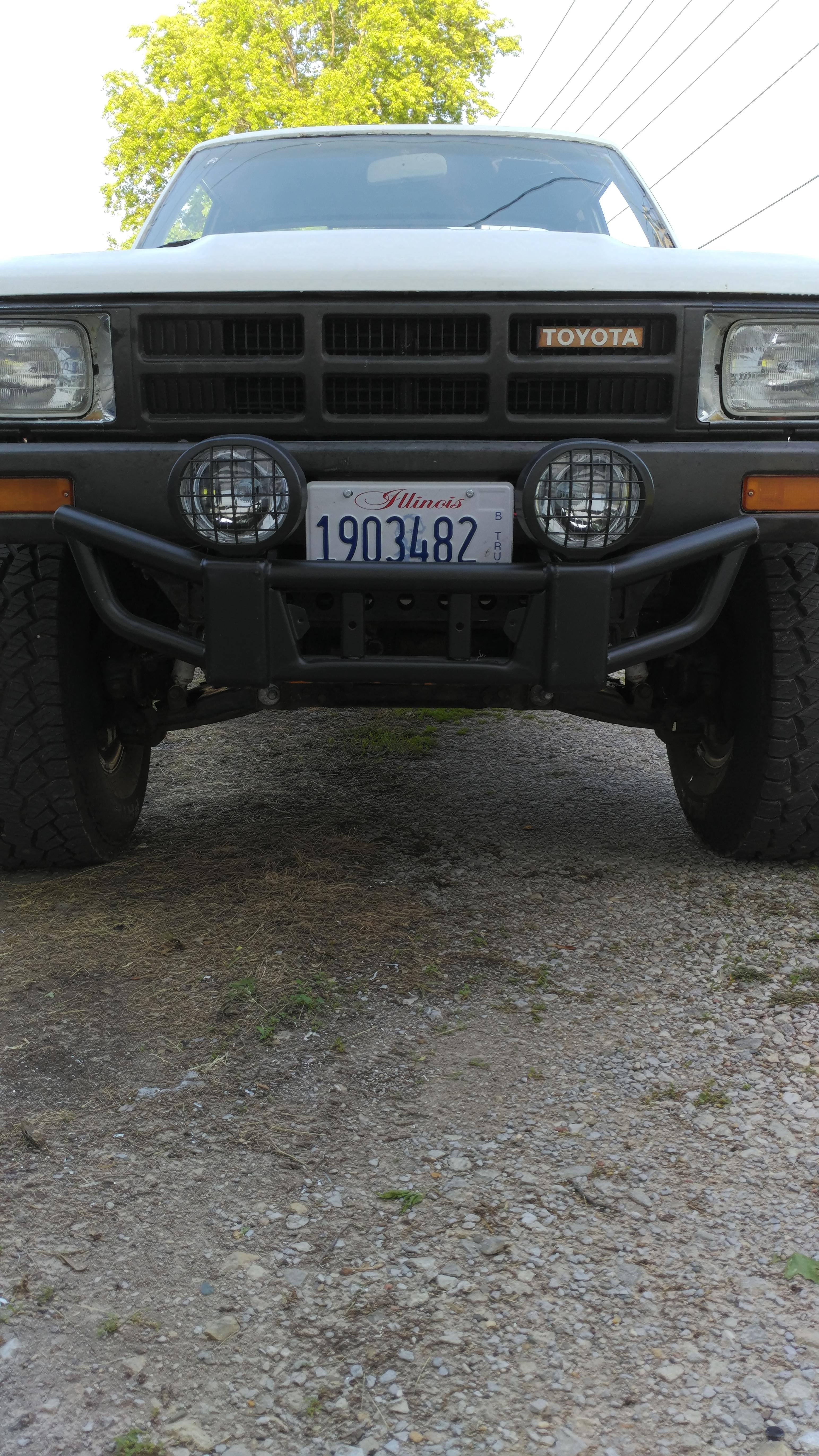

I took .5 inch aluminum angle stock that was 6 inches long with a 3 and a 6 inch long leg. The shorter leg I drilled holes in to bolt to the bumper mount. I placed the brackets behind the bumper mount so it was sandwiched. I had to buy longer bolts for the bumper. I can't remember what the thread was but I had to get it out of the specialty bolts at ace and it wasn't cheap. The brush guard had 3 holes in it so I marked them and put 3 bolts through it. I angled the bracket down to the brush guard so it didn't sitick up so much. I got it a little crooked but I can live with it.
