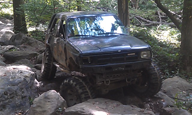

Been some time since I did anything with my 4runner.... I figured I would take it out and get the fluids moving...
I think I am going to start calling Two-Face... And get a better passanger side spotter..

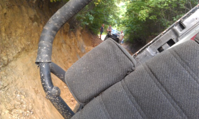

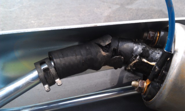

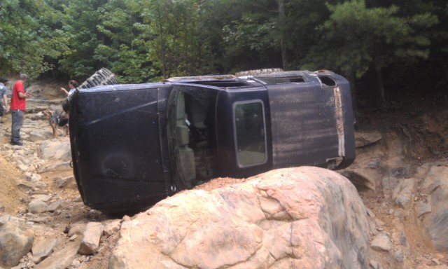

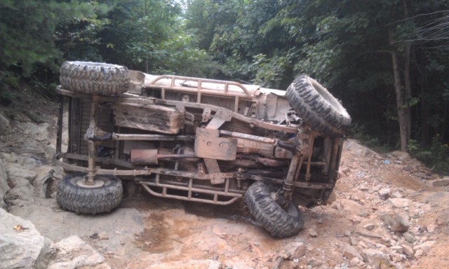

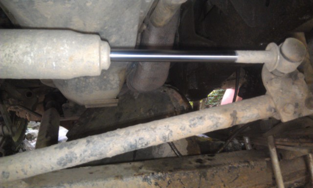

My gas tank has taken a few hits a while back, and I guess the hose finally had enough... the day I go wheeling..

Old Sep 3, 2013 | 10:30 AM

Was this at SETO?

Originally Posted by jason in tn
Was this at SETO?
sure was, did you make it out?
Old Sep 3, 2013 | 11:19 AM
  #52
jason in tn's Avatar
Joined: Aug 2009
Posts: 2,173
From: hohenwald tn.
No I had planed to but got stuck working. Looks like you had a good time. What trail was the flop on?
Old Sep 5, 2013 | 04:23 AM
  #53
FUNrunner87's Avatar
Joined: Sep 2009
Posts: 122
From: Oxford, NC
It was up 15 at the rock just before the ledges at the exit. I was making things harder than thet needed to be....

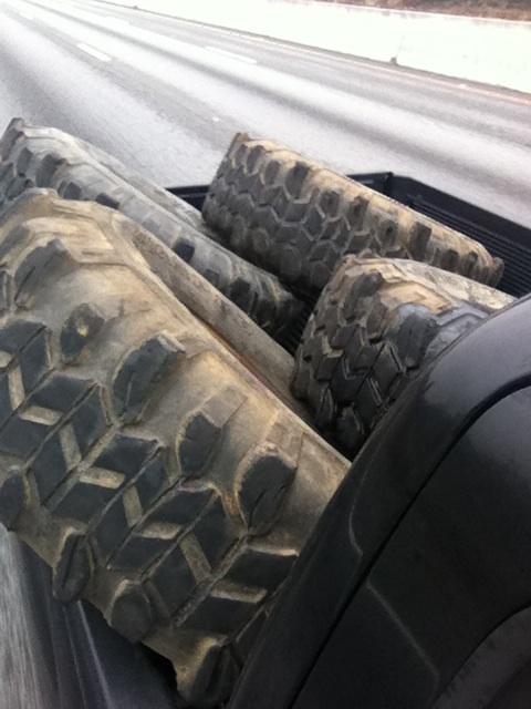

Update:

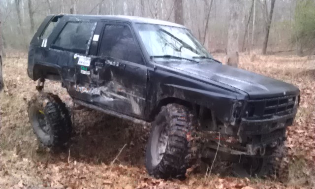

Made it out to Harlan in October. (no pics though) It was a little wet, and my boggers where sucking it big time on the wet, muddy rocks. I think I would have been better off on ice.
Soooo...I sold off my boggers, and picked up a set of 15x8 beadlocks, and then a set of USED and grooved 38x12.50 TSL.

Also found that the drain bolt in the front diff had been knocked loose. The oil and... what ever else that is now in the front end will need to be removed. I will probably tear the whole front axle down as its been a while since I checked it over...

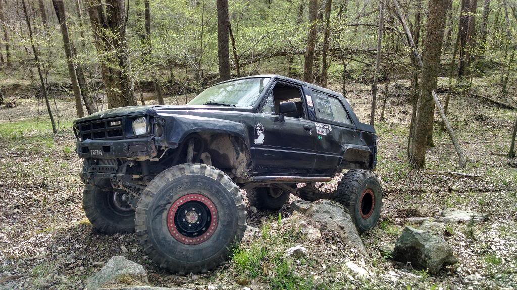

I finally got around to getting the 38s mounted on the bead locks. I love the new tires and bead locks. Here is my test hill.
