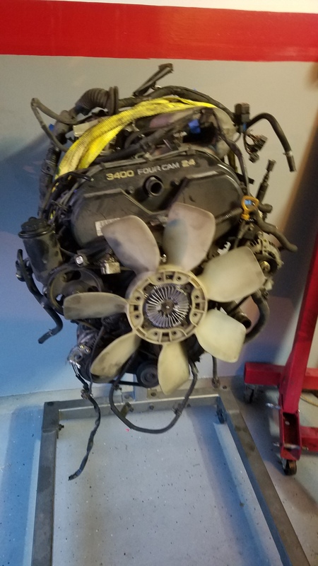

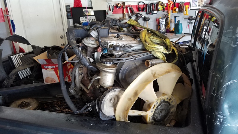

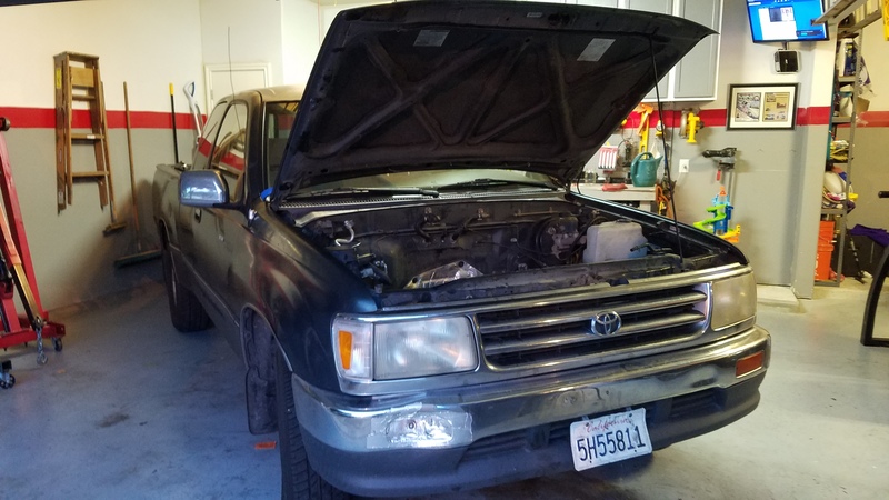

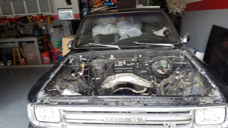

Hello Yotatech, it has been some time since i last been on here. I finally got a great deal on a donor car ( 96 T100 with 289k) and now ready to finally do my 5vz swap. I've been wanting to do this swap for about 10 years now, So i pretty much already got started on removing the motor from the donor truck today and so i am contemplating if i should rebuild the motor or not. I think im going to do a compression check to see if i need to. The motor is in great shape considering the mileage or even if that is the original motor.

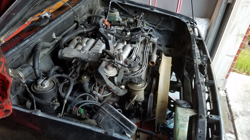

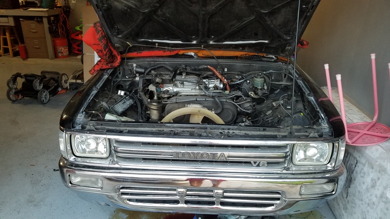

So Here are my plans ----
Swap the 5vz
Do Routine Maintenance such as gaskets and timing belt
LC Engineering S/C with 2.2 pulley
URD 7th injector
97 ECU to have the motor recognize the S/C
CAI
Mating the Motor behind the 5 speed manual( i have an auto)
So i have a couple of questions for you guys that already did the swap....
1) All i need is the engine harness? or do i need to snag the dash harness as well. I am gonna go with ORS to get the wiring harness.
2) Im about to get rid of the donor truck, Is there anything else i would need to grab from it that i might be forgetting.
What i got so far from the donor truck
- Engine w\ Harness
- Alt, Power steering w\hoses
- Motor mounts
- ECU
- Starter

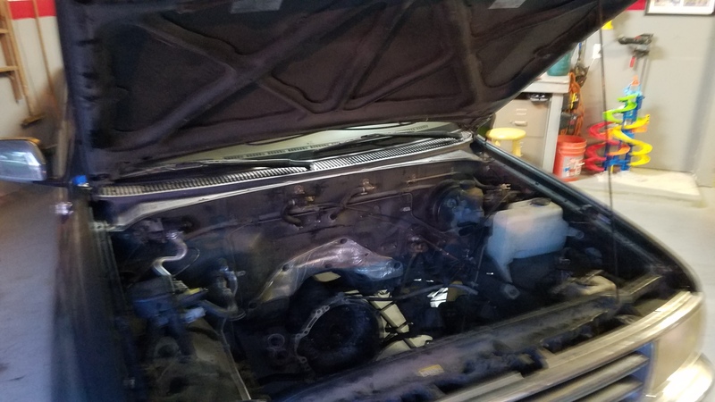

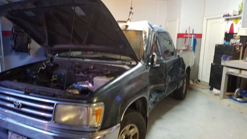

So i am finally getting into taking apart my truck now, got a lil done today. This weekend im looking to take the engine and tranny out so i can sell it with the t100 to the junk yard. They are going to be giving me 325 for everything, I think that a good deal considering that i only paid 800 for the truck initially, Although i know they will sell at least one of the trannys for that price. I just really want the truck out of my garage for i can clean up the garage, park the wifes car in the garage and start to rebuild the motor or at least just clean it up and start to paint as well as dress it up. Whelp here are the pics of todays adventure. Man its so much easier to disassembly once you have done one already. I disconnect practically everything in few short hours. The next step is just to unbolt the motor mounts as well as tranny, then pull her out.
Do you guys think 325 is too low of a price to get rid of the truck??

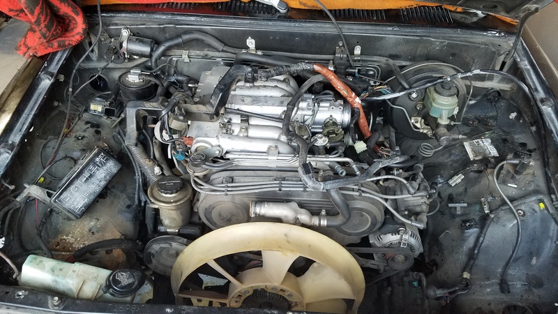

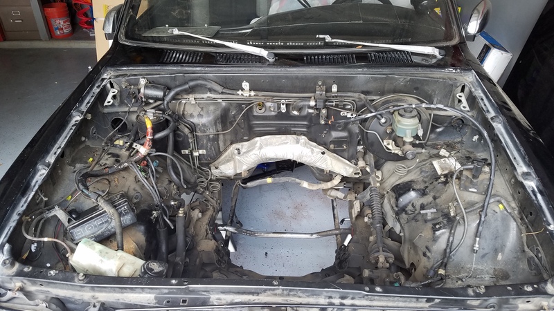

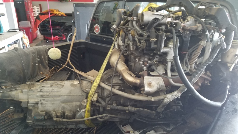

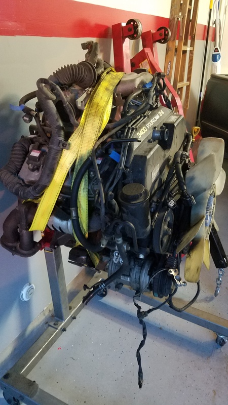

So yesterday i was able to get out the original engine out of the yota. I must say once you pull one motor out, getting the other motor out is rather faster and easier. With that being said i will now move on to cleaning the engine bay up and now look to the 5vz and doing the regular Maintenance such as timing belt and a few others. I also need to do compression test on the motor to see if it can handle the S/C. I also put the t100 on craigslist and hopefully have someone coming out today to look at it, that's if they do not flake!
Its crazy to think that this is the original motor that was in the truck has been with me since i've been a baby. Sniif sniff good bye 3vz....
