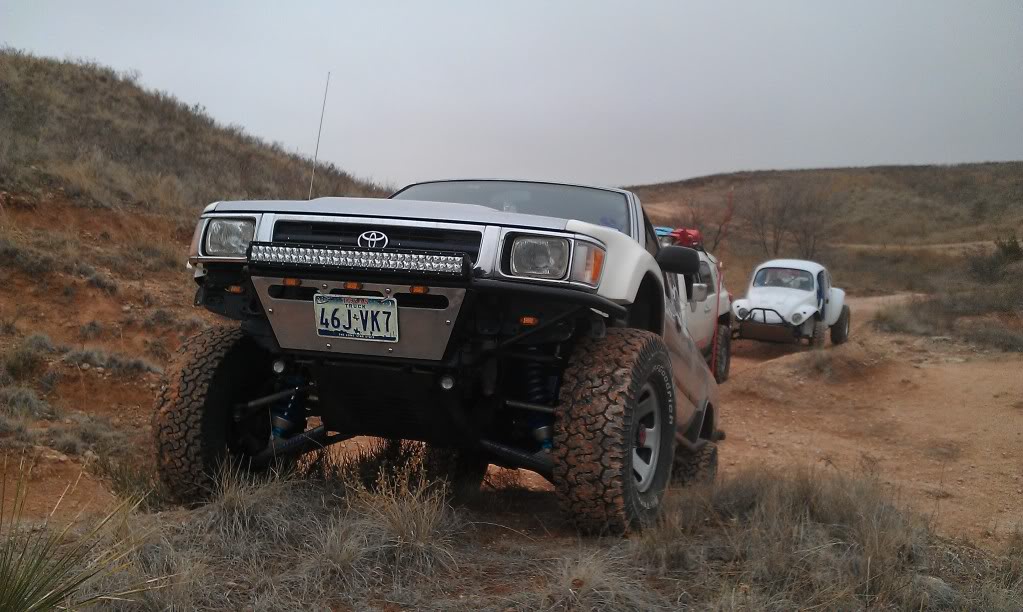

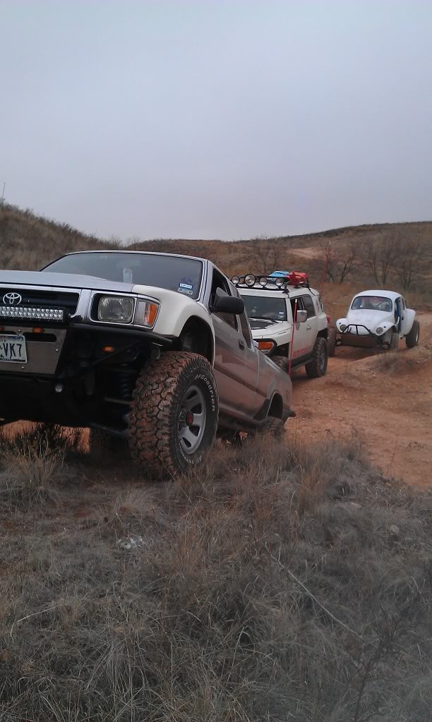

wow, he replied fast!!! (hopefully you don't mind me posting these pics in your thread. I can edit it if you want...) Figured you might like to see these for width reference...
BTW, if I remember right these were the 62" deavers also...
And just for fun... The truck now...
This isn't the T100 axle in this picture, the new owner of the truck has swapped in a 9"

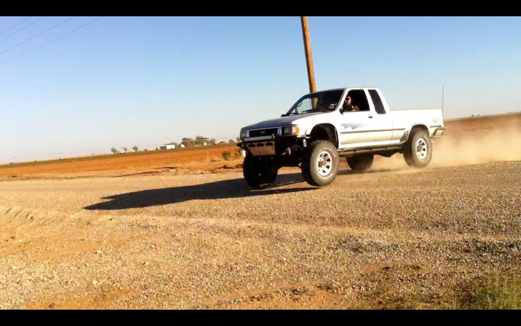

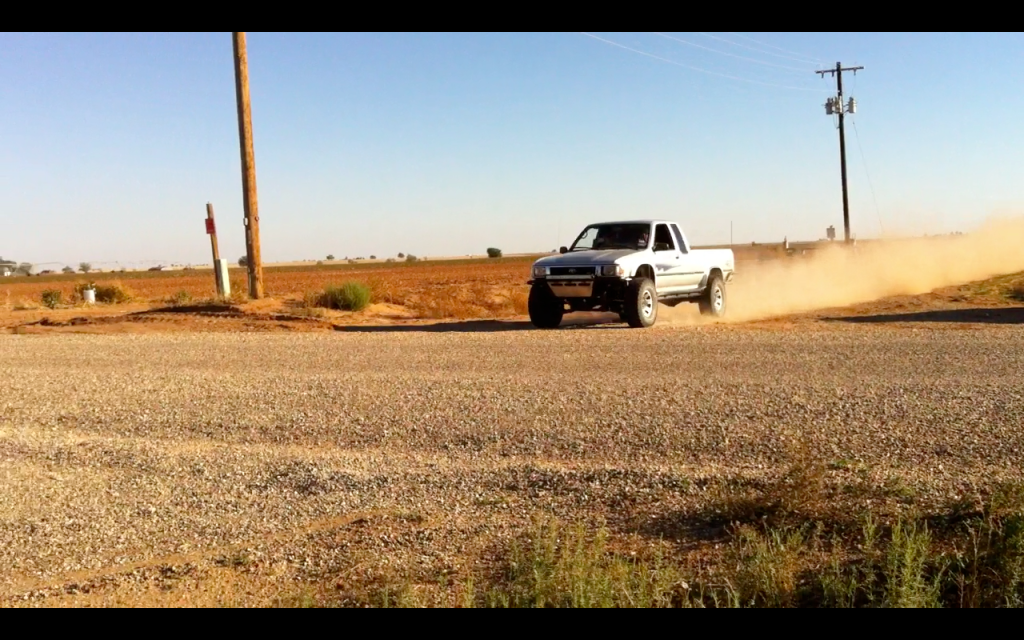

I know here in Nev and where I lived in Az you could pick up a T100 Axle for CHEAP! Like $200 max... They're kind of rare and hard to find cause obviously there just aren't a whole lot of T100's out there in general but the parts in the junk yard are cheap.
That truck has a custom front end built by the same guy that did mine. It's a 4WD chassis but he's not running the axles or the front drive.

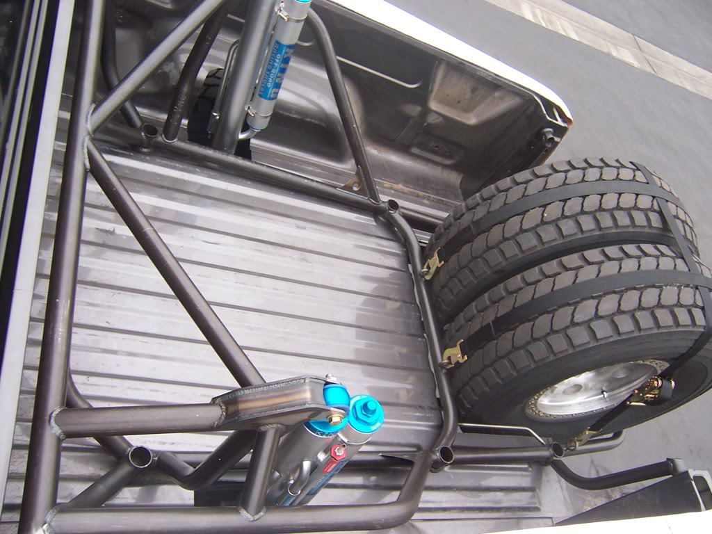

IMO a really nice setup would be to find a T100 axle, slap in some gears and a locker. 62" deavers with shackles either pivoting above the frame rails like above or thru the frame rails. Mount the shocks inboard of the frame rails on a simple clean bedcage like below and then mount some 2" stroke hydro bumps off the outside of the frame rails.

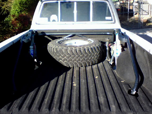

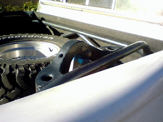

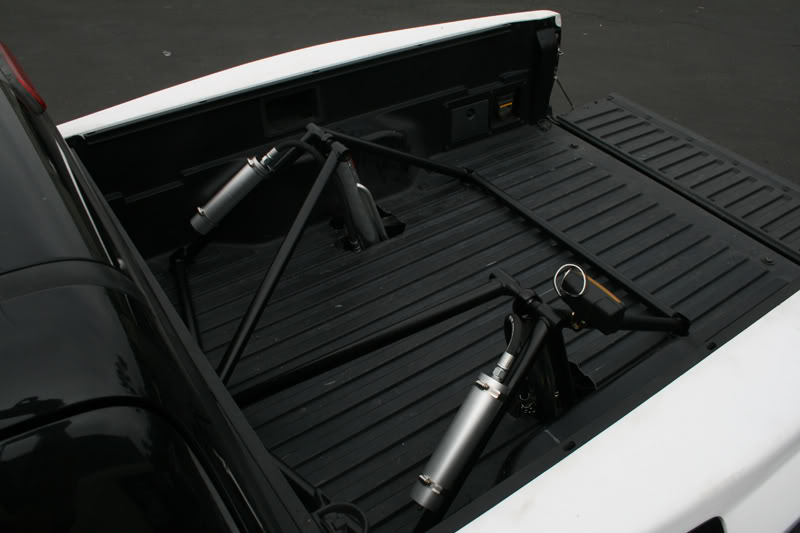

This is sort of hard to tell but the top tubes actually angle forward to the front of the bed. This is in a chevy but it's a clean basic setup that leaves you room to still use the bed. They actually made it with the intention of still hauling a single dirt bike in the center.

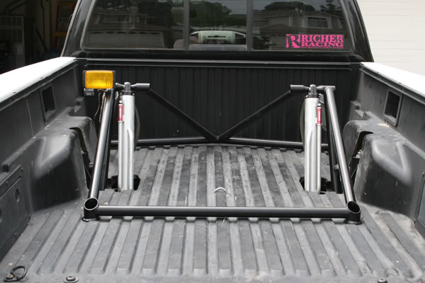

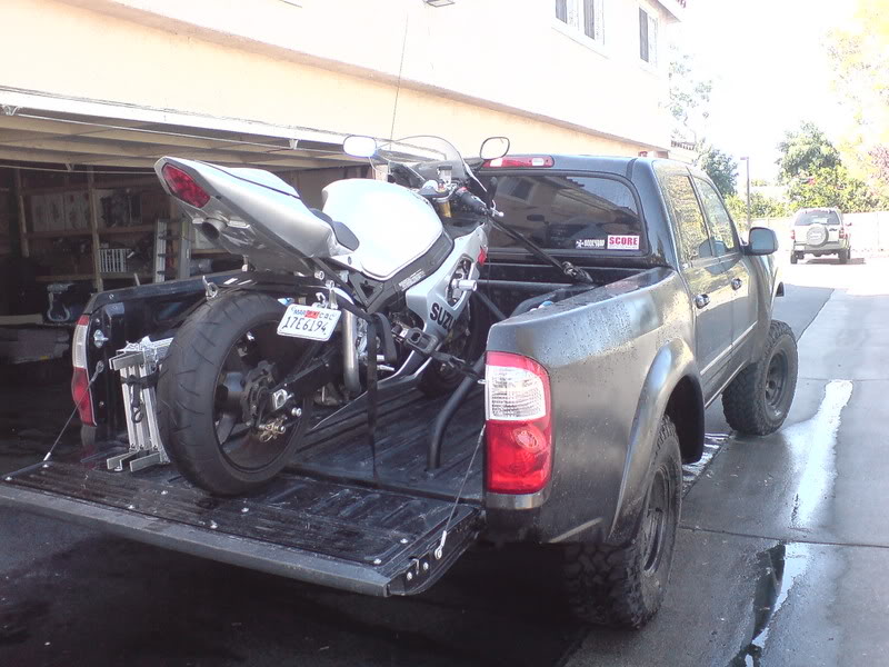

Couple more ideas of clean bedcages that leave the bed semi usable...
Look closely at this one... notice there's actually no bed! They built a new floor basically inside the cage work.
LOL and on and on and on...

Thanks for the help sirhk100. I think I'm just going to keep it simple and get a simple bedcage, deaver's, 12 inch shackles, and some smoothies. This way I can keep my bed and still have some decent travel out back and it won't burn a hole in my wallet.
I like the bedcage design on the first picture with the BMSoffroad sticker.
