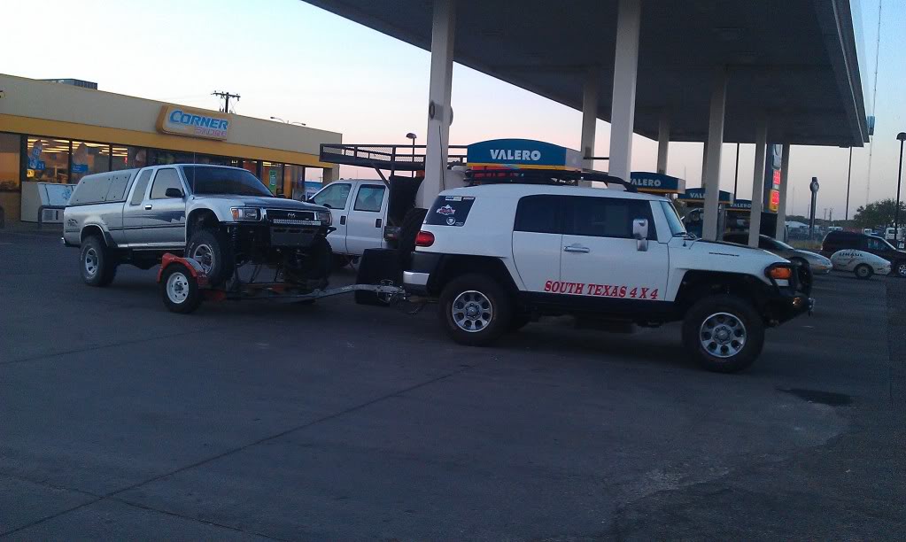

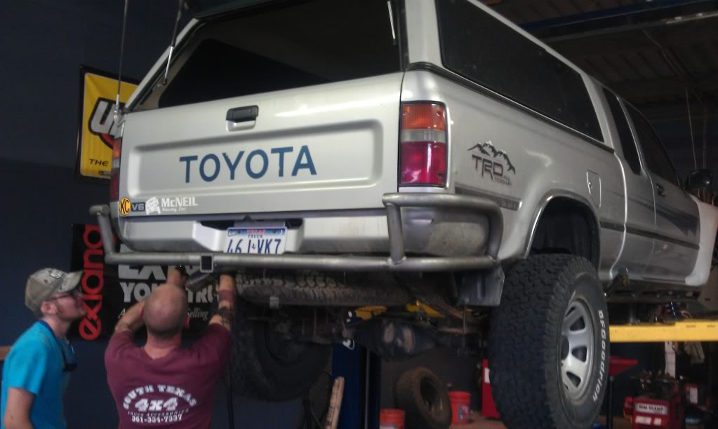

Towing her down to chorpus to South Texas 4x4 on Thursday. She'll be going under the knife friday morning. Along with getting the front fixed and a custom bash plate she'll also be getting some addicted off-road sliders and rear bumper if they make it to the shop on time. Pray for her.

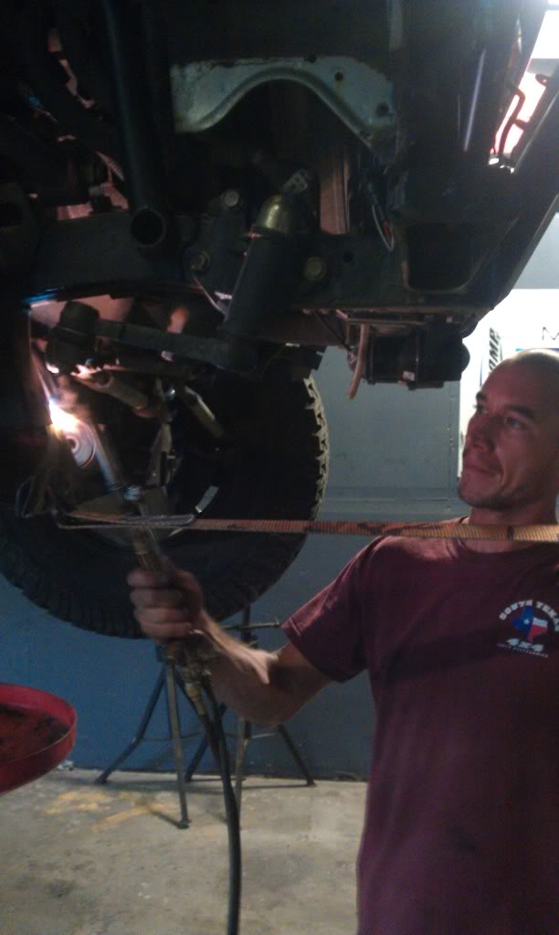

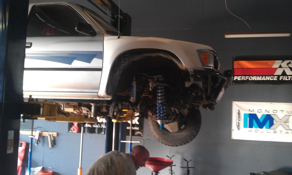

Update: She's finally fixed and drives just like she did before. No pulling or wobbling. Ordered a spanner wrench so I can adjust my coil-overs but until then she won't see anything crazy. Used a jack and some heat to straighten everything back out. Lance at South Texas 4x4 did a great job and I honestly think if it wasn't for him no one else would have touched it. Also added trail gear sliders and a rear bumper while I was at it.

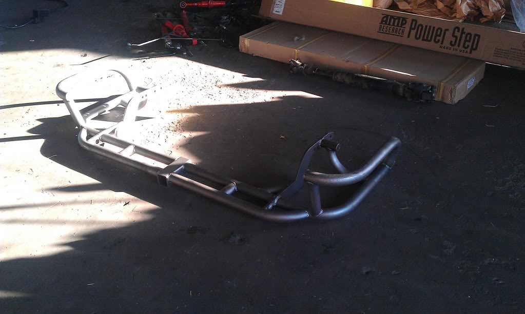

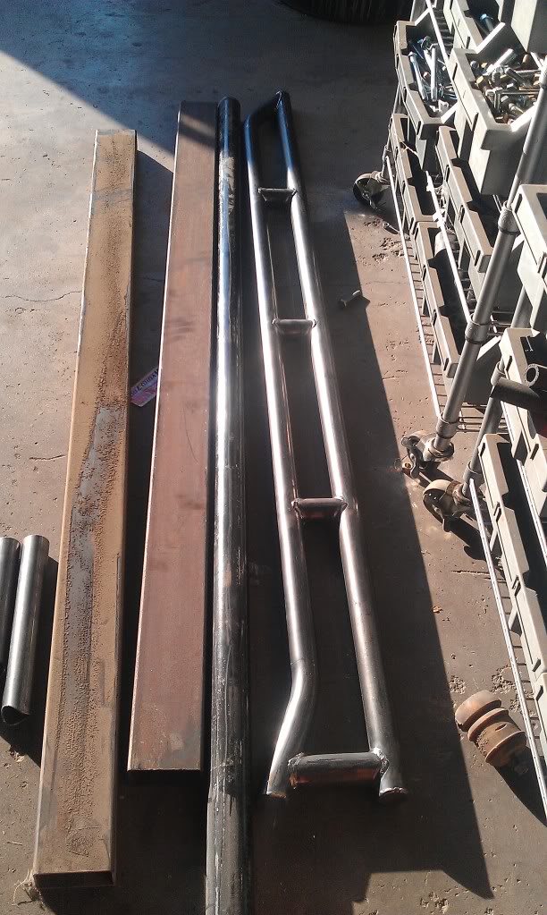

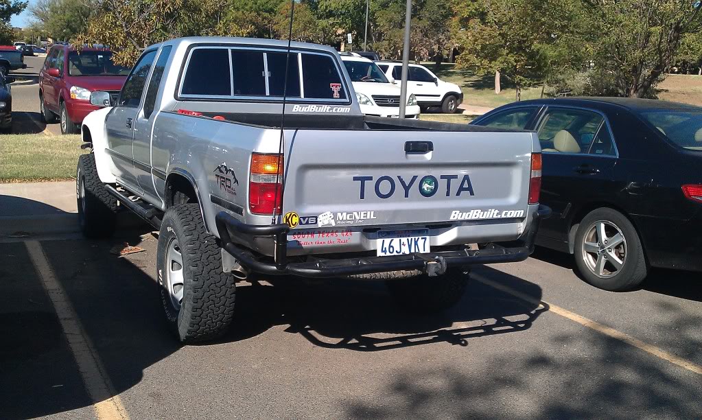

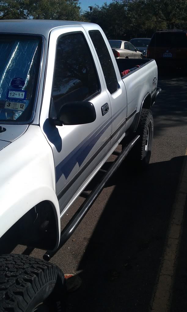

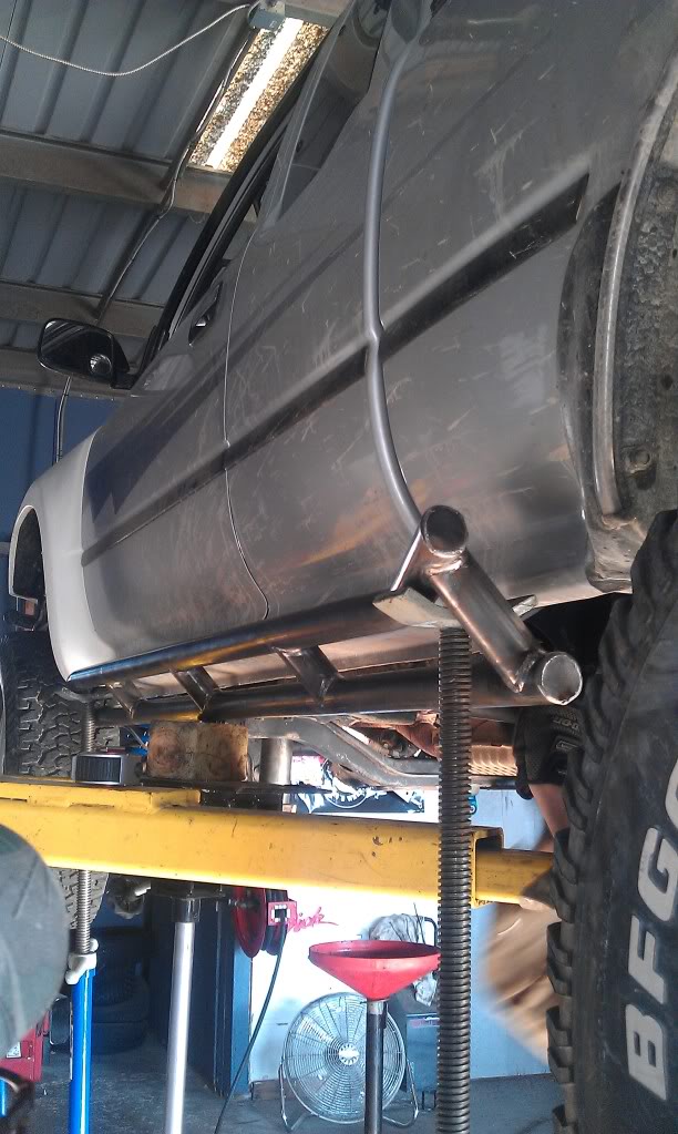

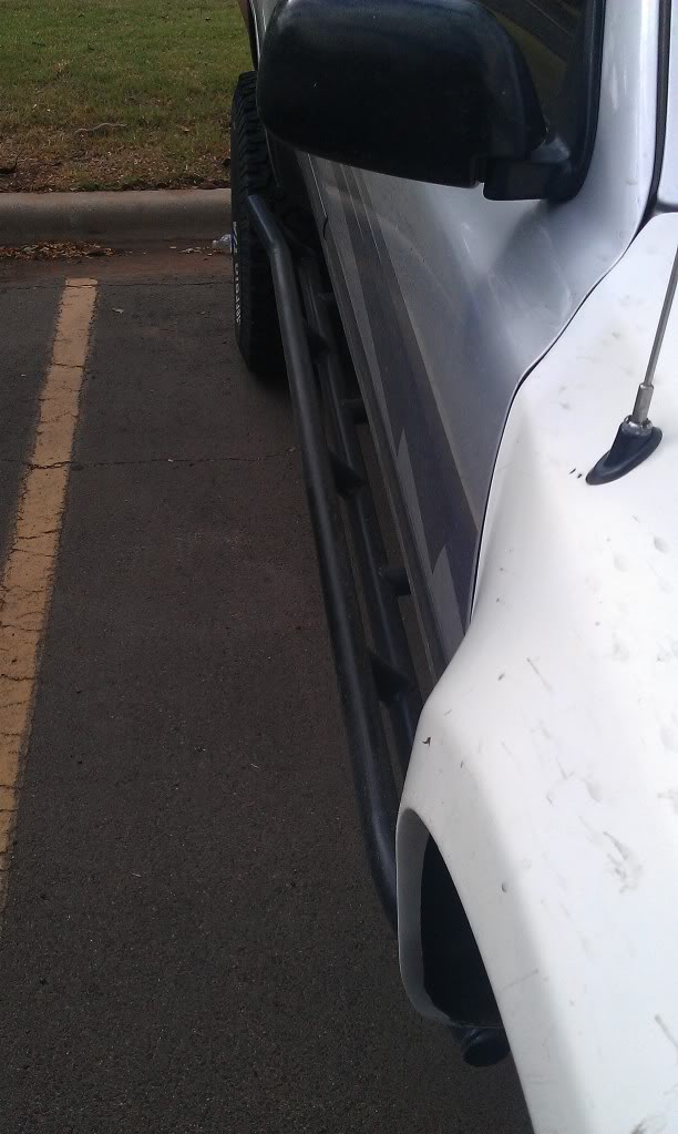

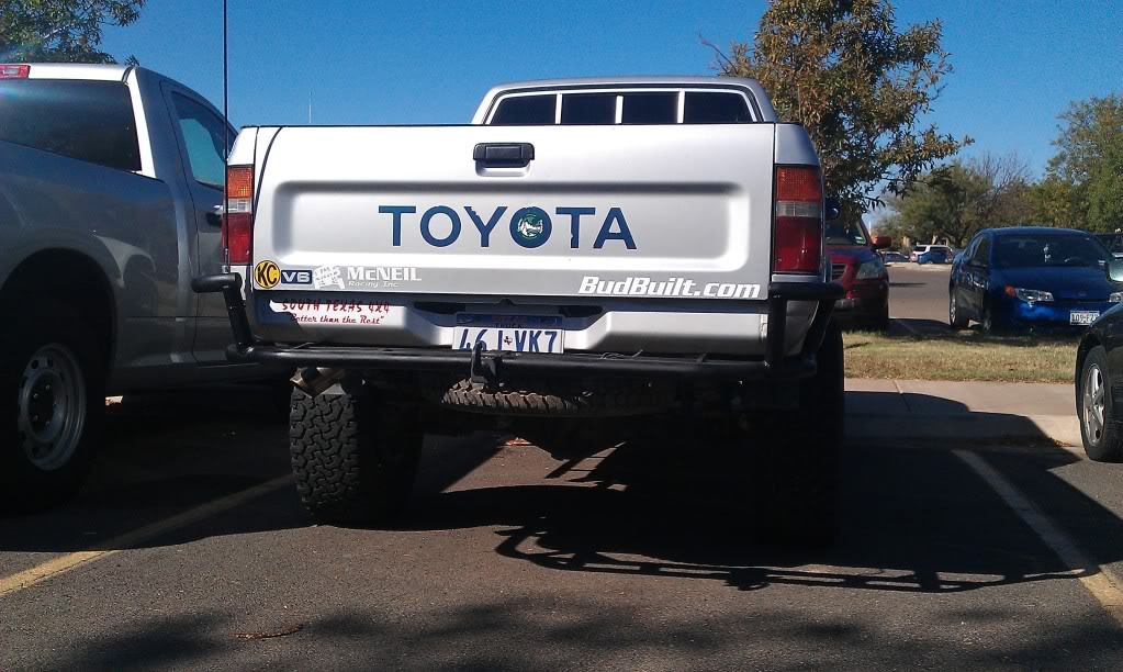

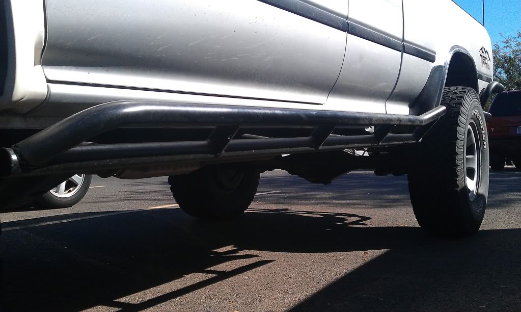

Painted the sliders and the rear bumper yesterday.

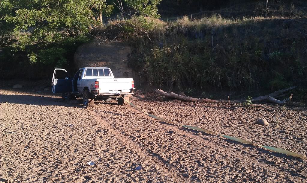

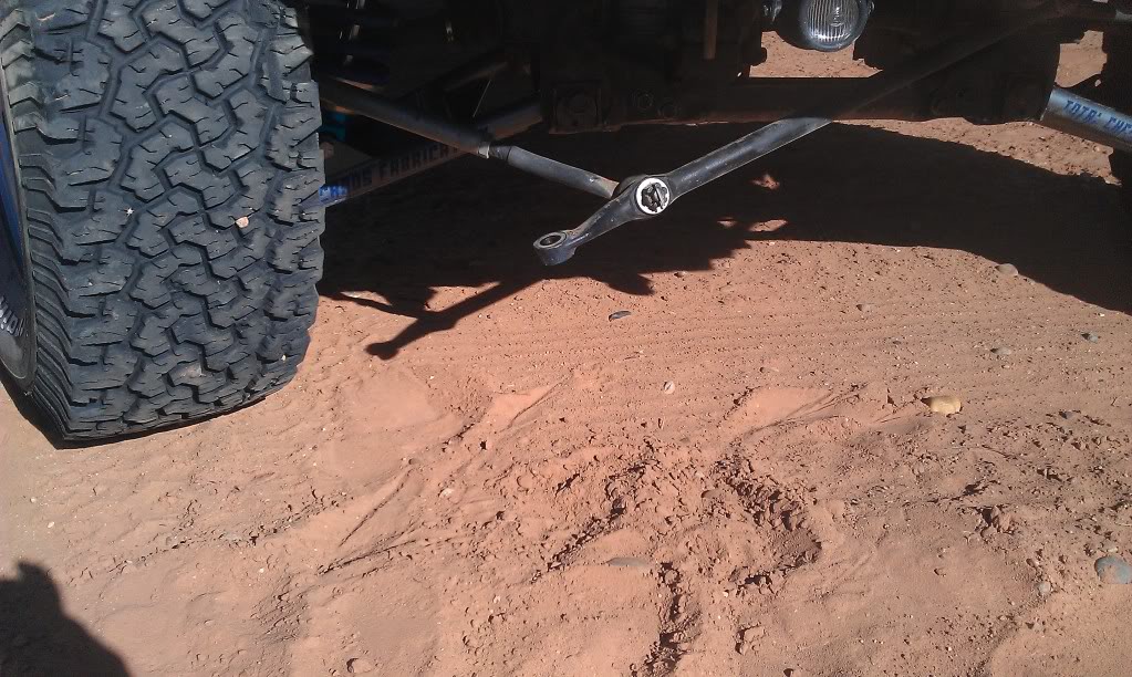

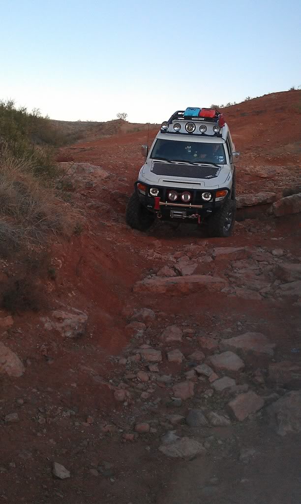

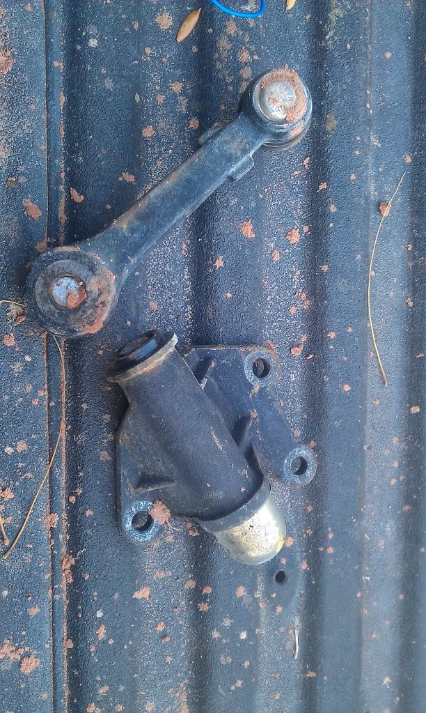

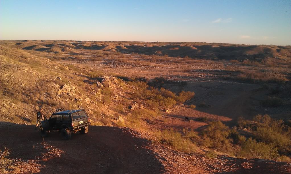

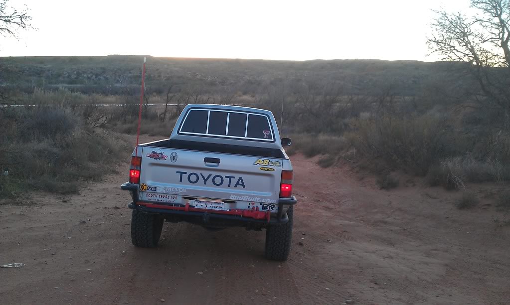

Went out to Amarillo on Sunday with some friends to hit up some trails. Only thing I broke was an idler arm. Sheared the bolt in half. Quick trip to autozone and 50 dollars later I was back on the road. Got some video of me hitting the whoops but I'm still waiting for my friend to upload it. In the mean time here are some pictures.

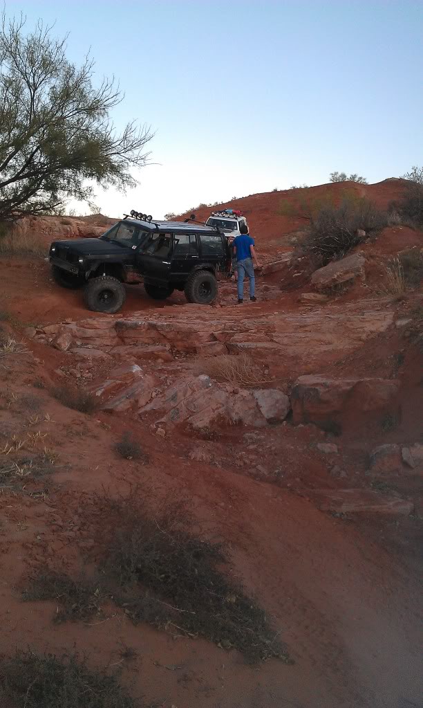

I felt more at home on the river bottom then on the rocks but she kept up with the fj and the cherokee on the rocks and then bombed the river bottom afterwards. Still waiting on my friend to upload the vid (roll eyes)

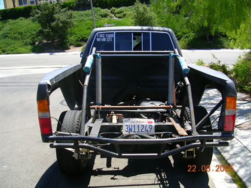

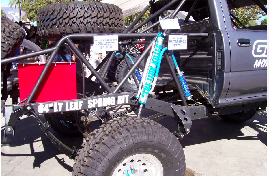

What I plan on doing for the rear. Don't know if I want such a complicated bedcage because I'd like to keep my stock bed.
http://giantmotorsports.com/content/view/41/51/
Old Nov 8, 2011 | 02:11 PM
  #98
Joined: Jun 2003
Posts: 342
From: Las Vegas
Truck looks sweet and it seems like you have some nice solid plans for the future to compliment what you've already done!

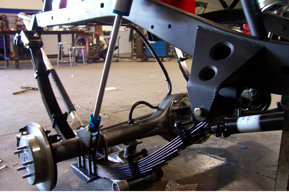

You might already know but I wanted to point it out just in case... The shock setup on that toyota above from Giant won't work on your truck. I'm going out on a limb here and assuming you've got the stock rear axle? If so, you won't have enough room between the tire and the frame rail to fit a shock. The shocks will have to be mounted inboard of the frame rails. Not a big deal though and it'll still work great on both the rocks and at speed. That guy is able to fit the shocks out there cause he's running a wider rear axle then stock.
Here's the best 2 pictures I could find to show you... In this first one, notice how close the tires are to the frame rail.
And then this one as you know the leafs are directly under the frame rail. You can see how close they mount to the tires. Here you can also see how I had my shocks inboard of the leaf springs. These are the 62" deavers with 18" sway a way shocks and shocks mounted above the frame rail like you mentioned. (figured you'd maybe be interested in pictures...)
Cool build man!!!

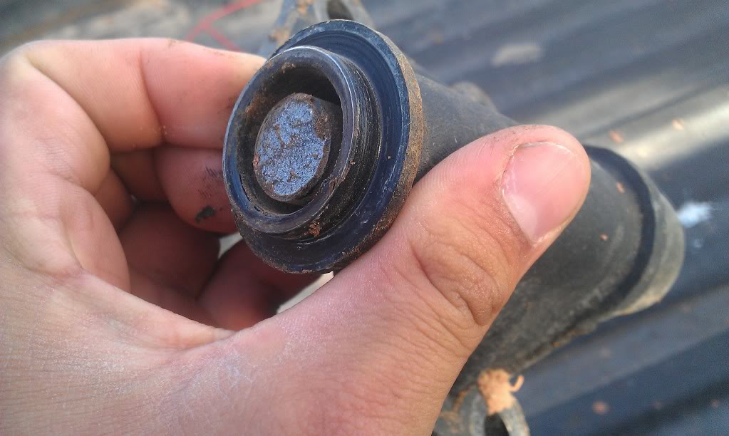

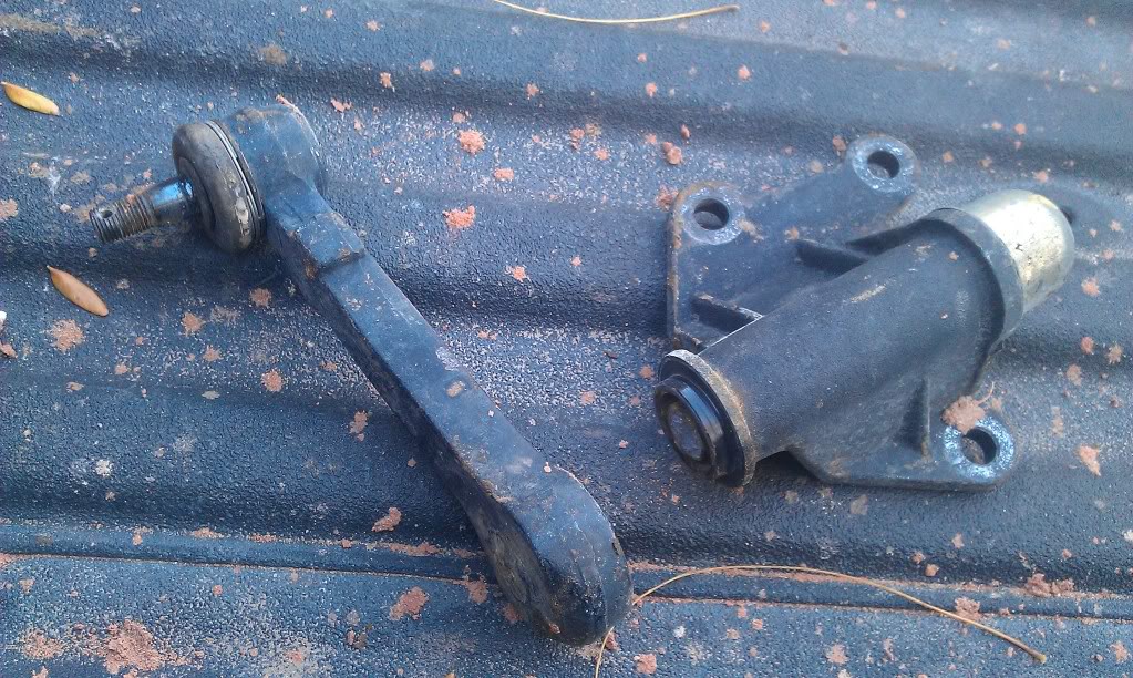

Pictures of sheared bolt on idler arm.
Cool build man!!!
Wow, thanks for bringing this up as it didn't even cross my mind. I do have the stock rear end on it and it seems as I will have to mount the shocks inside the frame in order for the kit to work. Was contemplating a t-100 rear axle as with it i could mount the shocks outside the frame and it would match the track with the front. Anyways, thanks for bringing this to my attention as i had no idea.
