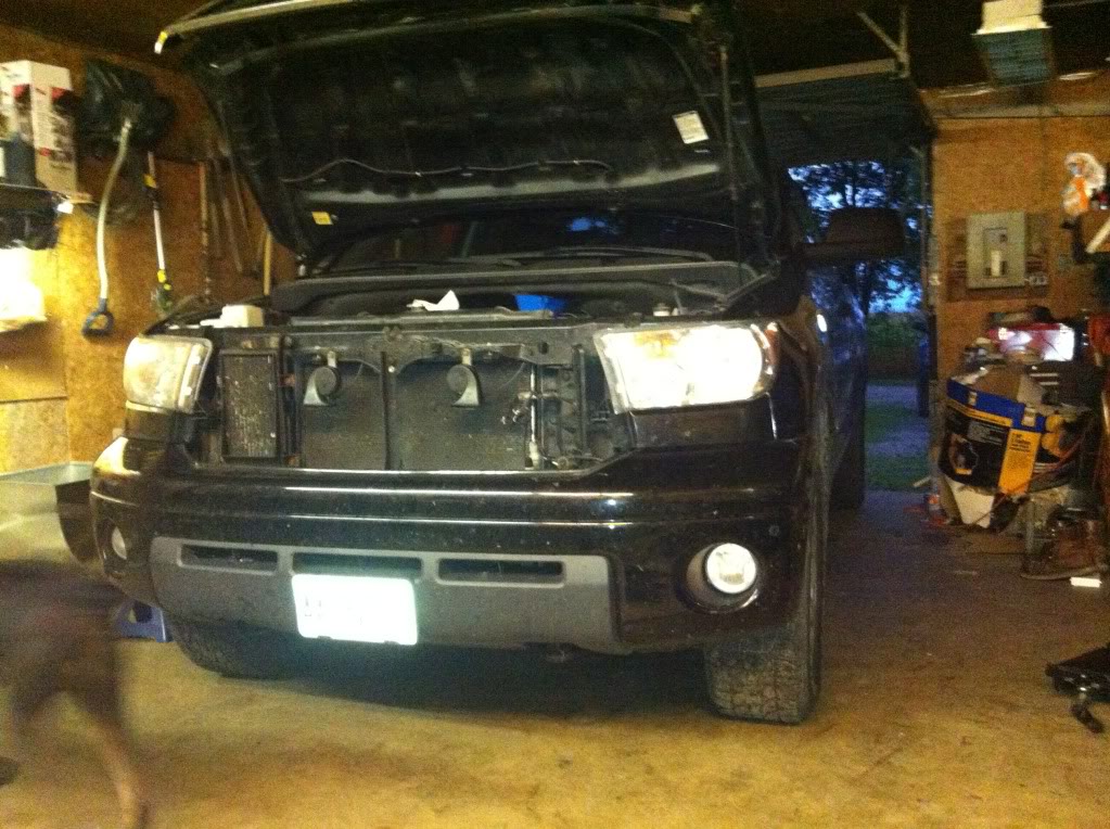

Not much room in the shop with the tundra in it. It's just awesome to finally be able to do an oil change at home without crawling in gravel.
