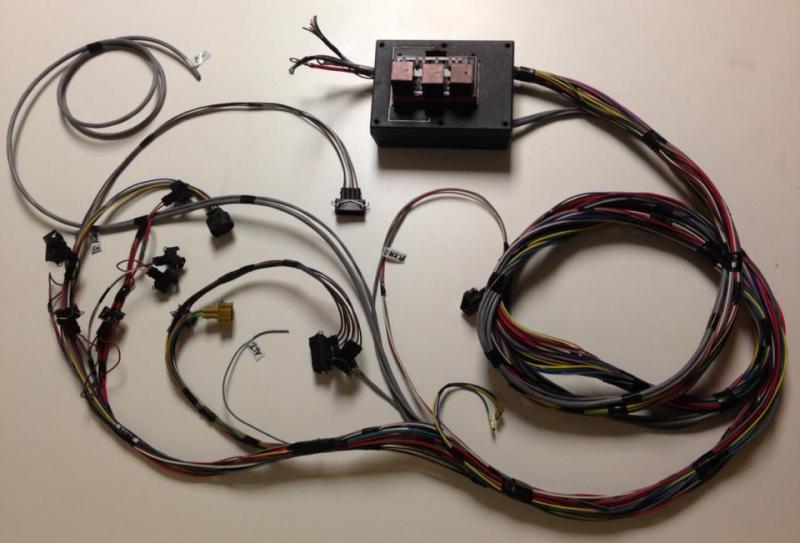

NICE looking wire harness! I haven't seen a V-Dub swap so I'm looking forward to how this comes out.
