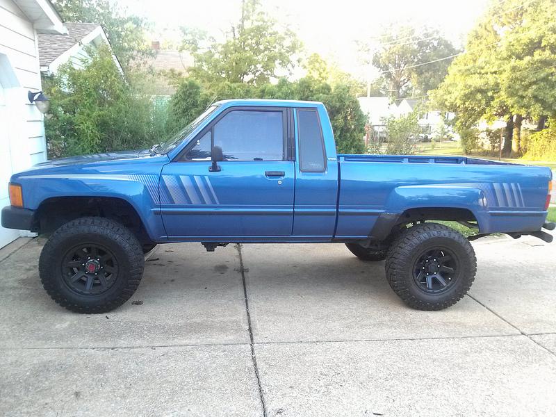

MOD #1 was switch out the chrome wheels
Picked up some black 15's from tirerack..
Living in Akron Ohio Goodyear Rubber is Cheap
So it got some NEW 31/10.50R15 Tires to match
