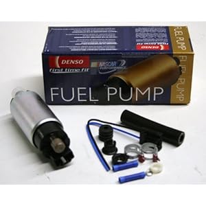

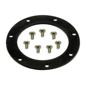

Well A couple o days into a good cold snap and my fuel pump ˟˟˟˟s the bed........
I checked spark quick buy unplugging a plug wire and letting it hang in the bay while I cranked it... saw sparks so that good!!
From there I checked injector pulse with a noid light
It was all good so I figured ECM and dizzy w/cam position sensor was all good as well!!!
So I unplugged the connector for the fuel pump..
Connection looked good
So I jumped power + ground to it
Had NO GO on the pump
For proper diagnosis grins I checked for power and ground at the pump connector before ordering the pump and it also checked out
My first thought after I had the pump in my hand was
"How Convenient" I just fill the tank yesterday
After pushing the truck inside the garage with my 4 wheeler
And an hour of me b!tch!ng
All is well!!!!
The ONLY seal kit I could get in such short notice was a dorman....
From my experience DORMAN parts blow...
However i did get a Denso Pump kit!!!
-Tek
