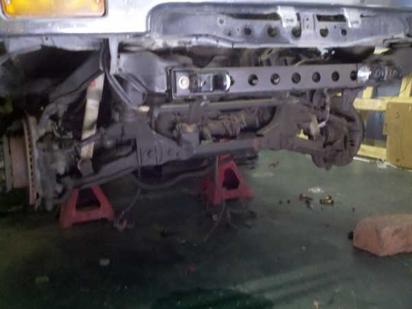

All cut out

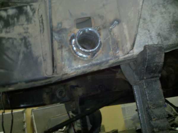

Frame tubes welded in

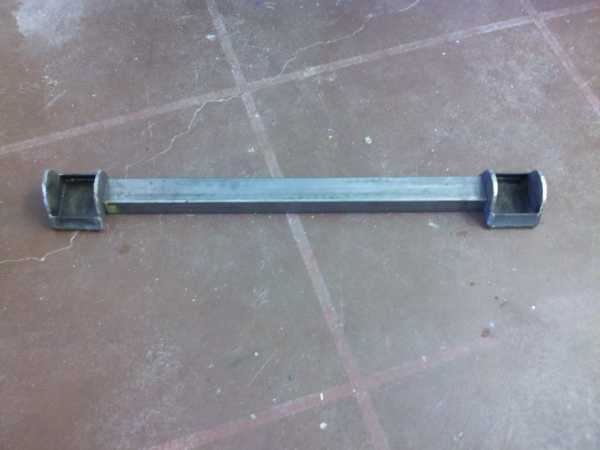

The front hanger pieces

the hanger ready for welding

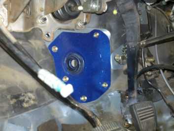

the firewall plate I had to make. Remember the 96 steering column is rack and pinion and the 91 is not, so the column went through the firewall in a different spot, so I made this plate to hold the column bushing in another spot.
