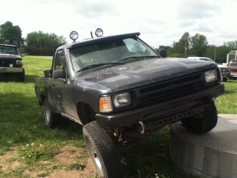

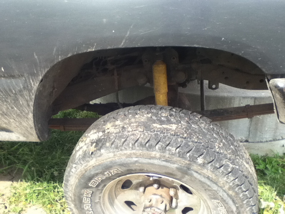

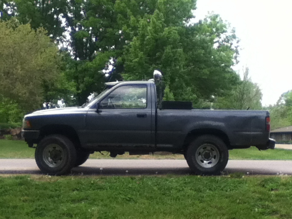

i ended up keeping 2wd springs in the rear and they flex great however the truck sags in the rear kinda like somebody put a leveling kit on and never put the adl in the rear
here it is sitting level

this was my favorite pic from kansas rocks by fort scott
the truck proved it was very capable down there, at first the idea was we were just going to stay on the green circle trails (beginner description states that 4wd likly needed most stock vehicles do well) then on the first trail we took it forked into 2 blue squares (intermediate description states minimum 32in tires rear locker, and winch) so we took a blue square trail and found out they were fun so all we did for the rest of the day untill trying to get back to the raffle without a map and ended up following the omaha jeep club a black diamond to get out to get back to the raffle in time (black diamond is the hardest trail where the discription in the brochure says minimum 35in tires, front and rear locker, winch, and spare parts) all i had was spare parts and while it needed a push (by 3 guys not a truck) to get through one obsticle it only got stuck twice in the same mud hole, all in all it was a good day and i was proud of my yota
