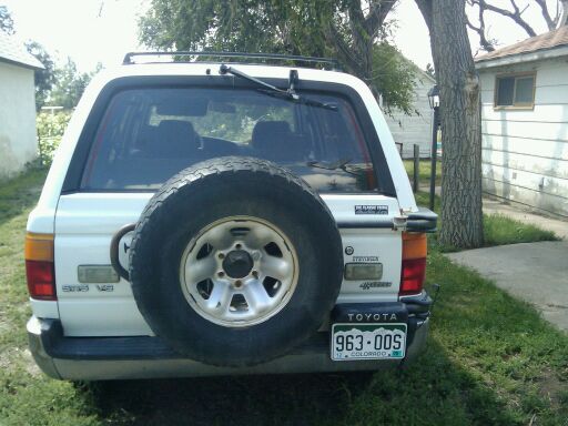

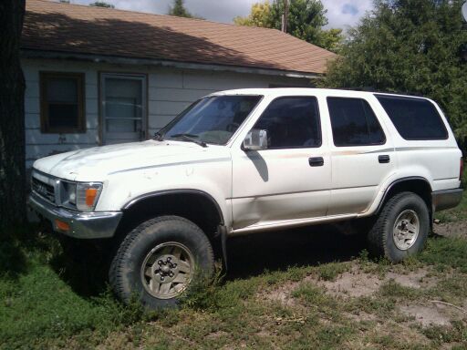

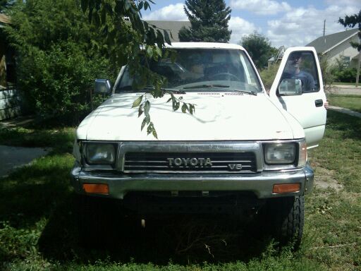

We here the stock photo's the day we picked up to add to the herd.
Attached Thumbnails devilboys toy's 1991 4Runner Build-Up Thread-stock-1.jpg   devilboys toy's 1991 4Runner Build-Up Thread-stock-2.jpg   devilboys toy's 1991 4Runner Build-Up Thread-stock-3.jpg

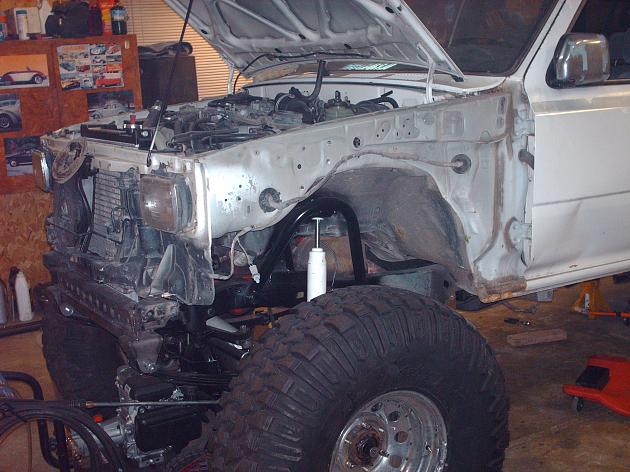

another pix with the front under and the 37"s on the front
Attached Thumbnails devilboys toy's 1991 4Runner Build-Up Thread-hpim1523.jpg

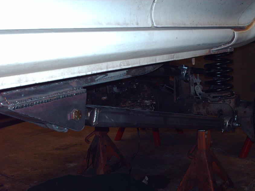

I reused most of the stock bracket's on the axle housing just moved the uppers. reenforced the lowers. all the frame mount mount and track-bar are custom. 3" xj springs. I will most likely use 4" or 5" xj coils after the rear bumper is made and after I build the fuel cell to go underneath.
Attached Thumbnails devilboys toy's 1991 4Runner Build-Up Thread-pix-rear.jpg   devilboys toy's 1991 4Runner Build-Up Thread-pix-rear.jpg   devilboys toy's 1991 4Runner Build-Up Thread-up-low-link-mount.jpg
