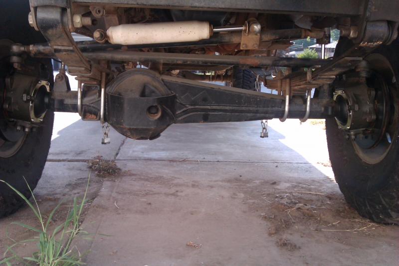

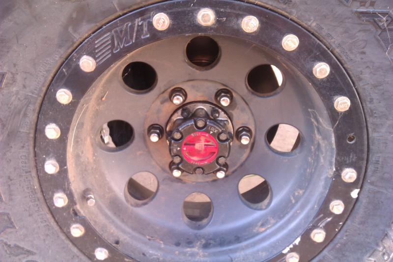

Yes, it is exciting, and if everything works out I may even get a chance to wheel it this season.
Here is the rig all torqued down and complete.

I have only driven the rig once, and that was when I drove it home from purchasing it. I parked it in the driveway and there it has sat since April of 2013. Hence, the new rig does not truly feel like it is mine at the moment.
