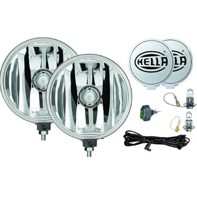

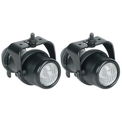

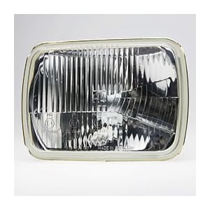

just put my order for lights in to ORW in socal. Aaron down there helped me out big time. gone through him for other stuff before and he is a great guy to deal with. kewl
lights ordered
Hella H4 conversion Euro beam pattern headlights with 100/80 hella bright white bulbs
Hella micro DE projector fogs upgraded with 100watt White H3's
fantastic fog lights with great cutoff beam and spread
and 2 pairs of the hella 500FF's. 3 of them upgraded with 100watt White H3's (3 will be on the bumper and I will install one on the corner of the bed for lighting it up at night (that one will stay 55watt).

got the new headlights installed yesterday and man they are bright waycool1 need to adjust them down so once i get it back home tomorrow ill be able to line it up with my garage door and get them dialed.
