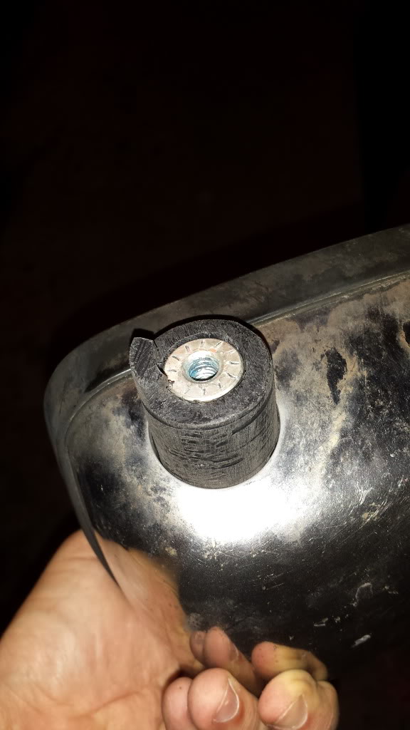

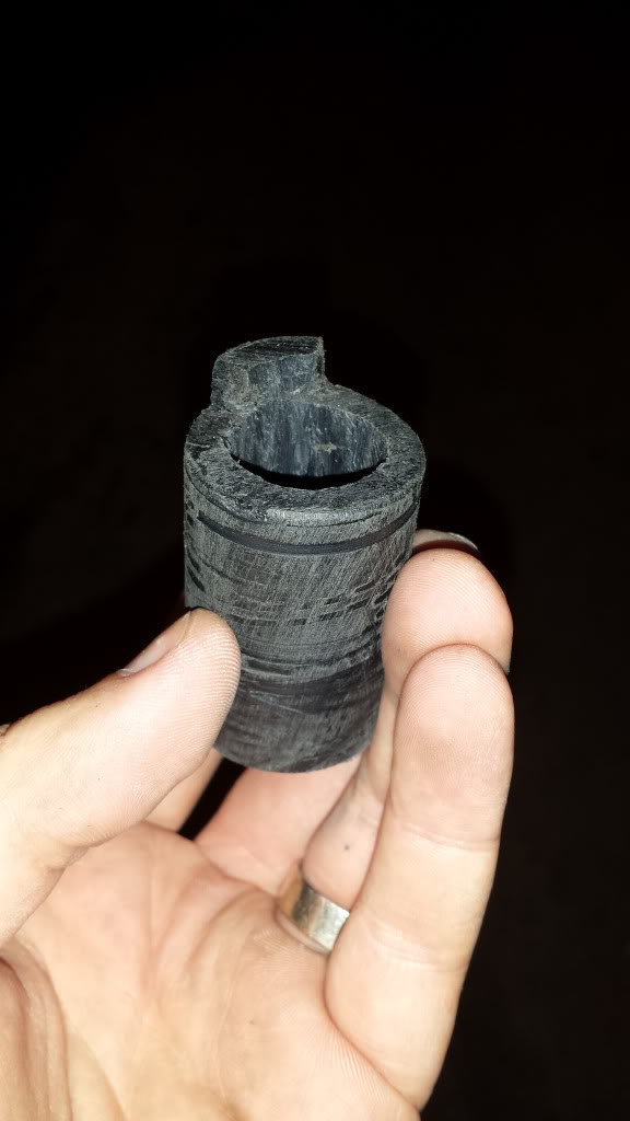

Ok, well, I finished the piece. As I said above, probably about an hour with a round file, filing the inside of the hole, checking how it fits, filing some more. After that, I marked it for that little tab that fits into the mirror bracket and I cut it with one of those vibrating cutoff saws. Here is the finished product:

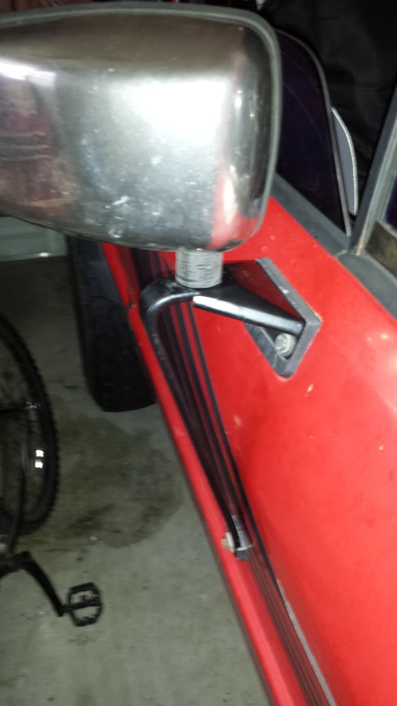

Here it is on the mirror:
This one is a bit blurry, but here it is looking up from the bottom of the mirror bracket. You can see the tab sticking into the pie shaped slot of the bracket:
And finally here it is all tightened down:
I should probably spend some time sanding the outside surface to smooth it. It got pretty marred up by my vise while I was drilling, cutting, and filing.
The mirror is solid and I'm very happy with how it turned out. It's great to have 2 non-wobbly mirrors now. I've got plenty of the Delrin rod left, I might start working on another one so I have an extra in case my driver's side OEM piece breaks.

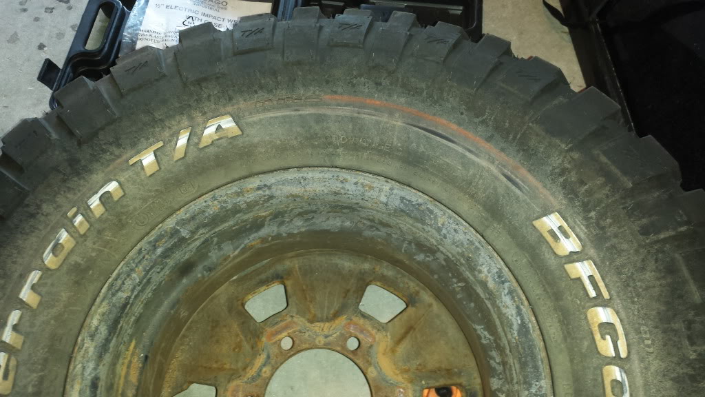

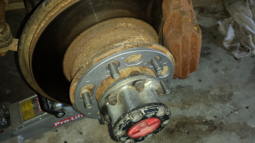

I happened to notice the other day when walking toward my truck that the inside of the front tires were rubbing on something, it had scored both tires. I crawled underneath and looked around, thought it would be the tie rod end being loose or bad or something, but I didn't really see anything that would contact the tire. After driving home, I was thinking and thinking, and then I thought maybe it was the control arm since I did install BJ spacers not that long ago. Searching on Yotatech I found this thread:
https://www.yotatech.com/forums/f116...s-help-234193/
I wish I had known this before I installed the BJ spacers, I guess I did not read the fine print, but glad I caught it before my tires were totally ruined.
And so I quickly ordered some 1/4" wheel spacers from Summit. They were the Gorilla SP603 spacers, it was like $18 shipped.
Here is the driver side tire:
And here is a shot of the spacer in place:

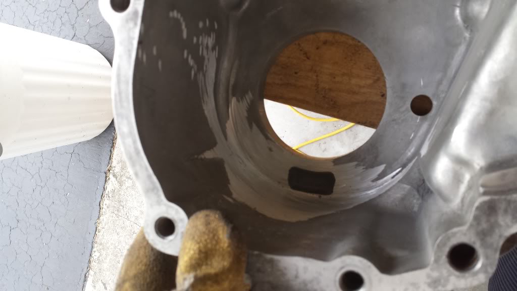

In trying to clear my endless backlog of projects, I went outside this morning and cleanup up the garage a little bit, and then that inspired me to do something about that transfer case that is sitting there all torn apart on the bench. Months and months ago I bought a set of Marlin 4.7 tcase gears and a fully disassembled case from a guy on this forum. The case was missing some little parts, which I ordered long ago, and then it had a forward shift rail which I needed to cut up to make into a top shift rail. Well Terry was kind enough to send me a top shift rail from one of his old cases and so I really had no excuse not to put this thing together. I did have to cut 3/8" off the rail Terry sent me according to Marlin's 4.7 instructions, so I did that first:
Then you have to grind a bit out of the front cover to get those big 4.7 gears to clear:
After that, it's pretty much just following directions to put a paper gasket on, put a cover on, turn 10 bolts, put another gasket on, another cover, more bolts, etc.

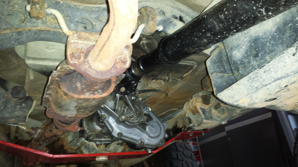

You guys got to me, so I did a little bit of work in the garage this weekend...got my little helper checking out what I'm doing

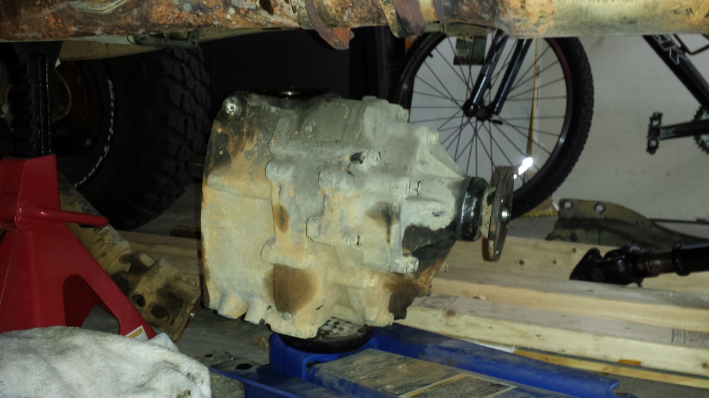

I managed to get the driveshafts off, drained the oil out of the tcase, removed the shifter, and put 1 coat of red paint on my new BudBuild skid plate.

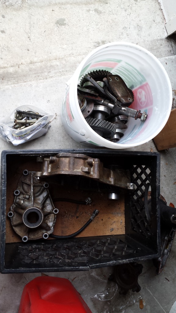

Also put all my old tcase parts together, if anyone needs a part for a tcase just let me know, I might have it.

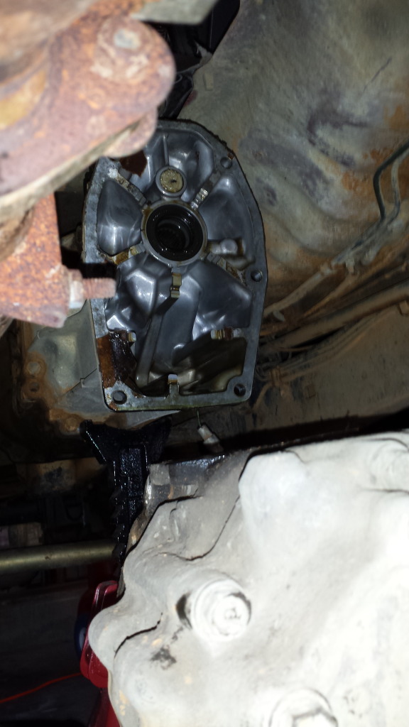

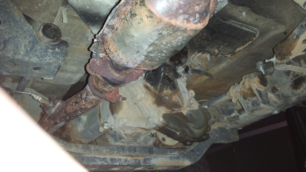

Took a ton of work, but the old case is out....
There's what the rear end of the tranny looks like. I guess I knew there would be a seal in there, but I did not have a new one handy to replace it with...hope that one doesn't come back to bite me.
And like magic....the new case went right in, really wasn't much to it.

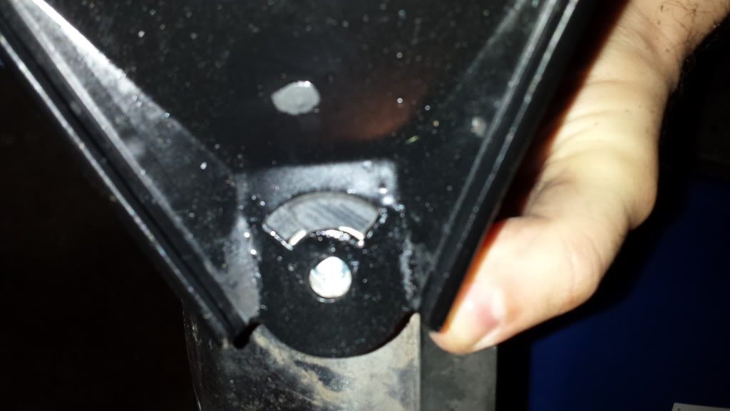

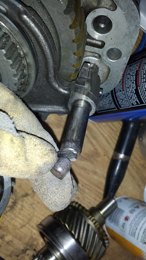

So in putting in that new case, I have 2 small hiccups.
1. The tcase was hard to shift out of 4WD, I saw was because I crawled under there and loosened the 4WD switch about a turn or so and the shifter now freely moves in and out of 4WD. So I'm suspecting that switch for reasons unknown to me protrudes too far into the case. I also noticed the 4WD light will not go off. I pulled the switch out completely to see if that little plunger was mashed, and it looks fine and I can depress it with my finger, I have not Ohm'd it out, but it is not damaged. The switch is the original off the truck, but the case could be from a different year. I've got some more investigating to find out if this switch is working and why it jams up the shifter if I tighten it down.

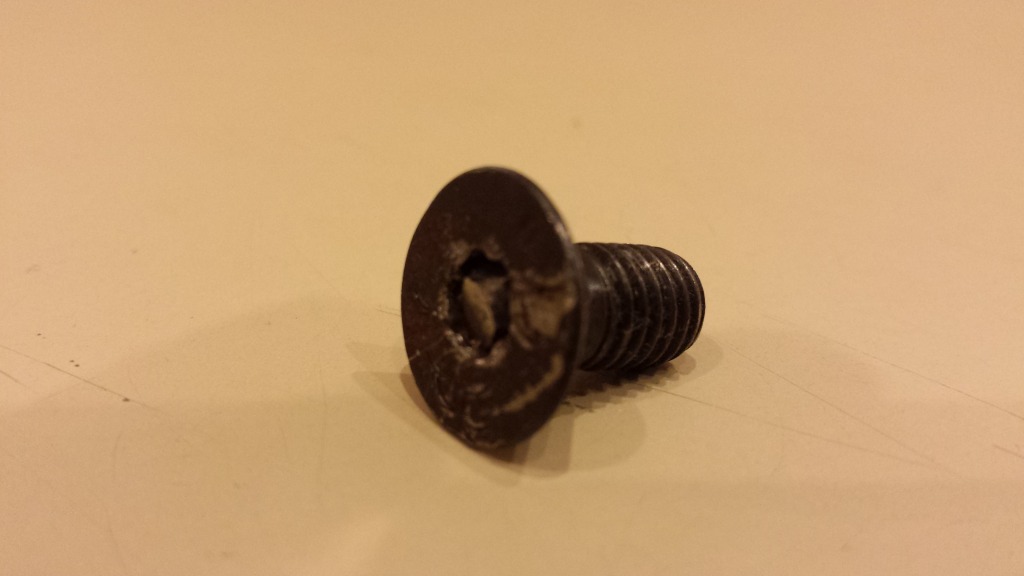

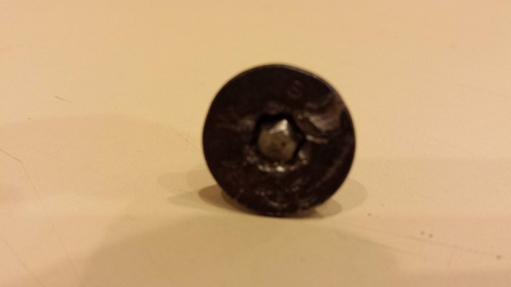

2. The other issue is that when I was taking apart the Budbuilt cross member to paint and install it, I broke the tip off my allen wrench in the bolt. The Budbuilt bolts are allen head machine screws and stupid me put the ball end of my allen wrench in there and it snapped right off somehow. Anyway, the little allen wrench piece is lodged in there. I thought I'd find a new one at Lowe's, but they don't have a grade 8 allen head machine screw in M8-1.25. They do have some that are not metric, but metric choices are slim. So how on earth can I get this allen wrench piece out of there?

ya might contact budbuilt? and check around town see if any hardware places are available they carry the crazy stuff more often
as for the ball stuck in there your not getting it out without damaging the bolt beyond use its like the head bolt in my block with the easy out broken off in that a week with diamond dremil bits an still had to have it heli coiled
